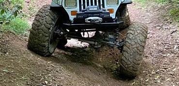

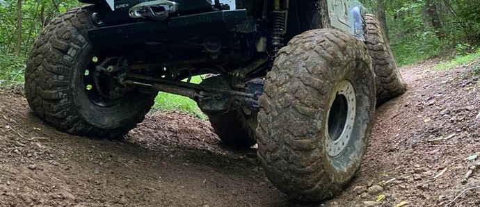

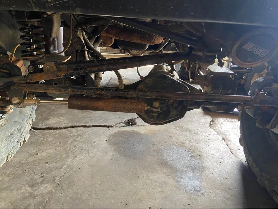

Someone local is selling a bunch of stuff that's under there YJ. I'm interested in the front axle HP dana 44, it's already geared to match my rear, has a ARB locker and RCV shafts.
I haven't confirmed with the seller which donor vehicle it came out of but I'm guessing a f150 or f250.
Right now I'm running stock width currie dana 60 in the rear. How much wider can the front axle be before it becomes too much? I'll probably add an adaptor to the rear so I can match the lug pattern. How much adaptor/spacer would be safe?
They are running a long arm kit and coilovers under their YJ. Do you think I would have to cut off all of their brackets and buy some sort of axle swap truss?
I'd like to see better pictures to tell you more. You could run a truss/mount brackets or just mount brackets which ever way you wanted. TNT Customs sells truss kits for a full width axle.
I think the axle width is 65-67" wide but not 100% positive. I don't know if you could run wide enough spacers or not to make up the difference in width.

Just talked to the seller. The front axle dana 44 was narrowed to match the 8.8. The jeep runs 2" spacers on all 4 tires. I guess that's to fit the 42" tires. He's never measured the wms so I'm not sure how to tell which 8.8 it is. He said it's out of an explorer.
If it's out of an Explorer then it's 58.5" wide so hopefully they narrowed the axle to Waggy width? If you want I can get you the measurement off mine so you could tell.
Back when I did mine Rubicon Express was about the only company offering the front brackets for a HP44. There are more now.
