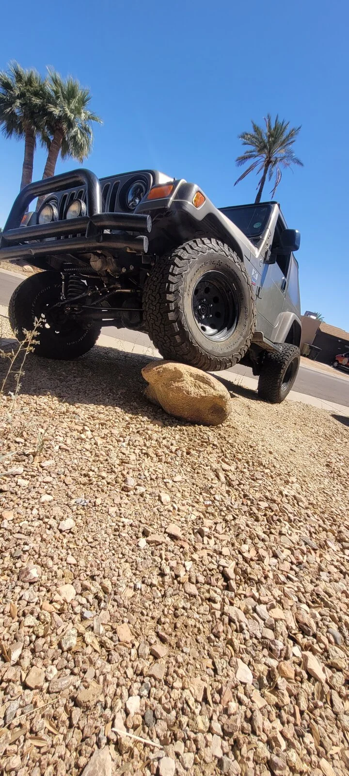

Tires, ALL 4 are set at 37 PSI and yes I'm running BFG K02'S ( Just bought the same dad had on it, last October) but went from 31's to 32's. Attached is yard wheeling pic

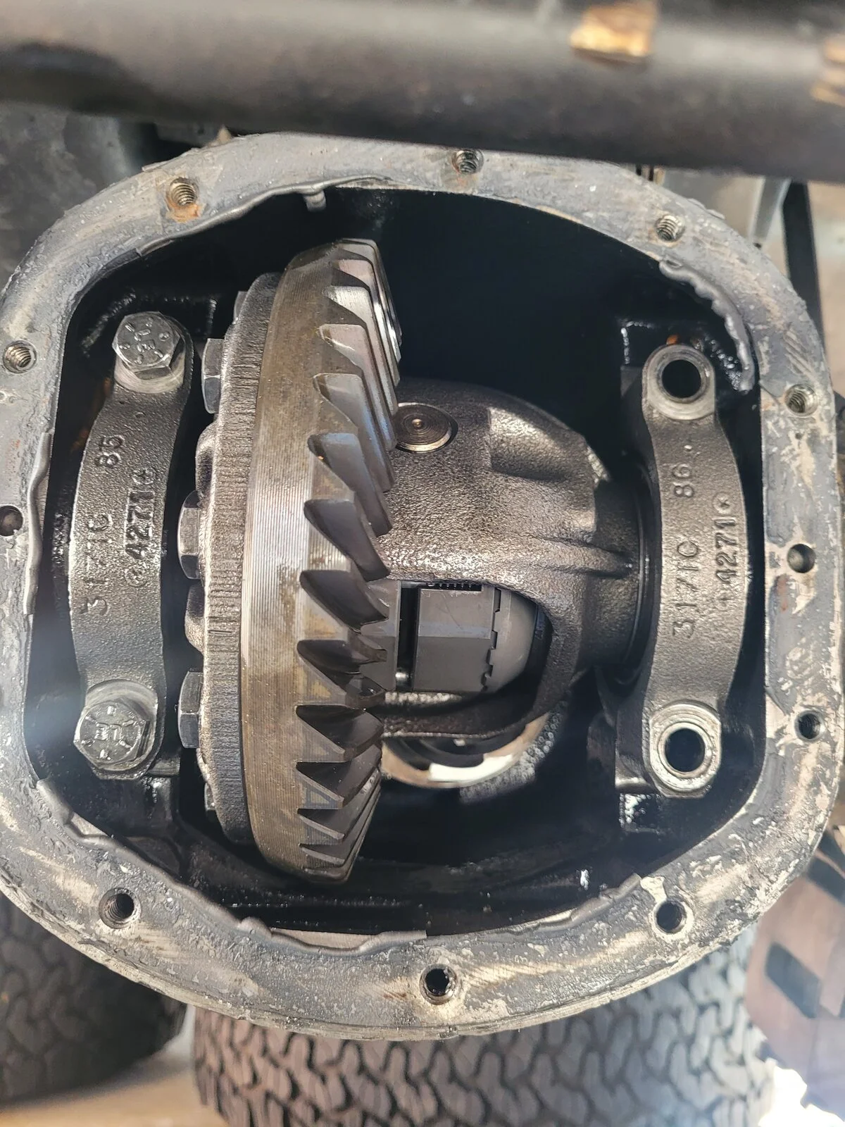

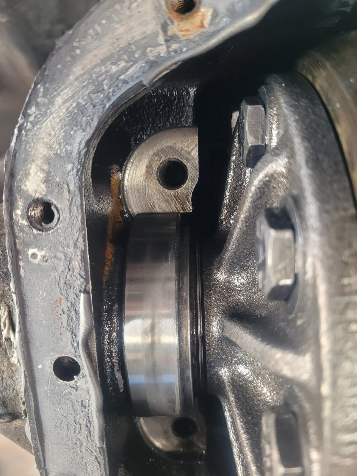

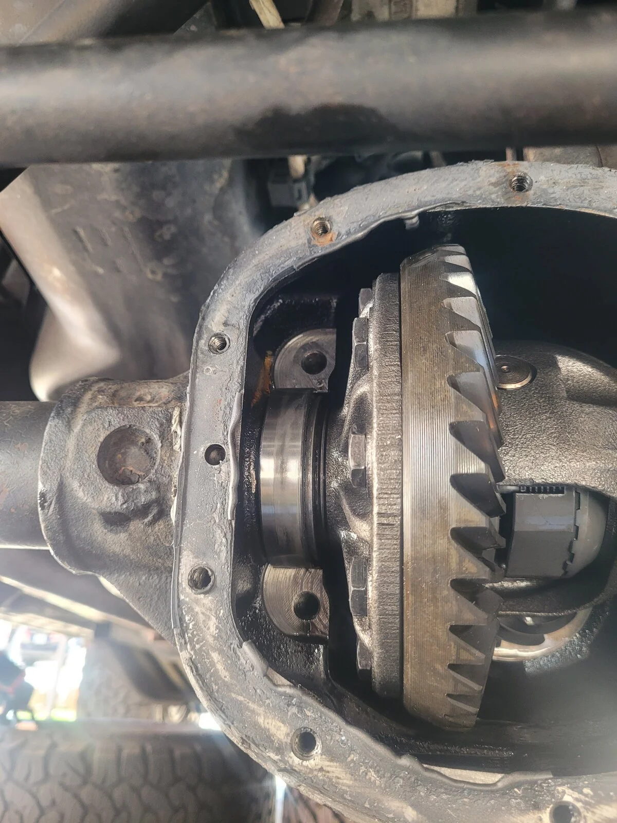

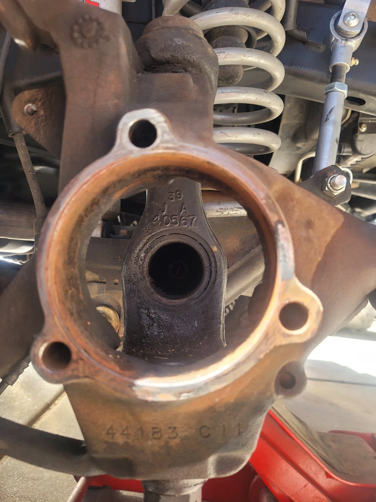

Hey y'all, so to clarify my title, I don't mean I'm crawling stumps or rocks! Lol j/j! šŸ˜„ Anyhow, I've posted before about "strange issues" with my front end and specifically thinking it was the locker, and I thought all was resolved over the last year. I upgrade the tie rod, tie ride ends, drag link and steering damper shock, as well as both Axel seals in front. While doing so I of course got to look at the locker and pull it and now understand it! BTW it's a knock off of Aussie, I believe... Uuughh šŸ˜šŸ™„. So NOW when I lock in, it is like wrestling a damn steer (cow) lol if I let my wheel go it pulls HARD right and trying to turn left is near impossible! Then when I disengage 4wheel, I have to back up like 3 or 4 times before the wheel "unwinds" again to straight! If I don't do this it drives off as if I'm still locked in with the hard pull.... I've had alignments done adjusted sway bar links(quick disconnect), adjusted drag link and still does it! Note this happened on pavement the other day... I've not gone to dirt yet because of this. Normal or do I have an issue? First photo is best "after" photo I've got right now. Others are in progress when I did this back in April. Thoughts suggestions anything please! And TIA! Thanks, Rosiebelle
In 4wd on a high traction surface, the steering should feel bound up but fairly evenly. I can't come up with anything that would make it continually pull to one side with a distinct difficulty turning the other way.
Something is wrong if that is repeatable. I'm not familiar with the exact function of that style auto locker but, it should lock under torque and deliver power equally to both sides which should NOT cause a continual unrelenting pull to one side.
What that describes as best as I can figure would be if somehow when it is seeing torque, it is locking in one side and letting the other freewheel. I suspect you could play with various methods of screwing up the install and still not be able to reproduce that effect. That points to something else but that something again makes little sense due to how rare it is. I suspect that the issue is coming from a bent housing from the bit of ditch surfing you did. But, it is very uncommon to bend the short side which is what might be causing the malfunction. If the shaft going into the side of the locker is tweaked, it would hold that side from engaging properly under load and putting all the power to the other side which would cause the hard pull.
With the tire straight ahead, check the shafts where they go into the axle tubes. They should be fairly well centered up and down and back and forth. When a tube gets bent, that shifts the shaft to one side or the other.

Few questions:
When you are in 2wd, does it drive correctly (no pulling)?
Do you still have the spider gears so you can remove the locker and reinstall the spiders and see if the problem goes away?
Do you also have a rear locker and is it also locked when this happens?

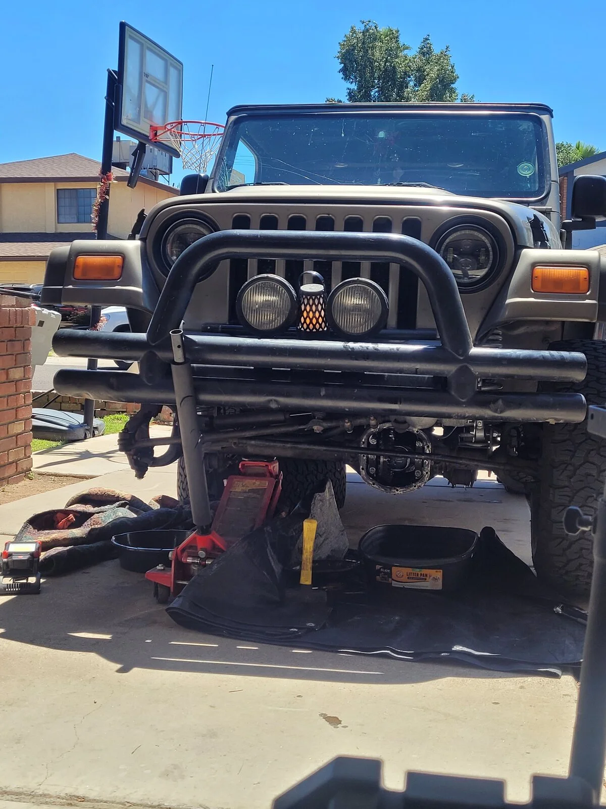

In that one picture, you have a floor jack with no jack stand. I see that you threw the tire under the frame, but please always use a jack stand before putting any part of your body near and especially under the vehicle (I know this from personal experience).
