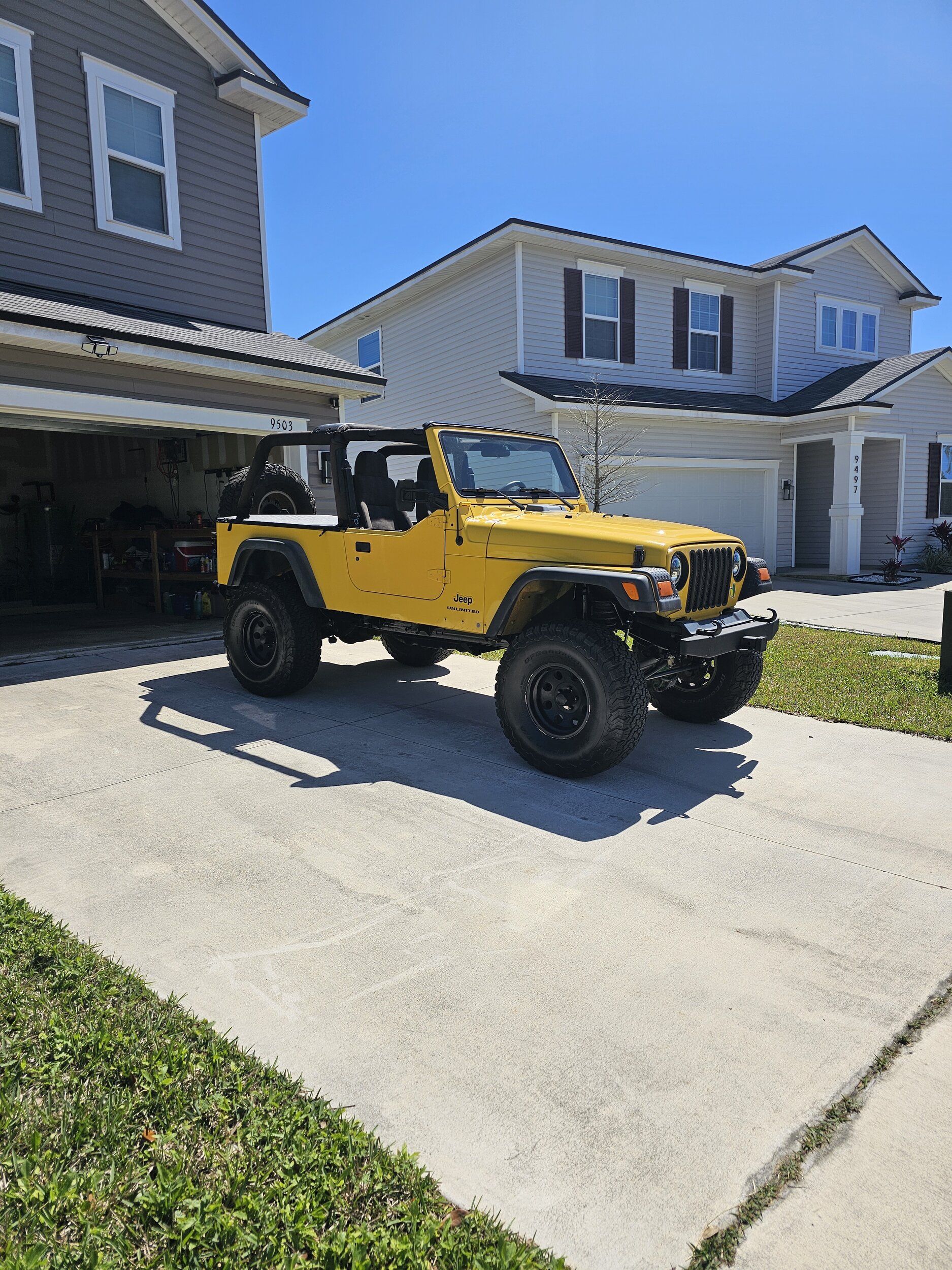

Let me just start by saying jeeps get smiles per gallon not miles per gallon. I have no issue getting terrible mpg I just want to keep the 4.0 healthy. I have an 05 LJ 6 speed just under 80k miles on 35s and stock 3.73 gears. Currently I'm getting about 8 to the gallon and that seems abnormally low to me. I'm in florida so all my driving is on flat ground and I'd say my average speed is around 60. Is this normal? If not what are some things I can look into? Did a tuneup not too long ago and no change.

Nice jeep!
