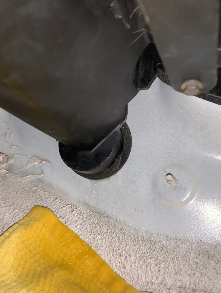

3. The cabin air intake is located under the plate between windshield and hood. It is raised, so water normally won't enter it unless the area is full of leaves and debris (which it may be). However, 3 screws hold down the plastic housing, and there is a gap between it, and the "funnel" into the ventilation system. It is filled with the foam, most likely crumbling, so put the adhesive in, or otherwise caulk up the gap.

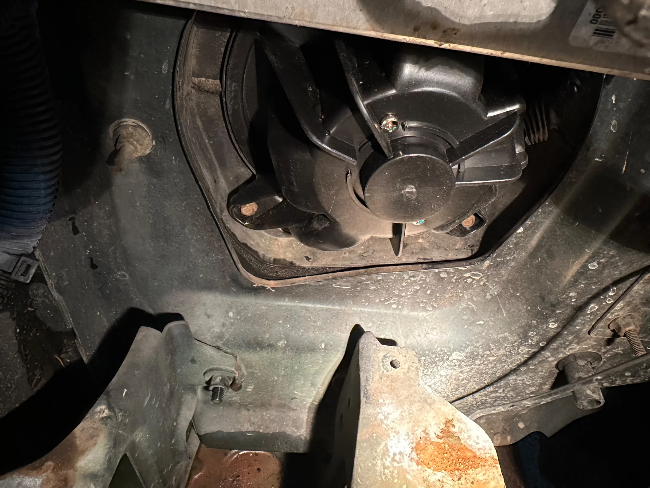

4. Remove the battery, and look under it to the fan motor housing. It sits in a little concave area with, again, some foam insulation around it. Flex seal the area.

I removed the cowl a few weeks ago after I woke up to some puddles on my passenger floor mat and found it to be pretty clean BUT the foam gasket around the air intake was a little damp.
I took that opportunity to removed the air intake which is just held in by 3 screws, let it dry off after I cleaned all the dirt and dust off of it, reinstalled with very good waterproof silicone sealant and haven't had any issues again. I'll have to check under the battery and the lines where the AC tubes come in. (y)
