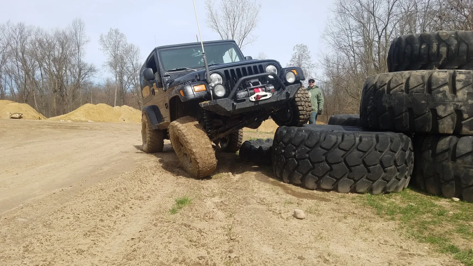

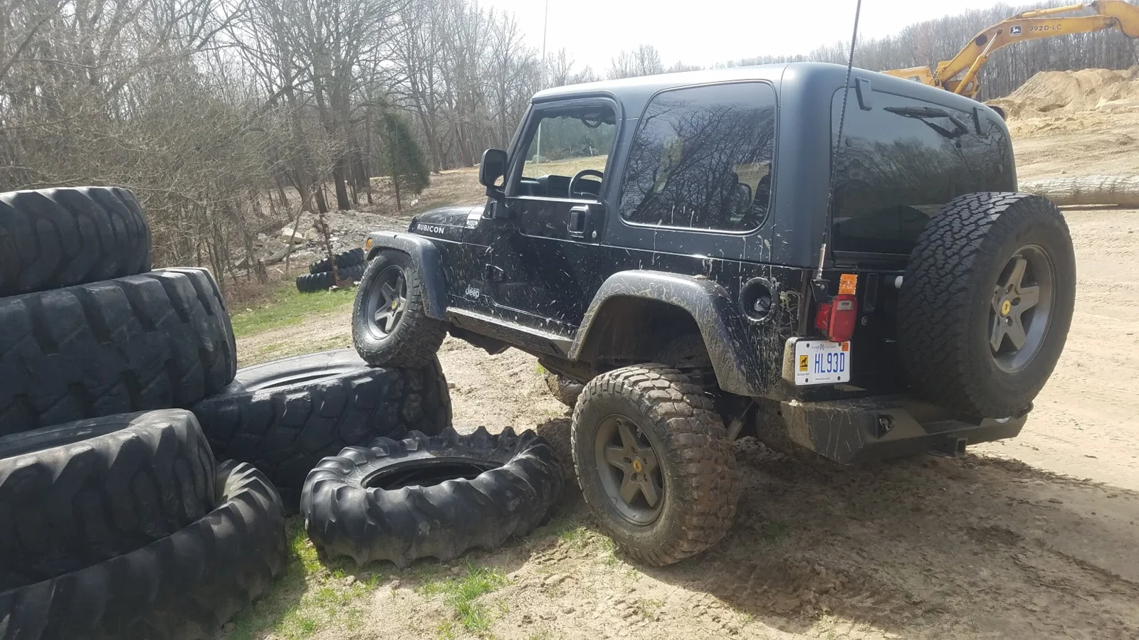

It works. Its not ideal. Just means you'll pull a tire off the ground a bit sooner and the jeep won't stay as level. You still have the travel, its just biased toward up travel vs down travel. If you're going to have a bias in travel, up travel is WAY better than down travel.

Is this RS55128/RS55240 with 2.5" SL?
If you do it all over again (with Rancho shocks), would you prefer RS55128/RS55240 or RS55239/RS55241?

Its OME Springs 2" with Bilstein 5100 shocks. Not exactly what you're running, but close enough. I had about 5" up and 3" down, the Bilsteins are an 8" travel shock, meant for 0-2" of lift (basically stock replacement).
I'm currently adding a 3/4" spacer to my springs and putting the 239/241's in. I'm planning to be pretty close, travelwise, to what @JMT posted above.
