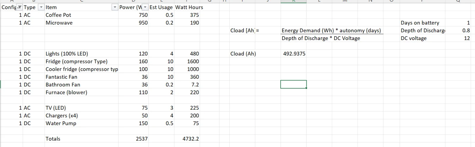

Did a little bit of power budgeting and came up with the following:
Ouch...I'll need five 100 Ah batteries to last for a day. Do these values and estimates look legit, @StG58 ? Maybe I need to rethink my power needs.

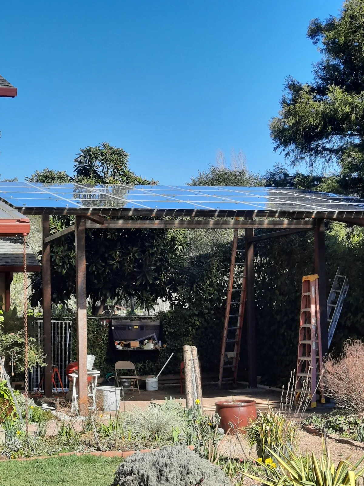

My father just got done adding solar to his house. It has an all in one controller that maintains the lithium batteries and switches between the grid,panels and generator(during a winter power outage) by itself.
He bought some cool frameless panels that are laminated to glass. Just 4 holes you use to mount.
Probably not as impact resistant as aluminum framed panels but lightweight for their size.
Those numbers look to be in the ball park, if a little high. Remember that with lithium battery technology you can run your batteries waaay down there and still get over 12 volts out of them. Find the power curve for the batteries you want and check it out. They fall off a cliff at some point, but it's usually around 90% + DOD.
Looking at your energy budget... Your refrigeration numbers could be a little high, except on really hot days, or days where you are in and out of the fridge a lot. We don't use the microwave, an electric coffee pot, or the TV(s) that much if at all out boondocking.
Our 27' trailer has essentially the same setup you have. I think the lowest we've ever pulled the batteries was about 85% DOD. (15% left + another small emergency reserve) That took just shy of four days. We have a theoretical capacity of 412 amp hours. Hope that helps.
