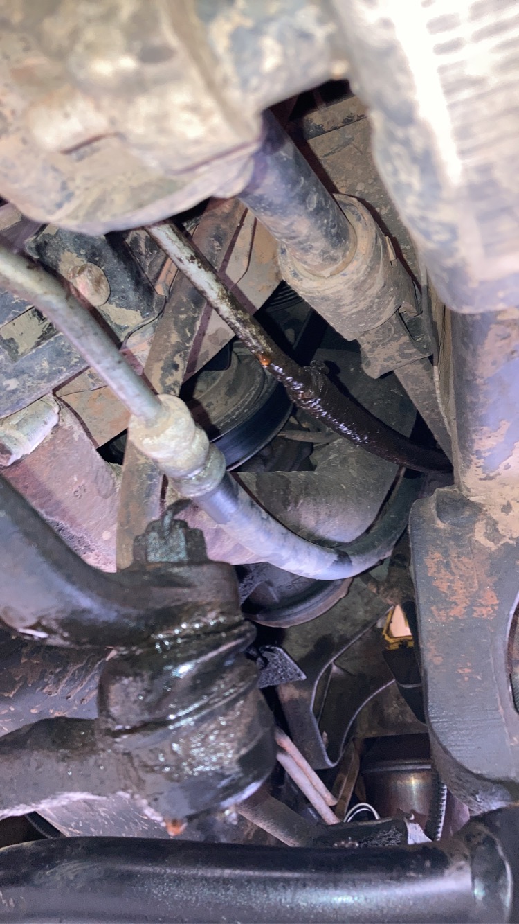

A line to my steering box is leaking fluid and my power steering reservoir fluid level is at “add”. The whole line is soaking wet as you can see. How do I fix this? Also can I use any power steering fluid to top it off?
That looks like the return line is leaking from the clamp area. The hose will get brittle and start leaking. But verify from the highest point down. The fan will blow the fluid back also. You can cut the clamp and get some power steering return hose and replace just the rubber part. If the pump reservoir is plastic carefully remove the clamp and cut the hose lengthwise down the reservoir nipple and carefully remove. You don’t want to break the nipple off the reservoir. I recommend a full circle clamp or spring clamp vs a worm type clamp that will damage the hose.

It replaces and is compatible with the ATF. But as above verify if the leak is coming from a bad hose or the housing. If it's actually just a bad hose replace it.
If you replace the hose that's going insert air into the PS system. That air will have to be bled out before you can start the engine. That involves jacking up the front end enough to get the tires mostly off the ground. Fill the PS system with fresh ATF+4 and then cycle the steering wheel fully L-R-L 25 times. Watch the ATF level and add more if needed. It might even overflow since it changes level as you do this. Then start the engine.
Running the engine before bleeding it when there's still air in PS system can damage the PS pump when it cavitates from the trapped air.
It’s leaking from the top of the line and it drips all the way down. Does anyone know which rubber line I need to replace it?
I will try to just add new clamps and see if it fixes it. Silly question but is the reservoir where I need to siphon the fluid the clear container near the brake booster where the fill/add line is? Or is it the black plastic container where the return line connects to
The return line is the one with the clamps on it. You can get some power steering return hose and just replace that and the clamps. If you order the return line it will come with the metal portion to the gearbox.
