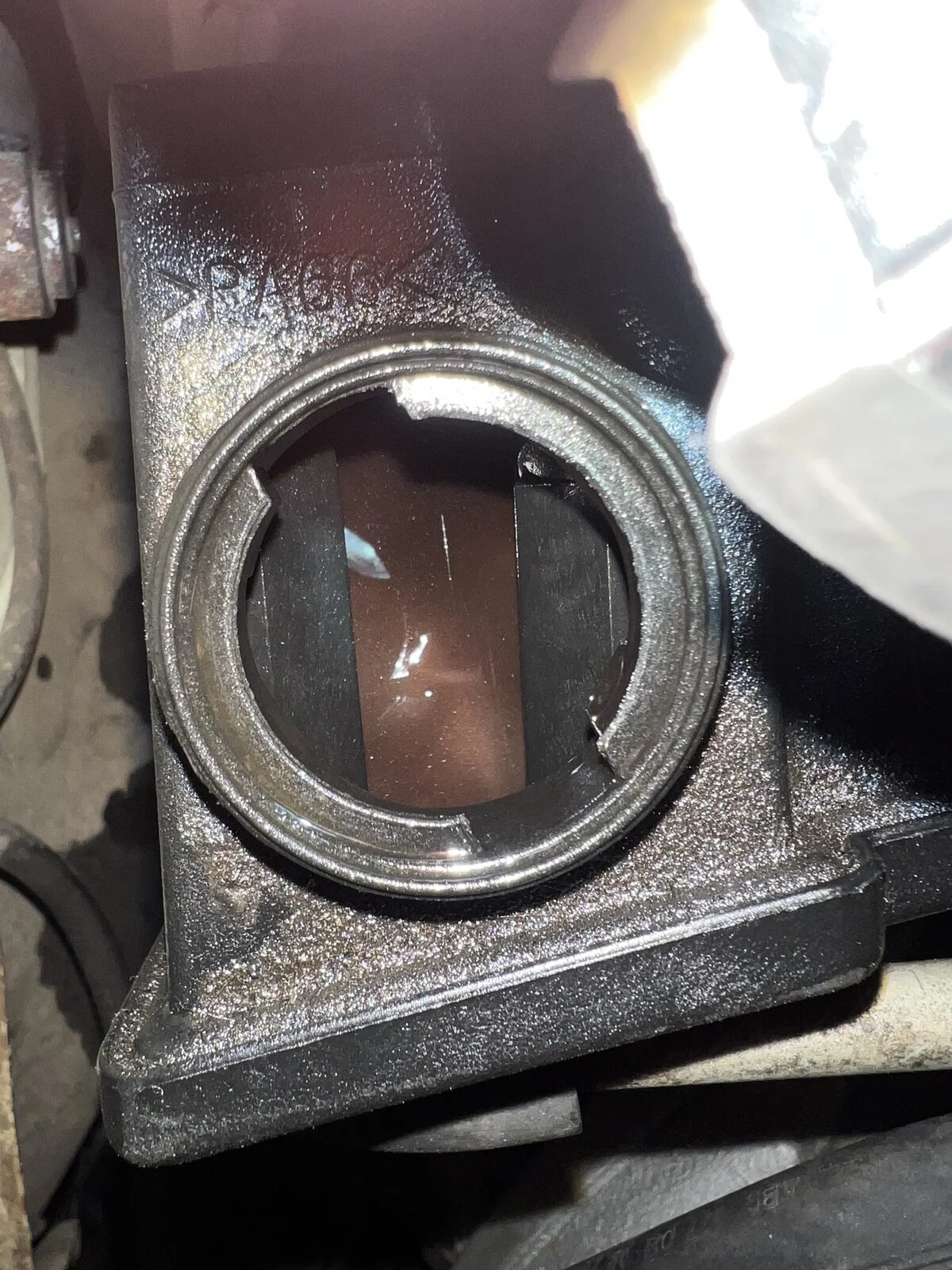

So about a week ago I replaced my steering box because it was leaking from the input seal. Put a RedHead Steering gear in it. It drove and steered amazing since the replacement but over the past few days I’ve noticed some whining while turning the wheel and a whining noise while driving down the road. I checked fluid and made sure the system is bled correctly but can’t seem to figure out what went wrong.
When turning left and right at idle there is creaking felt in the steering box and heard when windows down. At full lock there is a 1/4 turn that gets super stiff. Whining is extra loud now. Unsure what to do. Deffective box? Steering pump crap the bed? Put a picture of what my fluid looks like below. Used the right fluid for my year. 1999. Everything looks dry.
