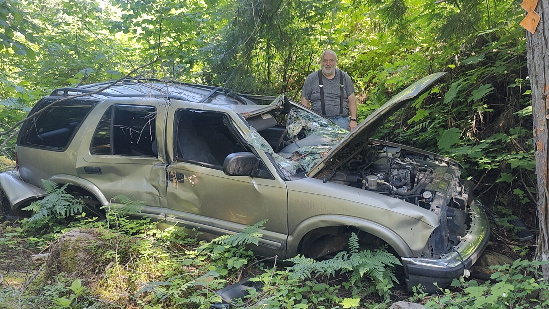

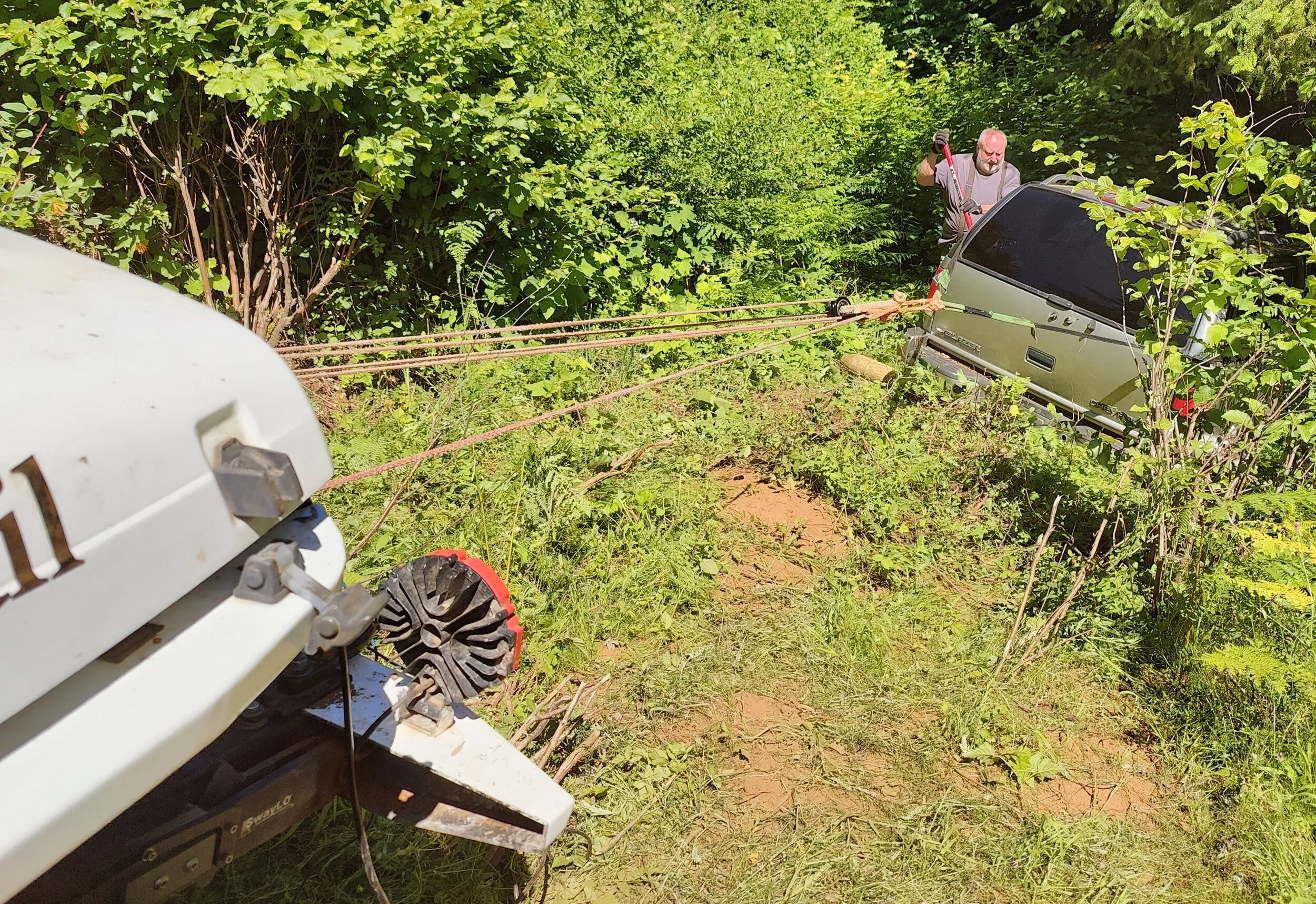

Found another vehicle abandoned in the woods yesterday. Going to have to do a little road construction. The hill it got dumped off on has heavy brush growth and it'll be easier to drag it 500' down an old skid road to another spur road. No wheels and the entire front end was disassembled.
-Mac

Agreed if it wasn't like on an 80 degree slope, I could barely stand up yet alone hang on...and I was afraid if I jostled the load too much it would slide into a trail below or worse the creek 100' below that. I was really on the edge of this being anywhere close to safe enough.
-Mac

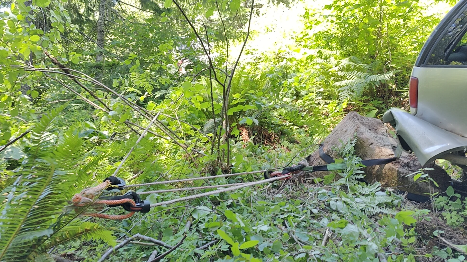

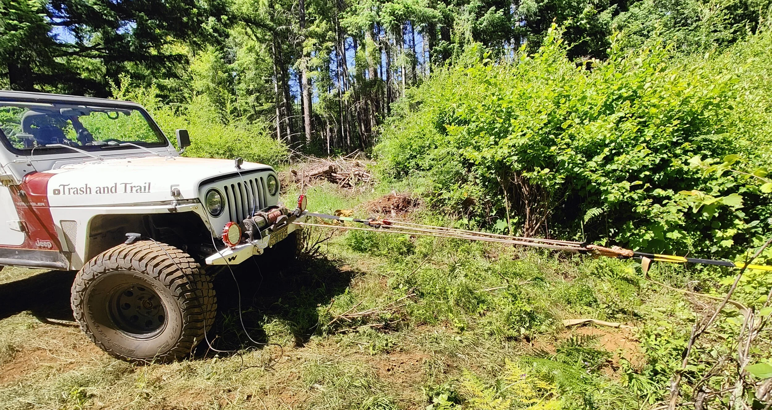

And at some point...it really doesn't matter how big of a winch you have...at 4400 lbs there's only so much you can pull before you're pulling the Jeep and not your load.
That's where plenty of line and rigging accessories come into play. Snatch back to a tree and the jeep sees 1/2 the load. Add a 2nd snatch at the tree and the jeep sees 1/3 the load.
Yeah I even brought a 80' extension rope aka @mrblaine OG test rope...and had plenty of rings... it's really hard to think through all the details when it's hot, you just spent all day welding the trailer back together, and you've clambered up and down that hill for the 15th time. That and (the second day) we rigged 20' up a spindley tree.
