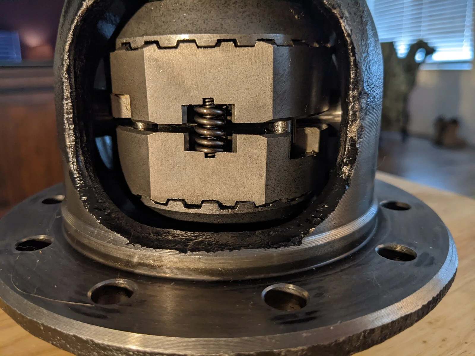

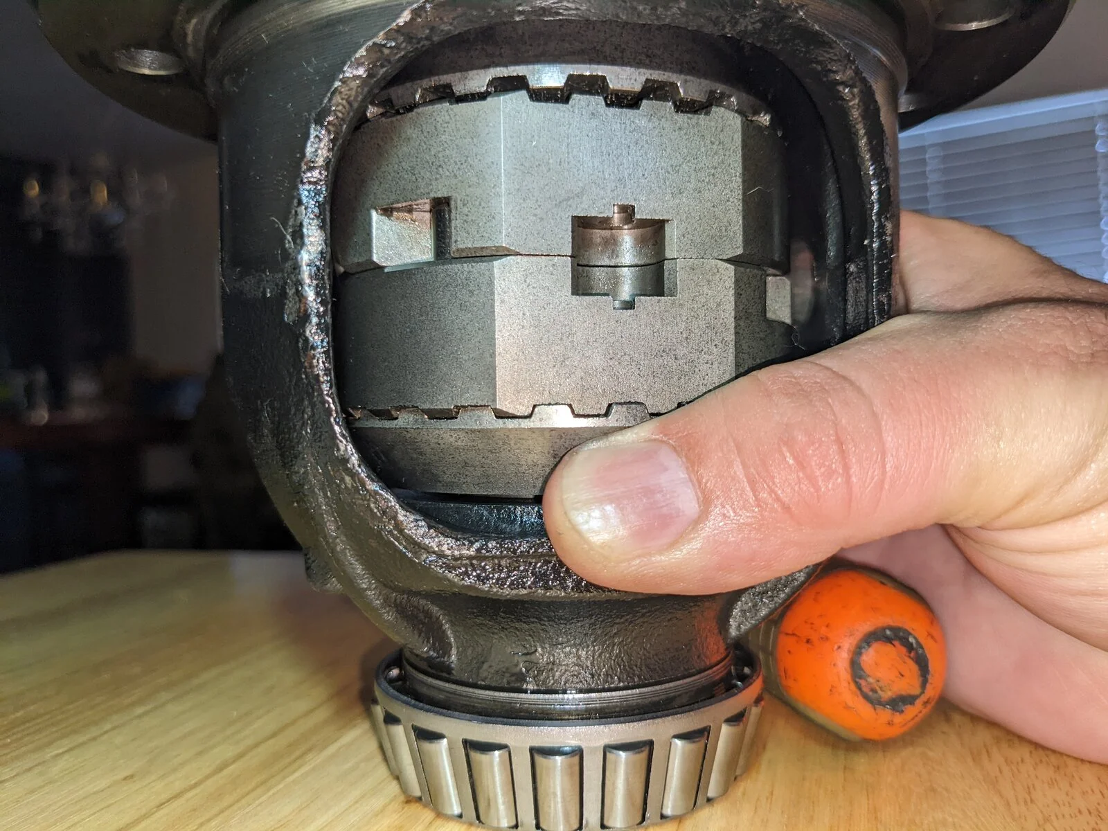

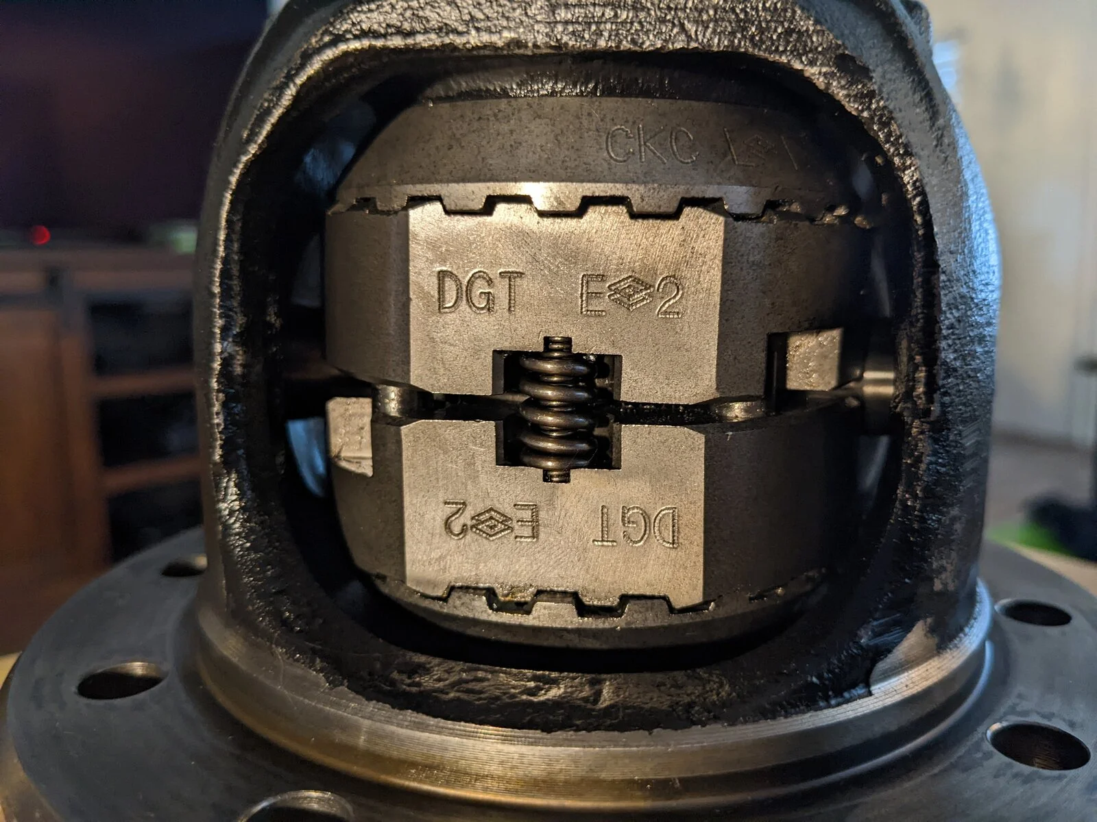

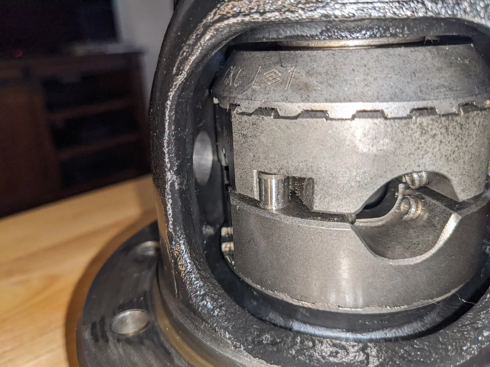

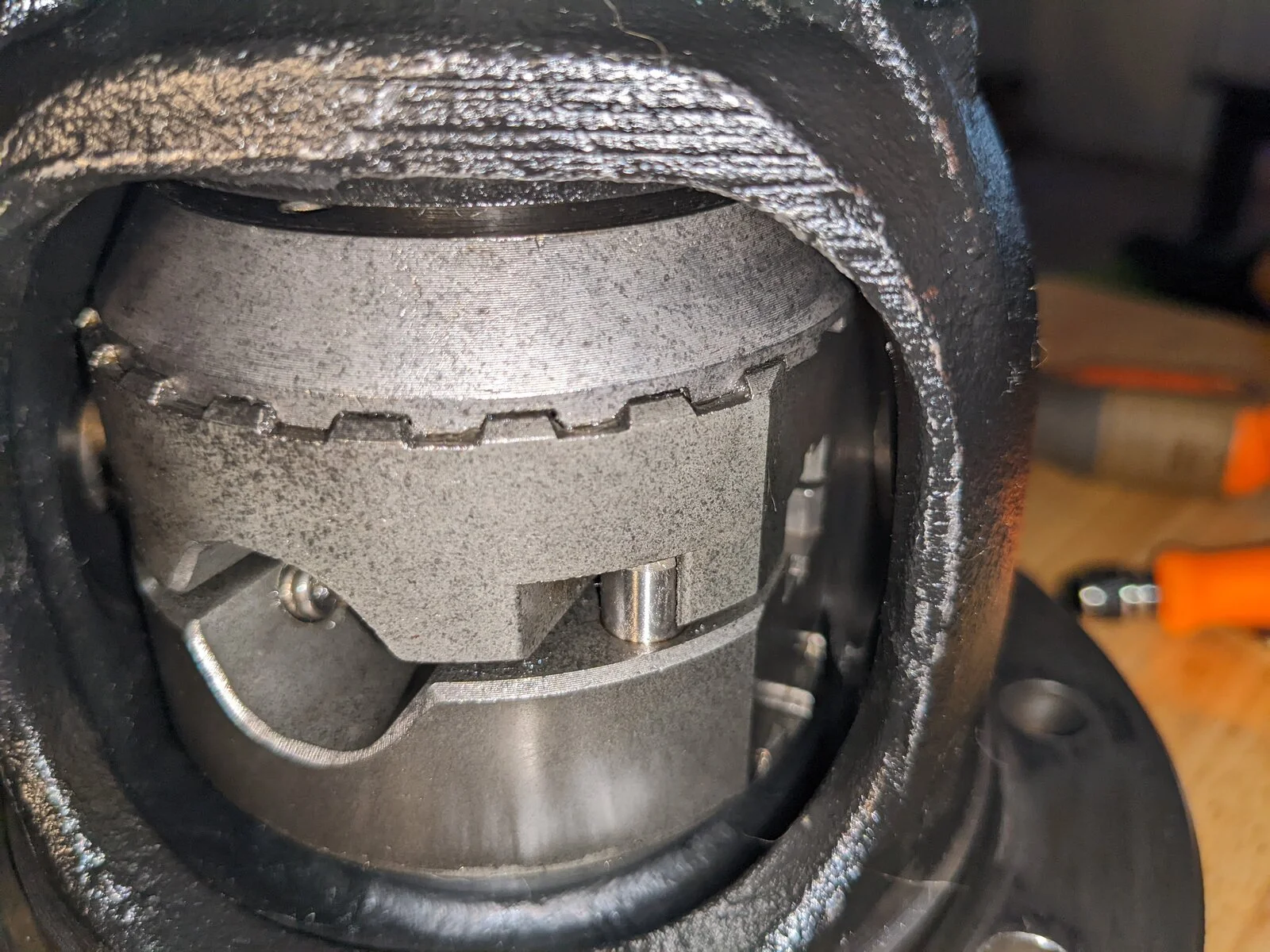

I'm running into an issue where the no-slip fits into my Dana 30 carrier, but doesn't spin enough to get the springs in. The driver's are slightly wider than the couplers and bump the carrier. I've read that a few people had this issue and used a Dremel to grind a mm or so from the cup rim where the spider gears would sit. If I slightly lift it to center in the carrier I can spin it but the gap between drivers is off because it's so tight, especially once I put the roll pin in. Looks wonky to me. Maybe shaving those areas will give it enough space to open and close properly. I have pics if anyone can help.
Reactions: Zorba
Have you reached out to powertrax? Mine is currently sitting in the box in my garage so I have no experience with installation.
