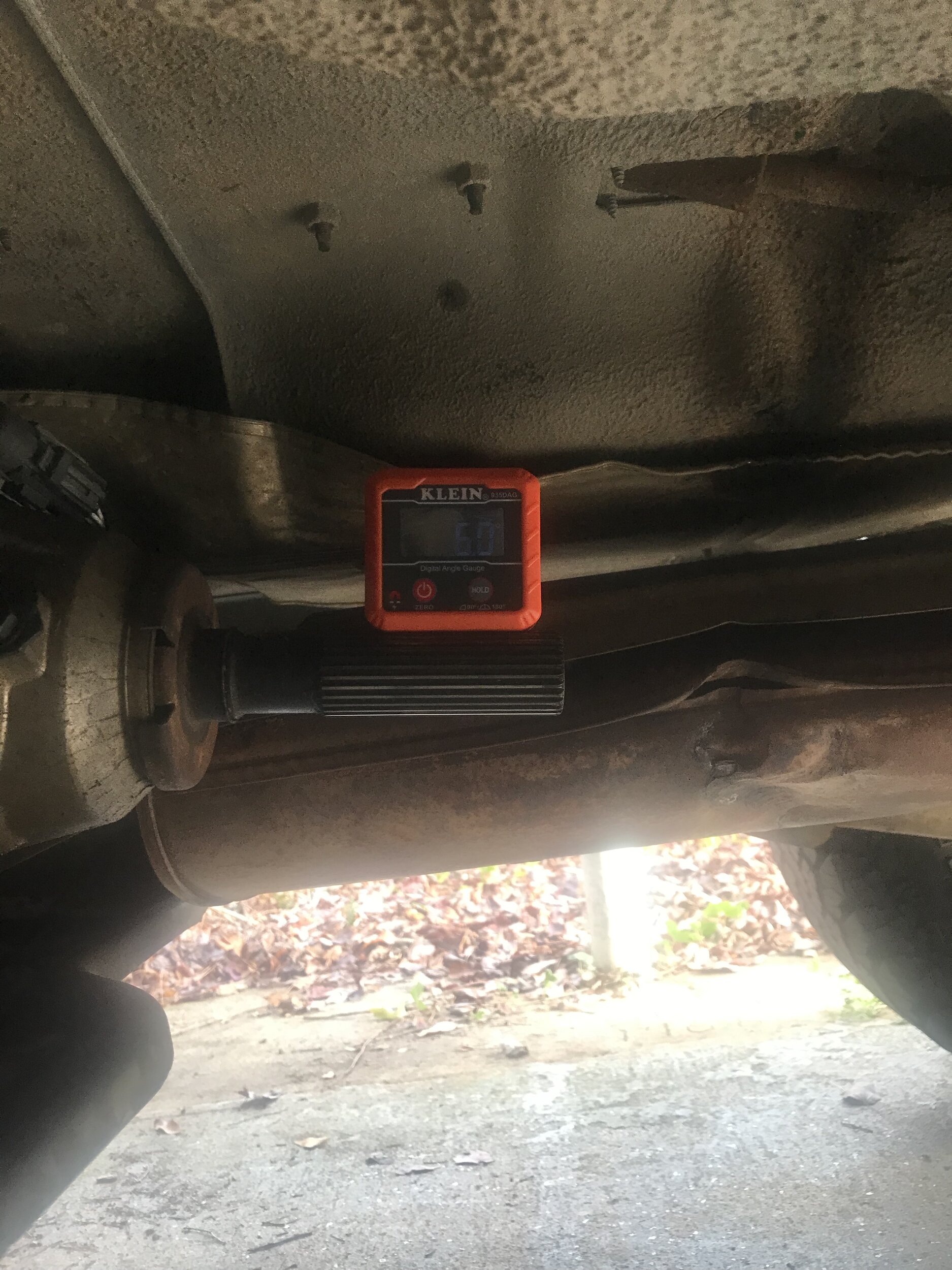

Hey everyone, I have a 2000 Wrangler Sport with a 1.25” rancho suspension lift. Stock Drive shaft. U-joints on the rear driveshaft tend wear out once a year. The angle at the t-case is 6 degrees (measured with digital angle finder on top of output shaft). Rear pinion angle is 10.9 degrees (measured at flat spot next to pumpkin).
I think this means I need to bring the rear pinion down closer to the ground.

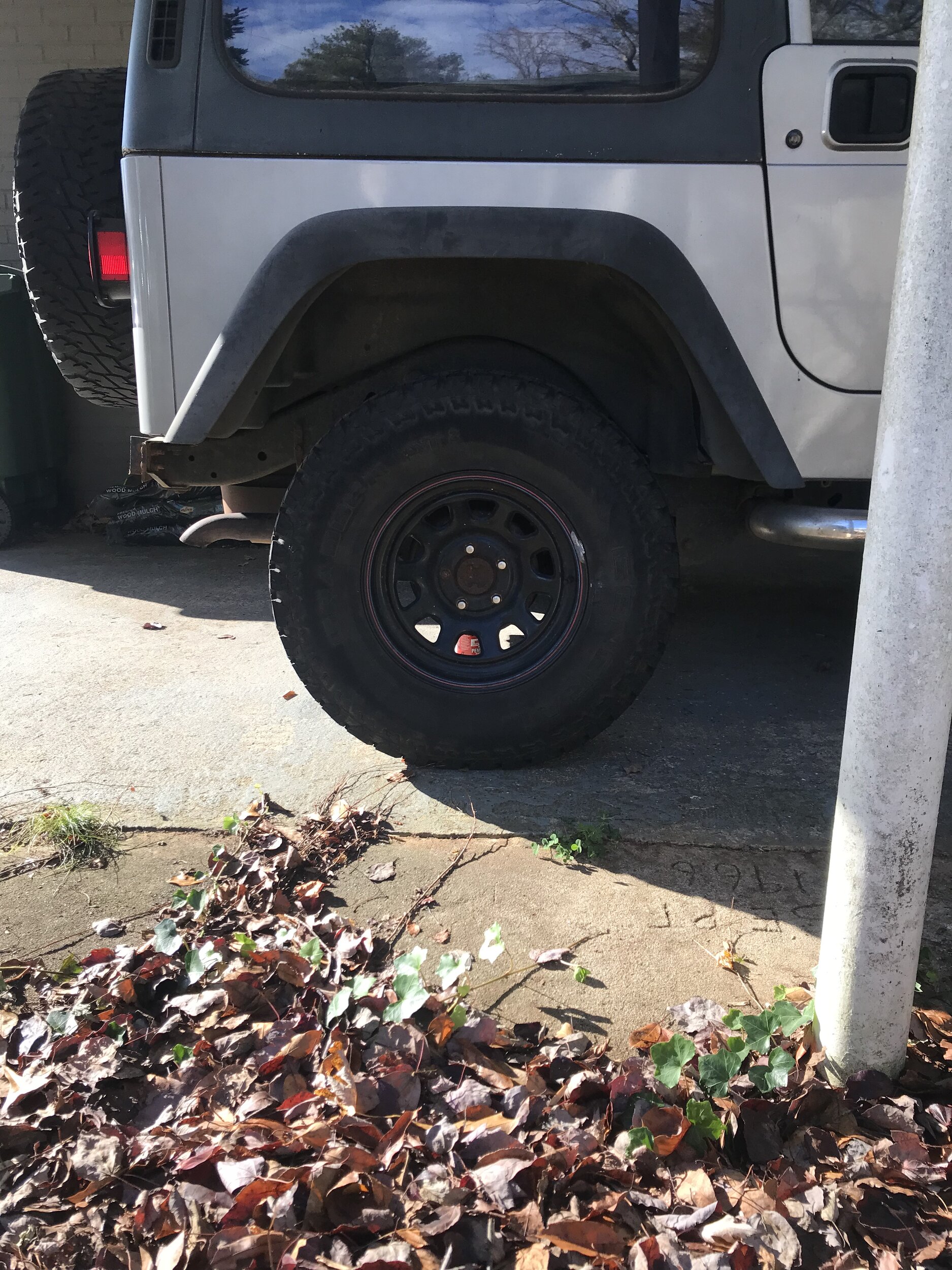

I purchased some adjustable upper control arms without thinking it through. They don’t adjust shorter than the stock ones, they only get longer. Will adjustable lower control arms help? The rear tire in the wheel well looks about right. Can anyone suggest a brand of uppers that adjust shorter than stock?

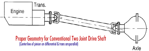

The rear pinion angle is supposed to be the same as the transfer case output shaft angle. They need to be parallel to each other. Do you have adjustable length control arms in the rear?
It needs to look like this.

And you said your lift is only 1 1/2”, which isn’t much. But the photo you posted shows what looks like a much higher lift.
Have you measured your lift height to confirm your assertion? IIRC, stock is 8” and 12”, rear and front respectively.

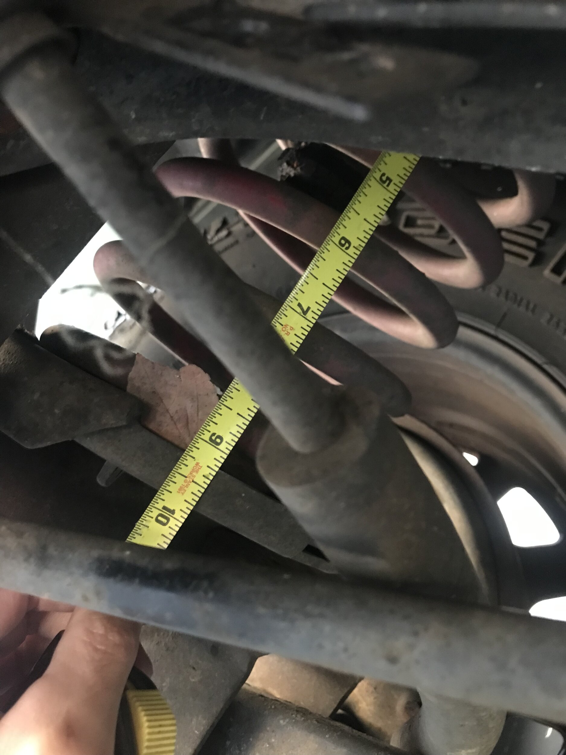

The rear coil from cup to cup is 9.5”, the front coil is 14” but the front has what looks like a 1” spacer which would make it 15”

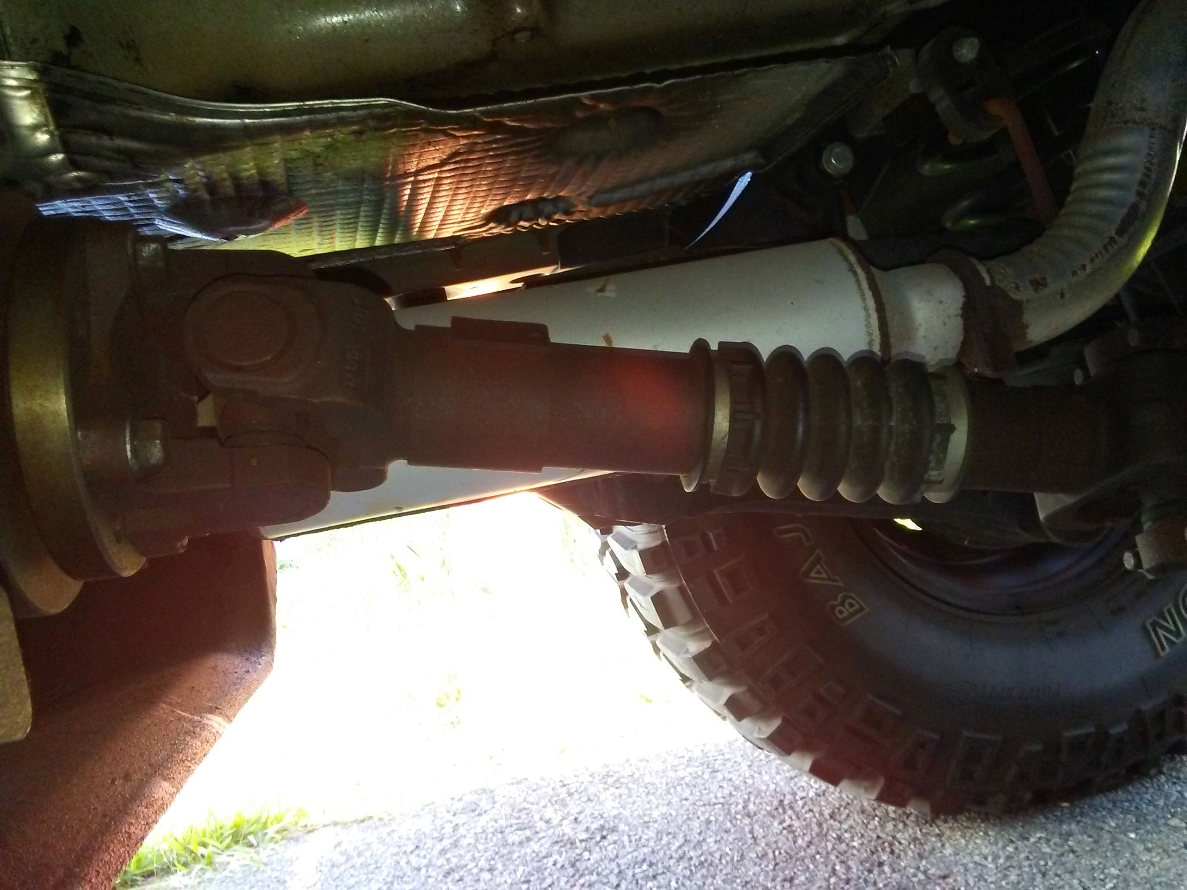

From the looks of your muffler did your driveshaft leave the chat once? Maybe post some pics of it.
