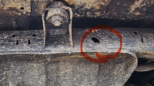

Here are the pics I took. I was poking around and given what I had seen, I thought this was pretty good. Price was decent, with new tires $8400. I had a $13K budget to play with to buy, so this seemed like a good deal for 2005 Rubicon, clean, 4L with 6-spd was ideal. I retired and sold my 69 Z28 where I dropped in a 383 Stoker, 6-spd, 4:10 9" ford. It was just look'n pretty. I wanted to engage differently as I like to hike, bike and thought... why not do a Jeep. I built the Camaro, so I have tools and skills (I think), but know enough to seek alpha to limit making mistakes.

A few things stand out to me in these pictures.
The drag link and track bar look quite wet near the frame side. This could just be extra grease but it also could be a power steering leak near where the input shaft enters the steering gearbox.
It looks like you are missing bolts on the transfer case skid plate / center crossmember, although the picture is not very clear. You should have three into each frame rail. Speaking of the transfer case skid plate, a transfer case drop defeats the purpose of a lift.
it looks as expected. My concerns are these: The surface looks wavy, for lack of a better term, and usually the sign of rust. There appears to be quite a bit of rust between the tc skid and the lower frame rail, very common, but something you should look very closely at by dropping that skid. There is quite a bit of rust on all other components underneath so the inside of those rails are likely also rusted. Most concerning is this, what appears to be rust flake, peaking out above the entry point above the tc skid, also very common for a TJ of this vintage and geographical location. It could also be a leaf, who knows, but I'd get inside that frame asap and see what's going on in there & if something is going on commence remedial measures immediately:

Thank you. It's gonna be a learning curve as I was looking at things I know, like rust, leaks, damage and I saw the grease, but didn't get deep enough under it to truly see. I didn't put it on a lift. I appreciate the feedback. I may just take on the body lift (does this impact things like fuel, brakes, steering) to get by for now as since these pics, we changed the tires to 265/75-16 and did an alignment. Clean up what I see, learn more about the vehicle, do audio upgrade, pull doors and put tubes on, and find a decent soft-top as this only has the hardtop. Open to thoughts here as well as it does rain from time to time ;-)
Ok, thank you. When I get it home and up I'll get deeper into it. I was poking and tapping and it seemed solid, but I wasn't under it for too long as I was rolling under it to see what it was like.

I hate to bust your bubble but that frame has been doctored up ! look at the 3rd pic and zoom in just aft of the lower control arm mount and you can see where the coating has flaked off and see the rust . I'm pretty sure they coated the frame to cover up all the rust. also why does the top of the jeep/ paint look so good and the under side look so dirty ?
