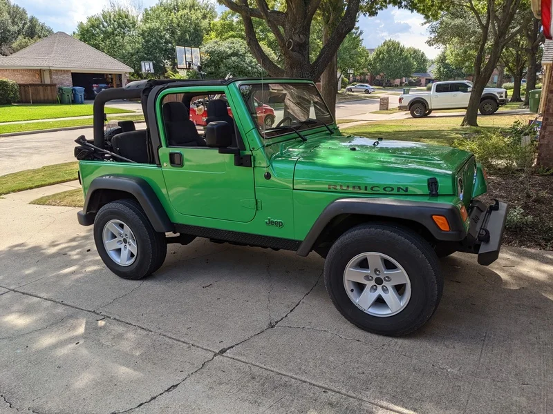

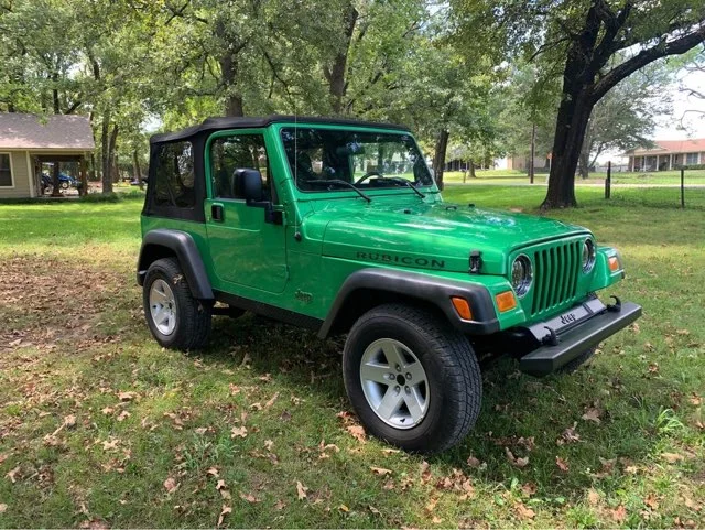

My wife and I brought home a 2004 Electric Lime Green Rubicon this week. This is my third Wrangler and second TJ.

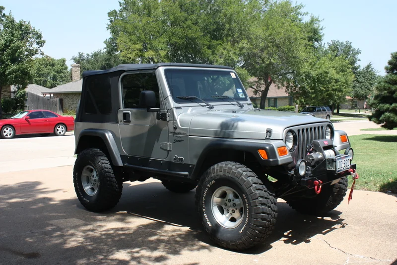

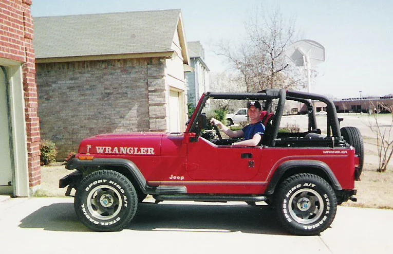

My first vehicle at 16 years old was a '92 YJ. 4 cyl, 5 speed, no lift and 31"s that rubbed everywhere. I was lucky to see 65 mph on the highway, downhill with a tailwind. My girlfriend LOVED it. Years later in college, I married her. The transmission didn't last long and we traded it in.

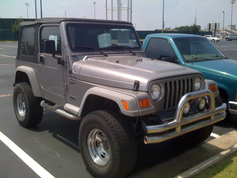

A few months after we married, she found a 2001 Sport in the high school parking lot. We brought it home and I got to work. Every bolt on choice the PO made was a mistake. I hate chrome. I hate tubes.
By the time I was "done", I had swapped in '03 Rubi axles, Rokmen TT, sliders, bumpers, SYE/CV, winch, JKS control arms, Currie hd steering, 35s, etc, etc. It was perfect. Whelp, as fate would have it, we had a kid early. I tried to convince myself I could keep it and run an infant carrier in the back, but I never felt right about it. What I should have done was buy a cheap, old - but safe - sedan and kept the Jeep. What I did instead as 20-something kid was sell it. In hindsight, there were other options, but I did what I thought was best for my family at the time, and I can't say I regret it. I do miss that Jeep terribly. Side note, its changed hands a few times over the years but I was able to track it down. Its in Tulsa now - V8 swap, atlas and has been stretched to an LJ.

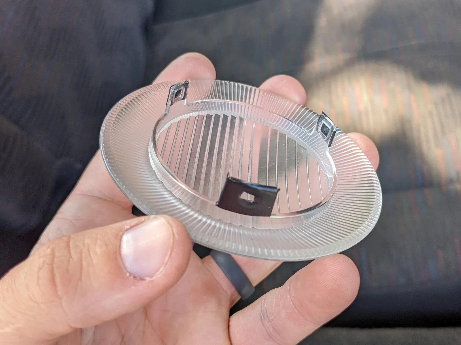

One of the rear speakers was buzzing. I assumed it was blown but after pulling the cover, it seemed fine. Turns out it was the dome light lens. A few well placed electrical tape strips and its quiet back there.

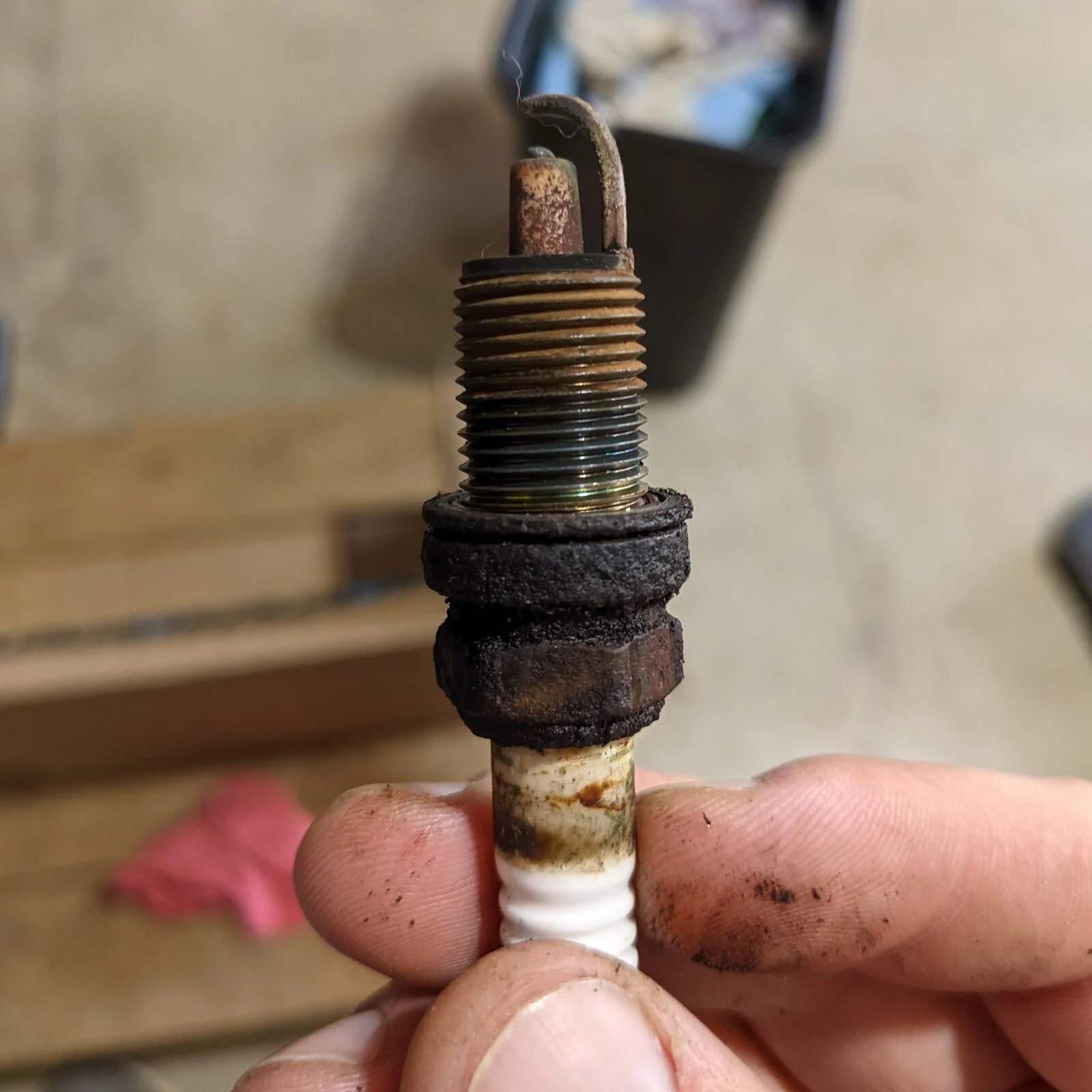

Got the spark plugs swapped. I had help from my oldest daughter. She's 12 and has really taken an interest in the Jeep and all the maintenance. Its been really fun to teach her about all the mechanical things going on under the hood.
The plugs were well worn. The rear most plug was coated in oil. Looks like the valve cover gasket has been added to the list.

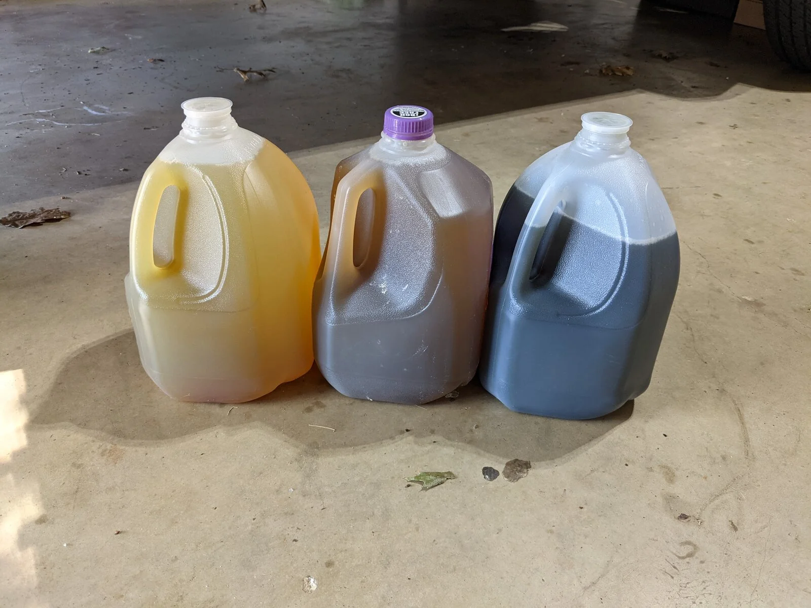

Flushed the Prestone cleaner coolant. The color was nasty. Refilled with Thermocure and will run it this week and I'm expecting it to be even worse. I attempted to clear up my coolant reservoir per @DuvelSteve but didn't quite get it clear. I'll try it again after flushing the Thermocure.

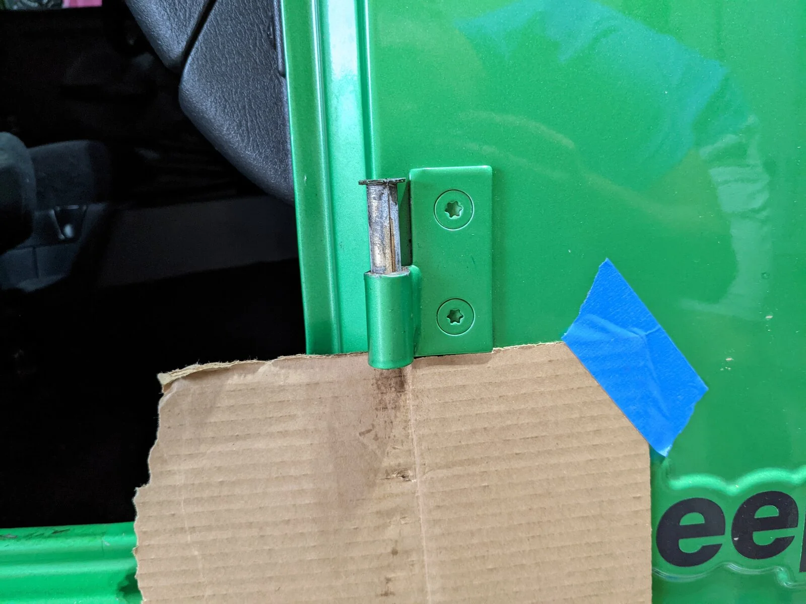

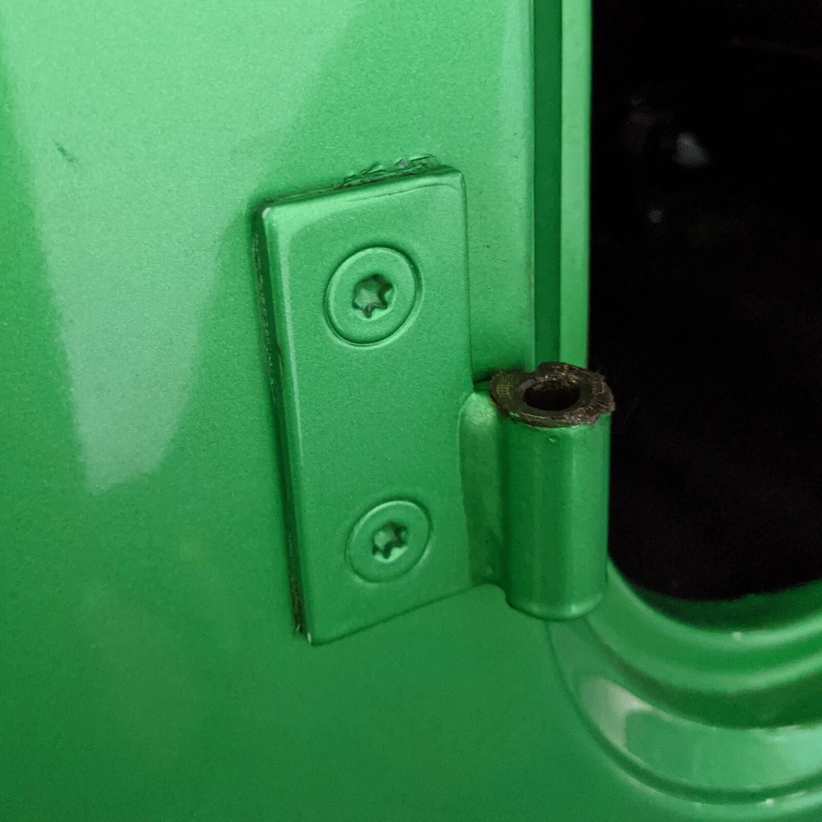

My doors, specifically the driver's side, were very hard to remove the first time i tried. The nuts were marked up like they had been removed, but the doors were stuck pretty good. It took a while, but I got them off without resorting to the jack method.
I ordered quadratec's replacement bushings and got around to installing them. The passenger side went off without a hitch. The kit is very complete and the instructions are excellent.
The lower hinge on the driver side door was another story. The kit comes with a punch tool that is machined to fit inside the bushing with a lip to drive it out. I started just as I had on the three others before. This time, instead of the bushing moving, the entire hinge started to rotate. This picture is after I rotated it back in place.
Not terribly worried about the paint. Should I tighten the torx bolts?
I didn't try again. The door went back on with no trouble. I guess three out of four isn't bad. :)

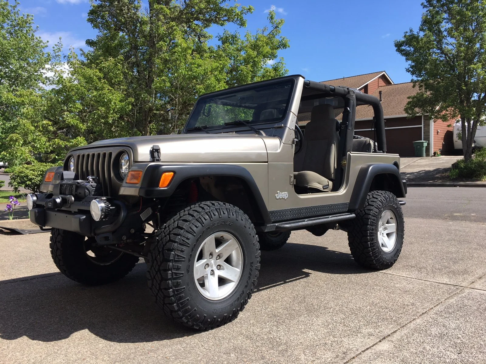

Probably the worst thing I did all weekend was read @Chris's build thread. I was all set on a 2.5" OME springs, a body lift and 33s. Now I'm looking at 3-4" SL, full set of arms and setting up for 35s down the road... Still not sure what I want to do here. This picture is just about where I want to be:
I think at this time, he was on 4" springs and .5" BL and 285s... hmmm.

Hey, I remember taking that picture! I think my wife was much happier then since she could get in-and-out of the Jeep without much fuss :LOL:
I bet. From the pace of your thread, it seems she only had a few minutes to enjoy it at this height, haha! :LOL:
I'm a believer in Thermocure.
Left to right in the order of application:
  • Existing coolant drain
  • Preston flush
  • Thermocure flush
I didn't get pictures but the view into the radiator was a gross brown before the Thermocure and after it was back to looking like metal and much more "normal". I highly recommend.

She actually likes it, I just think she’s more into exploring and going off the beaten path versus rock crawling. That’s fine though because I’ve found that I too am not as into rock crawling as some guys are.
