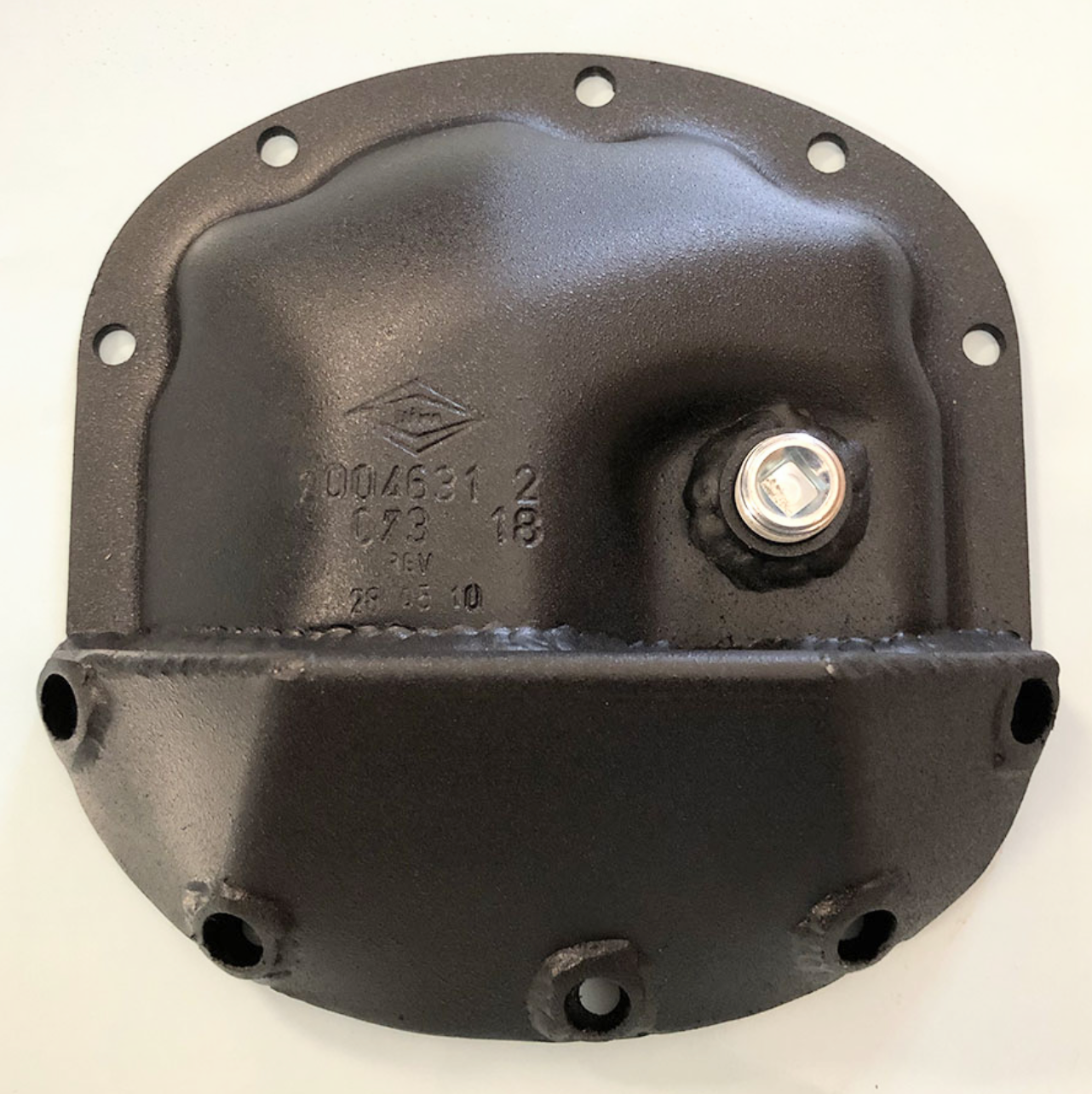

No problems with my Currie diff cover and I wheel it quite hard:
Note that this is not the Barnett design, it's a different Currie diff cover.
Reactions: hosejockey61

Looking at this pic, I don't think there would be an interference issue. It looks like the currie cover would be ideal.
