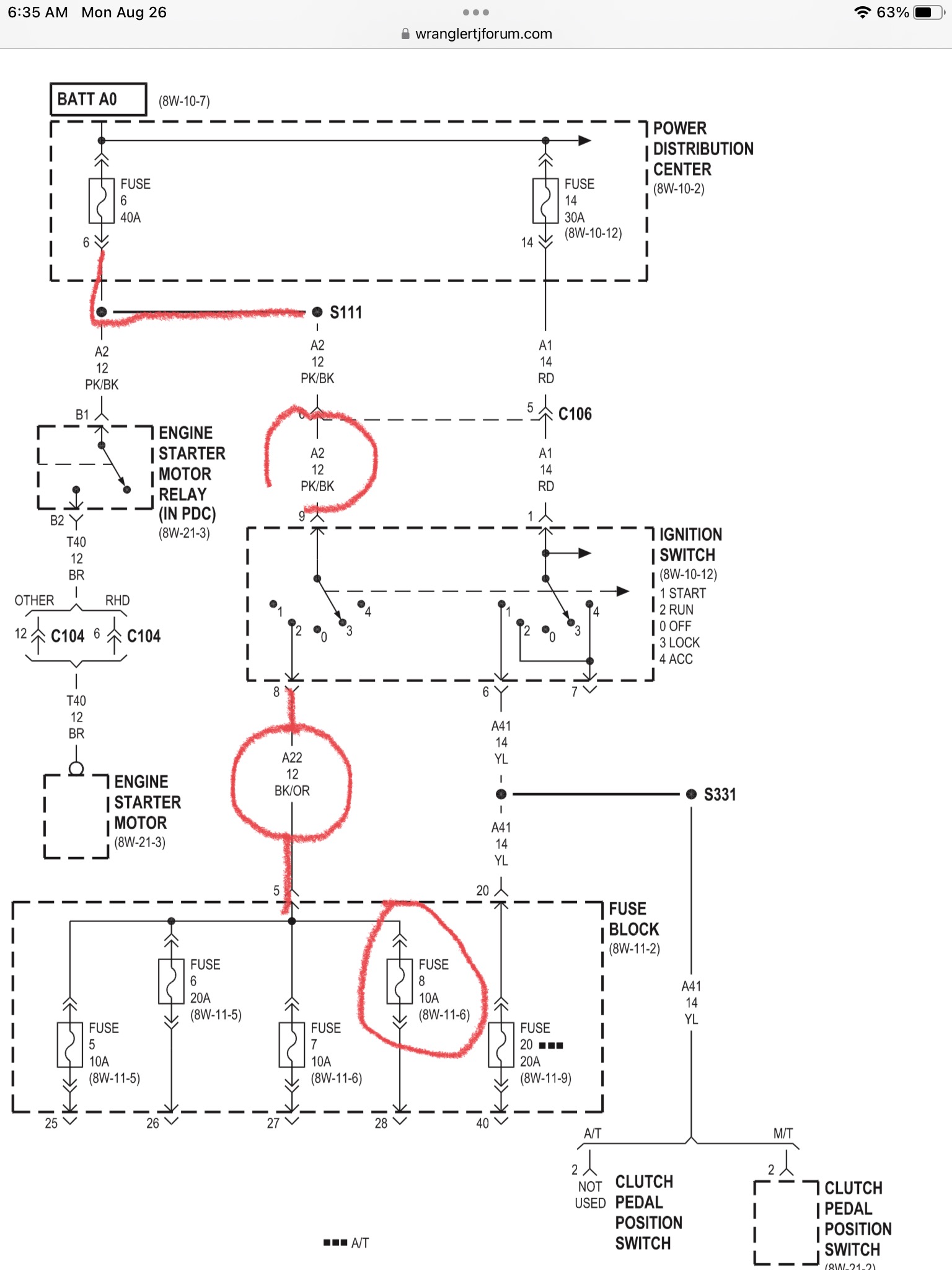

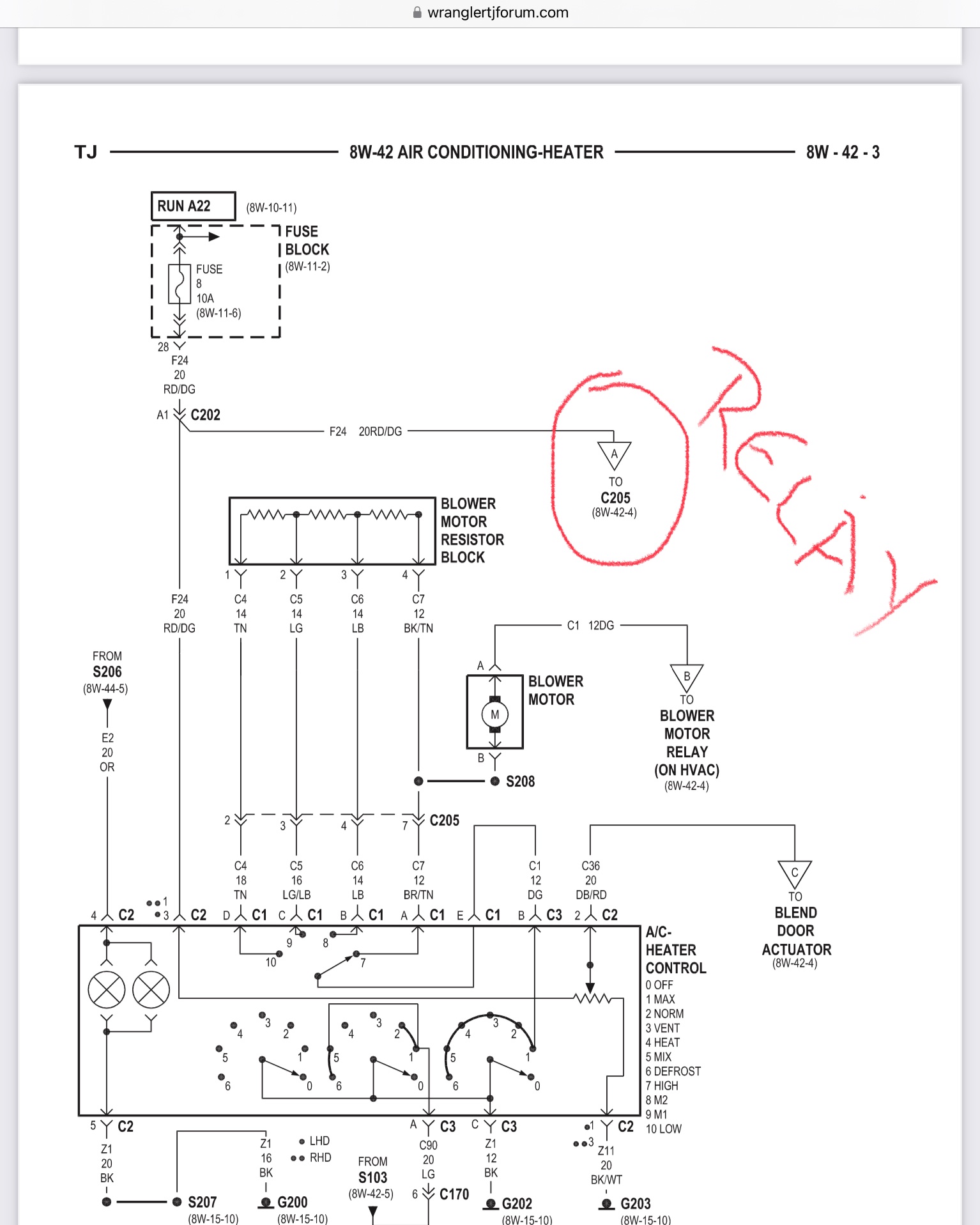

If you can get the blower motor to act up repeatedly, then check fuse #8 for voltage when the motor does not come on. If the fuse has no power, check for voltage at the ignition switch. Black/ orange wire pin #8 if it does not have power, check the input wire at the ignition switch connector pink/black pin 9 at the ignition switch. If pin 9 has power but #8 does not it would be the ignition switch or the actuator that turns the switch. ( it may not be turning all the way) check the electrical plug for melting.
