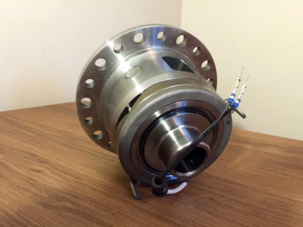

So while my front axle build was delayed by a cracked cylinder head, wife’s cancer, and a general lack of funds, I have finally completed it! So, my newly revived Reverse Cut Dana 30 consists of 4.88 gears, an Eaton E-Locker, Spicer 5-760x U-Joints (with full circle snap rings), Currie Front Housing Johnny Joint Kit, Currie Lower Control Arm Mini Skids, and the Vanco 16” Big Brake Kit with Black Magic Pads! The rotors from the Vanco kit are huge! Too bad my current wheels are only 15”. So I’ll wait…

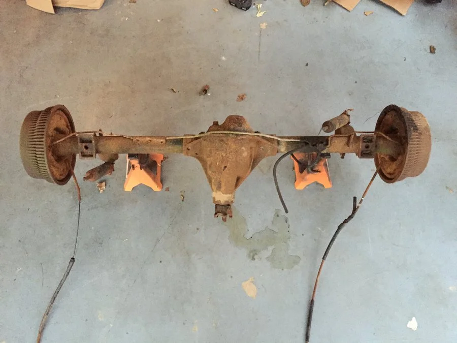

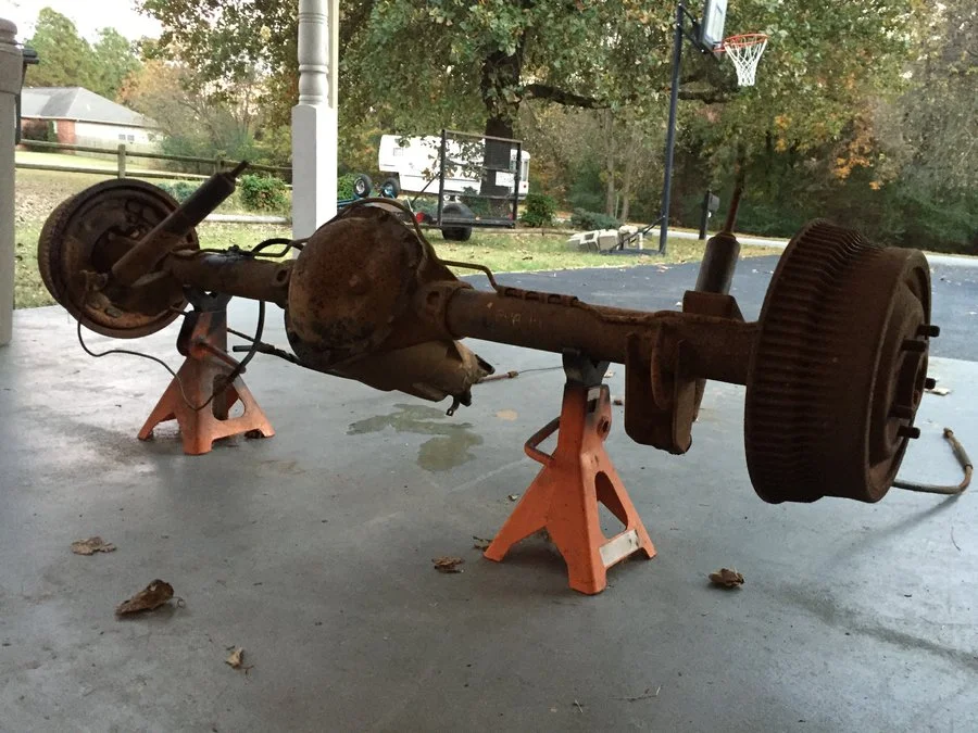

After contemplating several rear axle plans, I finally settled. My three most viable plans included;
• Keep my factory Dana 44
• Build the tried and true Ford 8.8
• Build a XJ Dana 44
I chose the XJ 44!

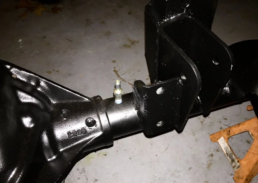

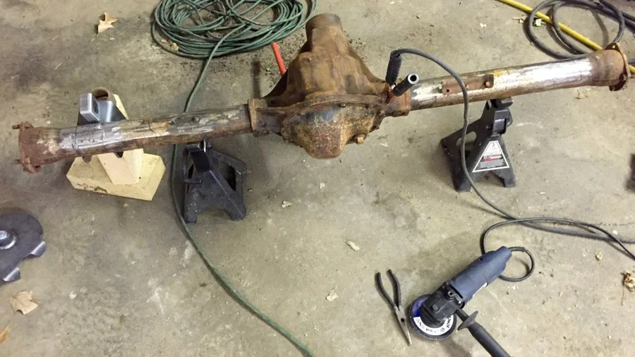

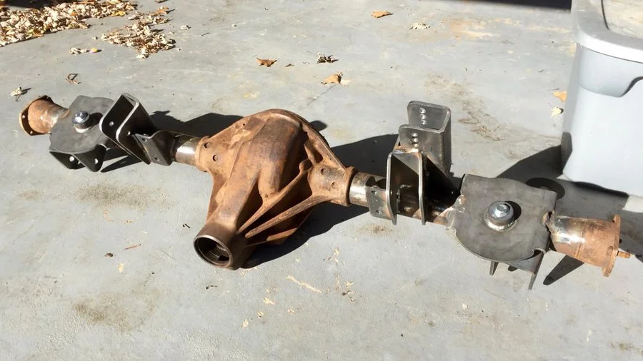

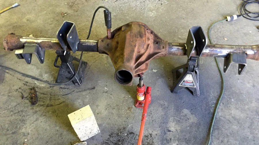

I installed my ECGS Brackets on my XJ Dana 44. The bracket kit is really beefy, but it did not include installation instructions. I was successfully able to adapt the instructions for a similar bracket kit designed for the Ford 8.8, and the installation was relatively easy. My welds aren't beautiful, but I think they will do the trick. Everything is set up for a pinion angle of 17°. I know it's not ideal, but I went ahead and stuck the shock mounts on. The mounts in the ECGS kit were nice but the mounts from my TNT Customs Rear Shock Mounts were a bit wider, so I can add misalignment spacers if my shocks are narrower. Next steps; sandblast, prime and paint.
I rattle canned my axle black and I drilled and tapped the axle for the axle vent.
