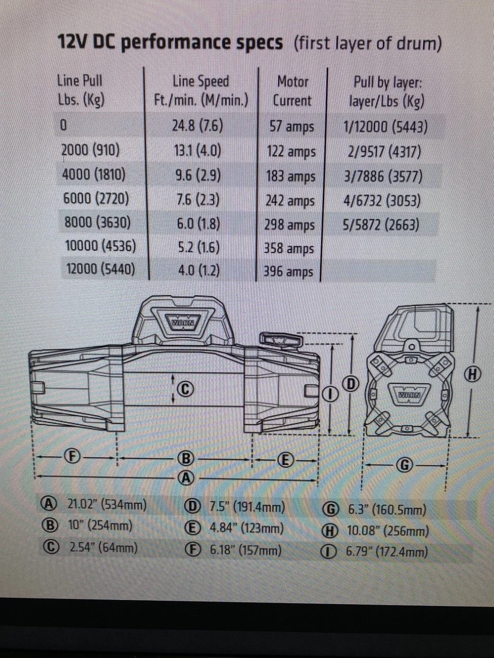

  1. is it typical to see a 25% drop in pull strength on the outer wraps- not one rally got above 9000lbs

1. All DC electric winches will see a decrease in output for each subsequent layer of rope as it changes the overall effective mechanical ratio of the winch. Now higher geared winches with big motors will have less effect but it is still there. I have found that typically for a majority of full size winches that equals out to about 8% per layer. You can see that Warn actually publishes that in their performance specs that and that they only rate the fifth layer for 5872 lbs.
