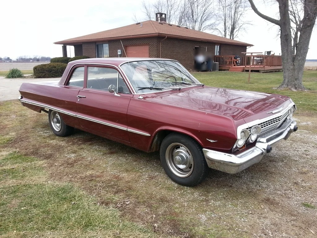

I like my TJ and all but, there ain't no way I am trading away a 63 Bel Air unless it was some non-salvageable POS. And yea, need some current pics :D
The Bel Air wasn't bad, but it woulda taken fat money to get it where I would have wanted it. 283 PG, an interior like a french cat house, manual everything, bad paint and wiring like spaghetti. I kinda inherited it. Plus, I've got an uncool Chevelle that I dearly love so the 63 was a dust collector.

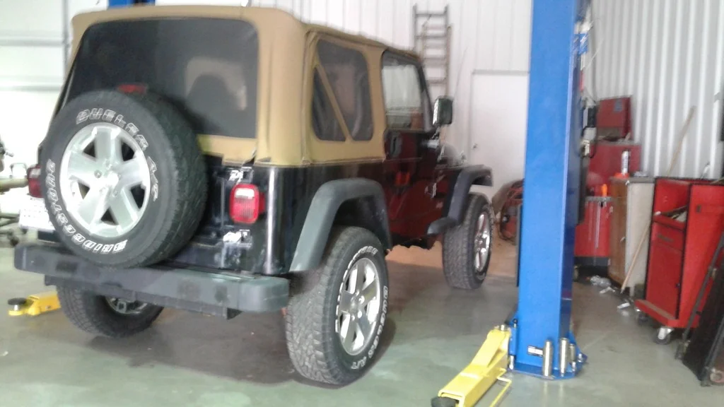

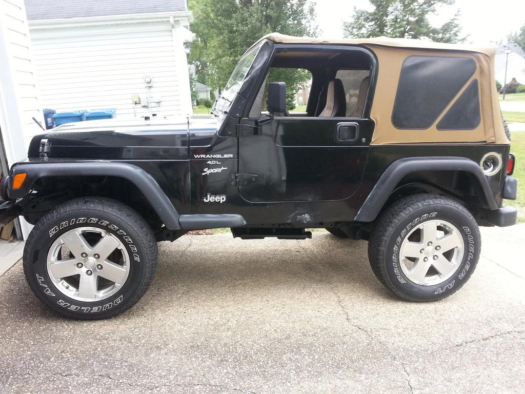

After the wheels were replaced with the CL specials. It looks silly, but my plan is to drop it back to stock height. Note the rust bubbles on the rocker. I hit that with a hammer and now it's a hole. there and the upper part of the fenders are really bad, the rest is good. The thing even rusts cantankerously. :

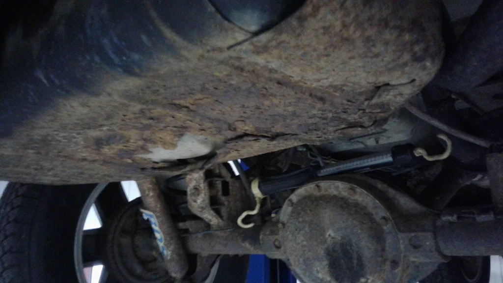

Gas tank skid:
If you can see, it is rusty which explains its nasty disposition. But it's weird. What's rusty is REALLY rusty, but most of the frame and tub are good. Bizarre. And that shock. How does a shock rust that bad but keep the sticker?

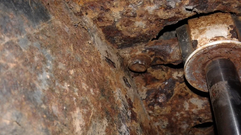

Here's what we are dealing with. This is the drivers side rear shock mount:
Of course it broke off. half the bolts we tried to take off broke or rounded off, even the ones that don't look this bad. This was by far the worst. The aftermarket shocks have rusted so badly that they can barely be Identified. The springs are worse.
Once we got that out, they mounting area cleaned up well and easily with a wire brush. But it took us most of a Saturday just to remove the rear shocks and drill out the bolts. The same thing happened yesterday when we tried to remove the front track bar. What a lot of this looks like is the parts used to replace factory stuff over the years seems to have rusted much quicker. And Jackass continues to make life hard for us. It snaps at us all the time. My buddy has been a pro mechanic since he was 15 working in his dad's shop. He has hit his hand twice with a hammer, had a socket fly off and crack him in the noggin and busted his knuckles 3 or four times. I've made three runs to the first aid kit for gauze and band aids, cracked my head on the rear drum and had a nice hot piece of steel go down my shirt prompting an apparently entertaining hoppy dance around the shop floor.

The 18s are probably a temporary measure. I have a set of TJ 15 Canyons for it, but I do dig the look of the 18s on a factory height TJ.

Oh yeah, not feeling the 18" wheels at all. I would personally put 15" wheels on it with a bigger tire. That's just my preference though.

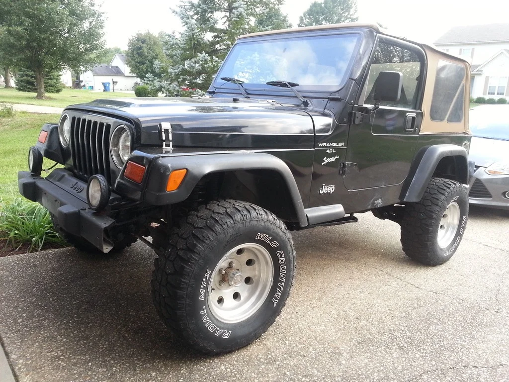

Speaking of the 15s, here is my old 4 banger. I love this look with the canyons and those tires.
