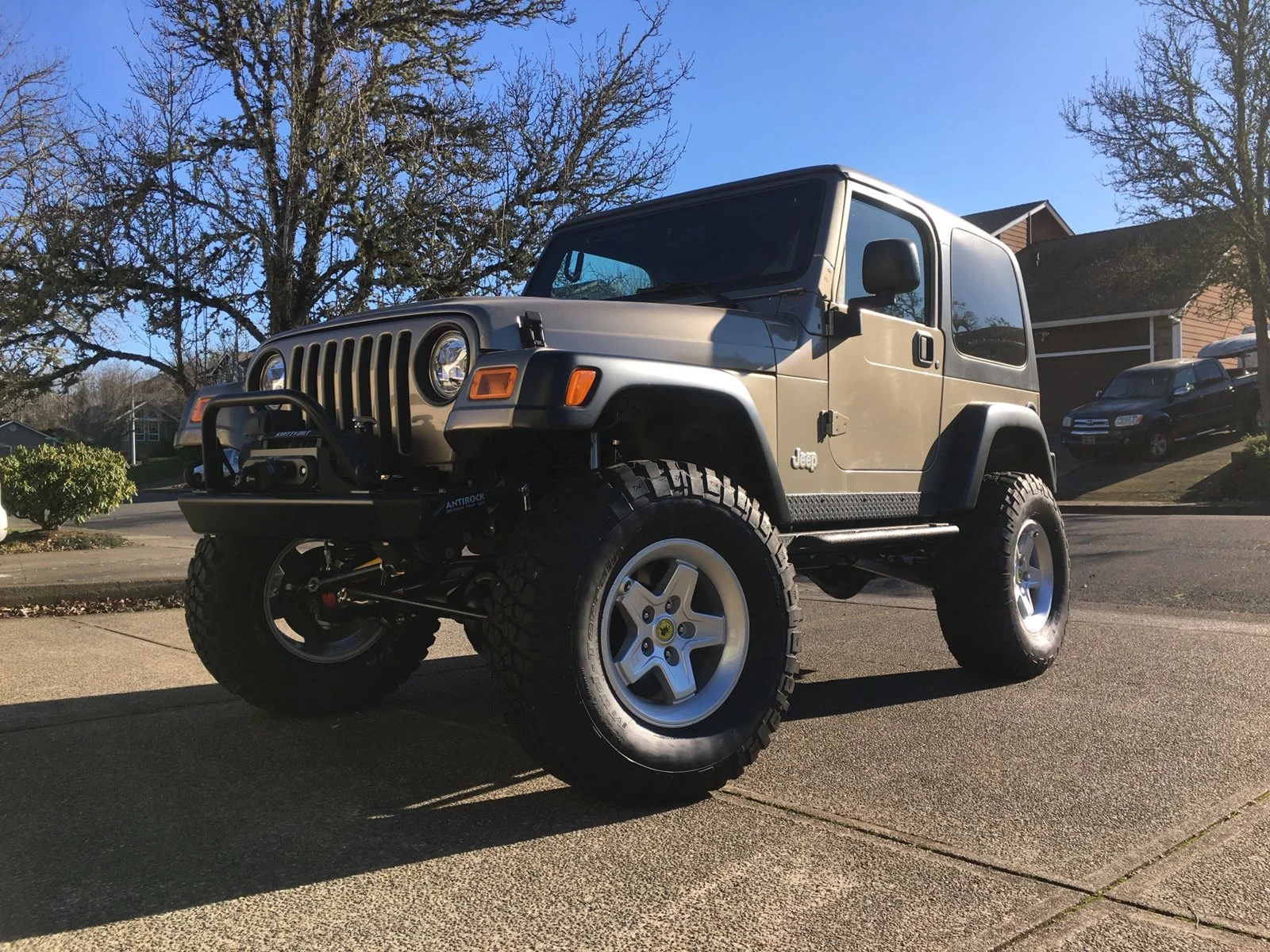

You'll find a number of progress photos scattered throughout this thread, But the most current photos of my TJ can be seen below:

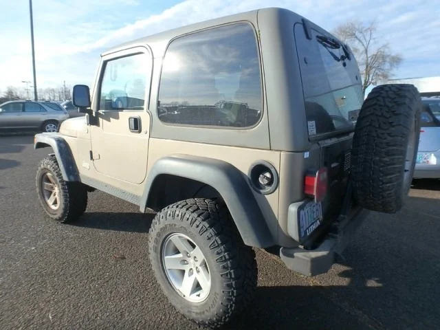

Where is a picture of this said Jeep that is going to be built? You know the rule!
You guys kill me! Wait until it gets back from being painted and I'll give you the before pic. I was told either this week or next week, so we shall see!
Starrs
TJ Expert
Aug 1, 2017
4,250
Indiana, United States
1 pic will kill you won't it lol. Hell I posted mine up when it had chrome nerf bars hahah no lift, factory original tires, and 12 years of dirt and grime on it that I had to claybar off. Post it up! Lol
OP
Chris
Chris
Administrator
Staff Member
Sep 28, 2015
37,933
Salem, Oregon
Come on Chris.....don't break the sacred rule ..... lead by example. I know you have at least one picture of it before you sent it off to be painted.
I actually don't. I'm looking for the photos the owner sent me before I came to look at it, but apparently they aren't stored in my iMessage archive like I thought they were.
