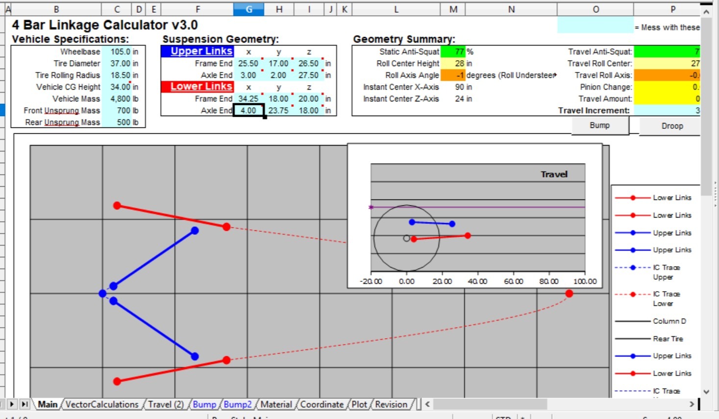

Here's one of the reasons why you run separation at the frame.
The first one is basically what I ended up using on my last Jeep.
Notice the static Anti-Squat (green box) My upper links were adjustable so I could change it.

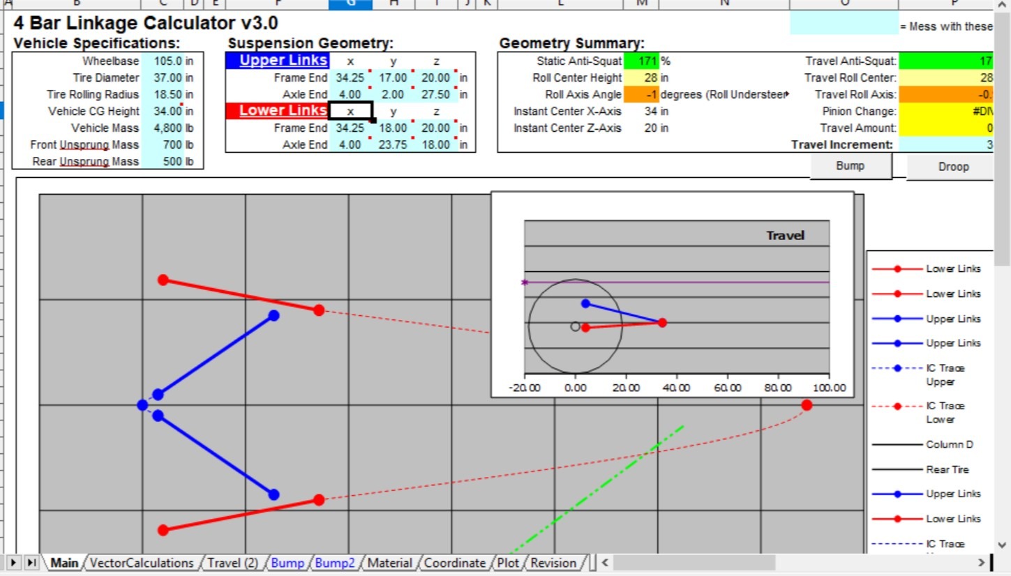

This is what happens when the frame side upper and lower links are at the same height. I realize this is a single triangulated 4 link (unlike RC that uses a 4 link plus panhard) but the anti-squat changes will be similar.
Wow, that's quite a big difference! I see what you mean.
I'd asked him about playing around with numbers on these computer programs to be able to find the perfect numbers for a lift. He said he used to do that, but it ends up just being a waste of time and he doesn't do it anymore.
Who knows... I can barely keep up with him when chatting with him he has so much information his brain!

The link calculators are a good starting point and help show the way the IC and AS change with different mount locations. But everything changes when the Jeep is no longer sitting still on flat ground.
At the risk of equating the two, neither the Savvy nor JW kits were designed with the calculators. Both are the results of real world testing and refinements over many years by people who understand how a Jeep behaves under dynamic conditions, not just on a fancy spreadsheet.
To play devil's advocate some more, the differences between the spreadsheet and what actually happens while climbing a waterfall might be why the RC long arm might not be doing what the spreadsheet says it should be doing. There is much more going on. But that is not to say it is a good kit to consider.
Yeah, I don't think Dave was saying he would consider running the RC long arm, he was just saying that it actually performs a lot better than you'd think, especially a company that builds some pretty questionable products otherwise.
And he was saying exactly what you are. He doesn't care much about the calculators, because he's built his (just like Savvy has with theirs) around real world wheeling, which is going to produce a lot different results than you can plug into a program. He said he still pays attention to his numbers, but he doesn't focus on those like it's the end-all-be-all.

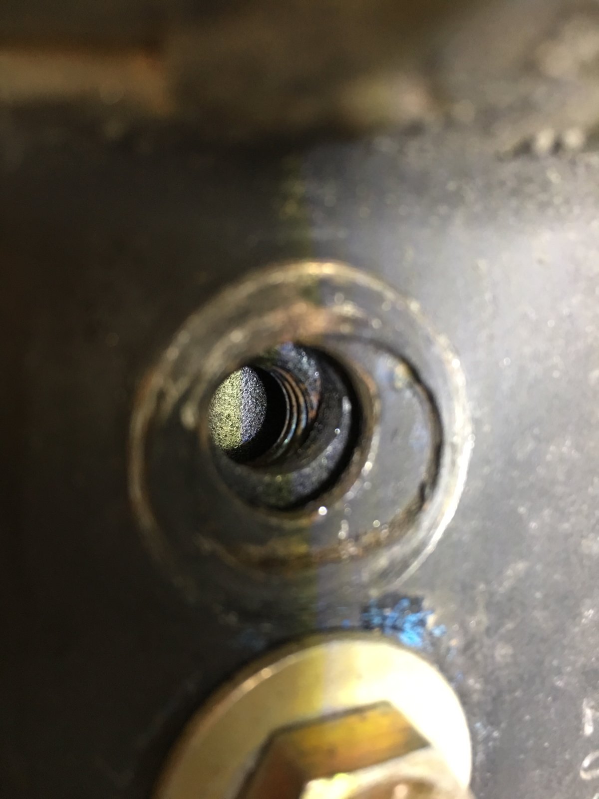

Okay, so I had a chance to install my Antirock today, as well as my JCR front and rear bumpers... well kind of.
So, I start bolting up the rear bumper and get all the bolts in except one. For the life of me, it won't thread into the hole.
Then I took a flashlight and shined it in there to see what was going on, this is what I see:
On the inside of the bumper they have a bolt that has been welded to the bumper so that when you put the bolt through on the frame side, it will thread into that bolt.
The bolt was welded so far off center, that there is no way to even start the thread on this bolt! What I think I'm going to have to do is take the bumper off tomorrow and use my Dremel tool to open up the 1/8" steel on the bumper so that the bolt will go all the way through and catch the thread.
Given that I paid almost $1200 for these bumpers, would you guys be mad about this? Mad enough to complain to JCR? Or should I just fix it and keep my mouth shut.
It would be one thing if this was a cheap bumper, but with the price they are charging, in my mind, there shouldn't be errors like this.
