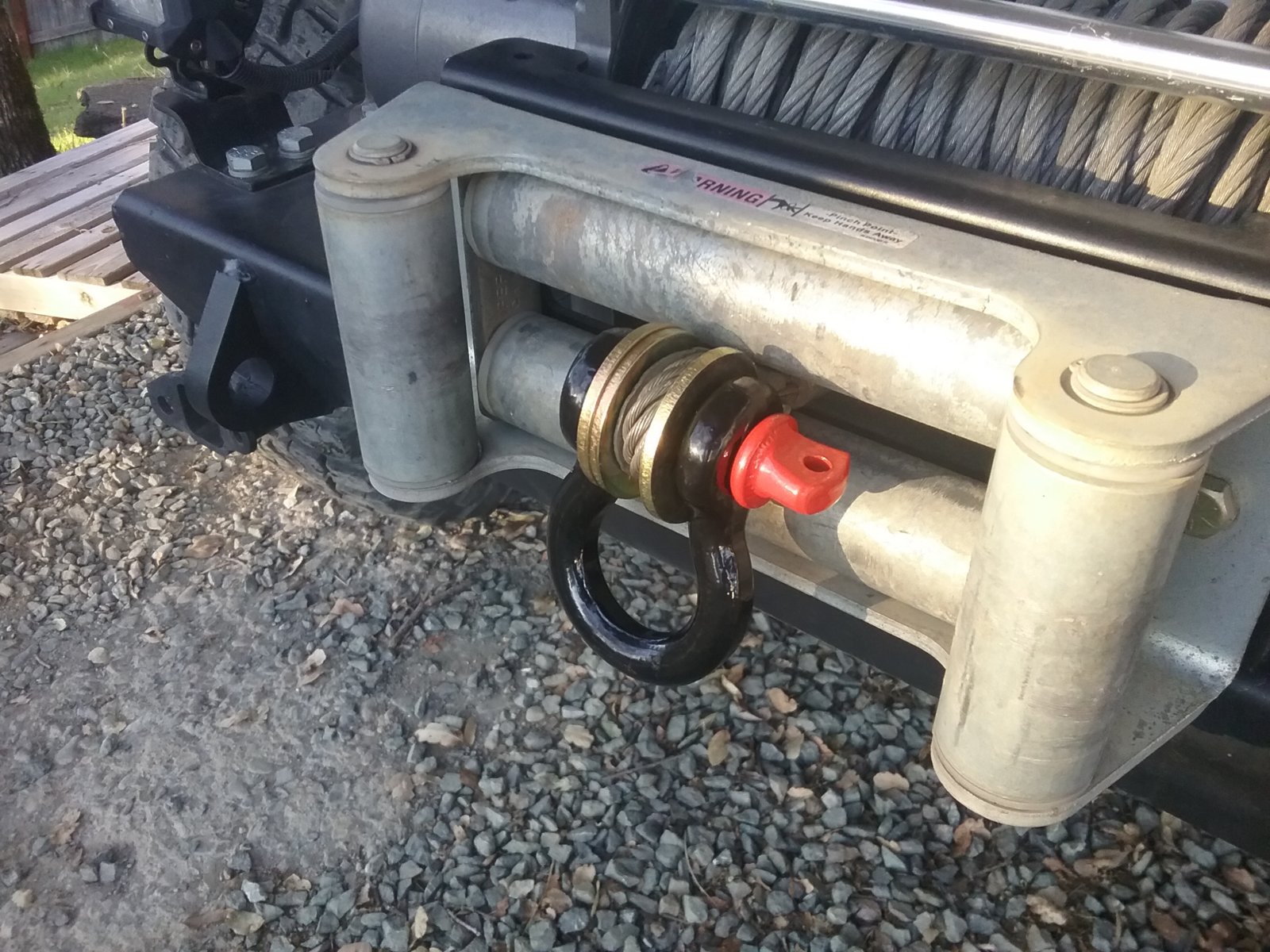

Excuses my ignorance but why do you feel that thimbles don't add value? Or is it the particular brand?
I think it is the brand. From what I can tell, the factor 55 thimbles have some poor design features that cause them to be less useful and more dangerous. The older factor 55 design was even worse.
I just received my TRE rope a few days ago so I’m looking to learn more about thimbles. Hopefully @mrblaine can help out with that.

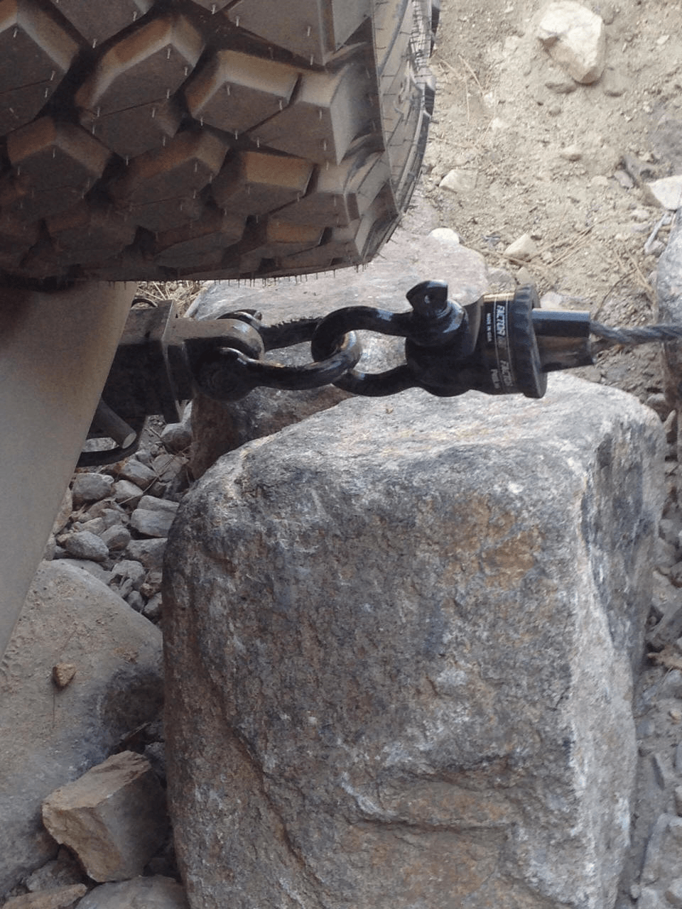

If you want to use a snatch block with that "thimble" and hook back to your bumper, how do you do it? (thimble is in quotes because it isn't a thimble, it is a hookless hook and attached to the rope via some method other than a thimble. In fact, a thimble is used to attach it to the rope with a pin just like a normal hook)
The eye won't fit over a recovery hook so you have to add another connection. Just to do a snatch to vehicle 3 connections, with a thimble, you have 1. If you want to do a pull on another vehicle that has shackle tabs, you get this-
If you look at that and think any of that is a good idea, there's some learning that needs to happen.

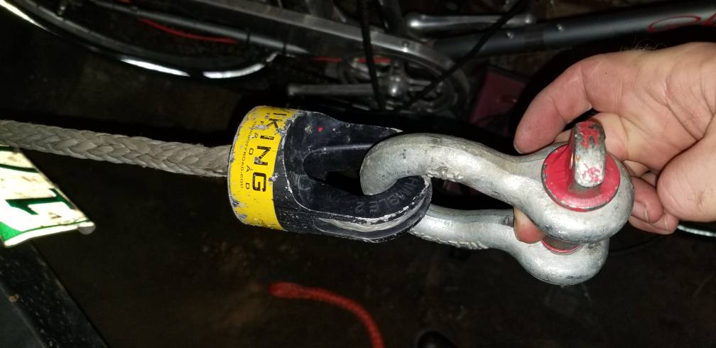

How would you do this same attachment with a true safety thimble?
I'm not doubting, I'm actually genuinely curious.
First start with eliminating the F55 thing. Keep looking for ways to eliminate connections.
With a Safety Thimble, I see see at least two things that don't need to be there.

Correct me if I'm wrong, but if there was a safety thimble there, could you just use a soft shackle in place of the two shackles in that photo (I don't want to use D-ring, since I know that's not the correct term)?

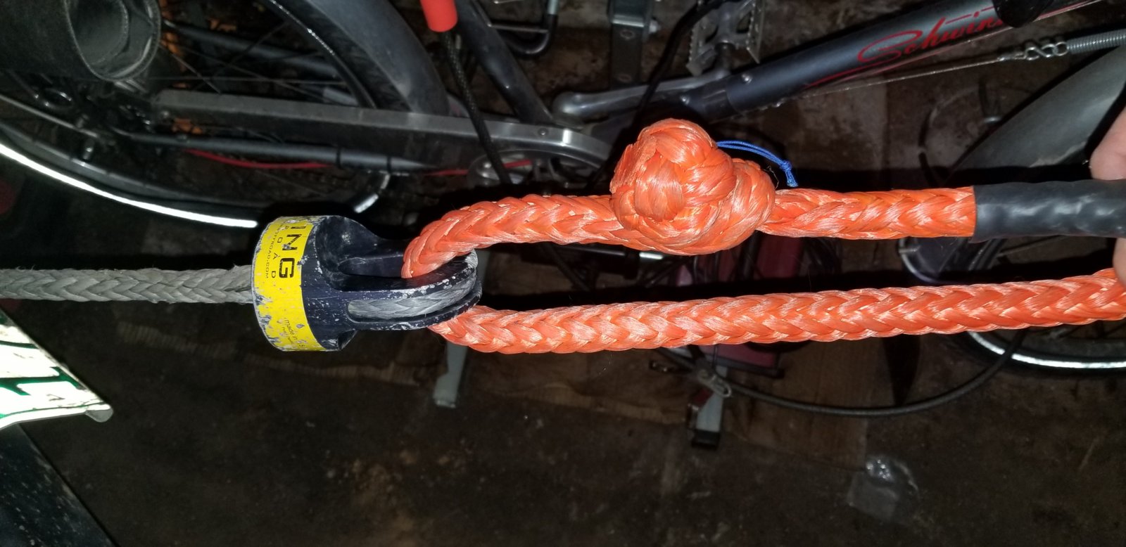

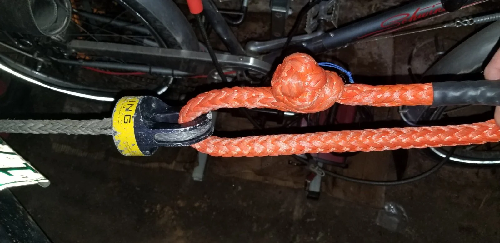

Here are a couple ways to reduce connections and also reduce the weight of the thing hitting you in the face.

Here are a couple ways to reduce connections and also reduce the weight of the thing hitting you in the face.View attachment 71487View attachment 71488
Okay, so this is exactly like what I was thinking.
But since I've never actually used this Factor 55 Pro Link, what I am gathering is that the eyelet on it is too small to fit a typical shackle through it?
Like I said, I got it for free and have yet to test it out, hence the confusion.

The Factor 55 isn't a THimble. A Thimble on rope is what keep the eye shape and keep from getting pinched. The Factor 55 stuff keeps the factory rope thimble in the rope pic above.
The Safety Thimble replaces that and is an actual Thimble, plus you can stick the shackle eye through the Safety Thimble, meaning 2 connections instead of 4. All the Factor 55 is above is a fancy rope stop for your fairlead.

Well Blaine is right (obviously). I went out to the garage and tried to put the Factor55 Pro Link around the hook on the Savvy bumper and it won’t fit.
So this is basically a useless POS. Good thing I got it for free.
Guess I need to hurry up and get a real safety thimble.

I would pull the "receiver to shackle adapter thing" out and put a soft shackle through the safety thimble and around the pin in the receiver. What I've found is that almost every winching scenario I've been in can be rigged up with just a soft shackle or a soft shackle and a tree saver (keep in mind that I'm not wheeling super hard like Blaine). I'm in the process of ditching all the heavy warn snatch blocks and shackles I have in favor of aluminum snatch blocks and soft shackles.
