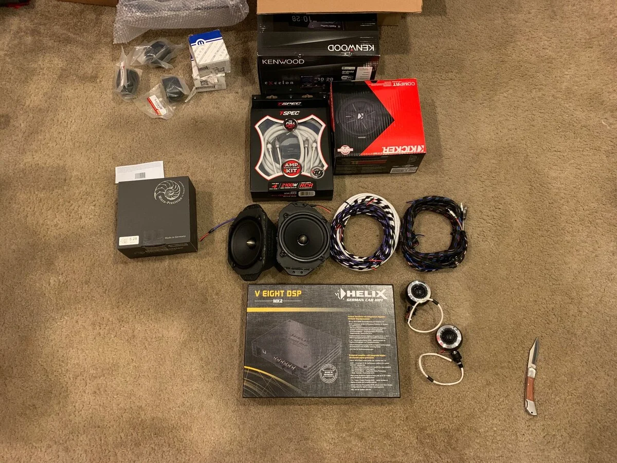

They are all very neatly labeled, so I think that should be easy enough.
One thing he didn't include and I'll have to source on my own is automotive grade wiring connector plugs for the wires to plug into the speakers. Any recommendations on this?
Oh, I see that in the tweeters, what about the actual amp wires, did they have any connectors.

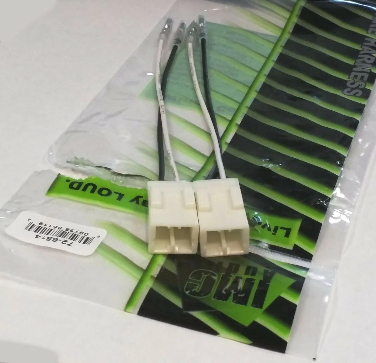

From the look of your pile of stuff it looks like you will be re-wiring the speakers... is that right? If I'm mistaken then if you are using the existing wiring in the sound bar these are what you need.
METRA 72-6514
I had to use a jewelers screw driver to open the clips up a little to get them to slide on the BLAM speakers. They clip into the existing plugs. But if you're rewiring from scratch then you probably would just solder new clips on the end of the wires.
METRA 72-6514

Sorry if I missed this in an earlier post but who did you get all this stuff thru? Those speaker pods for the front LOOK KILLER and would be nice in mine. I have some of the TJ style rollbar pods that I added years ago but they need to be remounted as I did a crappy job last time. I think they have Infinity speakers in them.
That whole setup looks great. Now get busy...... Don't forget to hydrate... :D
I got it through Don Amann at Unexpected Creations. He's very well known across many automotive forums, and is an audio guru.
Obviously this is a very expensive setup, but I'm very big on music and good quality sound, so to me it's worth the splurge.
