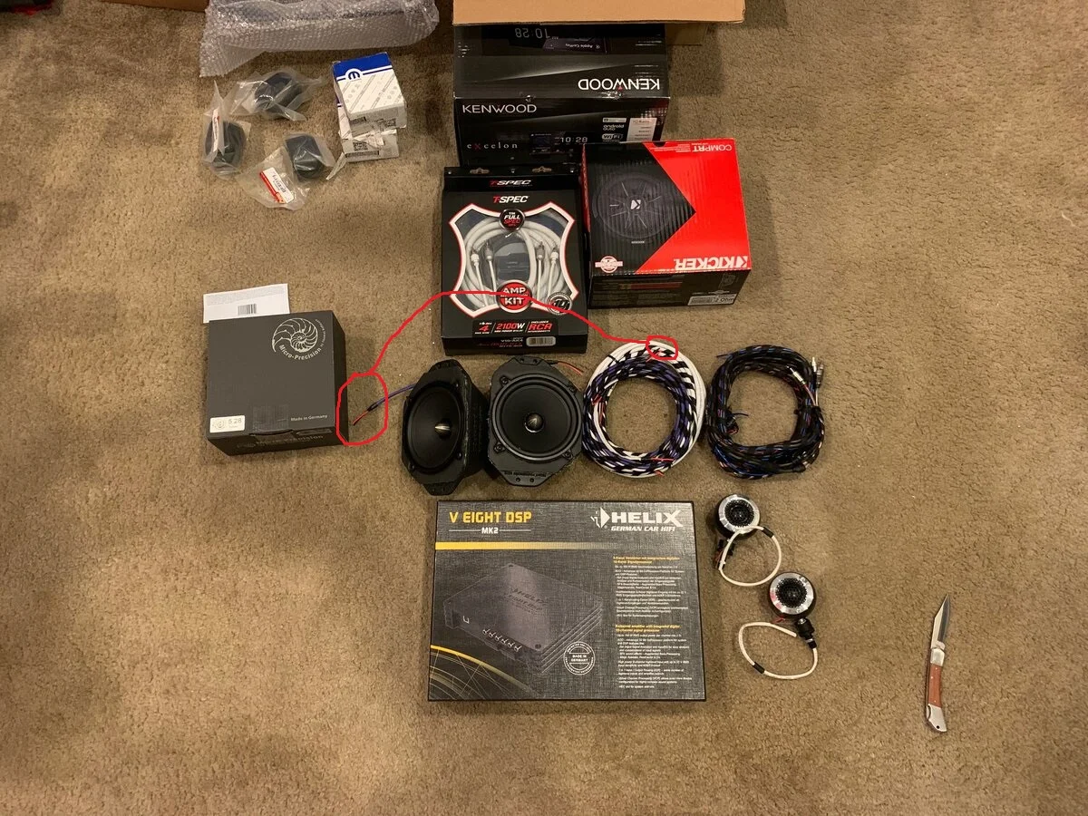

With regards to the quick disconnect connectors you posted, while the disconnects easily attach, you would only need the heads and connect your current wires that Don provided to them. I get you like that clean look, so consider just buying the heads instead of having multiple connecting points, both male and female heads.
This is an example that i super quickly found...not recommending these.

You are trying to connect these two wires, buy introducing two new wires that are already attached to a male and female head. You could just attach a male head to one wire and then a female head to other the wires, in the circles, and connect. The 5.25" speakers and 1" tweeters already have a pigtail, without the harness, so you are connecting an entire pigtail instead of the missing harness.
What do the 6.5" speakers look like, and the 6.75" kicker, do those have pigtails on them, that Don would have provided? Any pics of them out of the box?
No pigtails on the 6.5" speakers or on the Kicker either. Looks like he didn't do those ones.
The 6.5" definitely need them, so those connectors you posted would be perfect for those.
For the Kicker, I would just run one wire from the amp to the Kicker without a quick disconnect.
Yeah, the Kicker will be easy, as that's what I'd intended to do with it.
