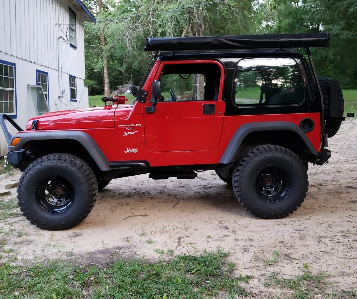

Decided it was time to document everything i do to the Jeep from here on out into this Forum.
The goal is simple, a daily driving rig that is outfitted to carry all my camping gear, kayaks, and fishing gear for 2-5 day trips year round while taking all of the scenic and off grid routes i can manage to find. I've owned this Jeep for almost 4 years now and this is what i've decided to dedicate it to.
So this is where i'm at:
-1999 Sport with a 4.0/AX-15.
-231K miles.
-Front LP Dana 30/Open. Rear Ford 8.8/Open.
3.5" lift, Core 4x4 Adj. Arms.
33x12.50x15 Cooper Evolution MT's
This will be a slow process, but i plan on solving some challenging issues. There are things i plan on changing along the way that i dont like about the Jeep like the Hi-Lift location, front bumper choice, lack of winch, etc. I'll be treating this like it's day 1 of owning the Jeep, and change things how i see fit and document it for everyone here.

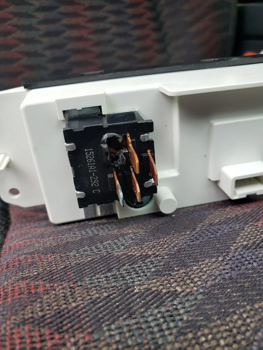

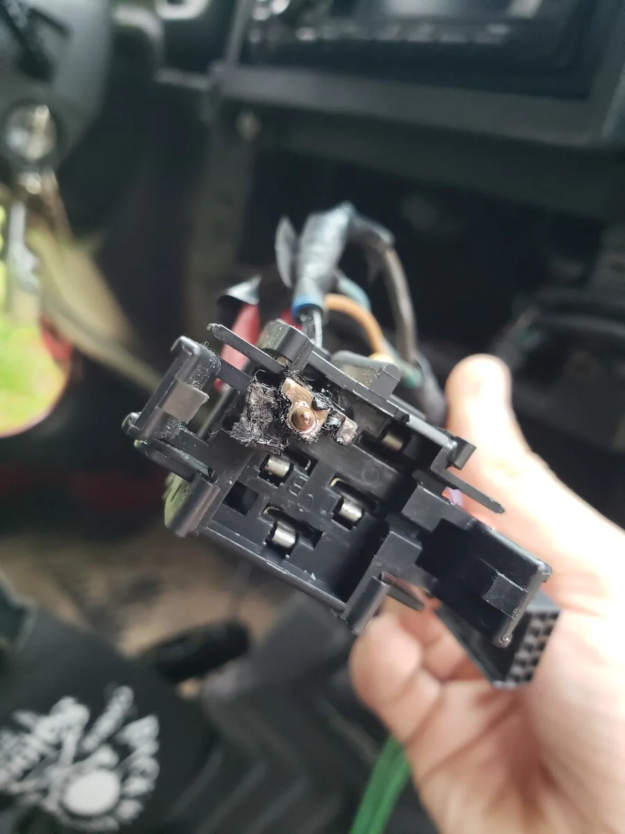

The A/C stopped working in the Jeep today. I believe the blower motor has worn out brushes that causes to big of a power draw, blowing resistors and melting plugs, burning wires. The fan speed selector plug on the Jeep's wiring harness has seen it's last day. I suppose my list has a new #1 priority. New blower motor, new resistor, new control panel, and new wiring. Anyone have any knowledge on where i can find the plug and witing harness repair kit?
Reactions: TJ Starting
Almost have all of the parts for the A/C repair. Went ahead and installed the new blower motor, a new resistor, and clean up all of the wiring issues. Just waiting on the control panel and i'll no longer be sweating my ass off everyday and can continue on to upgrades that i actually want to do! All in time.
