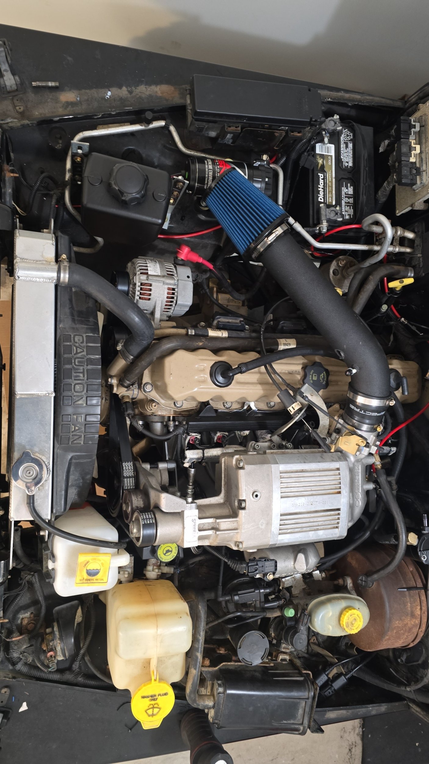

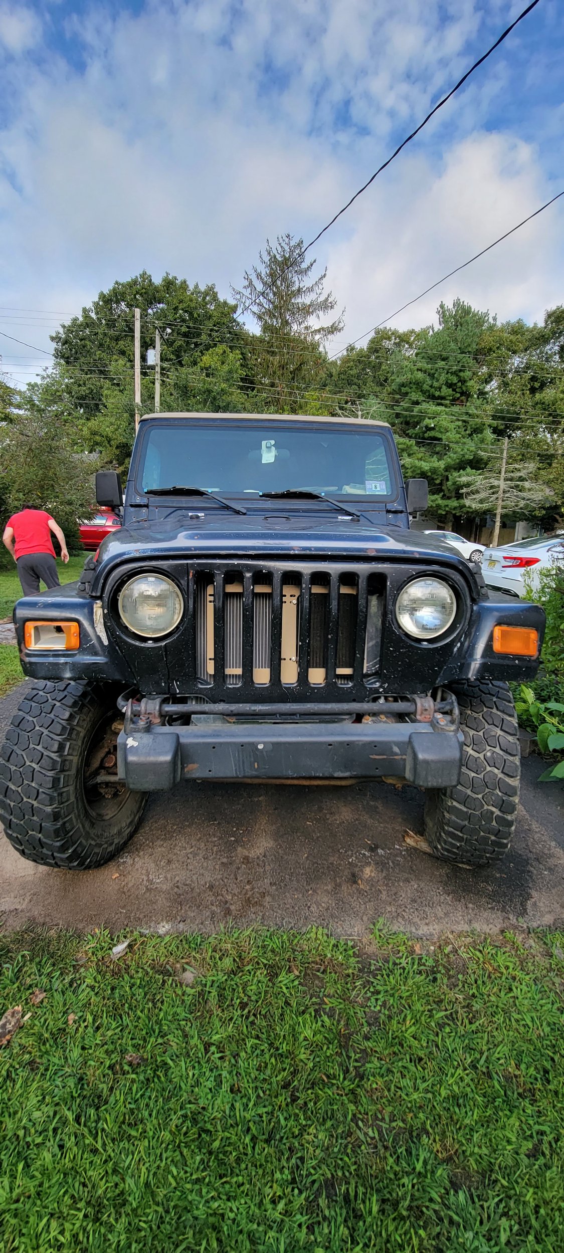

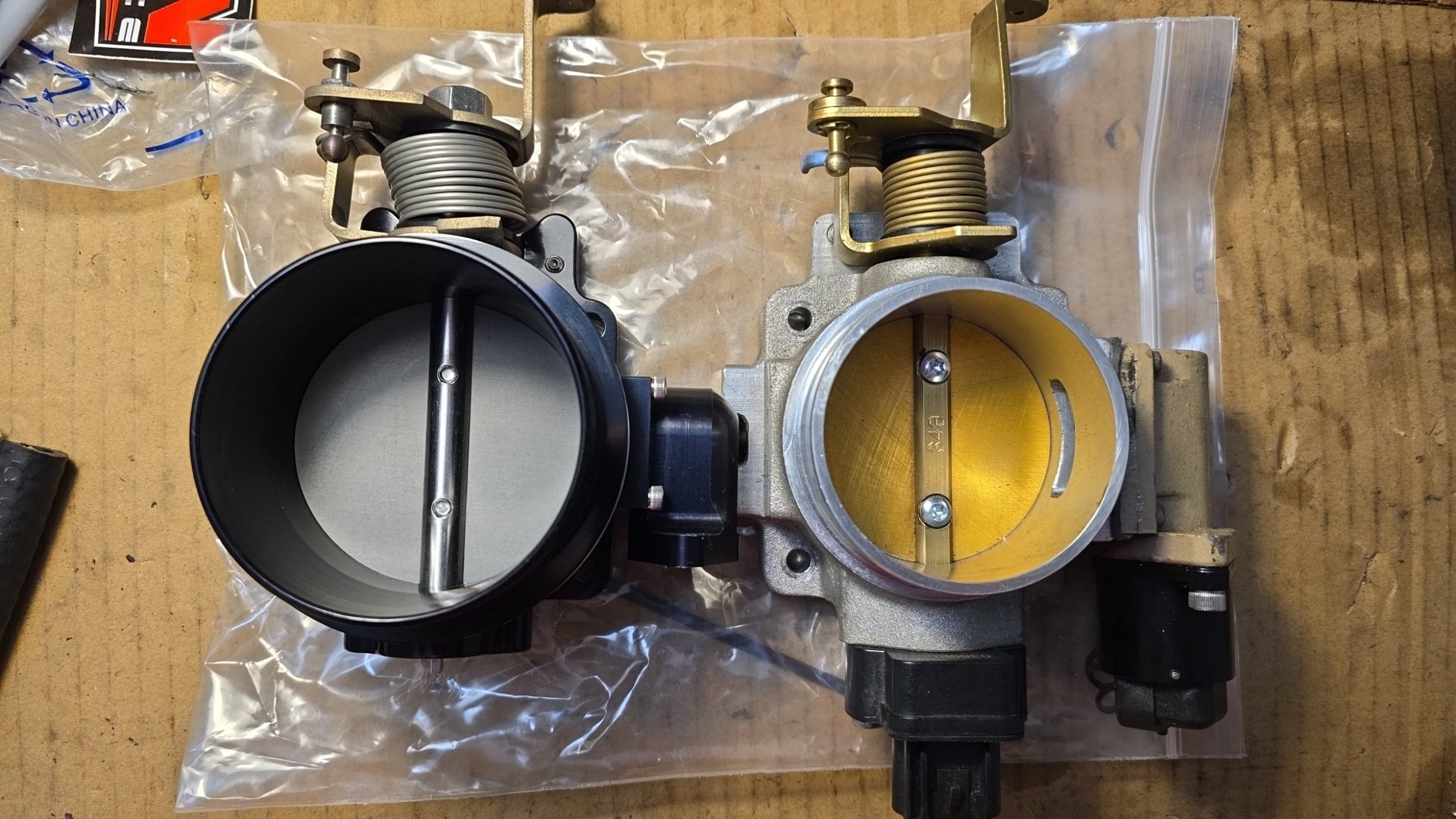

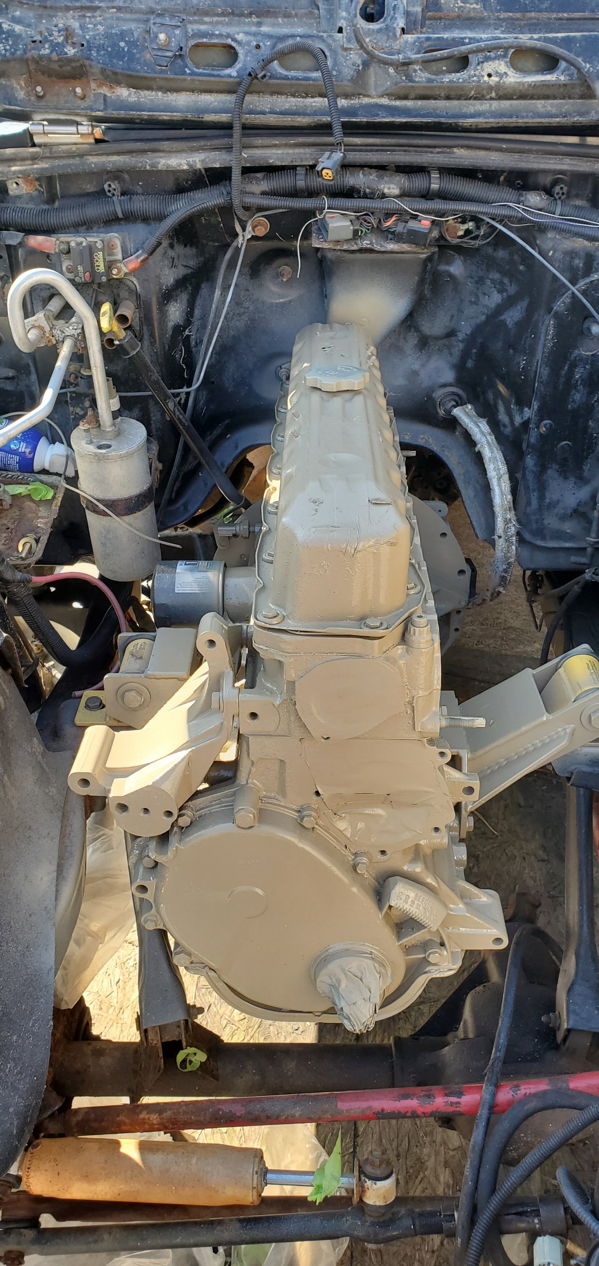

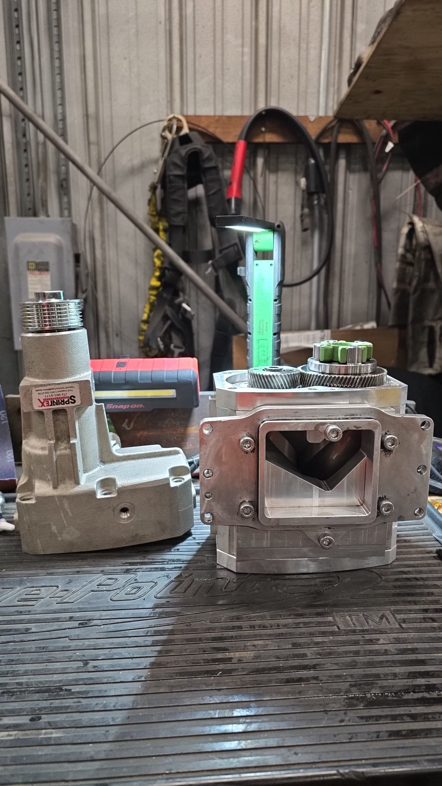

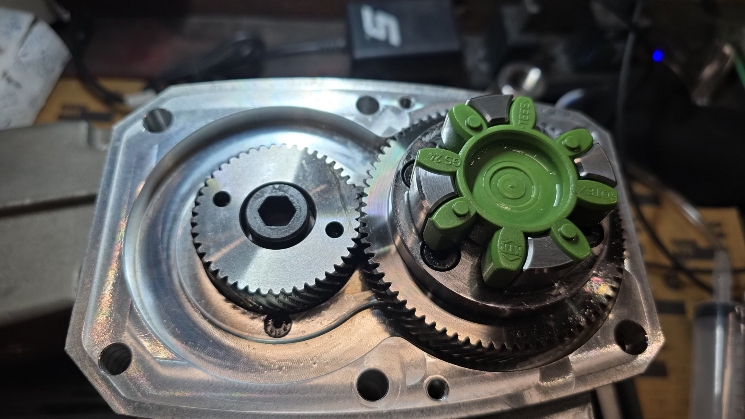

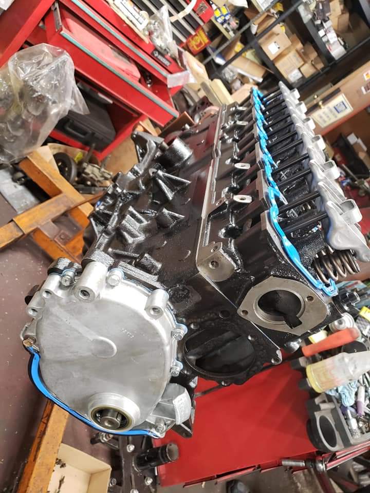

Hello everyone here's my ride , it's a 2002 wrangler sport with a built 4.0 ( rebuilt bottom end eith .030 hypereutectic pistons, balanced internals,arp main studs,rod bolts,headstuds, mopar purple 229 cam, shop 505 stage 2 performance head, port matched intake (ceramic coated),banks torque header(ceramic coated), aftermarket fuel rail(ceramic coated),36lb injectors,dei injector wrap, snow performance methanol injection, sprintex supercharger kit with a custom made 54mm pulley making 8psi, newcomer racing 1.7 rockers, cowl intake, brown dog engine mounts, built 32rh with shift kit and vent mod. Tuned on hp tuners
