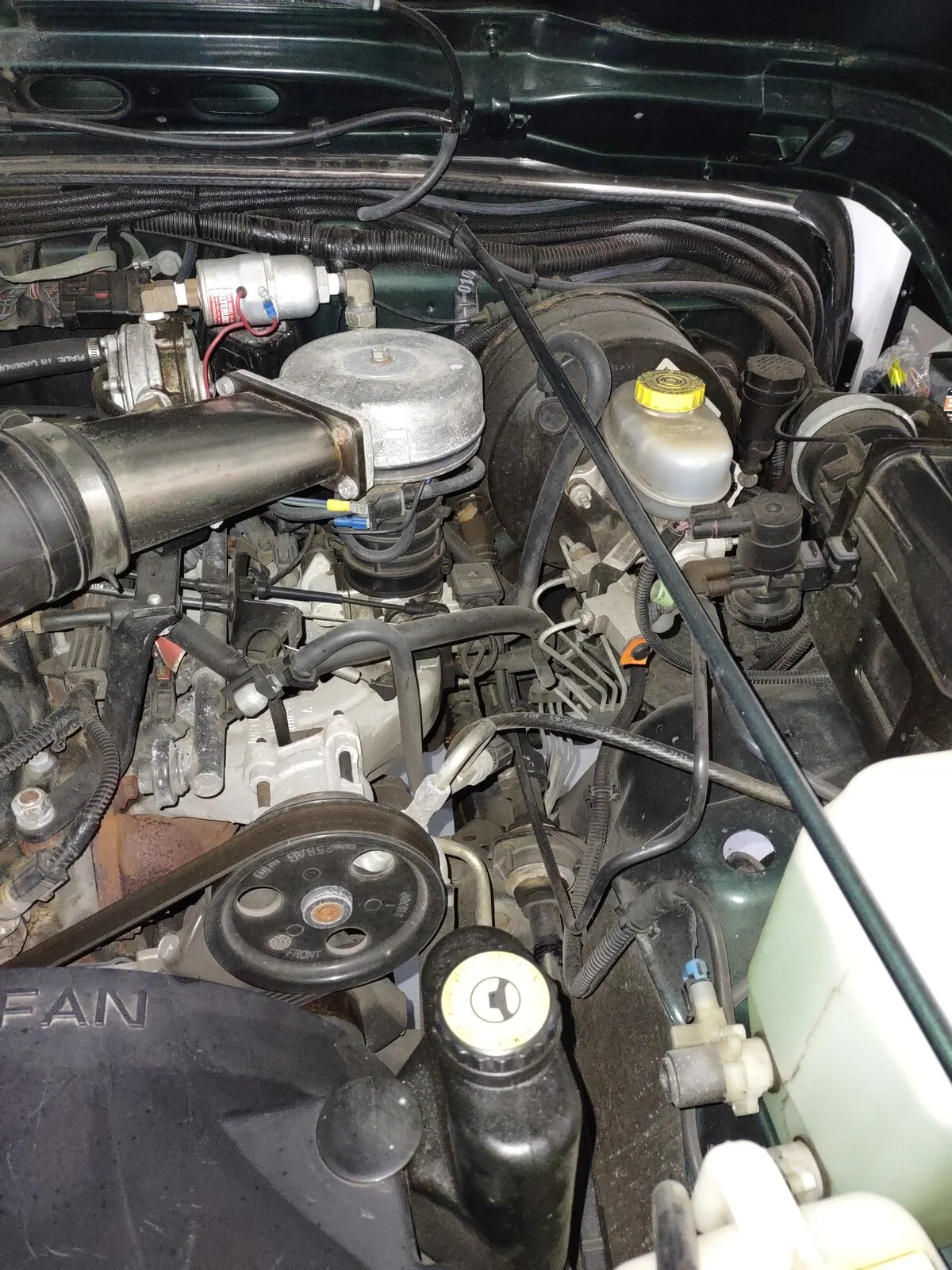

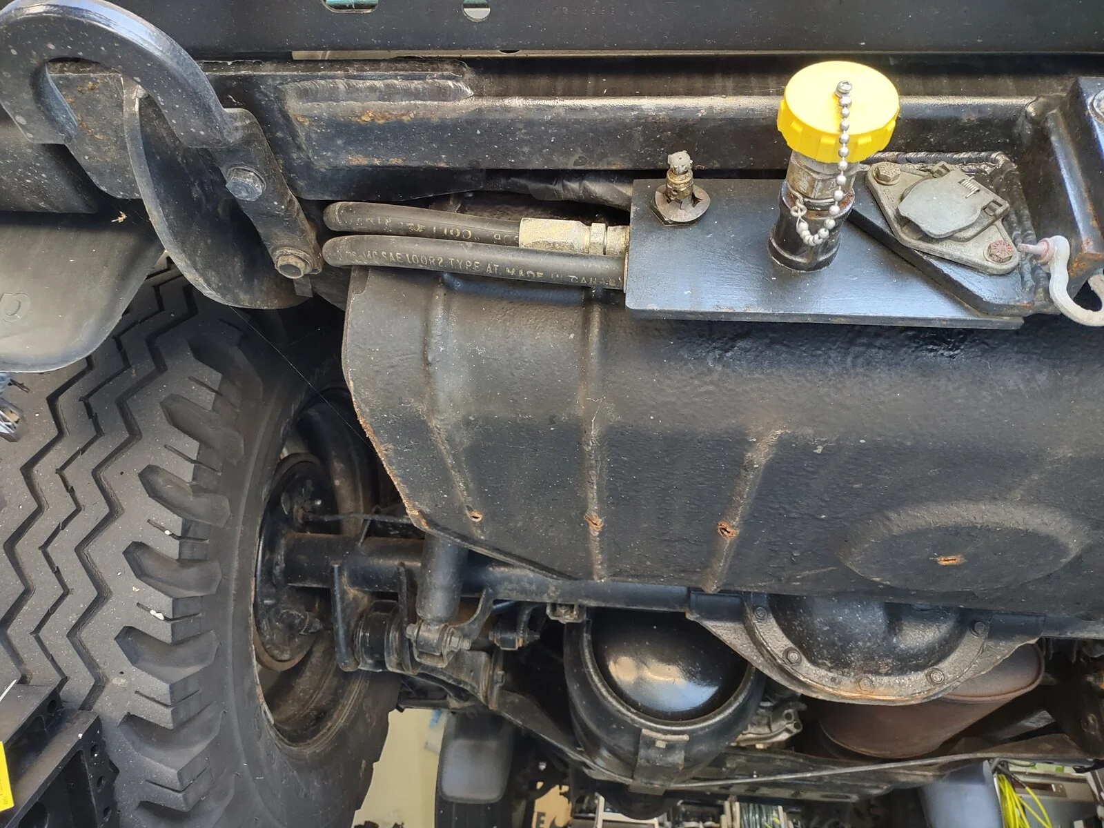

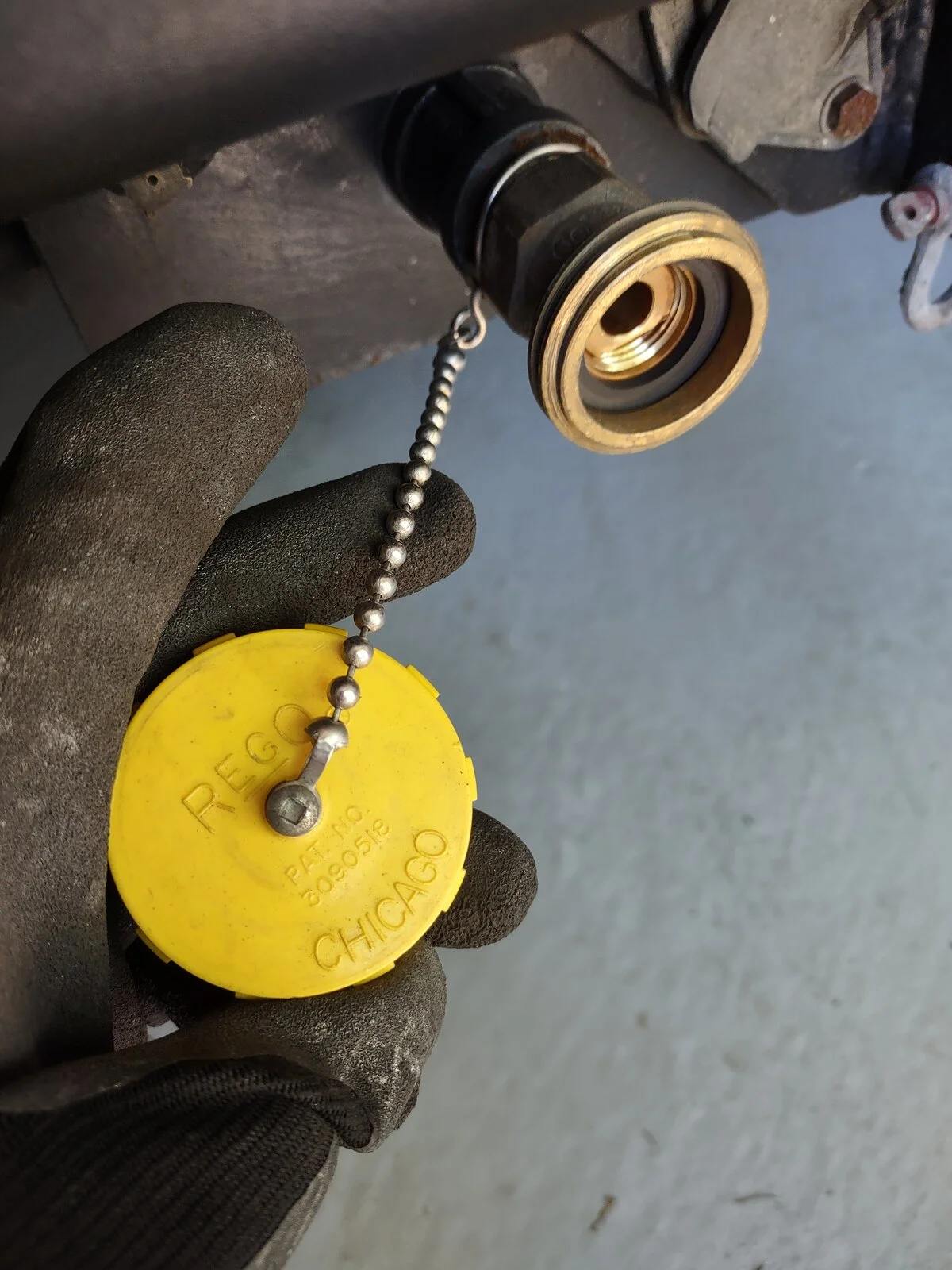

Hi Guys, I recently bought a 2000 TJ from the daughter of owner that have passed away recently
The jeep is in really good condition. However when I took it to the dealership last week they inspected it and told me I had a propane tank strapped underneath and couldn't work on the transfer case fluid as a result.
they asked me if my Jeep ran on propane, of which I had no ideal.
just wondering if you guys have ever seen such a set up before?
KingCarGuyZ
Feb 26, 2020
1,272
Dallas, TX

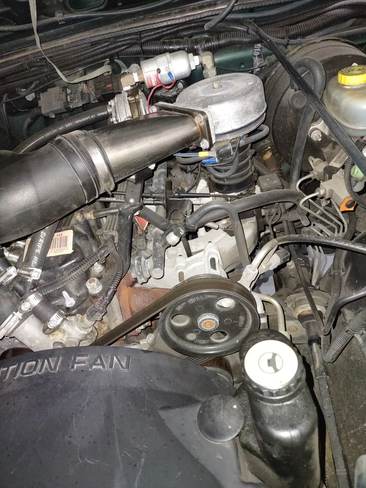

I’ve never heard of a TJ running on propane, but the 4.0’s well run on just about anything else, so I suppose it could be done. Can you take pictures of the intake area (under the hood drivers side where all the silver bits are and the big black tube ends) and maybe what’s under that yellow cap on the bumper? ….. I wonder if the PO wasn’t using the propane tank as a refillable OBA supply, but the connector doesn’t look right for that.

You got a fill port and a vent at the rear. Should be some components under the hood as well, and a switch to control what fuel its using someplace. Used to see a lot of propane conversion around here. Burns clean and used to be cheap.

I'm betting it does run on propane. used to work at a airplane catering company back in the early 80's that had about 50 ford f-700 (IIRC) and they all ran on propane. you hooked the hose up where the yellow cap is and turn the little brass thing with the hole in it to vent until propane came out then turned off the pump and closed the vent. either that or some jeep dealership turned that TJ into a rolling grill for cookouts !
