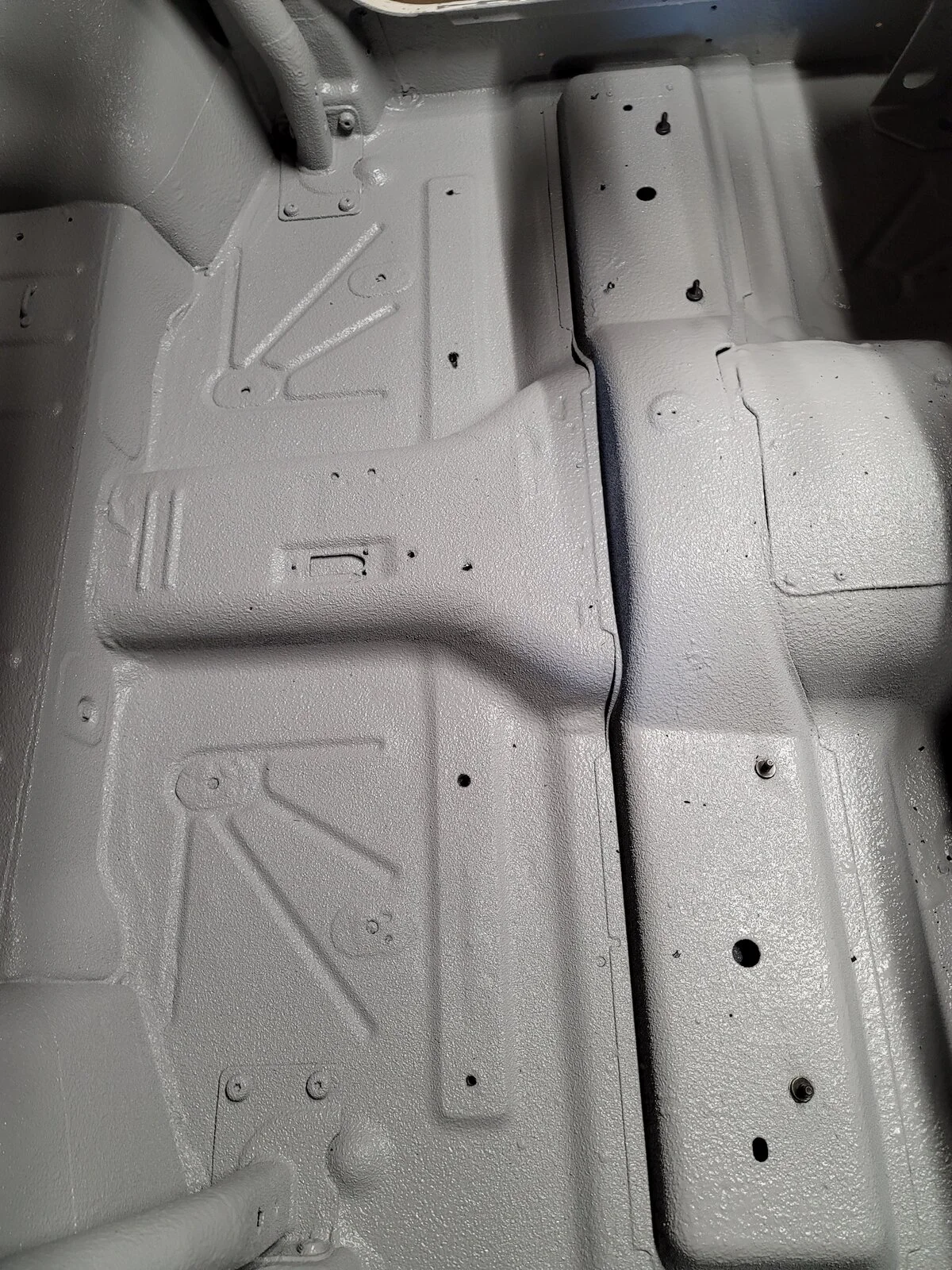

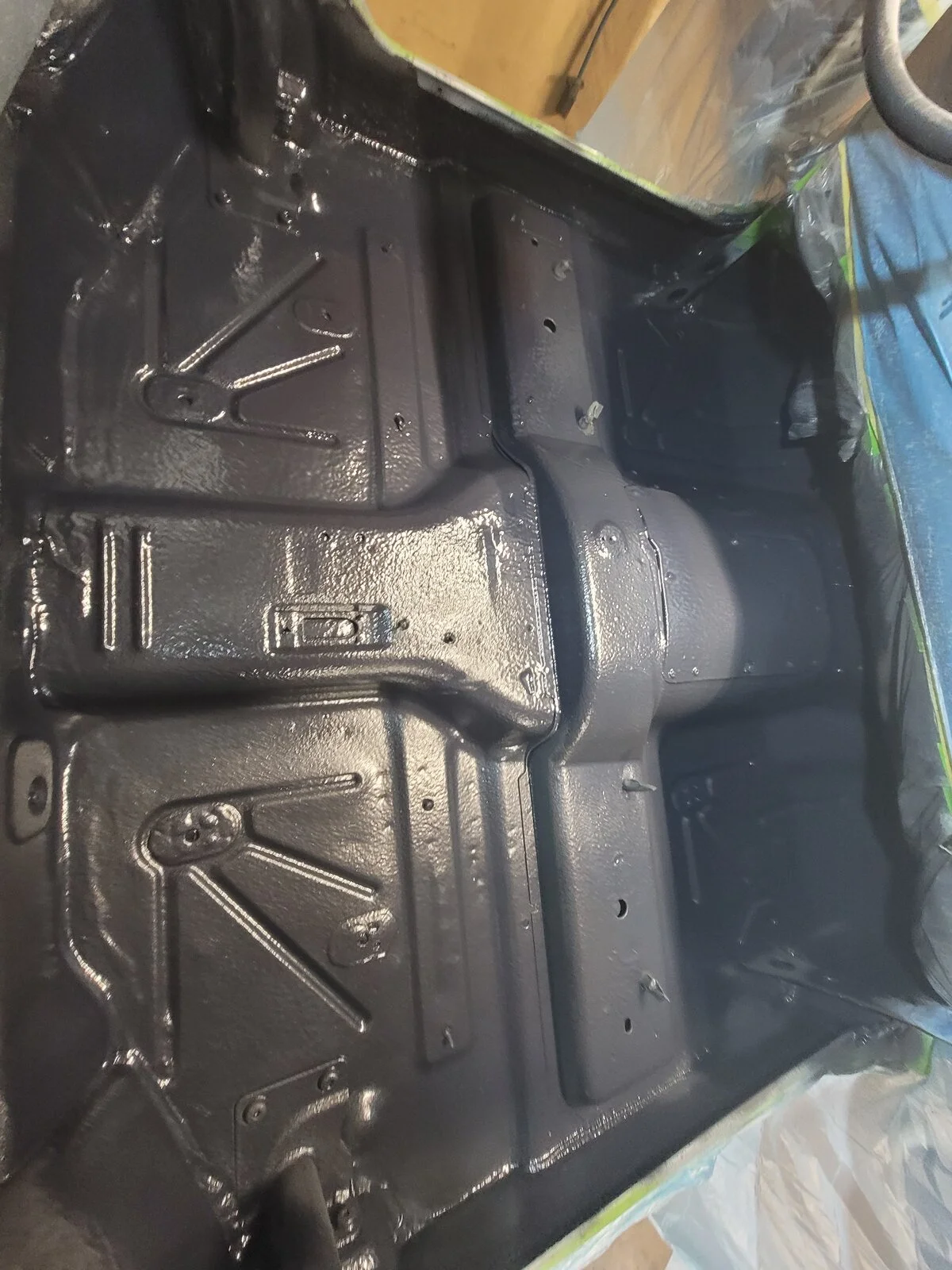

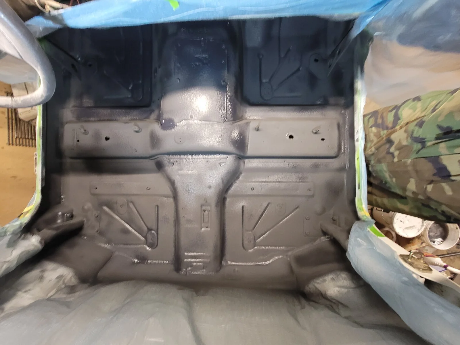

I just got done doing the ceramic coating to the front passenger area of my tub so I can't say yet how well it does or doesn't work.
I was only concerned with trying to cut down on the amount of heat I was feeling thru the floorboards.

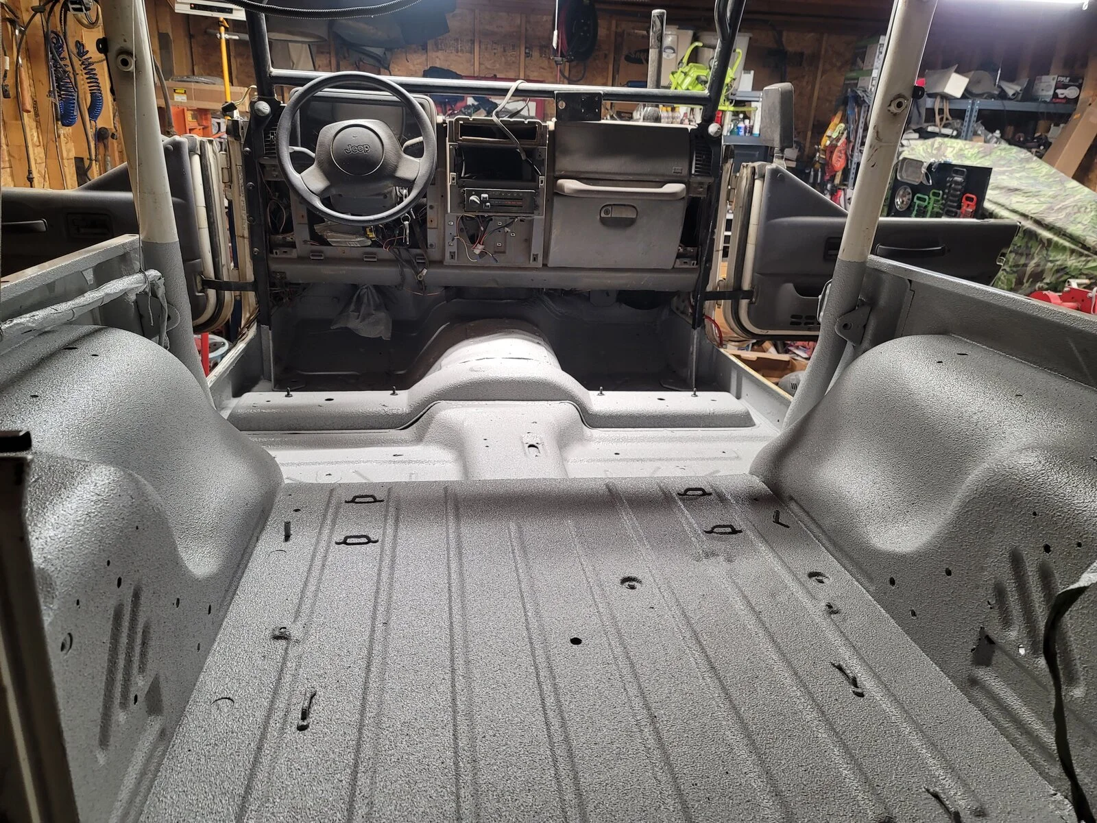

Then I sprayed the whole interior with bedliner as I do water crossings and deep mud holes so felt that any type of heat resistant or sound deadening mats would just become water logged.
If you are thinking about pulling the tub then I would and have the bottom cleaned off and prepped for then spray it with the ceramic and sound coating. And then spray the interior with bedliner.

I used 2 gallons of Lizard Skin and wished I'd had just a little more. I'll have to find the name of the bedliner I bought. Around page 178 is where I start spraying stuff.
I did the bedliner over the Lizard Skin for the durability since the bed liner in my truck seems to hold up pretty well. Since I'm not driving my Jeep yet I really can't tell you how good or bad it is yet.

Here is the bedliner I got.
https://www.linerxtreeme.com/
Worked really good and looks even better. Overall I'm very happy with how it all turned out.
