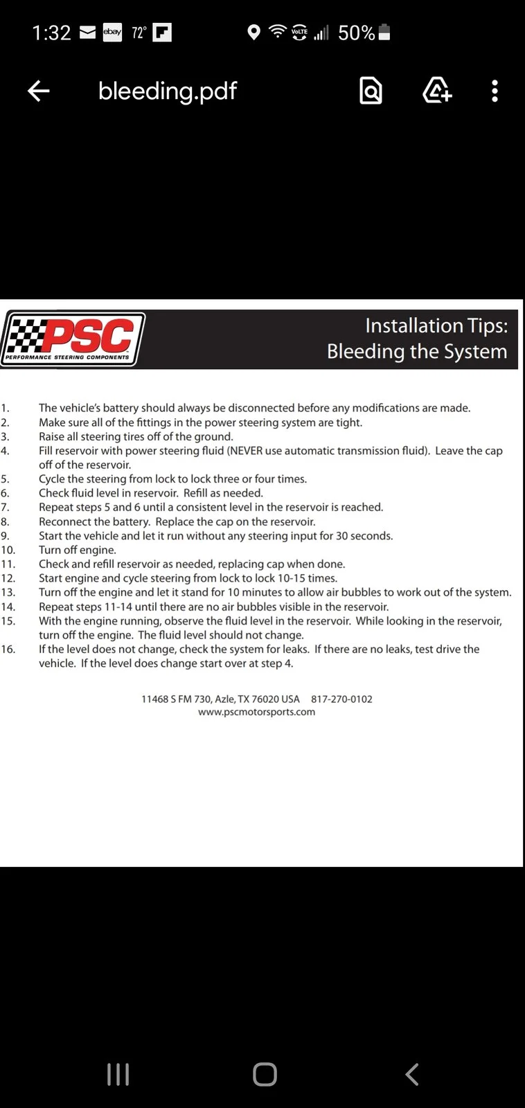

A little back story,
So I busted the sector shaft on the stock box a few months back and thought is was time to upgrade since this is not the first time the box has failed me. I was looking at a red head box but found a sale on PSC stuff so this came out to $1 cheaper. I will upgrade the pump next.
So I got the gear installed today, found my stock pitman arm even, and now it’s time to add fluid. This is where I would like some advice. (I have Swepco)
How should I go about this? Add fluid and turn the wheel a few times? Power on or off? Under load,IE hook up the tie rod or just leave it off while turning? Any help would be appreciated
Thanks
