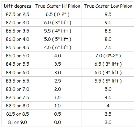

So I pulled out my last alignment sheet from about a year ago and my caster was 5.9* on the driver and 6.3* on passenger. This was with my front driveshaft removed when I was troubleshooting my return to center. When I got home I measured the flat spot on the front of my diff at 87* which equates to a caster of 6* based on the information that used to be on this site - http://go.jeep-xj.info/HowtoAlignment.htm (appears to be dead now). It basically stated for a HPD30, the caster angle is 9* offset from the pinion/diff angle when at 0*
I used this reference point to then set my caster to about 5.25 (86.25* on the diff) which is how it should be sitting right now. I'd like to verify this with an accurate method.
I searched around for accurate ways to measure caster. I understand that caster is the axis between the upper and lower ball joint in which the knuckle rotates on. I've seen methods that involve dowels inside the ball joint holes in the axle C's but that is not feasible in a situation with everything installed. I stumbled across one of Blaine's posts on another forum
Caster is the inclination of the king pin axis. In other words, draw an imaginary line from the center of your top balljoint extending through the center of you lower balljoint. That the axis or pivot point that the knuckle rotates around.
If you know that, then some simple knowledge about machine processes and deductive reasoning will allow you to pick a few places to use an accurate angle finder. The lower balljoint has a nice flat spot on it. The upper has a nice shoulder where it rides against the top of the inner knuckle. They are both at right angles to the centerline due to the way they are machined and make good places to measure caster from.
What confuses folks about trying to measure it, is that it they also lean inwards making most pendulum style angle finders useless unless held perfectly vertical.
Do not use any welded on brackets to determine caster if it's important to what you are doing. They are not that accurate."
I have a digital angle finder and I've tried using the lower ball joint flat in the past without luck but will try agian this weekend. In theory the lower ball joint flat should match the upper ball joint shoulder right? This should be a good way to verify my measurement
Played with the preload of the steering box tonight. It was hard to feel anything through the steering wheel while loosening the preload so I resorted to loosening a bit and test driving, repeat. I got the steering pretty sloppy and the return to center still wasn't 100%, after taking a corner I still had to help it out the last bit before it'd center and while driving I can "aim" it one way or another and it'll track that way.
I was able to get some good readings from the ball joints for my caster that coincides with my previous measurements. It should be right around 5.25* right now. I also pulled my tires and double checked my alignment using aluminum stock, was right at 1/8" for 28" tire. I pulled it into 1/16" and it didn't make any difference.
