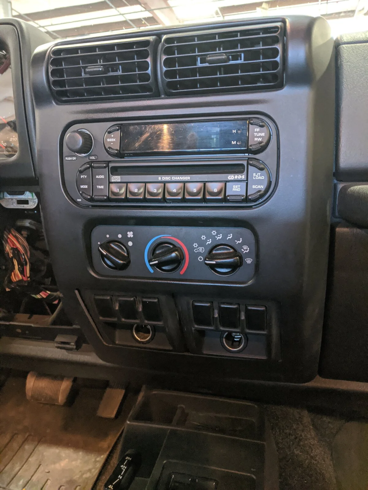

Finally making headway on a mod that I've wanted to do for a long time - installing switch pods from 97-02 TJs into my 05 Jeep. Daily driven TJ shows how to do it on 97-02 Jeep but I could not find anything on how to do this for 03-06 Jeeps, or even if anyone had even attempted it before.
The curvature on the older switch panel is slightly different than the 03-06 dash bezel so this took a bit of careful sanding/trimming work. I actually bought a very cheap used dash from a local CL part-out to practice on so that I don't mess up mine. The passenger side power outlet need a bit of trimming as well but nothing terrible.
I still need to do little bit more shimming and fitting to get them to sit evenly, but here's proof that this can indeed be done on 03-06 models. I will prep and paint the switch pods with SEM paint, the colors don't quite match and I know it'll bug me later.
I'm planning to add independent lockers switches and a winch switch (driver side pod) and passenger side will have the the rear wiper, defrost and trans OD switches. I'll post a photo later when all the workis finished up. The goal is to have it OEM looking.

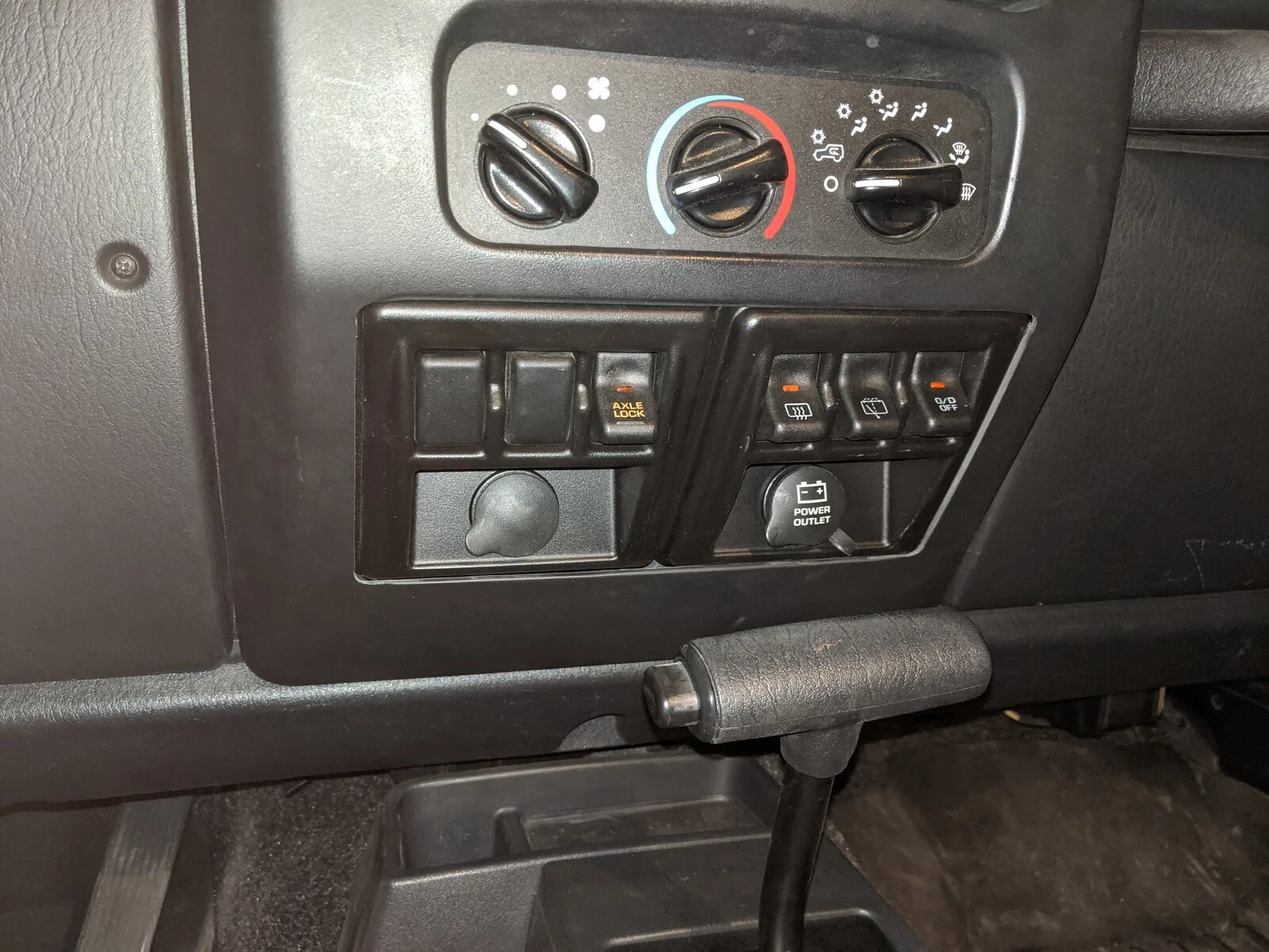

Finished up the independent lockers install and a couple @jjvw inspired mods 🤣.
I chose to retain the factory safety settings for the lockers (yes, I am aware most people enable lockers in any case position). I let other people drive my Jeep on occasion and I did not want any accidental mishap. I made sure the dash lights come on just like with the factory switch. I did have to build a small custom circuit to get the lights on the aftermarket switches to light up when turning the lockers on.
I also put in a switch for the winch such that it will only get energized with ignition key in on position, and the switch itself is turned on. Pretty straightforward install, nothing complex.

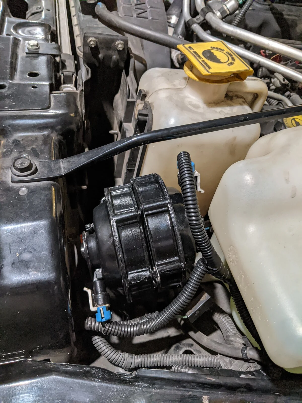

The first is the Cadillac 4-note horns. I got them from eBay. These horns are really awesome .. they are loud without being obnoxious and it definitely gets people's attention. I had help from my neighbor who put 3 small tack weld spots to put two of them together. The other two, I just mounted on the inner fender where I found space.
