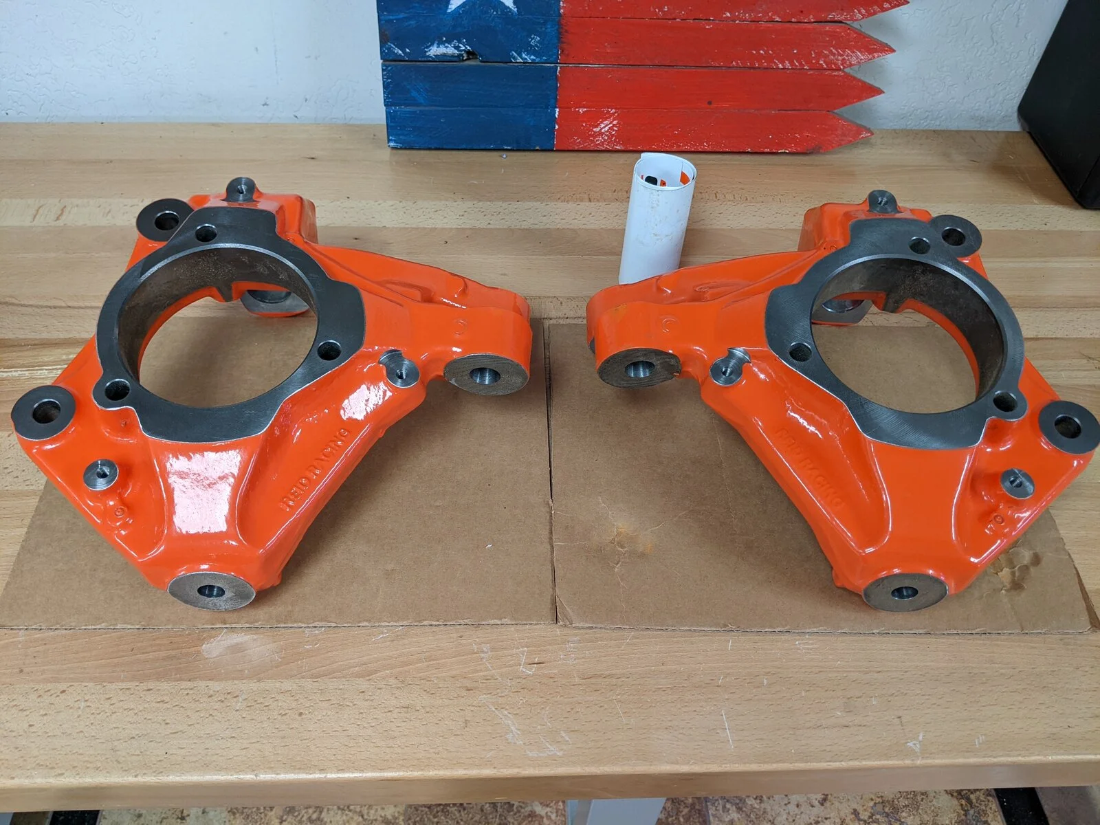

I made a call to RPM steering, and talked at length to the owner Don senior. I needed a drag link that connects to the JL knuckles on the axle side, and a TJ pitman arm on the other.. Super cool dude that knew everything about my project, apparently he already follows me on Instagram and is in the process of finishing up his own LJ so he had lots of advice on the setup. After multiple conversations across a few days, I ordered a custom drag length that will fit a flat TJ pitman arm, tapered for JK end links on the steering box side, and a high steer 2.5 ton JL stye link on the knuckle side. Along with a 2.5 ton tie rod, all in solid aluminum. Should be sweet.
