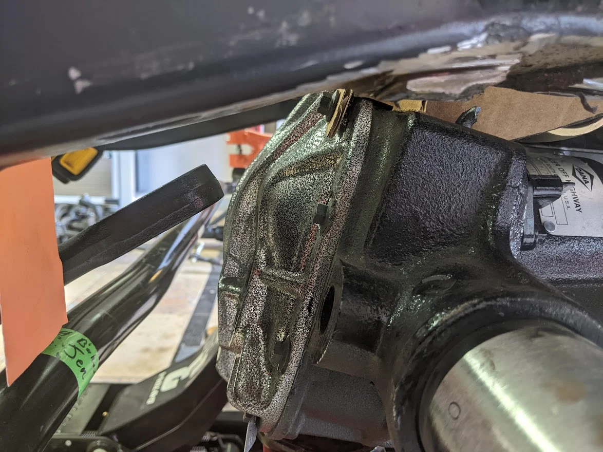

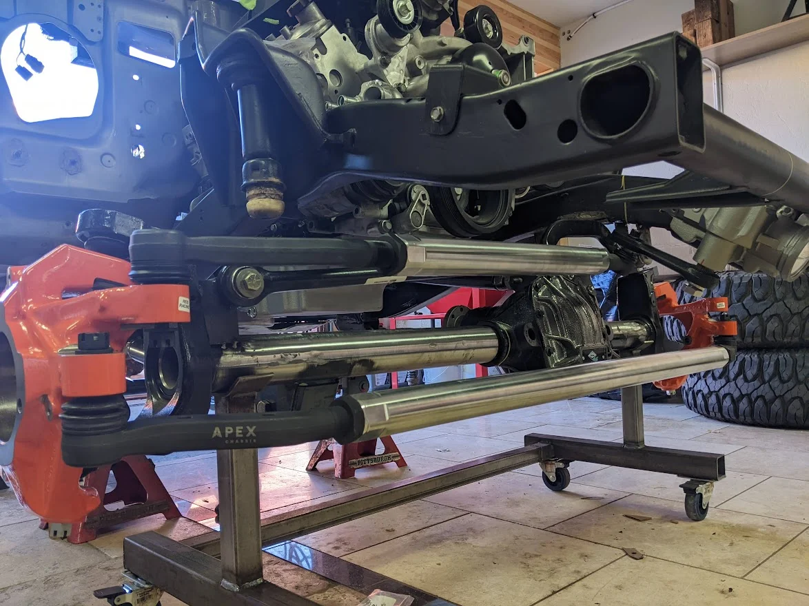

A rough draft is forming for the front 3 link, steering, and trackbar.
As it sits, the axle is 2.5-3" further forward than the factory setup. Things are tight, and I cannot finalize anything until the drag link shows up. But this is where we are at...
*all of the following pics are at full bump...the point where the axle will smash into things it cannot be allowed to smash into*

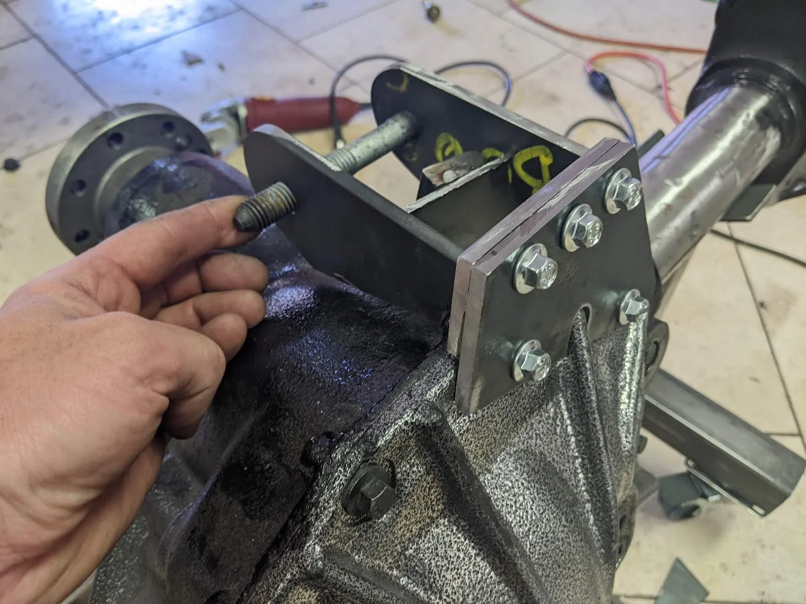

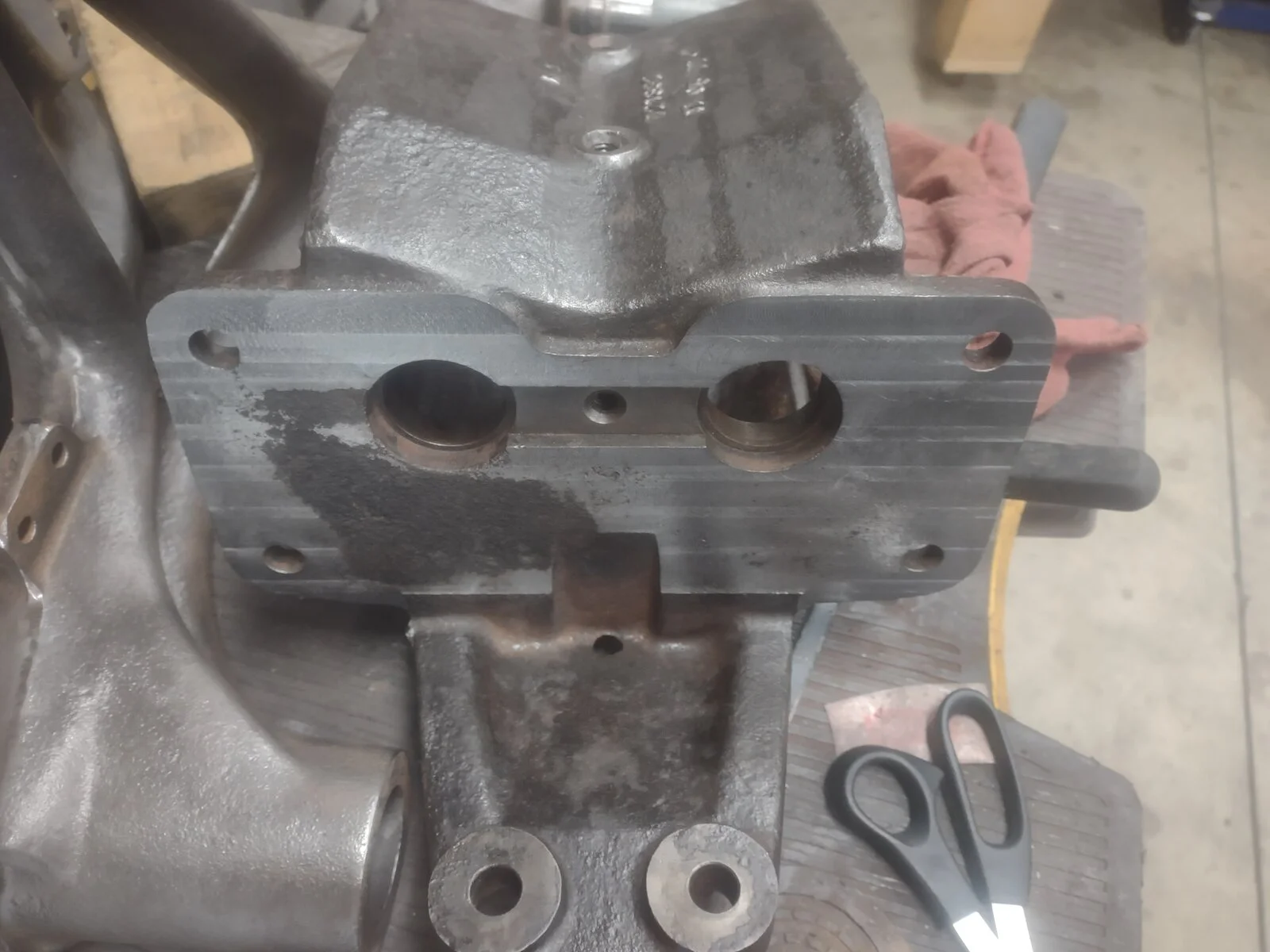

The cast OEM mount was cut in 1/2 so there are two "prongs" that protrude up, its common to use these as a key for locating a truss, and to tie into them, to eliminate any chance of the truss rotating. I will be fabricating a mount that will tie into this structure, with a 1 3/4 tube welded to it, to help secure the upper mount. I may cut this tube in 1/2 to keep the mount lower profile and allow me to get more inches of weld. This is a very rough, temporary mock up.

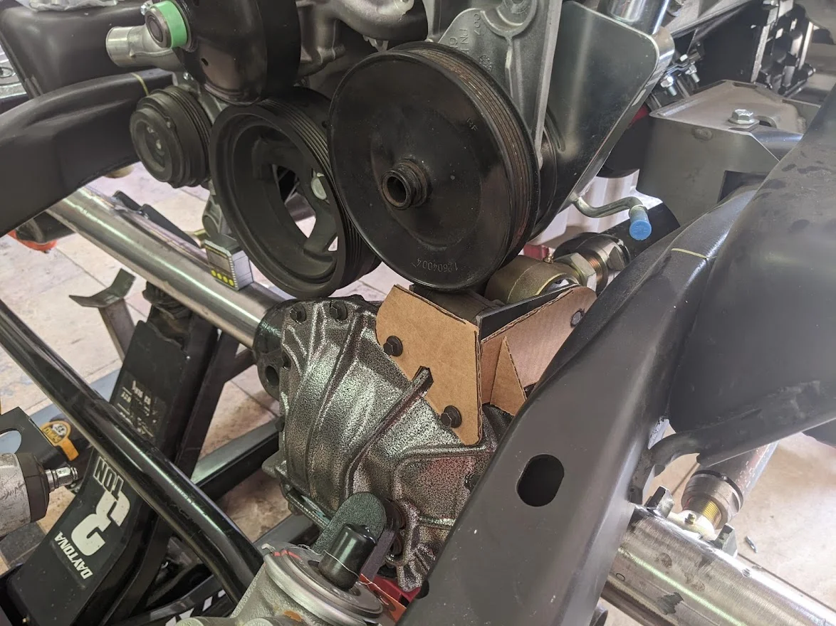

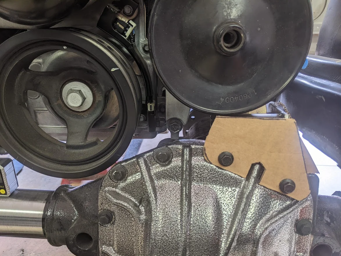

This is my CAD setup... I want to tie into the front diff cover bolts to help secure the upper mount... a truss just isn't going to happen with the 5.3. The front portion will be bolted on, the rear welded on. Welding to nodular cast iron is acceptable, but the more inches of weld the better. This mount will see no lateral force, that's all handled by the trackbar. only front to back forces will be encountered. I'll allow the axle to get within 1/4- 3/8 of the axle to allow for chassis, and bushing flex.

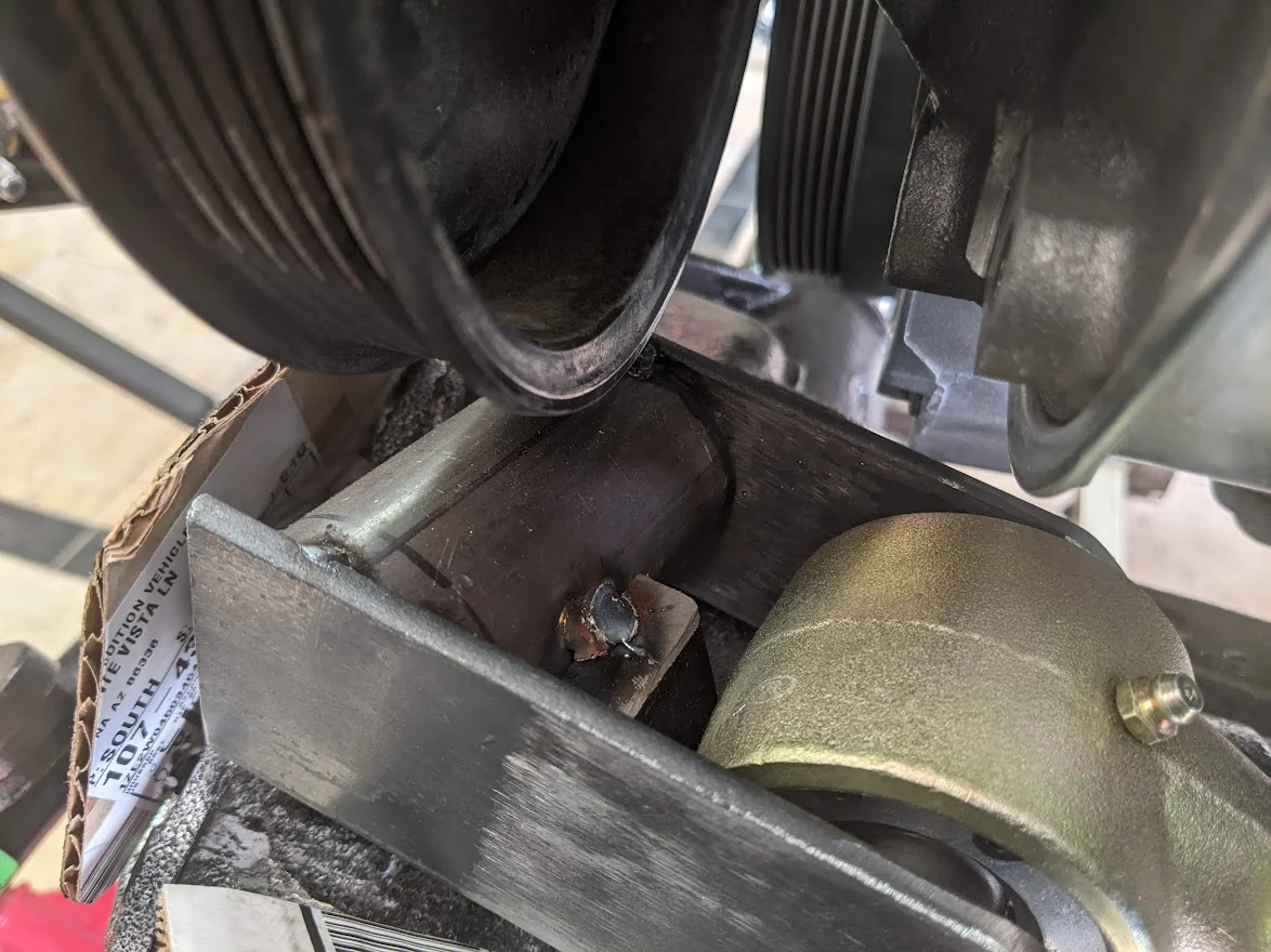

The power steering pulley will actually sit behind the bolt on plate, so its not as close as it looks. Same with the ribs on the pumpkin and the crank.
The plate that's bolted to the diff cover will be gusseted, so it doesn't just fold over under stress. There will be two more bolts along the top of the plate that tie into the welded portion of the mount.
same thing, different angle.
A flat pitman arm for partsmike. the JL knuckles are 6.5" from the ball joint to draglink, so I was planning on drilling the pitman 6.5 for a 1:1 ratio for steering box to knuckle ratio. Would love to hear thoughts on this if anyone has any. In this mockup, it gets supper close but I will likely be trimming a little off the pitman arm. Its also not as close as it looks.
Same thing, different angle. Also, in my parts bin, I found the rear trackbar from a JL 392. its a solid bar with a different bend than the standard JL stuff. It will be a great mock up tool because the angles are absolutely perfect for this setup. With the housing being rotated, it really opens a lot of room up. At full stuff there is plenty of clearance for the diff cover and trackbar and its almost exactly the same length as the drag link I need. cool.
So its a sits, its looking like I should be able to get 2.5 inches of stretch in the front no problem, but I may have to buy a tubing bender for the trackbar. I've always wanted one anyways.

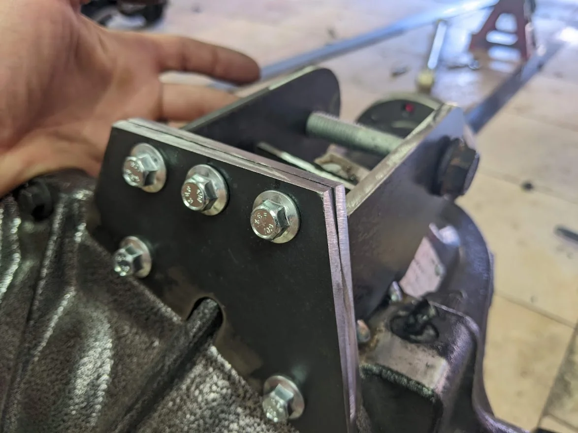

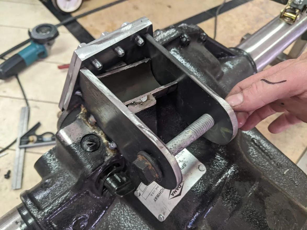

Here you can see the internal structure of the mount, 1 3/4" dom tube cut in half. This will get welded to the tabs and then welded to the upper CA mount. There will be a top plate, that will tie the two structures together. The part that welds to the axle is drilled and tapped.
Same thing, different angle. The Upper CA bracket will get welded all along the top of the center section with a gusset for good measure. I'm hoping that tying the diff cover, to the OEM upper mount, to the center section, will be strong enough for enormous abuse.
I believe this is strong enough to take more force than the axle can handle, even with 37's (spoiler... maybe 38s). I'm no engineer, so if anyone has any nuggets of knowledge before I burn it in, I would love to hear it. I want to keep this jeep low, but with massive up travel. A truss would be easier, but would severely limit up travel forcing me to sacrifice COG.

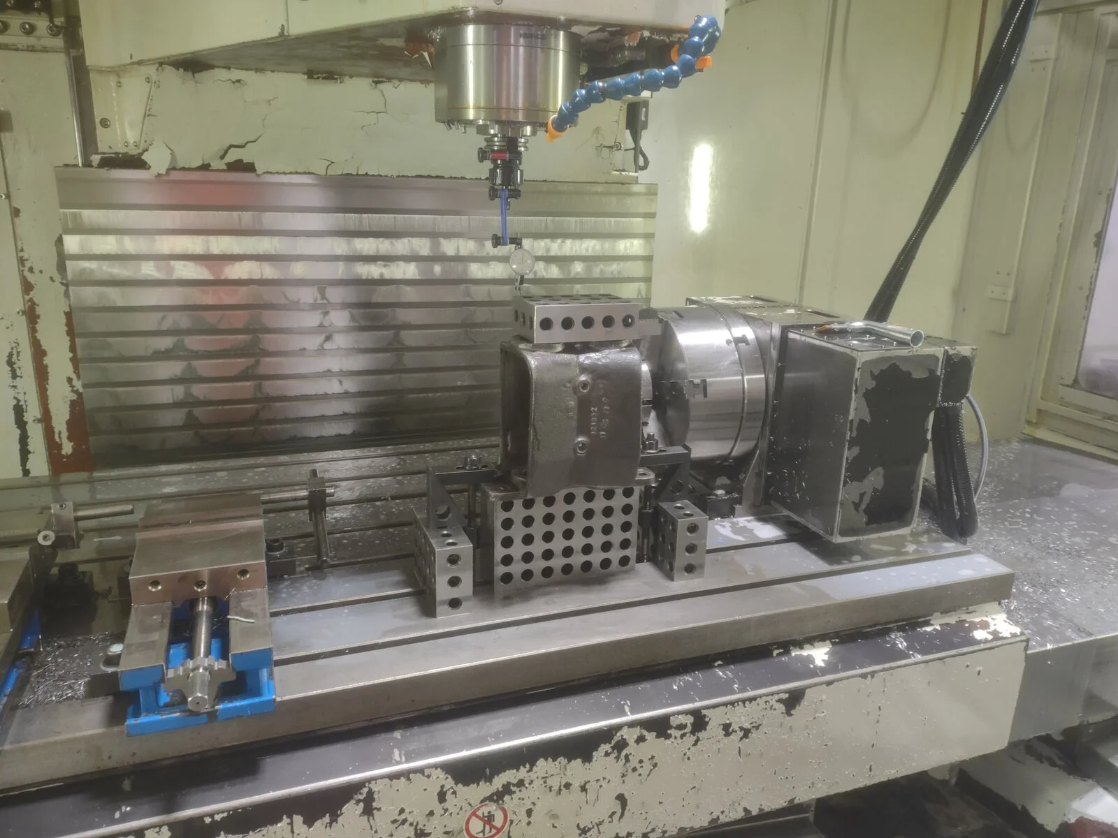

Damn you’ve got the cool tools, Mike.
Kinda... Every once in a while I gotta use production tools for government work, lol. That particular machine is a Hurco VMX64. It's huge... And sits a lot because it's so slow on tool changes.

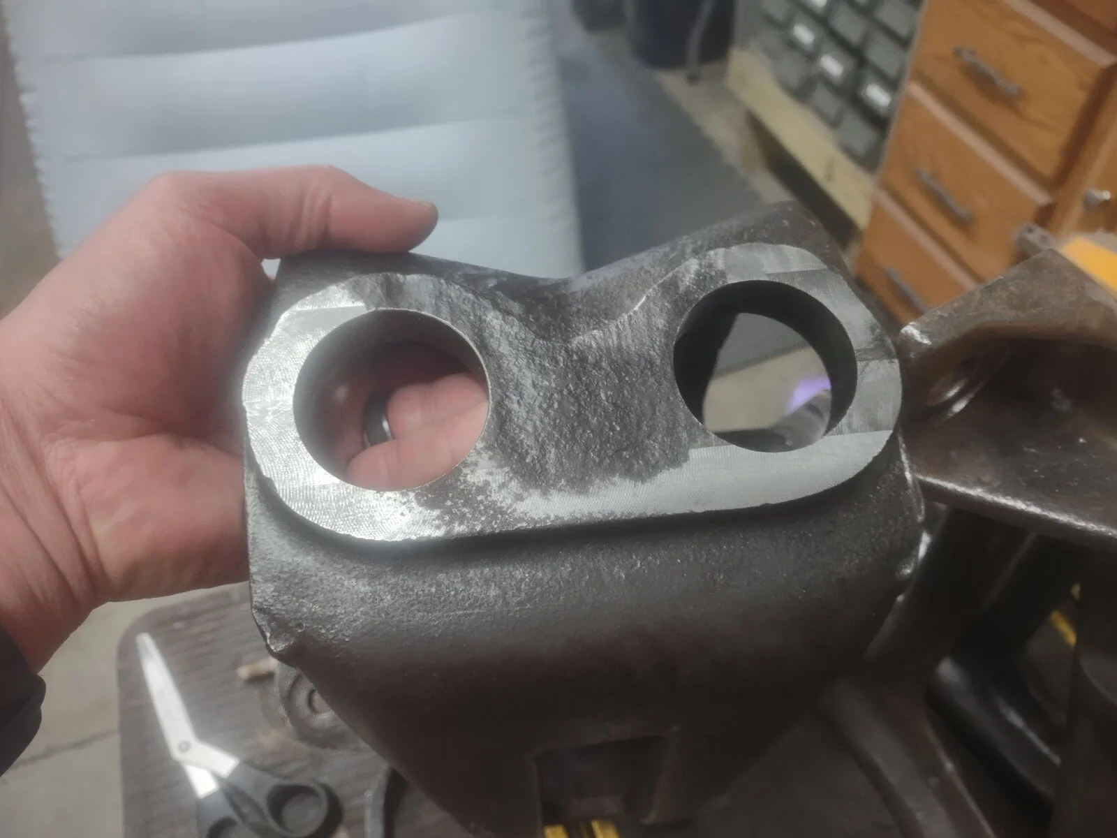

I had to true up my suspension control arm mount on the motorhome.
This side was just for banking... It doesn't affect the final assembly so I just cleaned it up enough to be steady.
This is the side that I really needed to true up. It bolts flat to the frame and shims are used to control camber and caster.
View attachment 339741This side was just for banking... It doesn't affect the final assembly so I just cleaned it up enough to be steady.

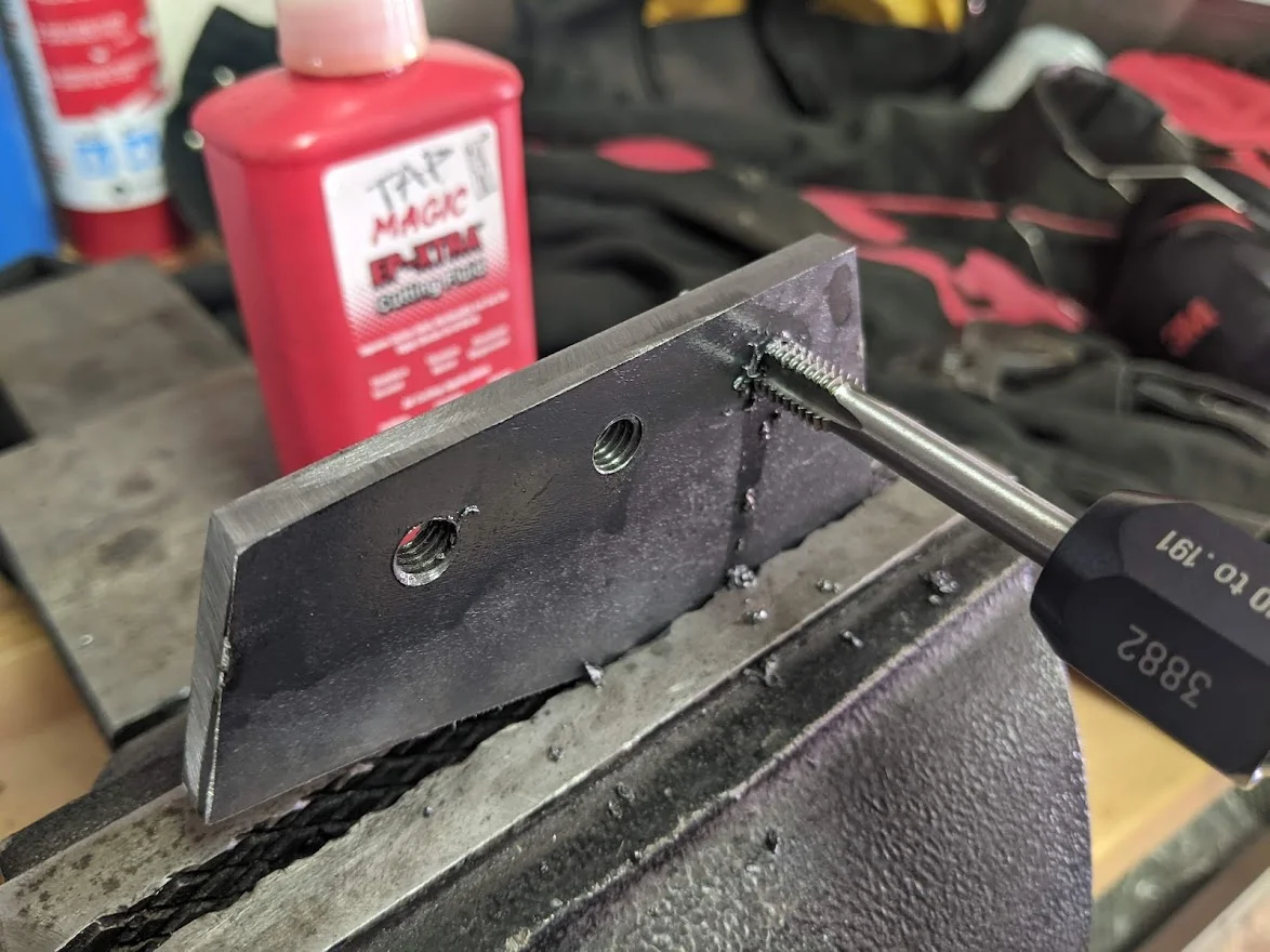

My post was meant to be funny, but until recently, I didn't have the capacity to do even something simple like accurately drill and tap a few holes. I wouldn't have the slightest idea how to use that machine you posted... and until you posted the parts you machined, I didn't even know what it did.

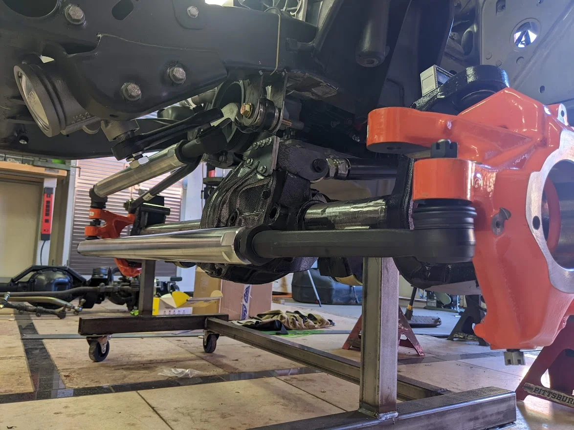

The drag link and tie rod showed up from RPM steering. Its beautiful 2" solid aluminum links milled to accept 1.25 threads with 2.5 ton rod ends.
I need to tweak the trackbar a bit still, but its the exact same length as the drag link, just need to change the angle. Also, before I make anything permanent, I need to install the grill and radiator to check for clearances in front of the axle.
So how much stretch did I end up with?
Currently 102.5
So right around 2.5" front stretch, 7" rear stretch
