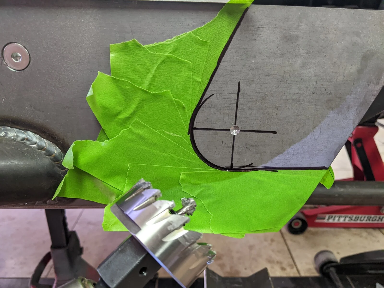

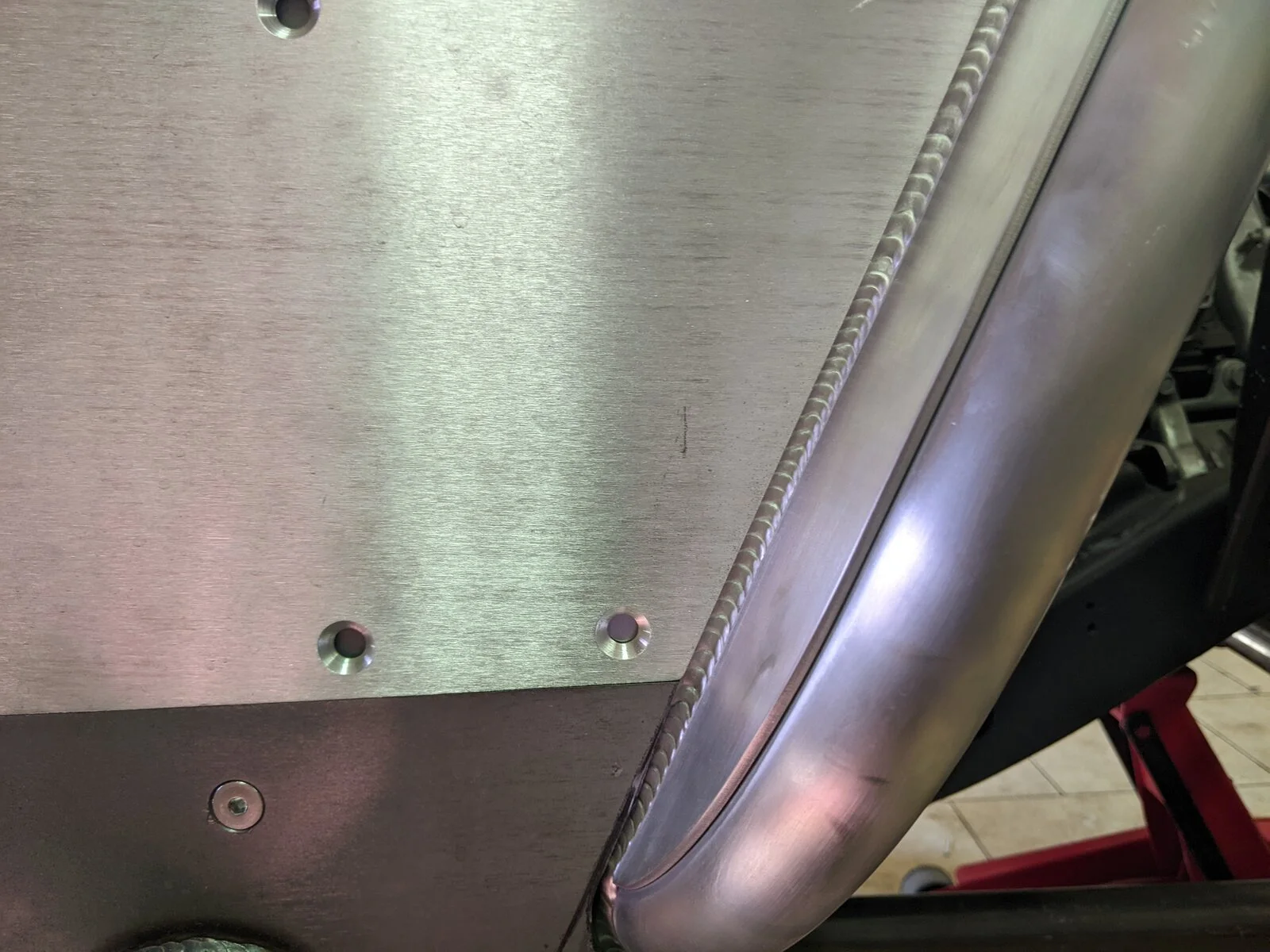

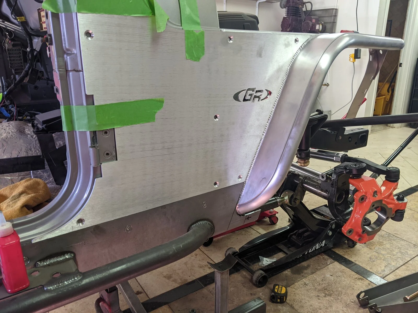

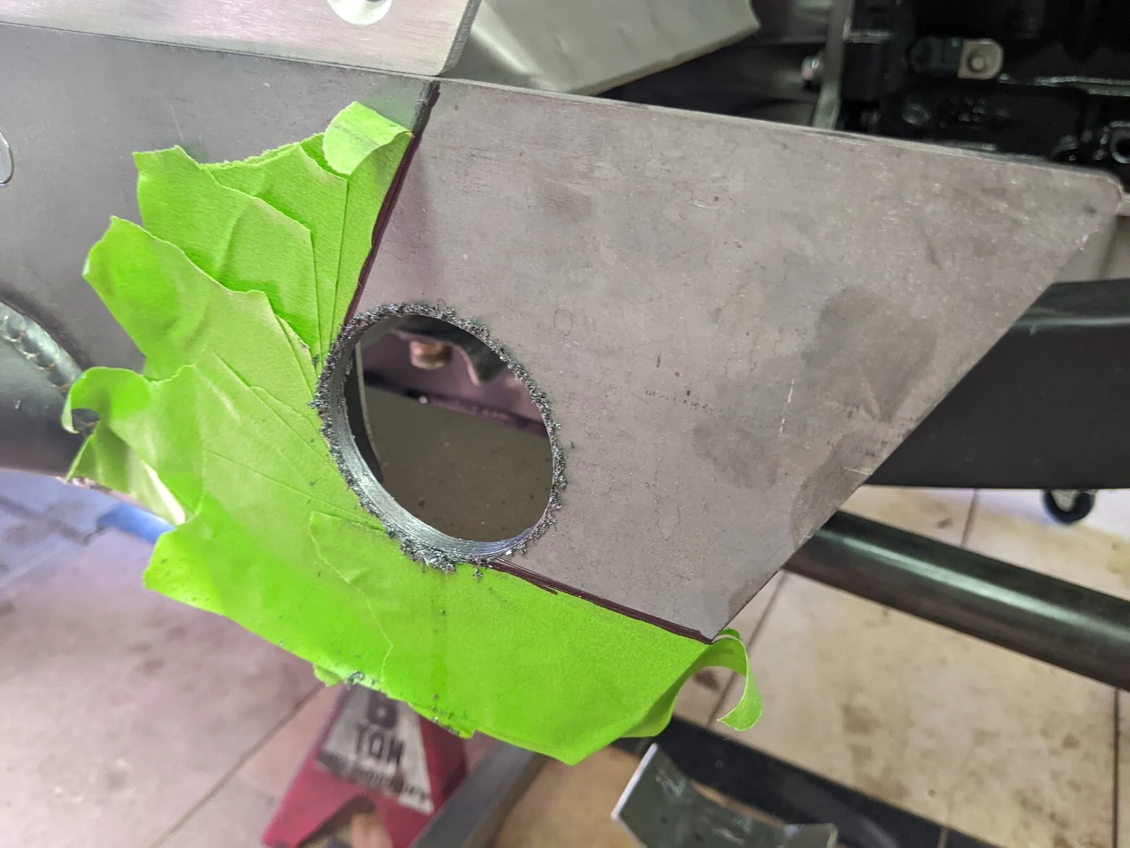

I need to put the fenders on, but the genright sliders are intentionally left long, you have to trim them to fit you fenders, whatever they may be. So I started by laying tape down on the fender, around the flare, to recreate the radius, which is a 2.25" circle by the way.
Drill the hole
And use a cutting wheel to connect the lines
I'll clean up the cut, and trim the little leftover nub.

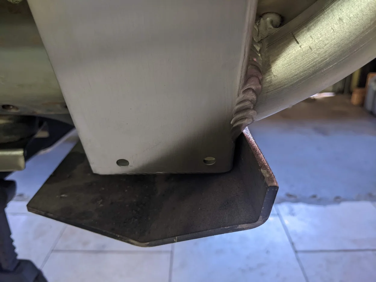

I got dead even with the flak jackets
I'm loving the look

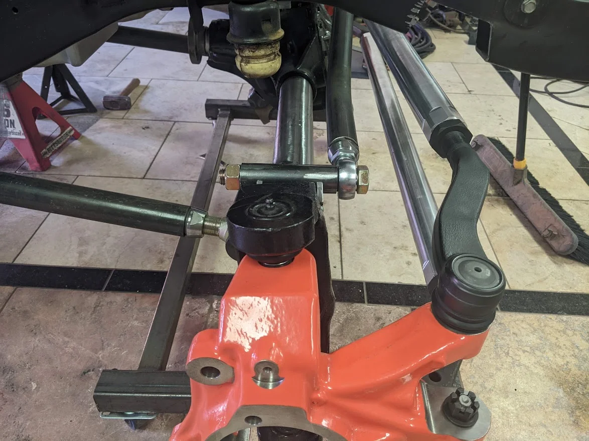

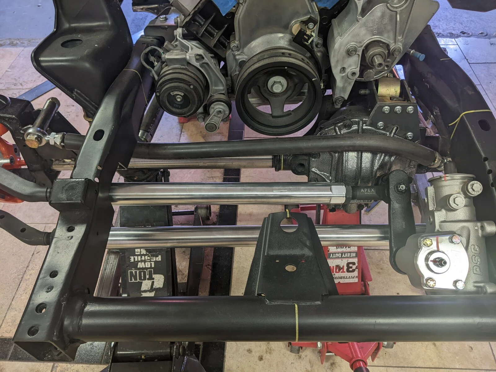

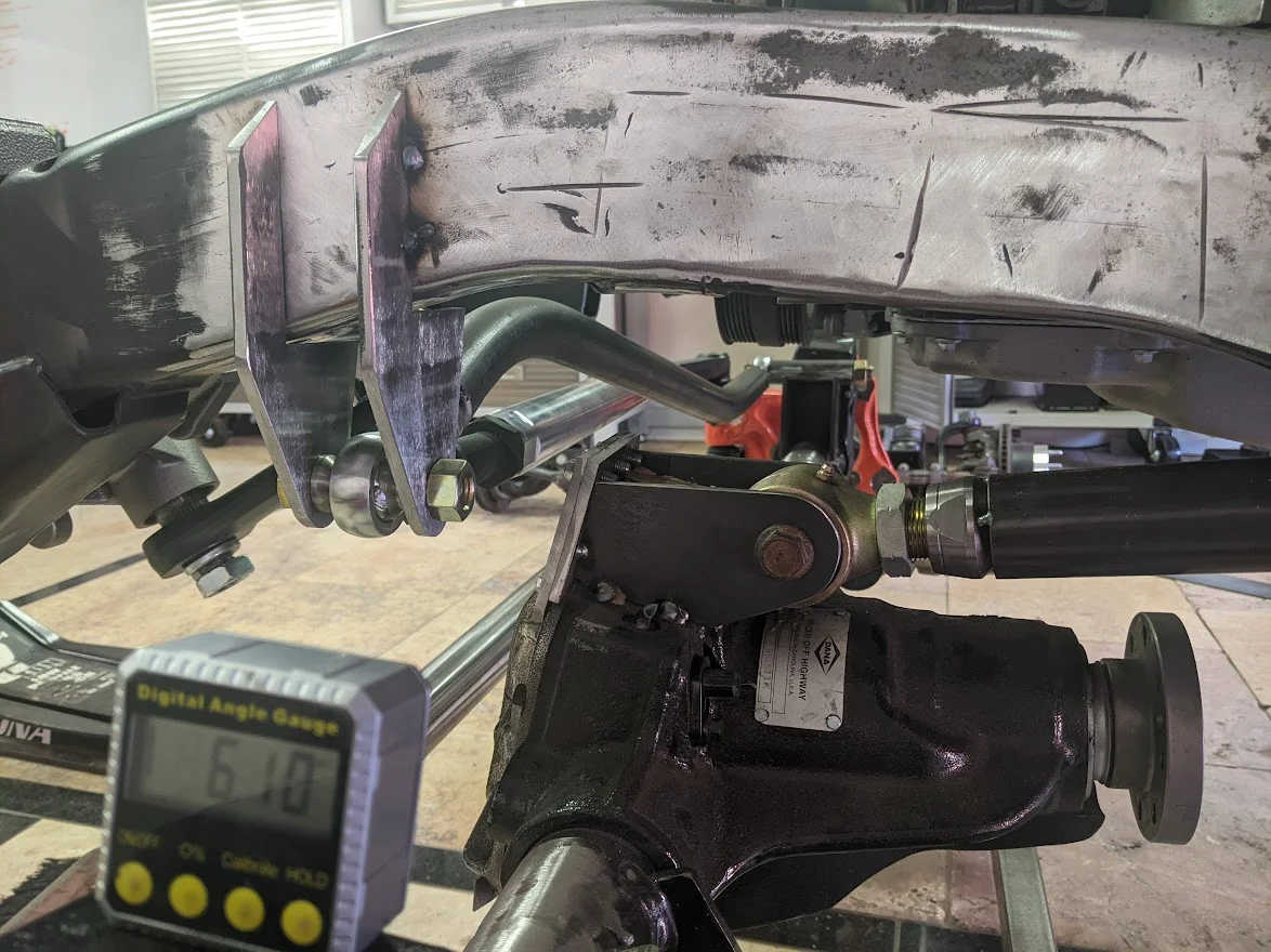

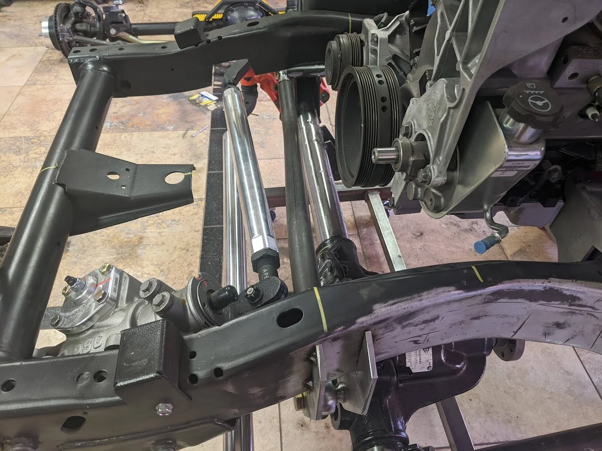

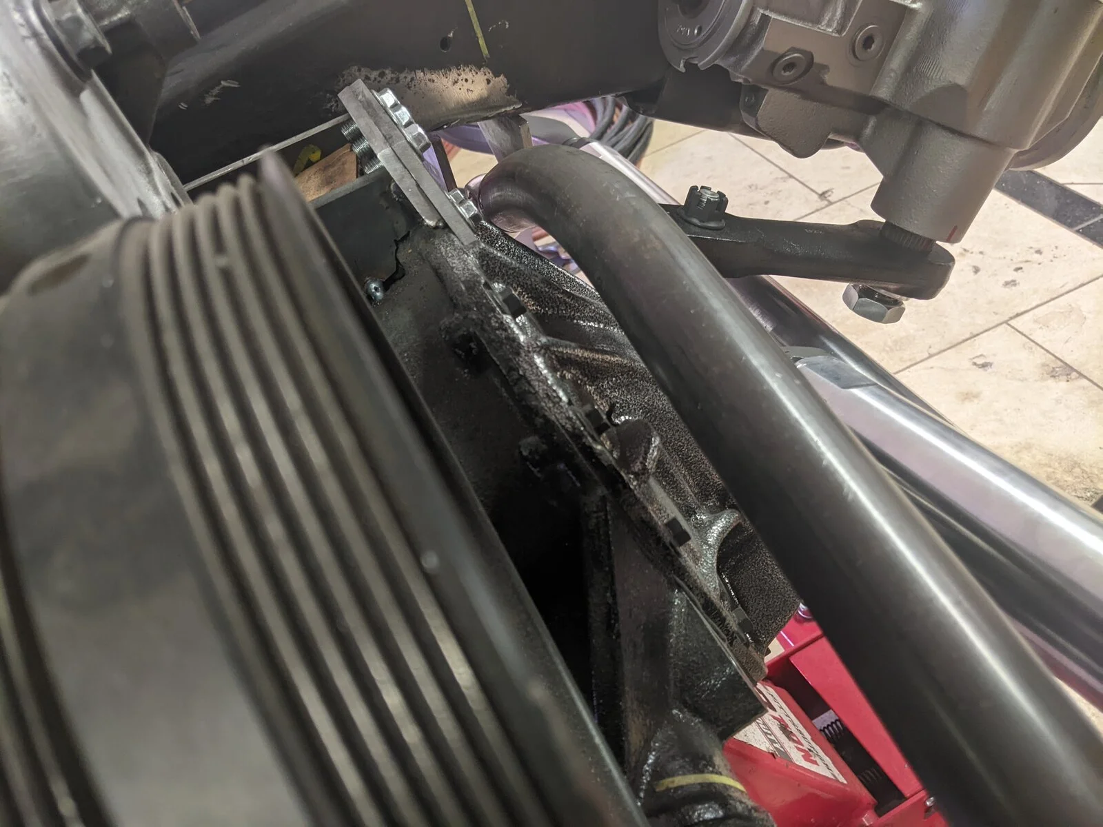

Back to the steering. I fabricated a trackbar from 1.5" 0.25 wall DOM, utilizing 3/4" joints. Using a HF pipe bender and some patience, I put two bends in the track bar. The first to go over the diff and the second to tuck under the frame again.
The drag link and trackbar get close, but clear.

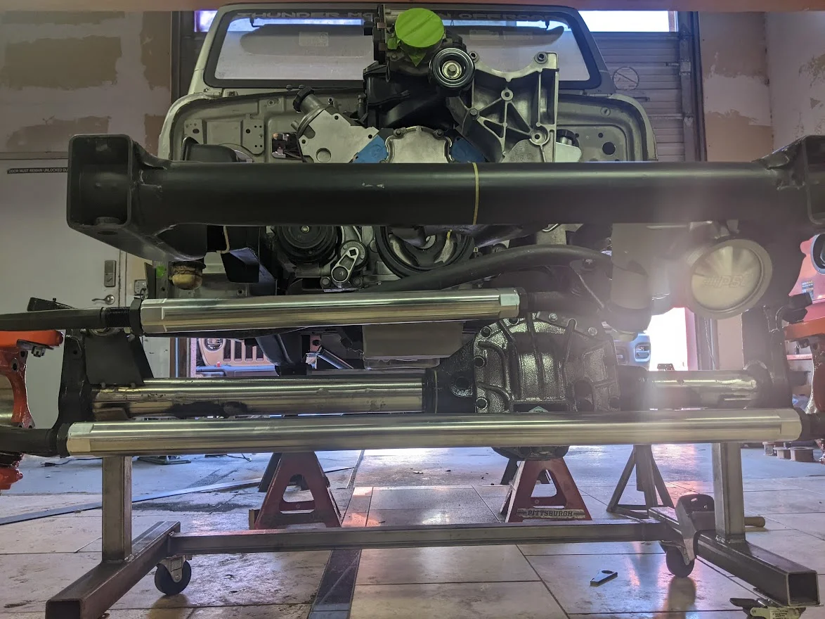

At ride height with approx 6" of up travel. Trackbar and draglink are parallel and equal in length.
Axle track bar mount. Its single shear but that is a 3/4" bolt going through it. Note how the heim sits close to the tube... it will allow for a small amount of movement, just enough to accommodate travel, but not so much the trackbar can get tangled up in the steering. Its totally neutral at ride height. You can see the bump stop from the factory to get an idea of how far the axle has moved forward. The factory TJ stuff the spring perch sits about 1.5" in front of the axle centerline, now its sitting about 1.5" behind axle centerline. Also the big ole notch for the drag link so it doesn't hit the frame.

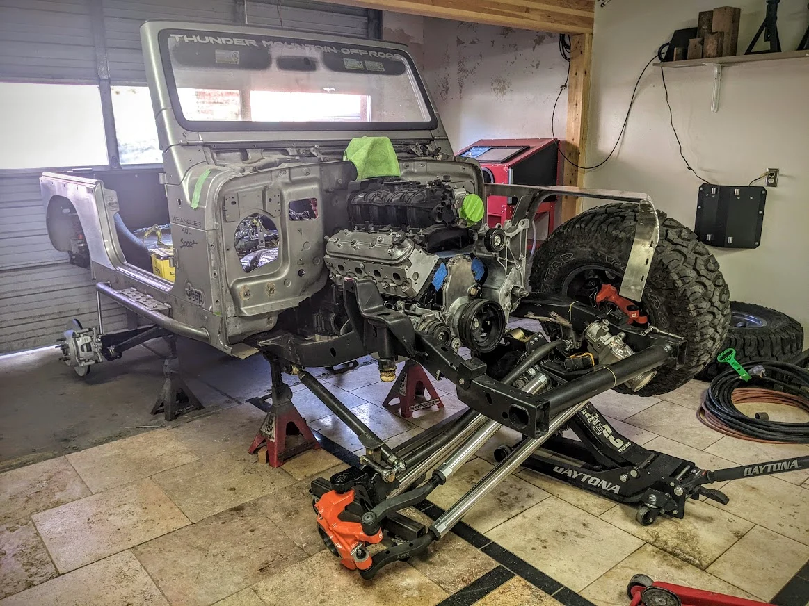

Still lots to do, but the basic front steering and suspension is designed.
Drill the hole
I'm loving the look

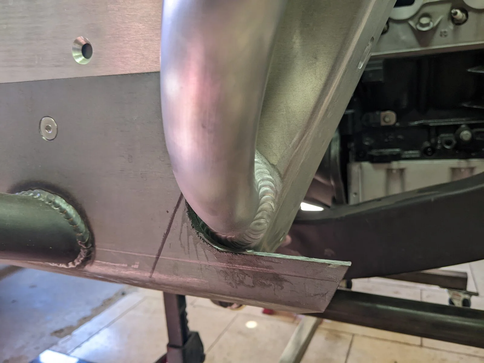

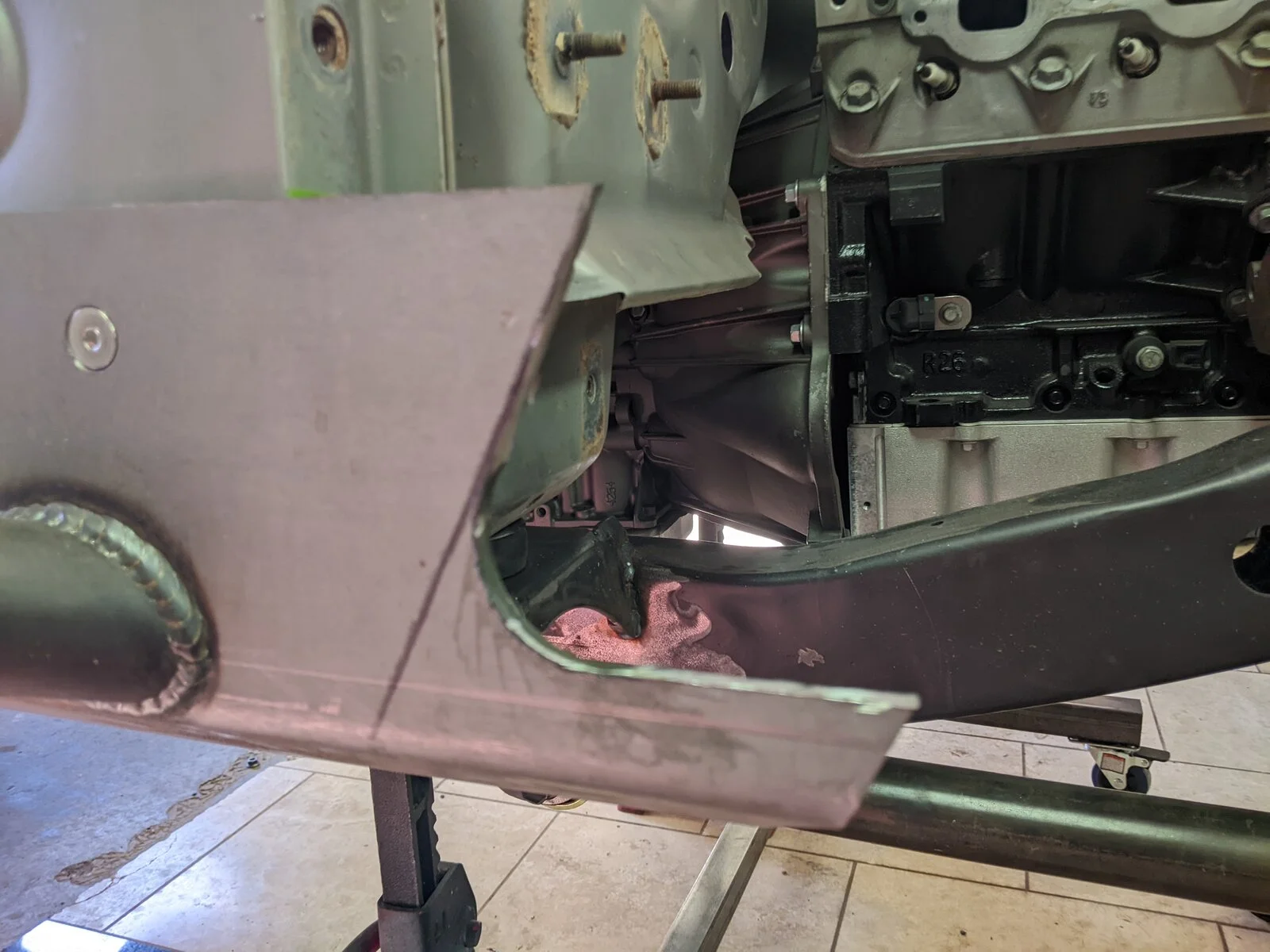

I am at this exact point on my Tracer build. How did you properly locate the hole location since you can't slide the hi-lines into the rocker uncut? Did you measure from the top edge where the fender will mate up?
The flak jacket armor is perfectly lined up with the flare, so with the fender off, I still know where the flare will be using the flak jacket as a reference. So I used a straight edge to continue that line down the rock slider. Then using the tape in the pictures, made a template of the bottom of the flare, transferred it to the slider and connected all the lines. It worked pretty well
thank you for the quick response. is the bottom of the highline sitting all the way at the bottom bend of your rocker?
No problem,
it goes to the top bend. like so...
I still need to trim the rocker to fit the fender. I'll probably box the bottom and tie the fender to the rocker with two countersunk bolts.
No problem,
perfect, thank you so much!!! I am finding that my genright hi-lines are not welded identically so each side will be a custom cut into the slider, i am seeing about 1/4" of difference on where the tube starts at the bottom :(
And fully flexed out. I've been waiting for this, because it sets up a few things.
There is plenty of room for 37's. There is actually room for 38's. and If I can tolerate a little rubbing now and then, possibly 40s
