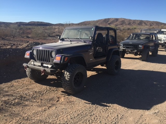

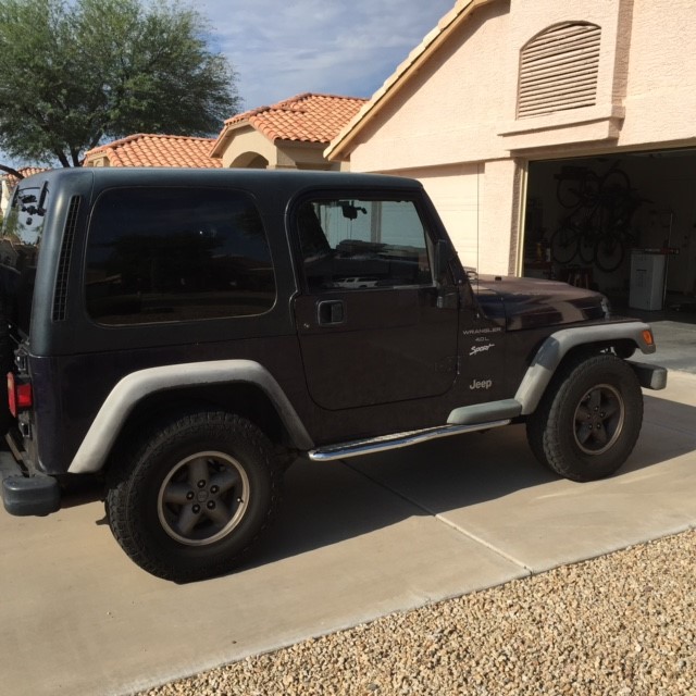

June 2015 the wife and I bring this little Jeep home. $6200
1998 Jeep Wrangler TJ Sport 180,000 miles, Arizona Jeep so zero rust.
4.0 engine (20k on remanufactured replacement)
Automatic 32rh 3 speed (Leaks).
Interior light grey and all intact, full console , all carpeting and full rear seat.
Amethyst Pearl Paint with clear coat peeling on hood and fenders (Arizona Jeep) . Hard top with full doors.
Dana 30 front and Dana 35 rear axles geared for economy with 3:07 open differentials and 31" tires.
Stock steering set up with the optional "death wobble" feature included.
And power steering , brakes, rear wiper and cruise control that I have never used. Ever. Not even sure it works. I may have too try it this weekend just to see.
Ice cold A/C which was a deal breaker with the wife as was the A/T and Hard top.
As with every Jeep I looked at it leaked every fluid it had except fuel and Freon.
We bought it at night and thought we had scored a decent "Blue" Jeep. Went out in the morning and low and behold it was "Purple"!
Wife loved it immediately! It took awhile to grow on me but wouldn't change it now. It really is pretty unique and we get a lot of comments on the color.

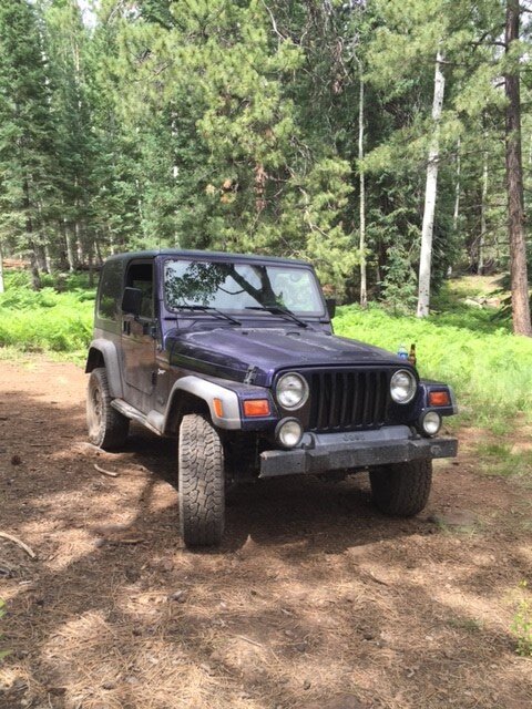

Did not take long to realize 307 gears were not going to be ideal with any size tire. So looked into a re-gear and man that seemed expensive. After researching the internet I found that 3:73’s were pretty common in the grand Cherokee and their Dana 30’s were everywhere and cheap. So I dig into Craigslist…..
I answered an add for some axles but when I got there he had already sold his Dana 30 but told me he still had a rear axle he knew nothing about. I look at it and it looks to be a Dana 35 from a TJ. I rotate the axle and count the pinion rotations and do some math…..bam 3:73 gears! I it has a blue nylon hose coming out of the housing and ask but he knows nothing. So $100 later I take it home and yes it was a TJ Dana 35 3:73 gears and an ARB locker that worked perfectly.
Next was a
GC Dana 30 for $125
Used Dana 30 lunchbox locker with broken pins……..$75
New pins ……$25
Used unknown 2.5 inch lift springs and sway bar disconnects……$100
Used 5x 33/10.50r15 mud claw tire mounted on steel wheels …..$500
Rubicon Express front track bar new…what ever wholesale price I could find.
ZJ rear disc brakes complete with e-brake cables from a u-pull wrecking yard acquired on half price
Wednesday of course…..$65
External trans cooler and some DV8 led lights…..
Oh also shot some paint on the hood and fender to make her shine a little more.
So if you haven’t already noticed I love to make a deal and I can be very frugal!

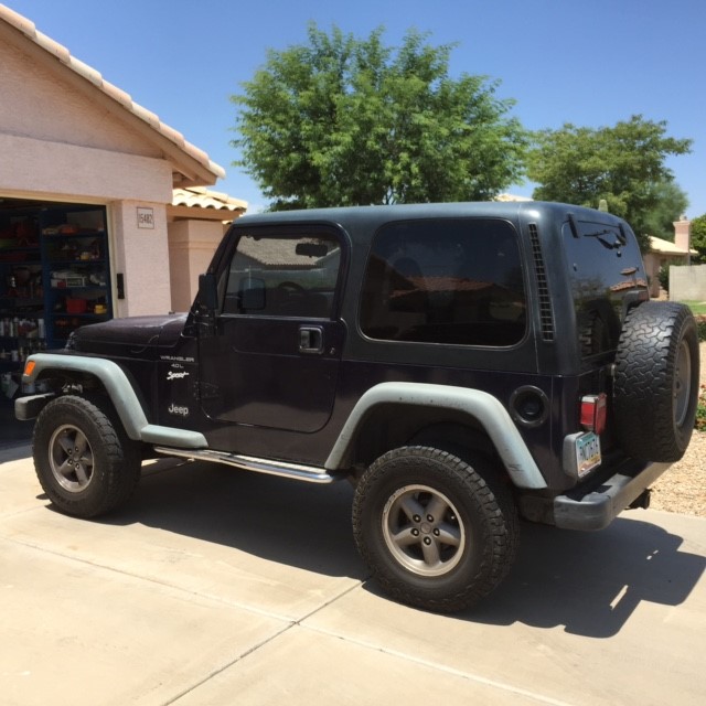

So that brings me to this stage
So around this time I picked up a used Procomp front bumper, a Smittybilt rear bumper with tire carrier and some takeoff Rubicon tub rocker armor. I know, I know , I know.... Smittybilt! What can I say? They did the job and I am not a role model. They are heavy, hard to open and close etc. Twice through the Rubicon and a dozen trips to Moab they never rattled, broke or failed me. The swing away has been replaced with a MORryde gate hinge set up.
The trail doors, duster, sun top and Hi-lift were given to me by a employee who traded her Jeep in on a new truck.
Shortly after that 4Wheel Parts grand opening sale.......... Smittybilt XRC9500 winch $225 couldn't resist and it hasn't missed a beat.

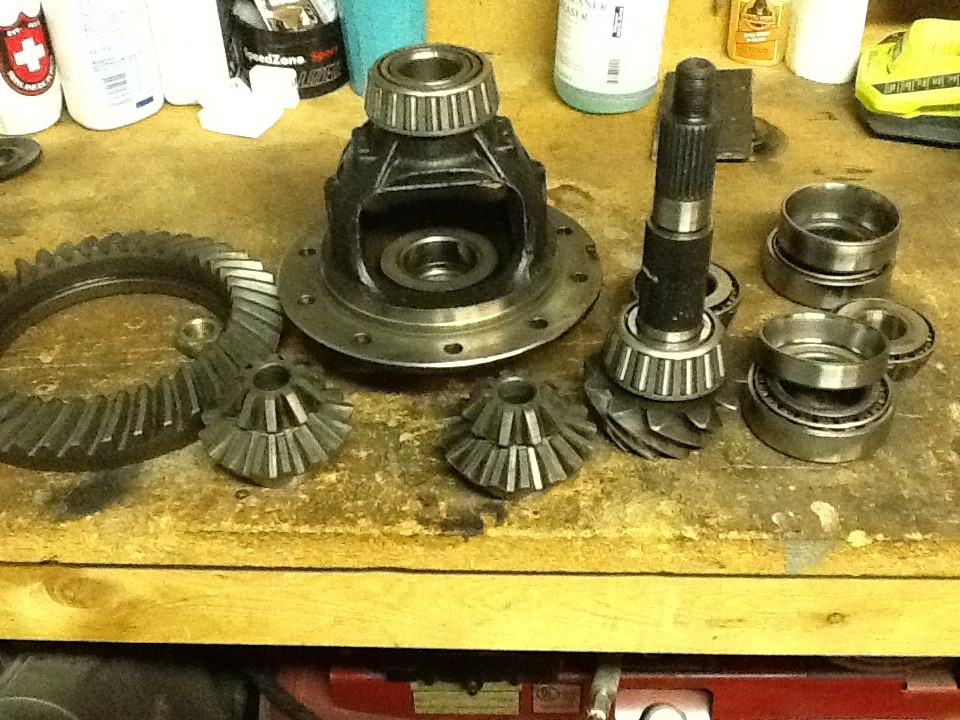

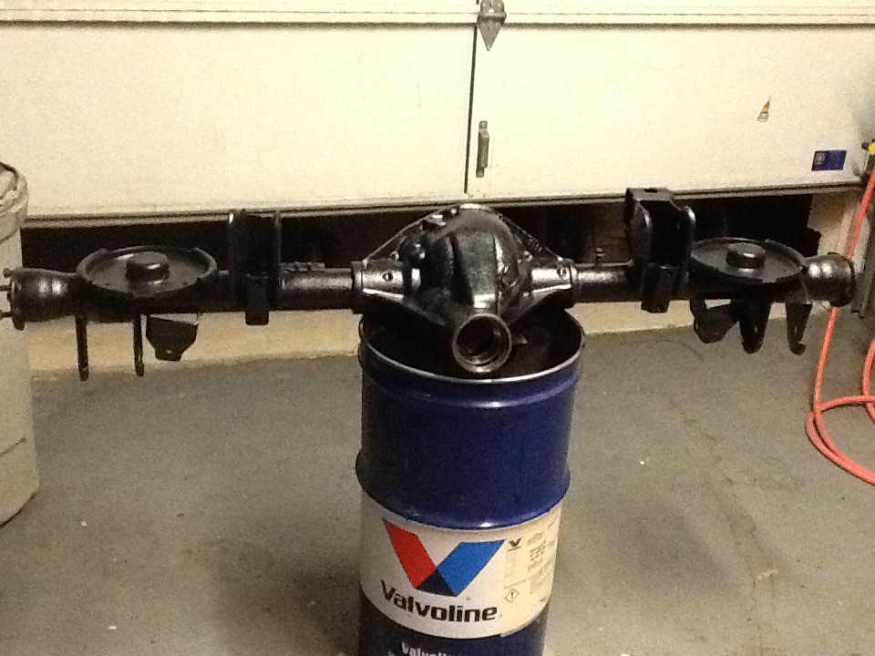

Summer 2016 a guy in one of the local Jeep clubs bought a set of Dana 44 axles but only need the front. I purchased the rear Dana 44 that was pretty rusty, stripped it, sand blasted and painted.
Pressed on new axle bearings with the disc brake retainers.
I was lucky that it was geared to 3:73 and that matched what I was already running. So a little cleaning on the bench.
I was pretty happy with the lunchbox locker I had in the Dana 30 up front so I picked up one to drop in the rear.

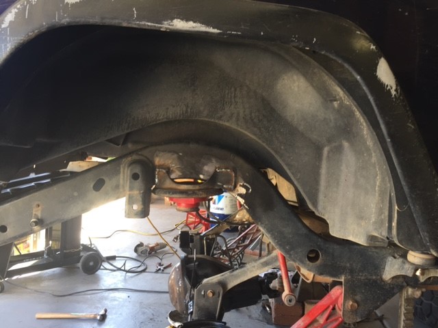

Spring 2017 finally getting the axle under the TJ. While I was at it I relocated the upper spring mounts the straighten out the coil springs. It's pretty easy, just cut the welds, move the seats
A little measuring to make sure your height is right and weld them in.
I also cut the factory lower control arm mounts off of the Dana 44 and welded on some 1/4" heavy duty mounts. Not sure it was needed but I seem to just bash into a lot of trail obstacles. I also did my mini skids at the same time.

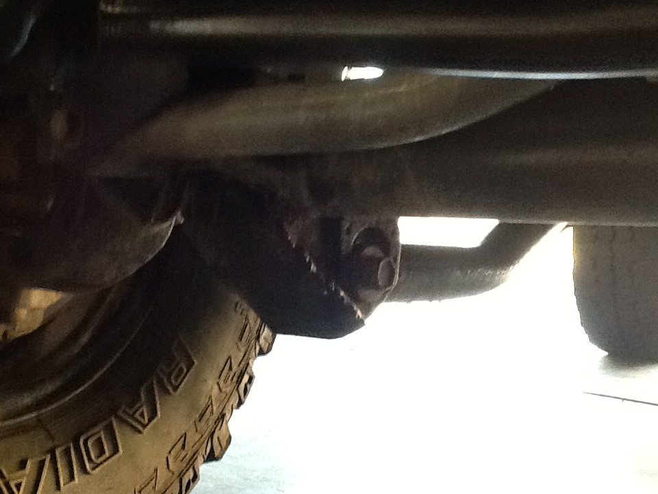

I decide in the ultra-high clearance UCF skid plate. This is a waterfall project.....
First the UCF skid plate
1.25" body lift
Adjustable rear upper control arms
1" motor mount lift
Transfer case shift cable
Teraflex ultra short SYE
Shorter muffler and exhaust pipe modification.
Again no real pictures, however I will tell you that you can run the Ultra-high clearance plate and retain your factory transmission mount. The UCF LOPRO trans mount just was not going to work for me. This was a battle but I won. It was very important to me not to have any vibrations at idle, in gear with my foot on the brake.

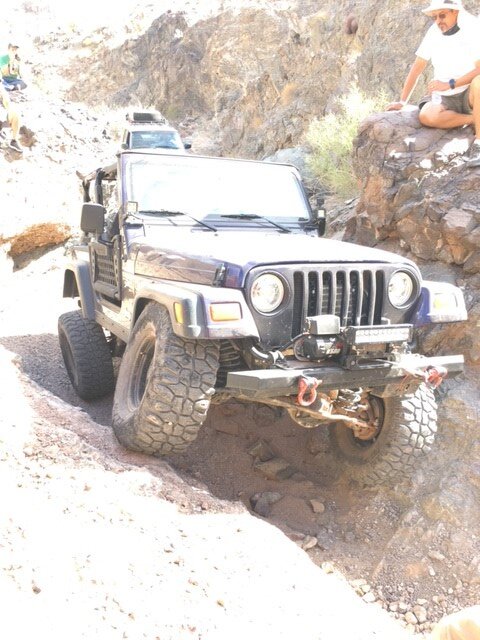

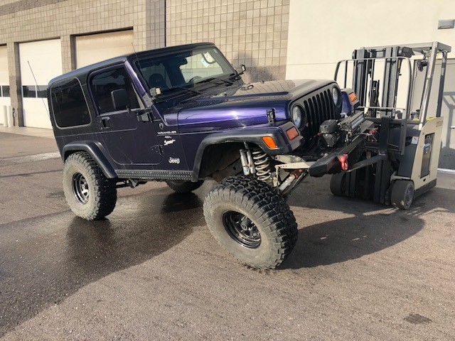

Rock carnage on the trail ended up eating a couple of my Rancho 5000's
I scored a set of four Bilstein 5160's new in the box for a 4" lift TJ for a price I could not pass up. The same guy had a used Anti-Rock and a UCF engine skid that rounded out our deal.
Pretty straight forward install..
A couple obligatory flex shots.....

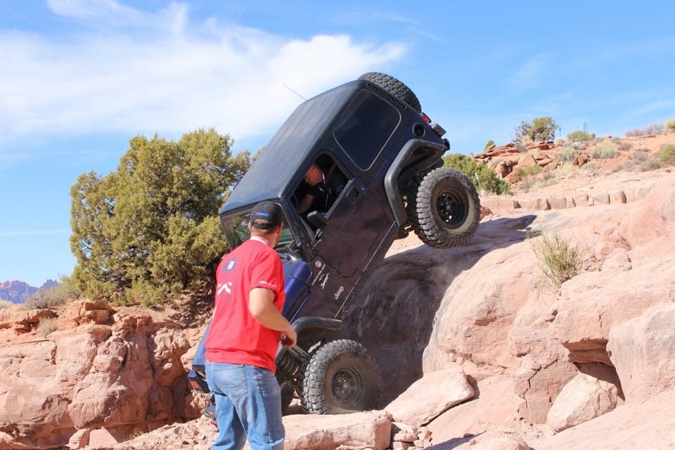

And we are off to Moab to play with the new toys..

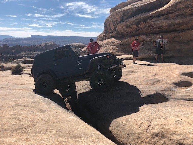

Rear is about a foot and a half off the ground. Landed on the front bumper hard! Pretty wicked drop for a short wheel base. Ledge to the right and big rock on the left. I pulled my air bag fuses before I went over, just in case!
The fall on Steel Bender, isn’t it?
Most short wheelbases use a safety strap from what I’ve seen.
Reactions: RINC
Yes. I think they call it "Dragon Tail" or something. Debbie drove that whole trail except for that drop. All the other short rigs did a safety strap but I was last in line so I just winged it...I have a video of it somewhere. I will post it if I can find it.

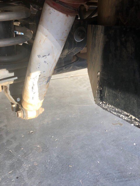

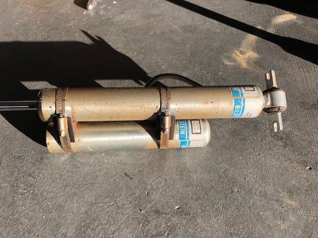

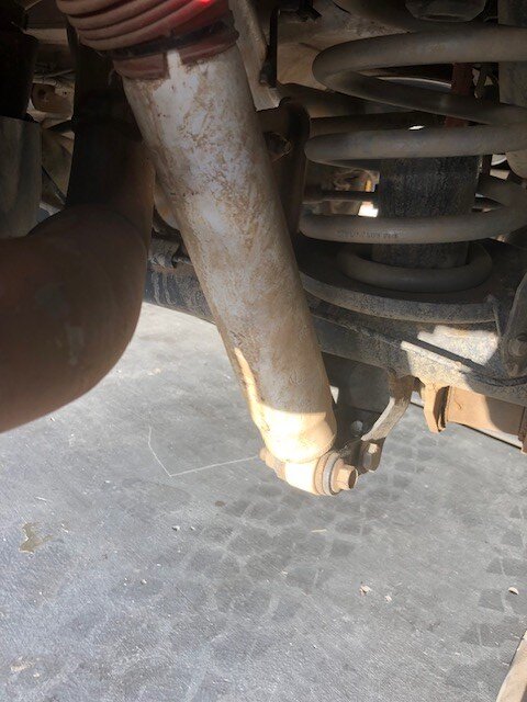

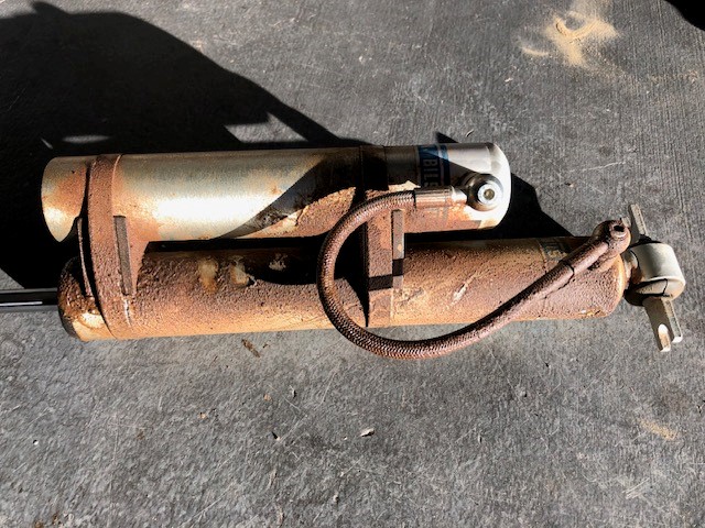

I ran the Bilstein's for a couple months decided I was underwhelmed. They felt ok if you hit something hard or drove it like you borrowed it from a brother in law ! Just driving on the street was fair but on a dirt road or a trail I could feel every rock or pebble I went over. They are really not tunable with the exception of adjusting gas. Oh and they leak! Bad! First on started to leak a month after I installed them. I called Bilstein and was told they are a "Off-Road Performance" part and there is no warrantee. That did not please me so I started a long arduous battle. I used some of my industry contacts and was connected with "The Bilstein Guy" at Toyota. He introduced me to the Industry rep who got my first shock replaced. I ended up replacing three out of the four shocks. Never damaged or abused. They all leaked at the hose bung at the shock body. Now I had run 5100"s on multiple Toyota trucks and never had a problem. One of my employees had a 5100 fail and Bilstein replaced it no questions asked but 5160's whole different ball game.
Any way I continued to run them with no additional failures until I did my out board project.
