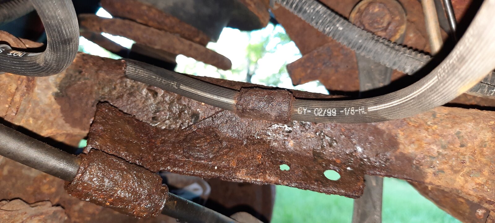

The clamp of the rear flex line is pretty much toast. I have been going through the parts guide and it is not called out. Should I fabricate a replacement or just remove the remains and get on with the job?
Not sure exactly where this is. What is the clamp attached to? The non-ABS parts diagram (Figure 005-520) shows item 5 as 5212 8189 'SHIELD, Brake Line, Tube Rear Axle' but it's not clear if it's the same thing as your photo.
If you can't find one, you could grab a generic brake line clip that fits your replacement's OD and drilling a hole for it in the existing part to snap it in.

That clip is for the rigid line from the right drum. I will leave this for a while as I still need to start work on the actual brakes now. Thank you.
