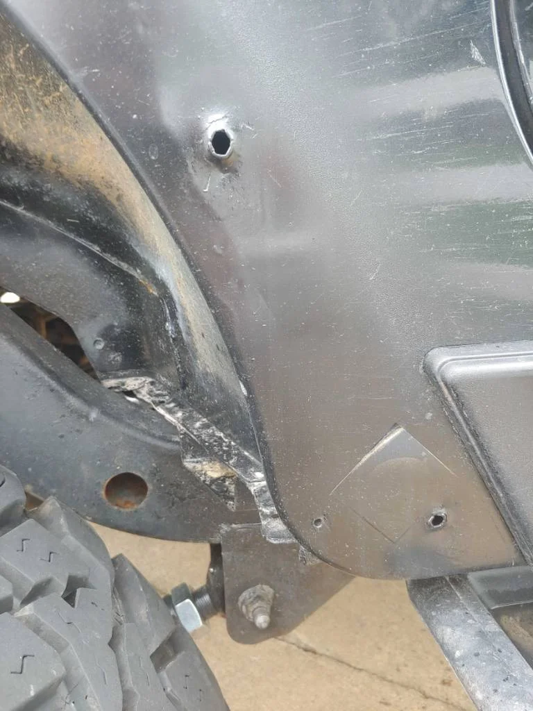

Three for sure, looking at my Jeep right now. Here's the two that can't be accessed. The third one is the last one on the back. As you can see, a PO goofed mine up pretty good. That's the passenger side, on the driver there is one nursert still in place, but the screw is broken off in it. [emoji849]

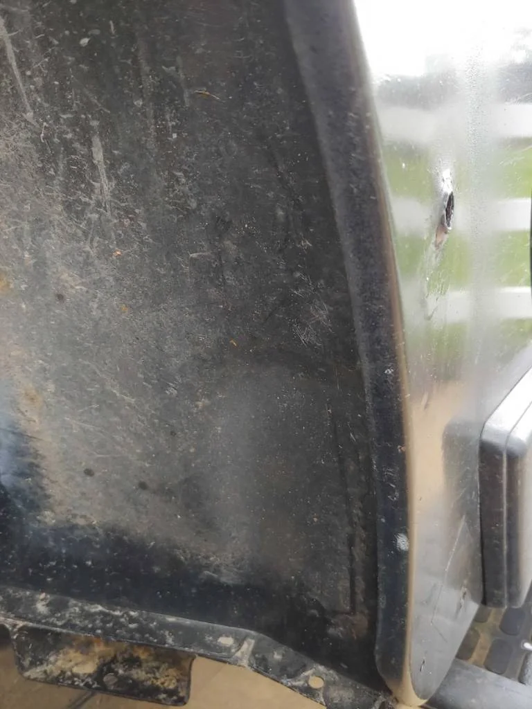

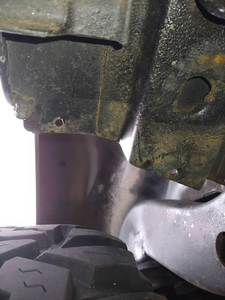

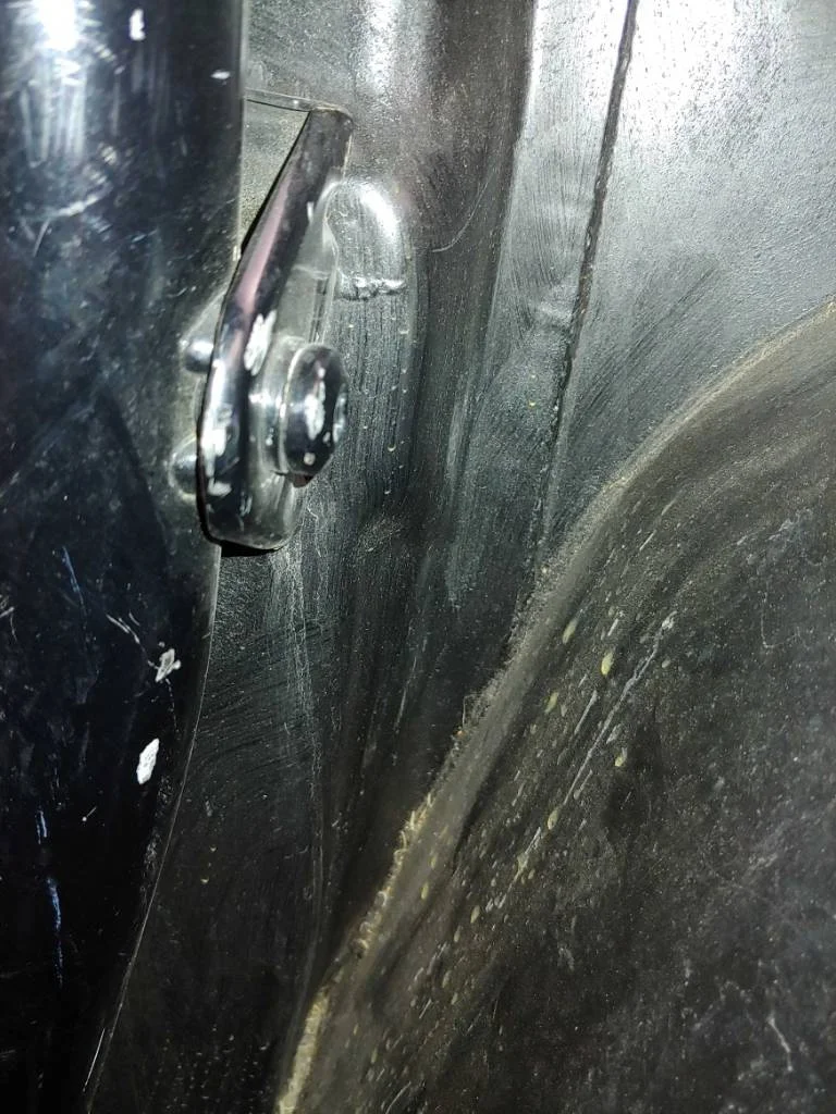

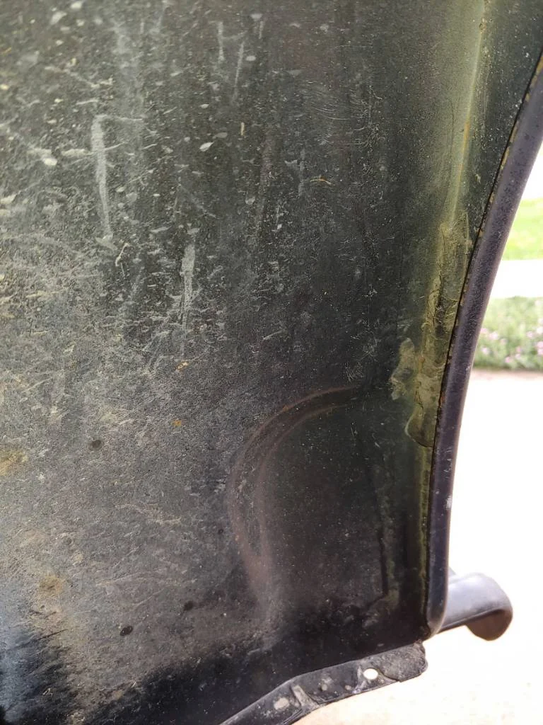

Mine is a '99. Here's a few more pics of where those two holes are. The last is from inside, the holes should be between the fender tub and the roll bar under that metal box/reinforcement. I've had a few other Wranglers of different years, but this was the first one that I've taken the flares off of, so they may all be a little different. I would think the LJ may have a little more room with the extra length, enough to push where the flare mounts away from where mine is. [emoji1745]

Three for sure, looking at my Jeep right now. Here's the two that can't be accessed. The third one is the last one on the back. As you can see, a PO goofed mine up pretty good. That's the passenger side, on the driver there is one nursert still in place, but the screw is broken off in it. [emoji849]View attachment 89443
