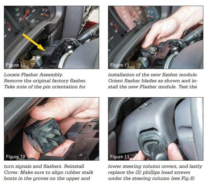

They shouldn't need a resistor. I have LED front turn signal bulbs, headlights, and taillights. I used the EP26 LED flasher relay and don't have any issues.
Does that relay go in the steering column like pictured below?
