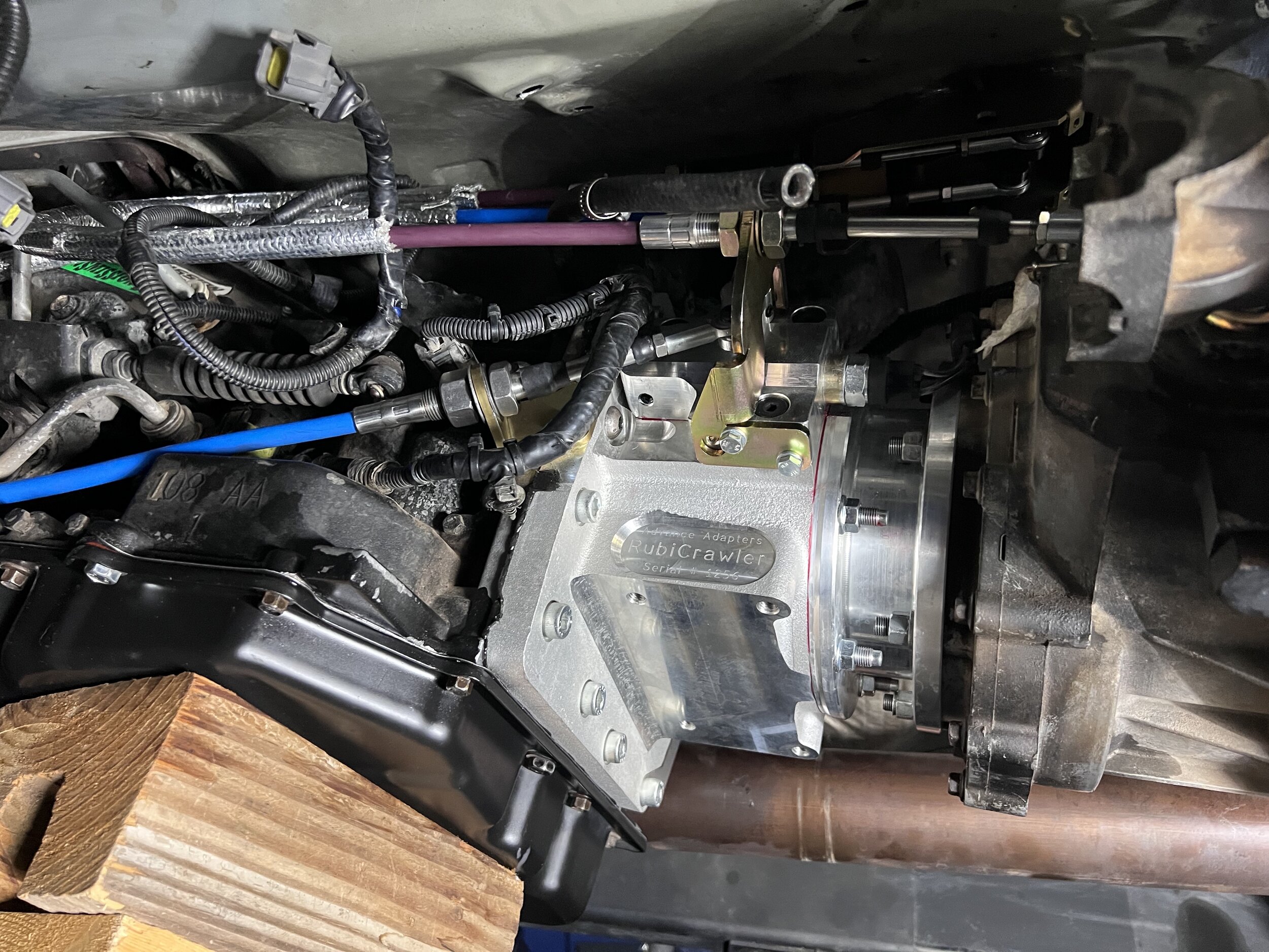

I hear that. My RC install plans were greatly accelerated due to a leak where the tail housing meets the 241OR. Didn’t want to run with the leak for very long or crack the TC off twice since I’ll have less free time moving forward.

Just got the Savvy cross member back in, so I’m on track to finish today assuming I don’t mess something up. Blaine has been incredibly helpful and helped me learn a bunch on this job.
