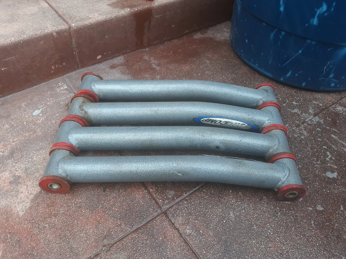

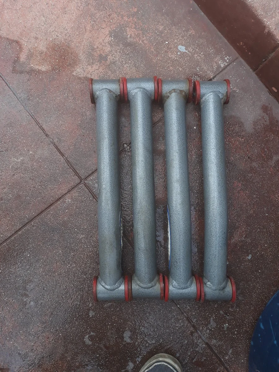

I just purchased 4" lift pro comp springs and lower track bars.
Can I install the 4" lift springs and 4x pro comp for front and rear lower track bars arms without any other parts or mods.

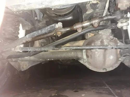

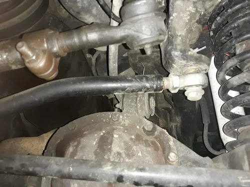

I just checked my rig and it seems it has a adjustable track bar maybe I can make up the 3/4 in with adjustments and not drill. Check photos.
I feel I have the correct parts and a complete kits on the mash up. I'm hoping I don't get any driveline vibration.
An adjustable track bar up front is better than moving the hole 3/4". The hole that gets drilled when using the stock track bar weakens the mount.
You need to tighten the jam nut on that track bar before you have a new issue.
Yeah saw that last night 1st time. Did it already.

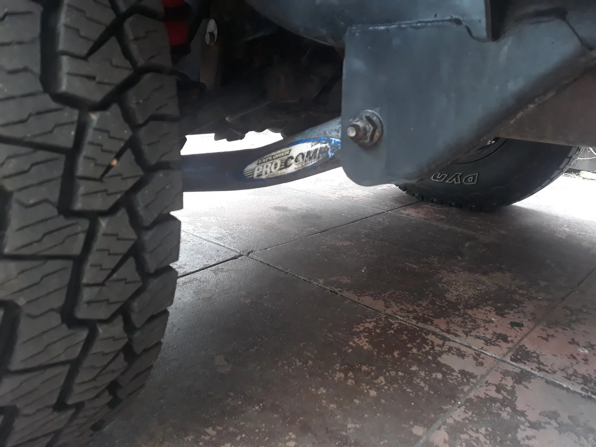

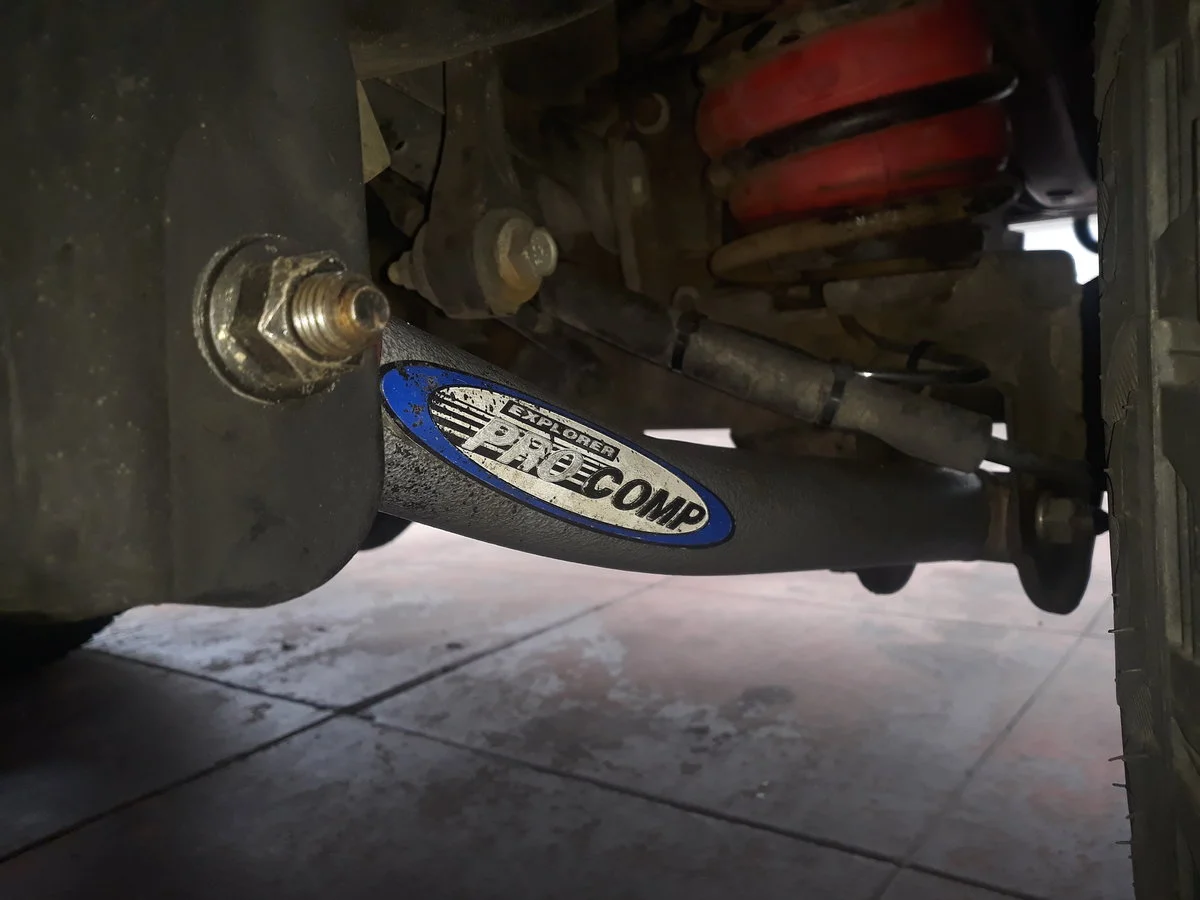

I will do the SYE for sure its definitely on my list of mods. More than likely the next major mod for sure. Tires are last of course but I want 5x beadlock steelie pro comp 17". This past weekend I put on my lower control arms backward of course because I couldn't finding anything online on the direction the arms should be installed until I finished installing the c-arms. Following day pulled it apart and did the all over again.
Happy with the results car tracks better on the road noticed the old rubber bushing old arms we're on the way after replacing parts. I guess 17 years on stock parts is a good time to replace rubber anything.
For a reference the long length of the track arms should tie into the axles for front and rear.
