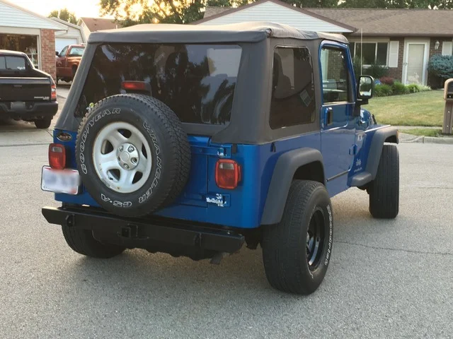

These are not my current tires. Just posting to show how bad the skateboard look really is =)

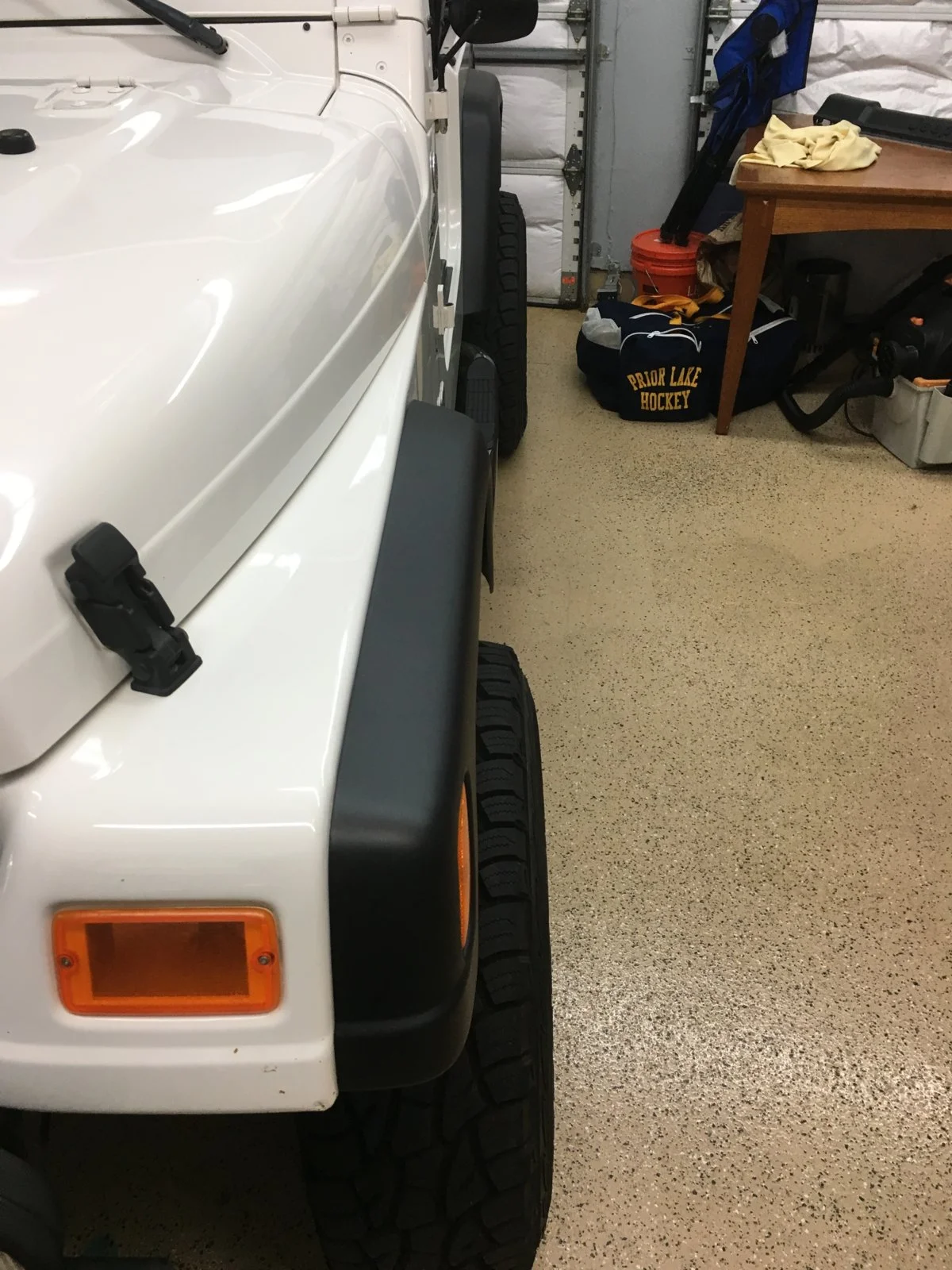

These have 4" backspacing. 15x8 wheels.
I like a little skateboard look....:)[/QUOTE]
Thanks for posting the picture. It is kind of difficult to tell at a slight 3/4's view. Do you think the 1" extra flare of the Rubicon fenders are enough to get rid of the skateboard look?
I can get a different pic when I get home tonight. But I think the factory wheels have about 5-5.5" of back spacing, depending on the wheel. So the 1 inch wider flares should cover well.

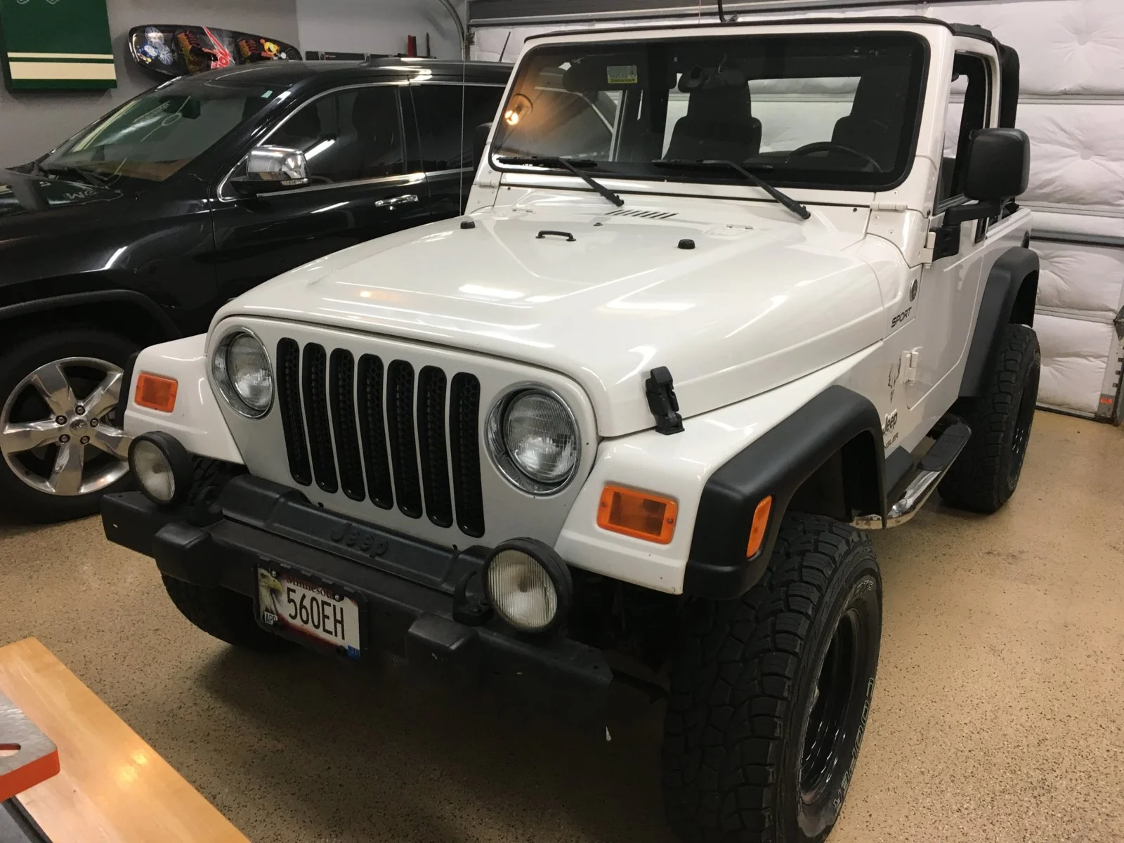

here is a little better pic
Thats about perfect. Bout an inch and a half outside the flares. 4" back space
