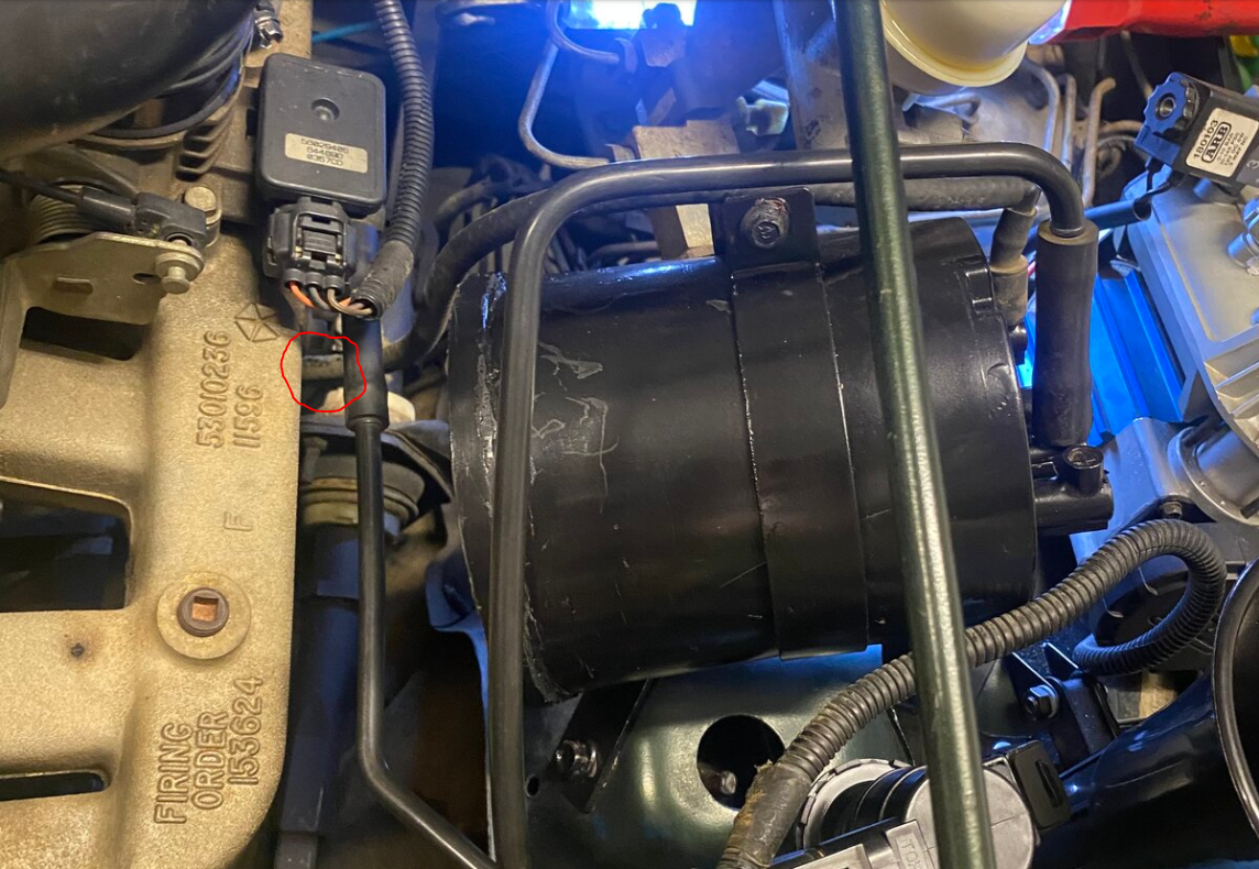

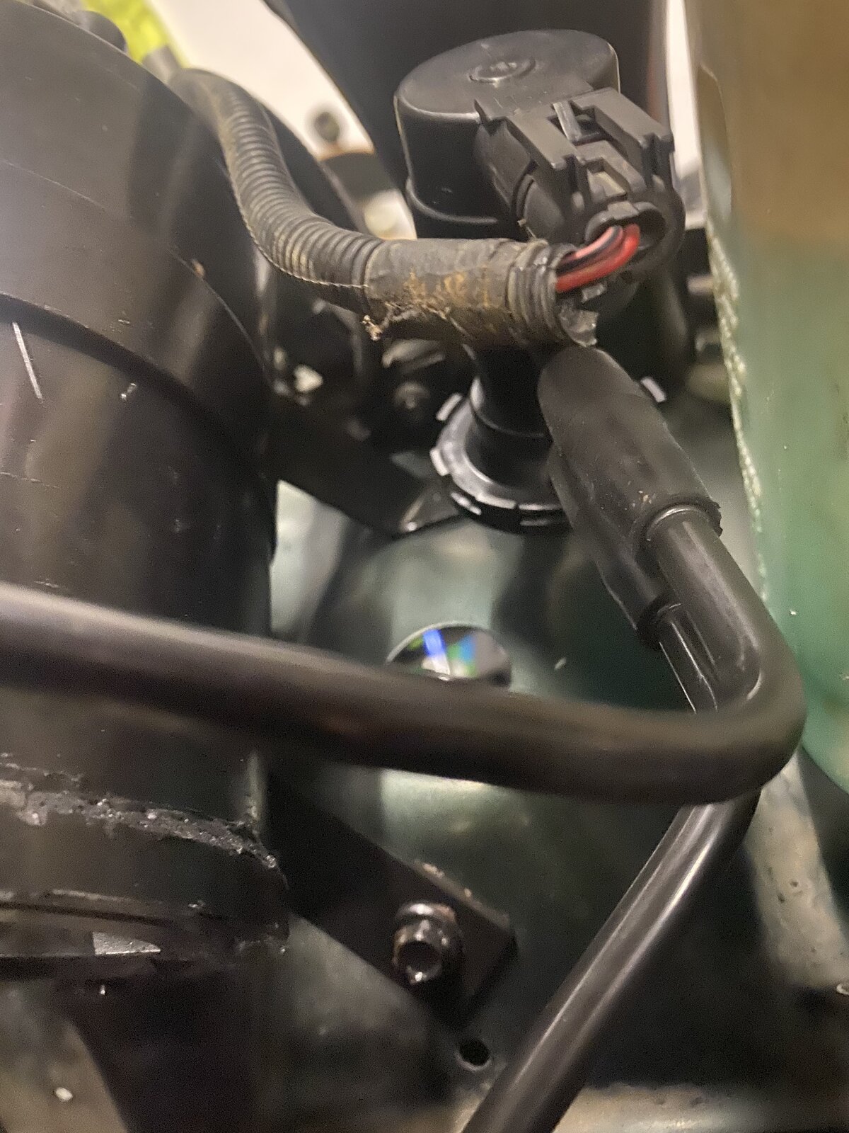

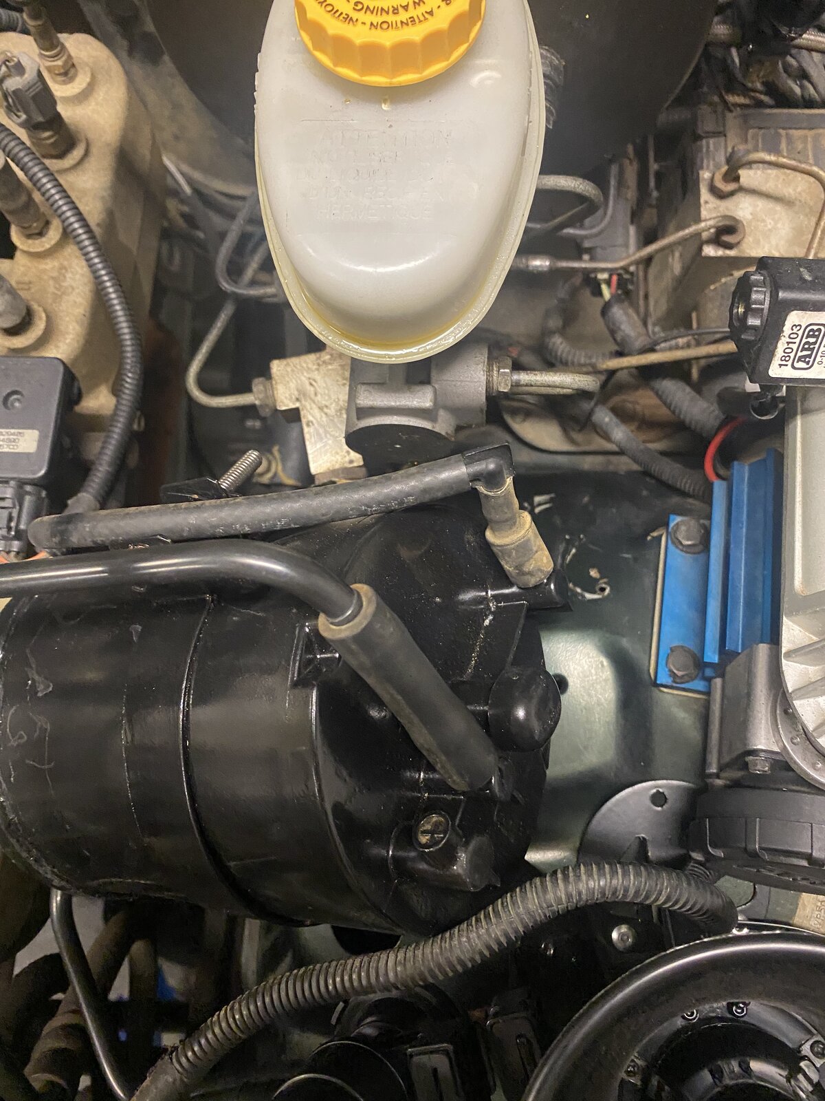

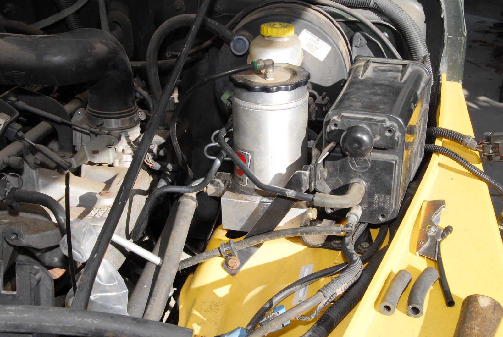

I have attached some pictures from 97 Jeep evap system. I just had to rebuild the canister.

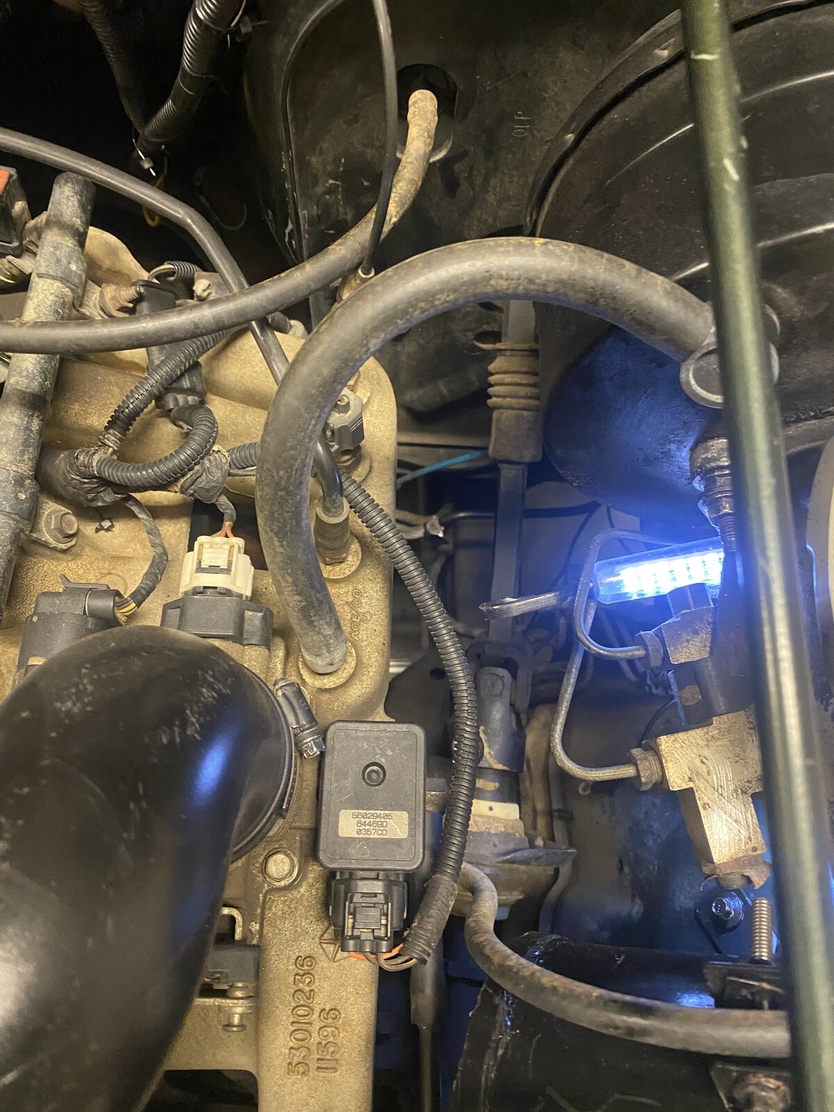

In this one, the 3/8" vacuum line connection at or near the manifold, what does that connection look like where the rubber hose ends?

I have attached some pictures from 97 Jeep evap system. I just had to rebuild the canister. View attachment 292585View attachment 292586View attachment 292583
BTW- I forgot to say thanks for the pics and I have a couple more questions. How does one rebuild a charcoal canister?

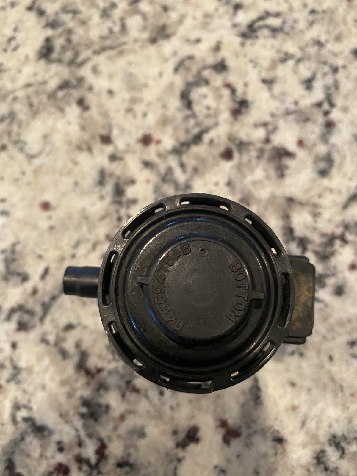

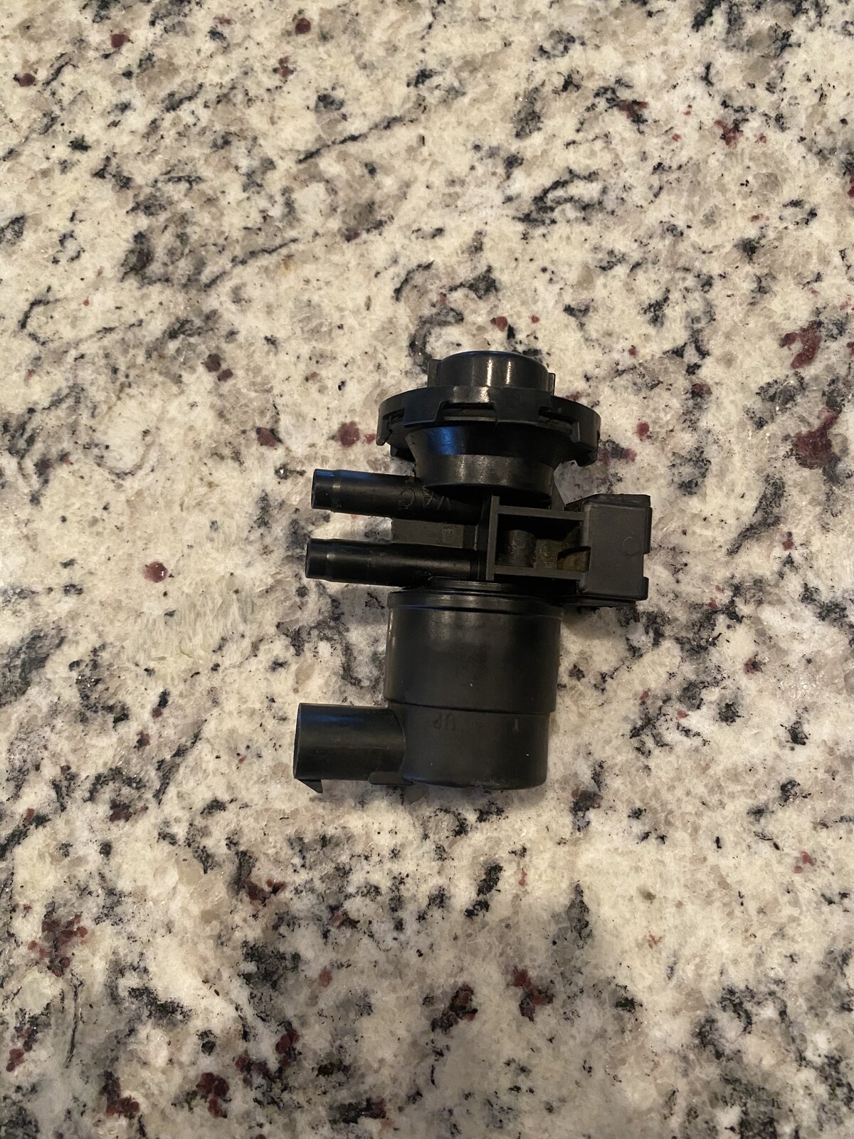

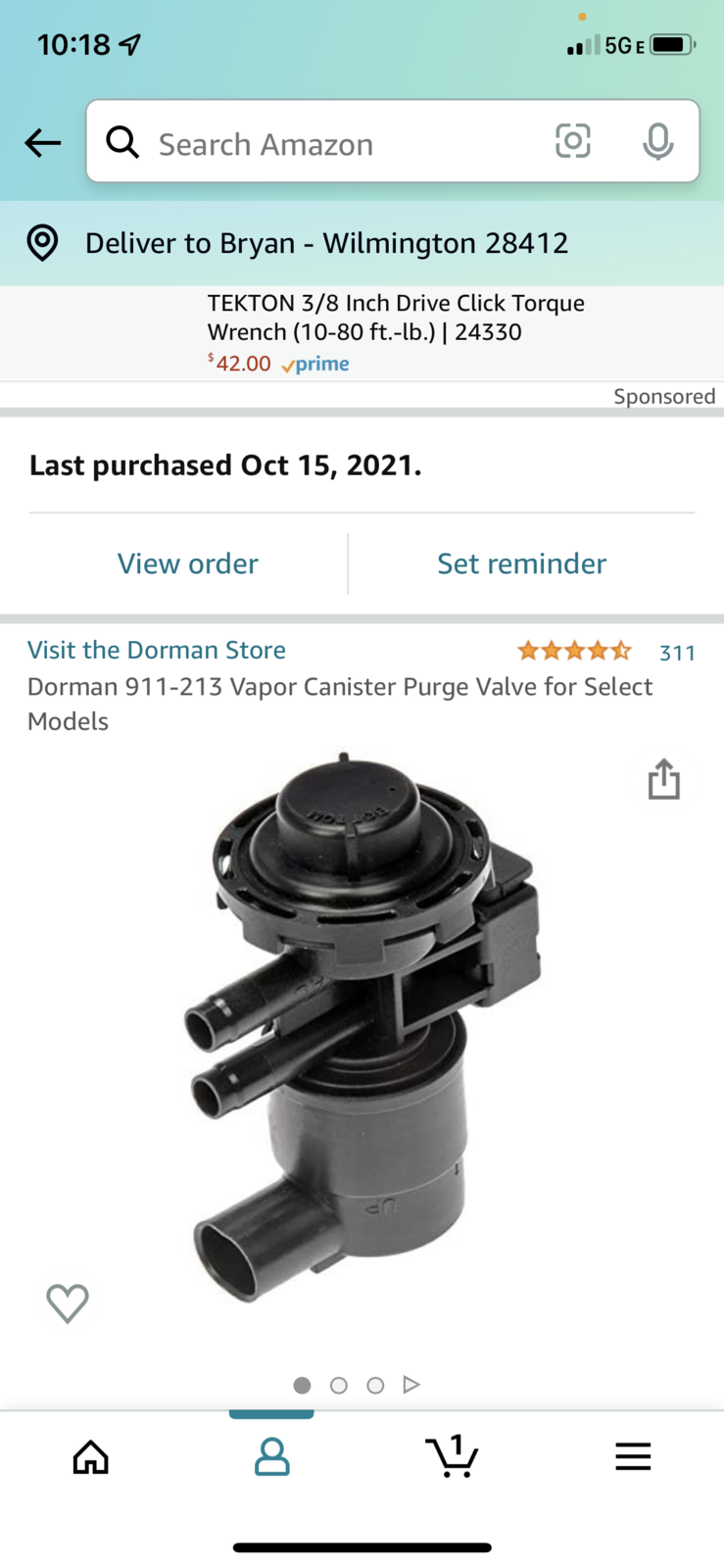

Is your purge valve the one it came with or has it been swapped out? Reason I ask is there are two versions. Has to do with which end is up, and how it is marked. Some have the small end up, some have the small end down. Some are marked TOP like yours and some are marked BOTTOM.

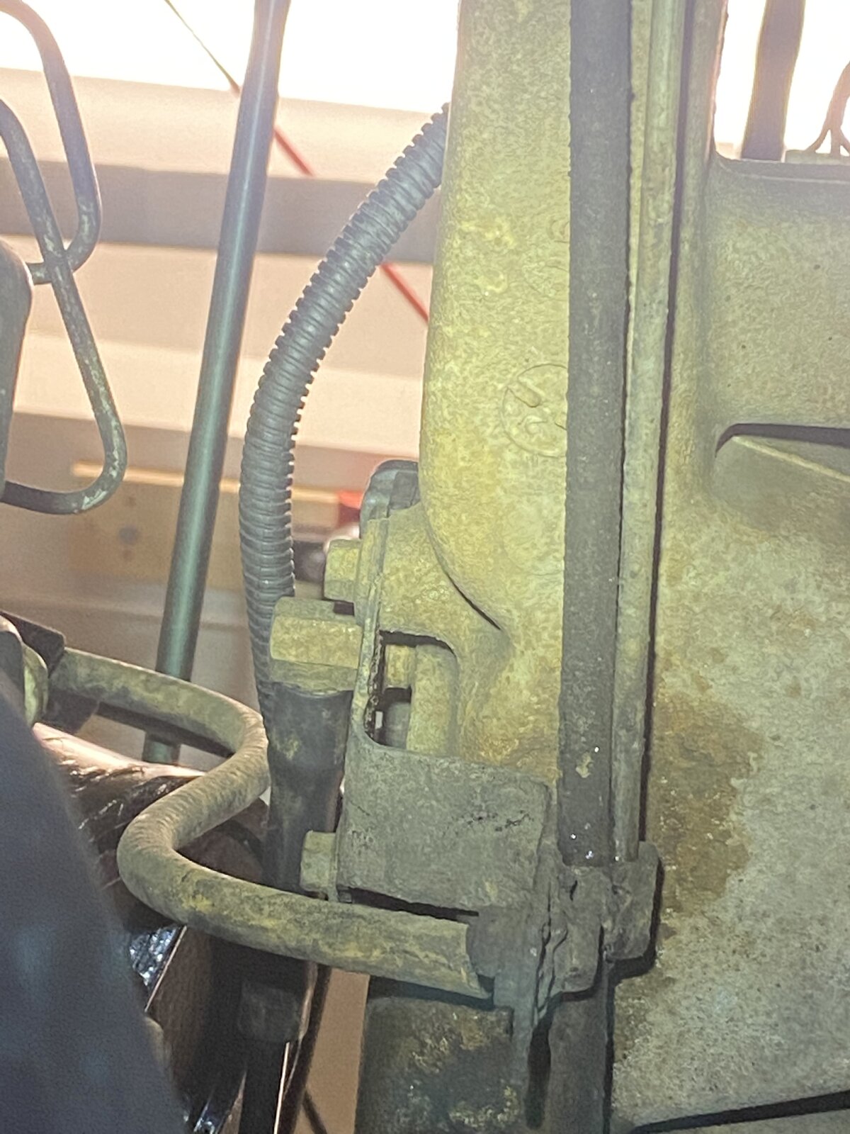

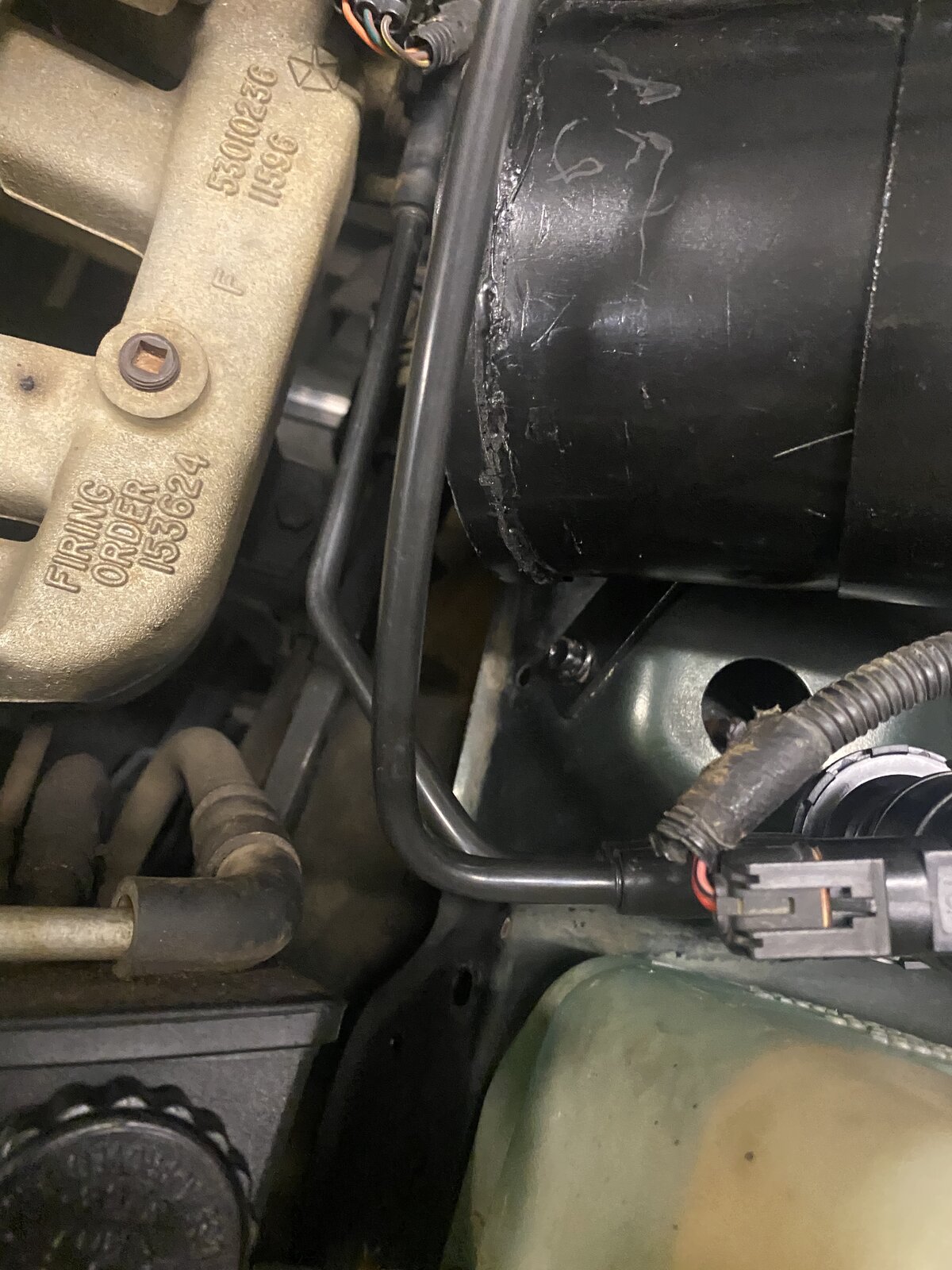

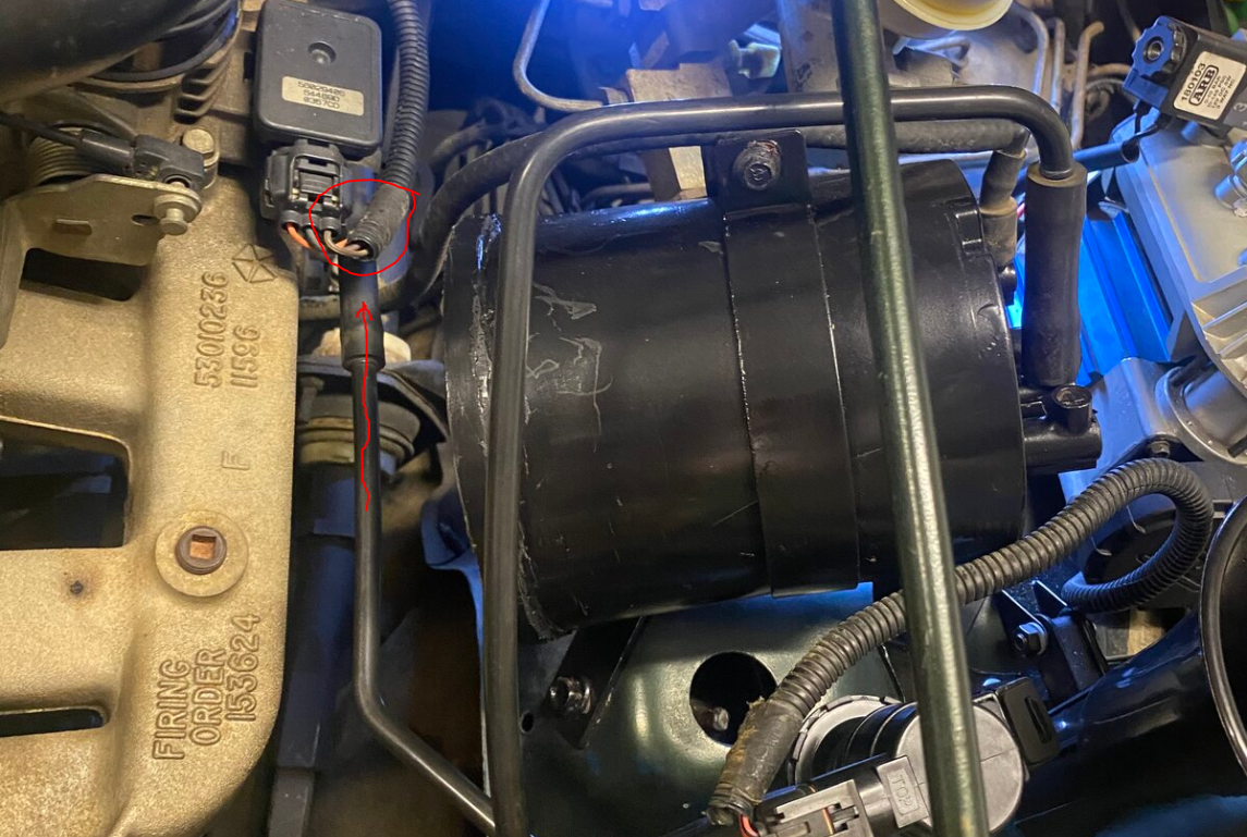

Thank you. In the pic below, does that hose connect to the 3/16" hard line that comes up the frame from the rear of the rig, runs parallel to the fuel line and then does a 90 degree bend to point at the canister?
Yes. There is a bracket under the intake manifold where the line turn 90 degree and go to canister. Above the bracket is input of 3/8 line in manifold by a fitting.

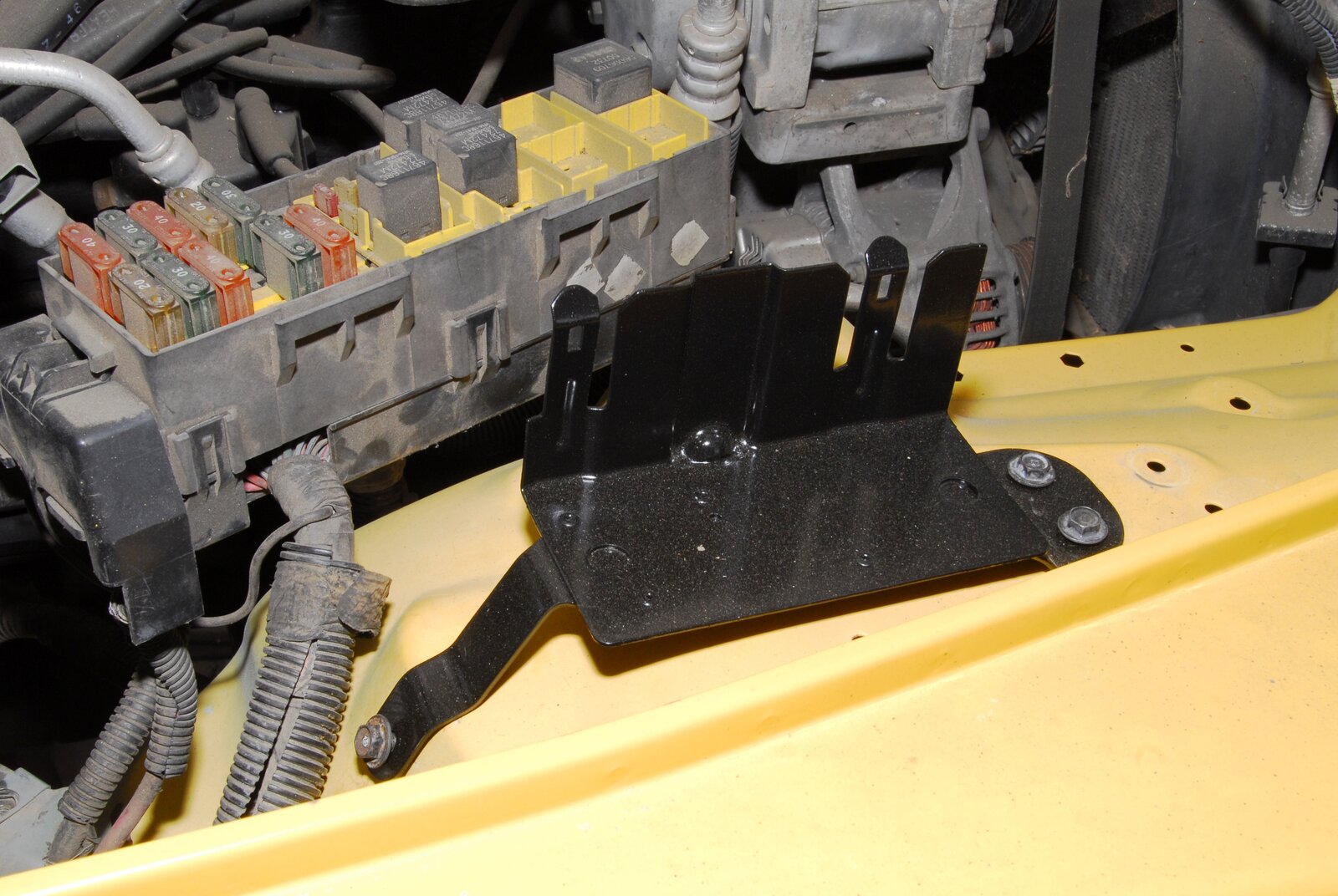

If someone wants to post up a pic of their PDC bracket, my 97 is the two finger mount, later ones are 4 finger but I don't know if that is a 97 only thing. Has to do with on some at least if the lid opens from one side or one narrow end.

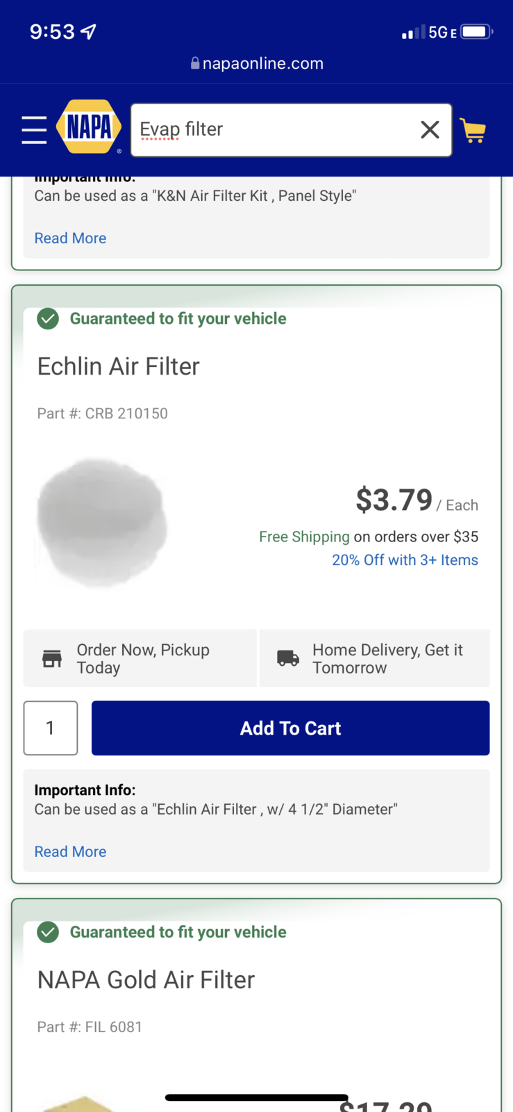

Your welcome. I have my Jeep since brand new. I just replaced the purge value. I keep the old one with part oem part number on it. I purchased the filter from Napa and new purge value. My canister was leaking charcoal into purge value. I cut the bottom seal off with a hand saw and clean out filter materials. I epoxy it back together.

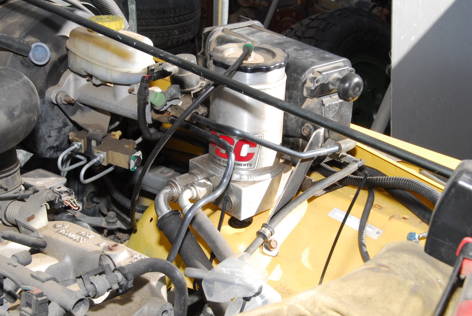

Being aware of the difficulties sourcing a new canister, I'm trying to convert mine to the later style. That and I like using the bracket as a mount for the PSC steering reservoir.
