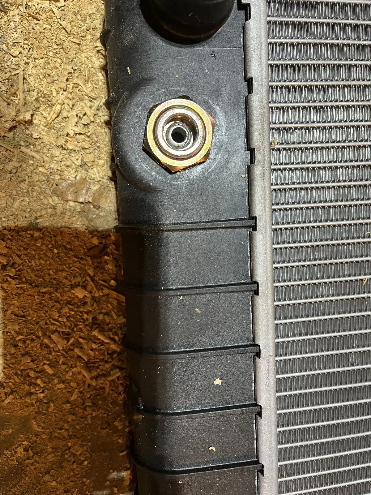

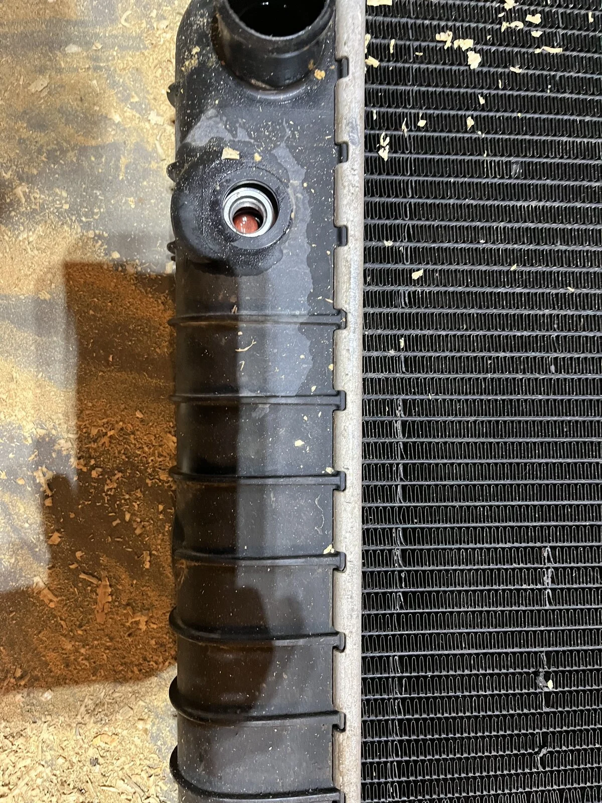

I think I’m learning the hard way about AZ radiators. The attachment for the transmission lines is slightly different and for the life of me I cannot get them to connect. Left is the new one, slightly different, but I figured it would work. Unless I’m just not lining it up right, it seems the new one is too deep for what is coming from the trans. Am I missing something here, or is there a way to make this work?
Poking around on here am I correct that the new radiator has quick connect fittings, so I will need to use cut my hose and clamp it? Of course the fittings currently going in are metal, so I’m going to need to get more hose, and couplers. Seems rediculous for what should be a simple job. Looks like I need 11/32 transmission hose and a hope/prayer they have couplers that size.
I did find a similar thread with a potential solution, not exactly sure how the Doreman connector works though. This seems to be for the opposite problem, male end is coming out of the radiator so this doesn’t make sense to me.

Just wanted to close this out, for whatever reason I was not realizing that the metal screw coming of the metal connecter from the trans was the same clip style as the Dorman part. Once that was made clear, I unclipped the old connector and clipped in the Dorman which screwed into the new radiator. Everything is sealed and working as it should. I appreciate the patience and help from the forum to fix this. It really was obvious, but just wasn’t registering in my grey matter.
