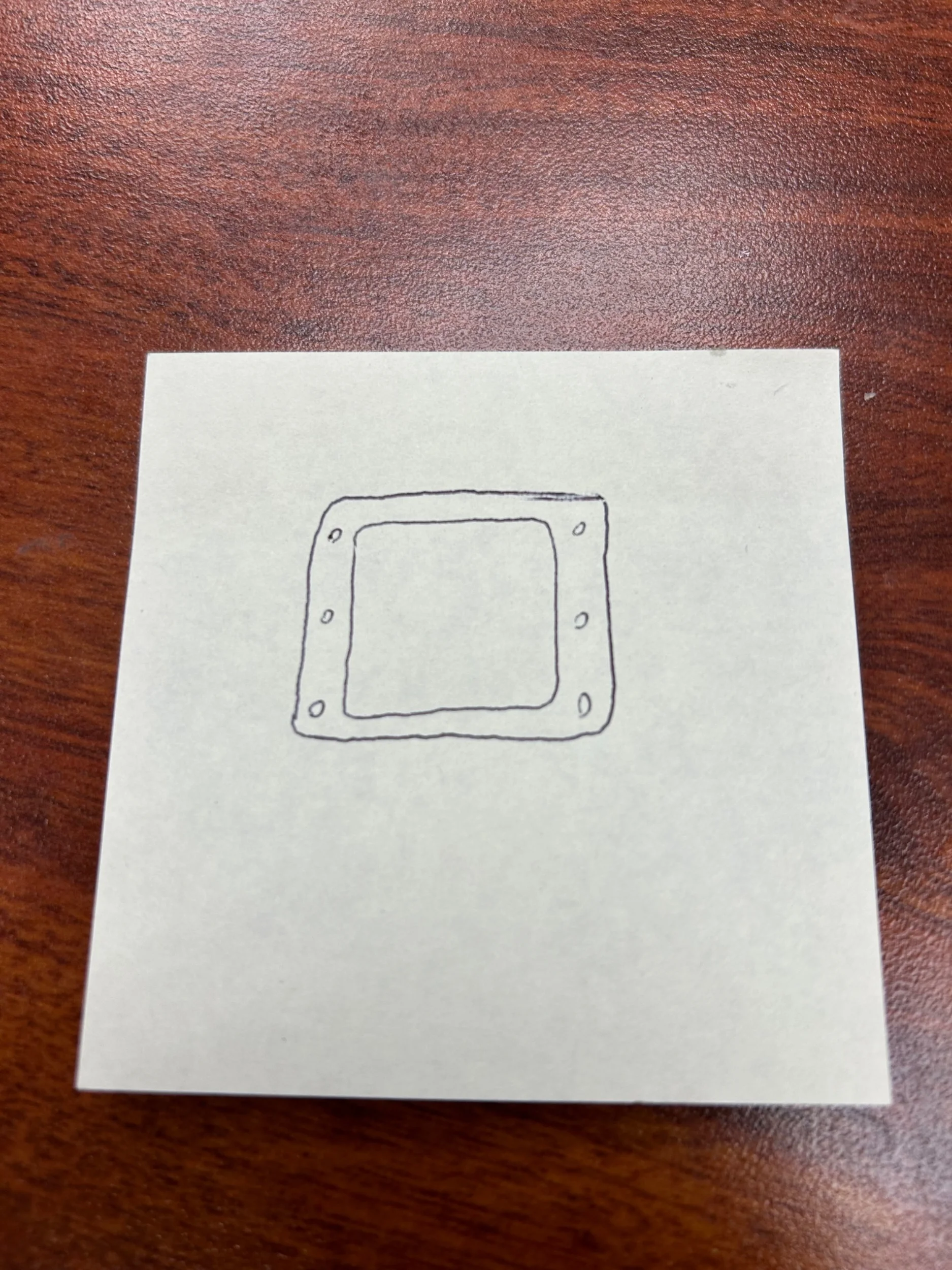

I have now cracked open my radiator twice and I am fairly certain it is the fact of an aluminum radiator mounted to the flexing grill and causing the tubes to crack at the tank. A stock plastic tank radiator is out of the question because LS. I am now considering my options, one of them is making a cradle mount where the radiator can sit "loosely" or having a thick plate laser cut that matches the mounting pattern on the grille and will stiffen the area where the radiator will be. I also considered the idea of making some kind of extension where the radiator can mount to the frame directly but that seems like it would be too much of a PITA to attempt and there is just not a lot of room to work with. I would like to try and repair the radiator again instead of spending hundreds on a new radiator, but I want to make the mount better and hope that fixes the issue.
Has anyone had these issues of too much of a flexible mount on too rigid of a radiator?

I wonder if you could rig up the mounts using rubber isolators with studs at either end to allow some give. Pretty easily available on McMaster Carr, scamazon or the like.

As stated, you likely have something else going on. And as you noted, the stock radiator has a plastic tank and it never fails due to the grill shell flexing which would rip the little square nuts out of the molded in pockets they live in that attaches the radiator to the mounting flanges. They are not very robust and the grill shell is very stout and not prone to flexing at all.
