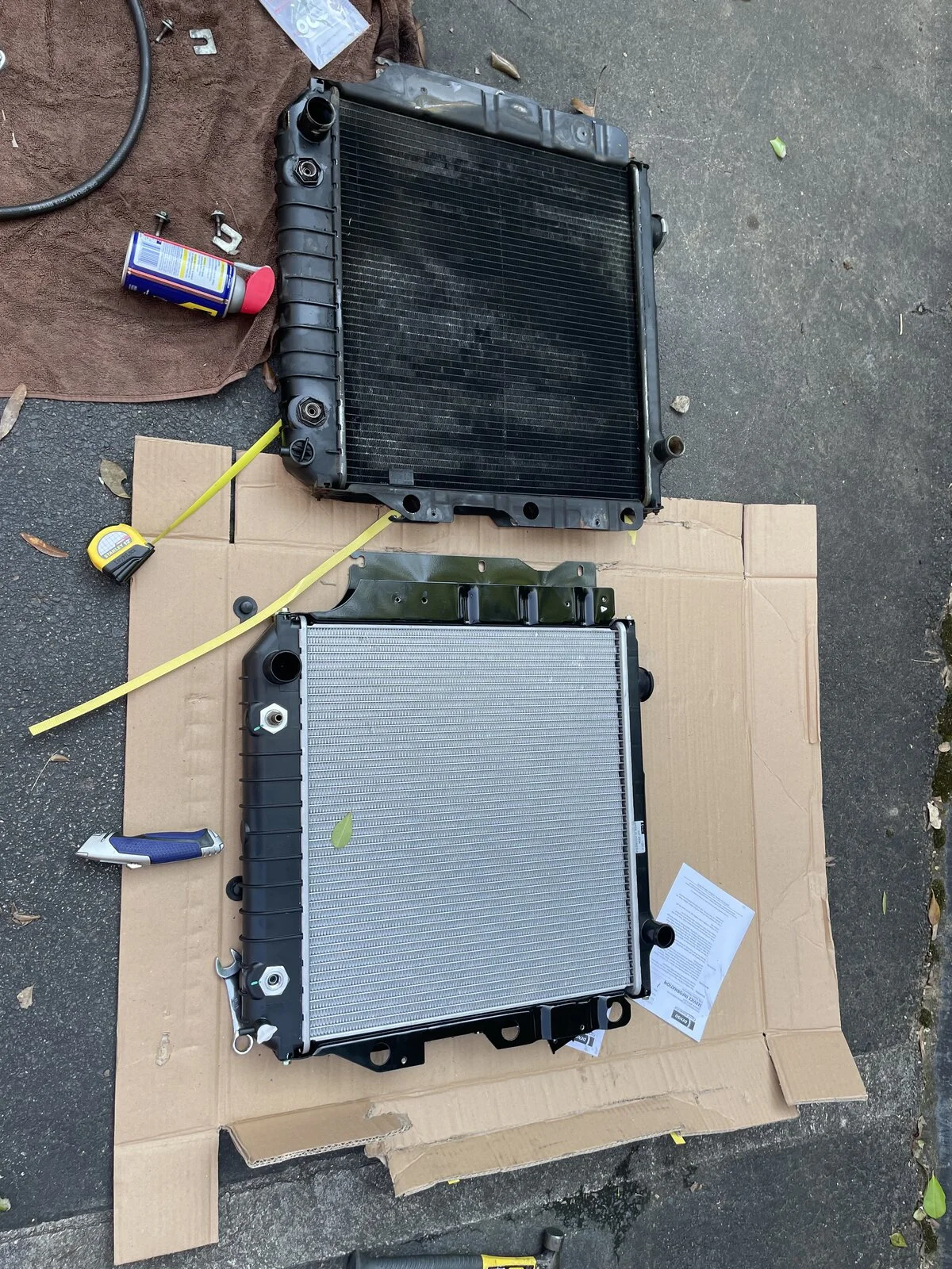

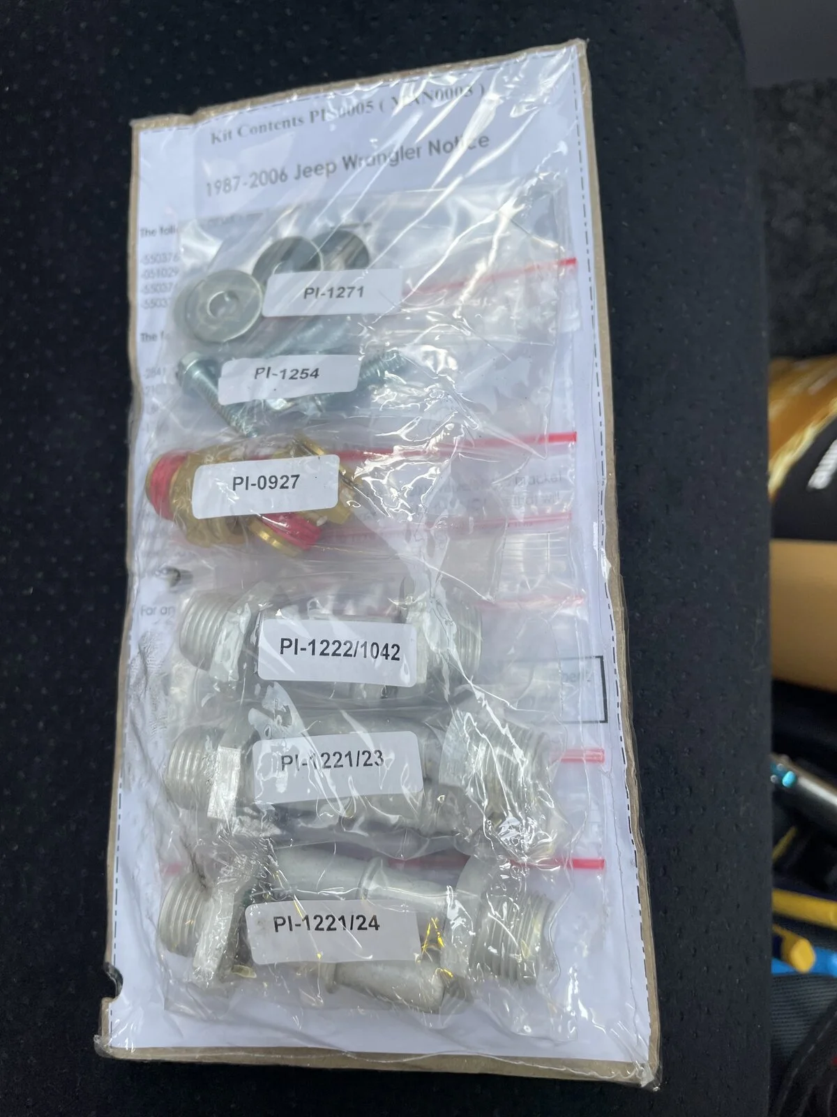

Replaced mine today with a Denso. Fit like a glove. It came with a host of fittings for the tranny lines but I used my my originals which also fit perfectly. If you haven’t done it before, the bottom 2 bolts on each side of the radiator don’t need to be completely removed, Just loosened enough to slide up the old radiator and slide in the new one. The radiator will then rest on those while you get the others started You can see the slots in the pic.

Also changed the belt and hoses while i was at it and flushed the system. Repaired a leaky tranny line that I didn’t know I had too. Used a couple of 3/8 inch compression to hose barb fittings.

Almost forgot. Remove the breakaway flap if you have a/c.
