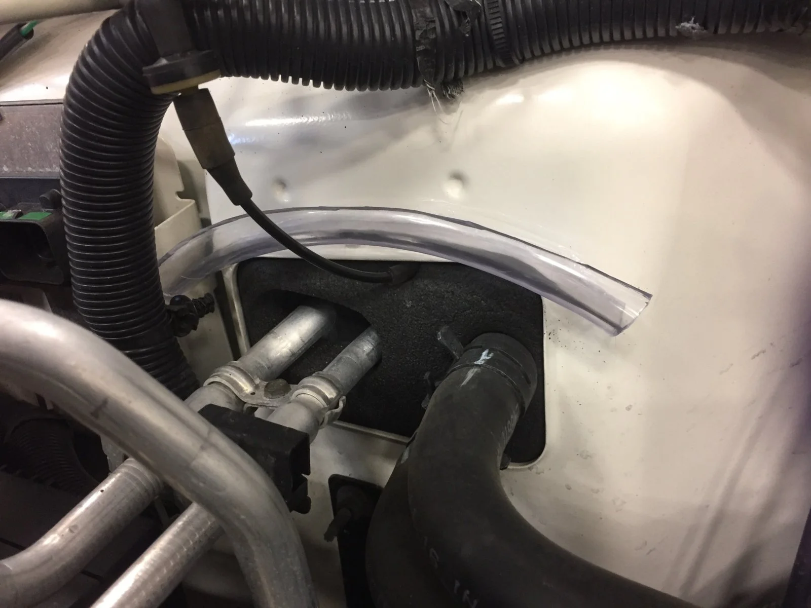

My passenger side leaks from the HVAC seal all the time it rains, I move the carpet up when its going to rain. Most likely yours probably leaks from the HVAC seal as well.

Mine would do the same thing when I picked it up in December. I methodically moved my way up the firewall with a syringe until I found the guilty party. Like @lxxtsy my leak is where HVAC/heater core inserts into the firewall. It would only leak when parked and raining. Quick fix was a small gutter over it attached w/silicone.
