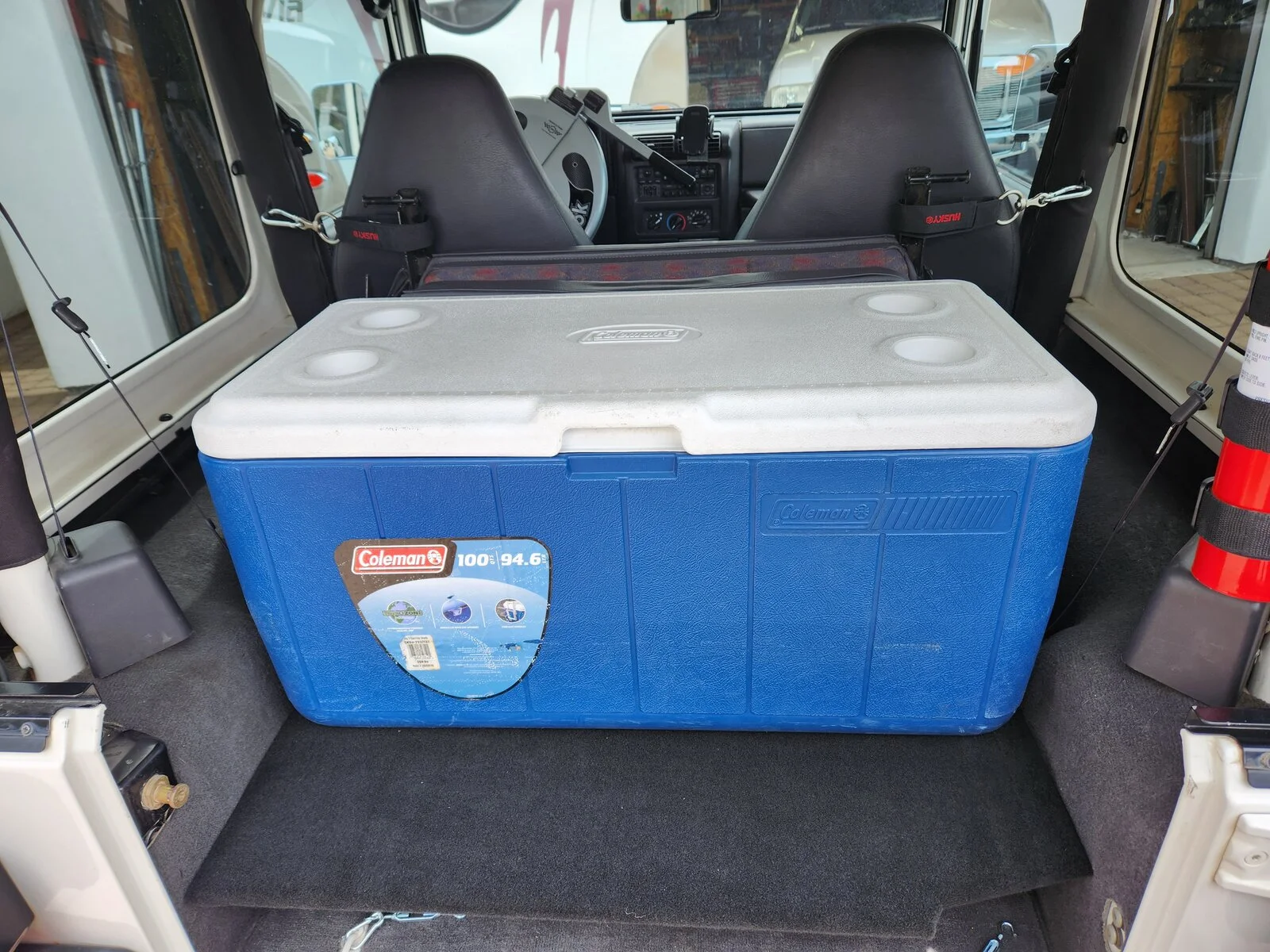

When the back seat is out or folded there is still the seat belts and seat belt mounts, and the seat brackets which make the floor not useable for a large ice chest. I have an ice chest that fits perfectly except for the seat brackets and seat belts but if I build a raised platform using 1x2s and 1/4" plywood it will raise the floor and make it smooth for cargo. Before I build it just checking to see what others did, maybe there's a better solution? (A smaller ice chest is not an option)

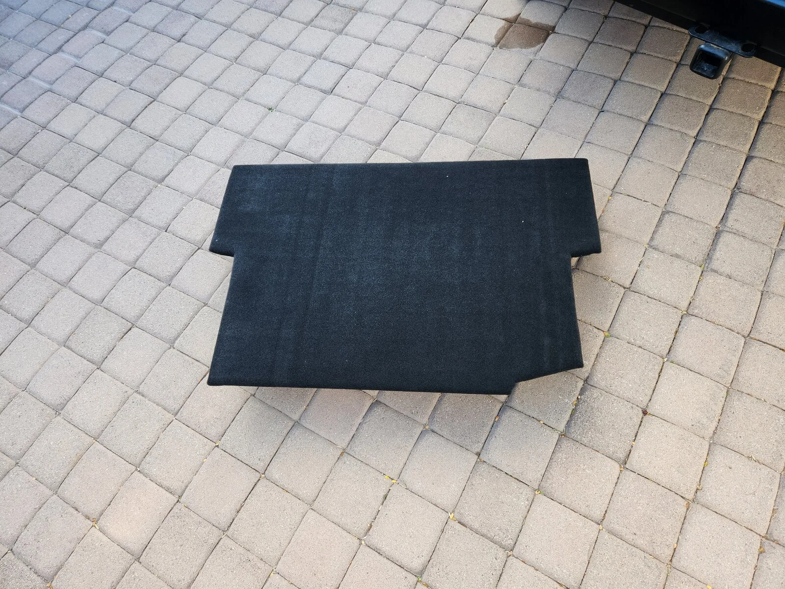

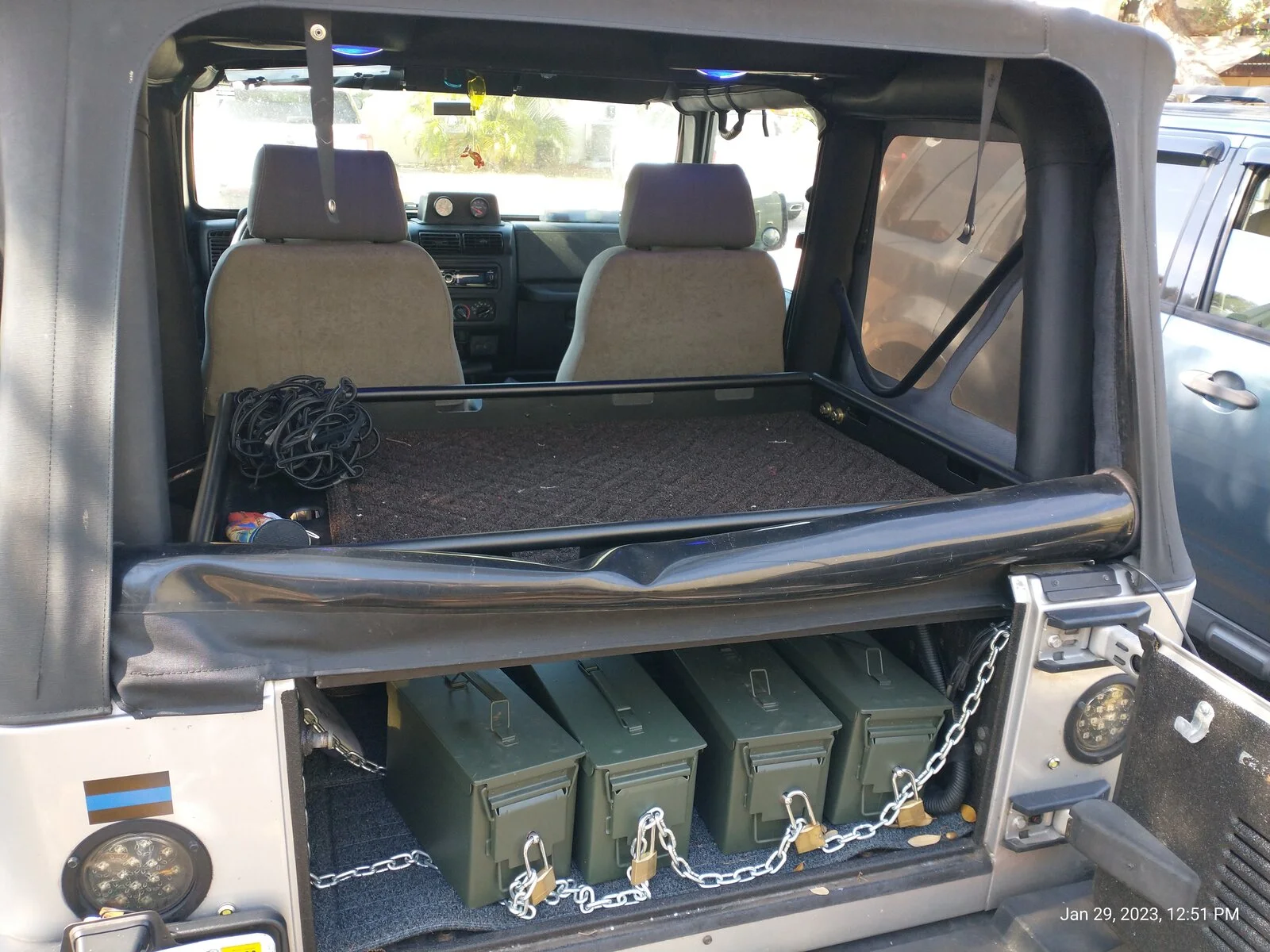

I made a 6" deep platform for tool storage underneath, and anything else on top, here.
Wow thanks for the link to your thread, lot's of good info there and I bookmarked it. My woodworking skills are not quite as good as yours but I can do OK and your platform gave me good ideas. I can work with steel so the bracket fab will be easy. I need to examine my springs and bump stops as well and your thread goes into great detail on that. I thought my springs were stock but not 100% sure, it doesn't look like I have a lift but two things make me think I might, there is a short throw shifter installed which I read solves the shifter and boot issues after a lift, and my transfer case linkage needed adjusting to get into LO which I also read can be the result of lifting the ride height. I will go over your thread with a fine toothed comb.
My platform works pretty well, but is not ideal. If I need something in there, I have to unload everything on top to get the lid up. Drawers at the rear would be nice, but might take a lot of work. But hopefully it may give you some ideas.

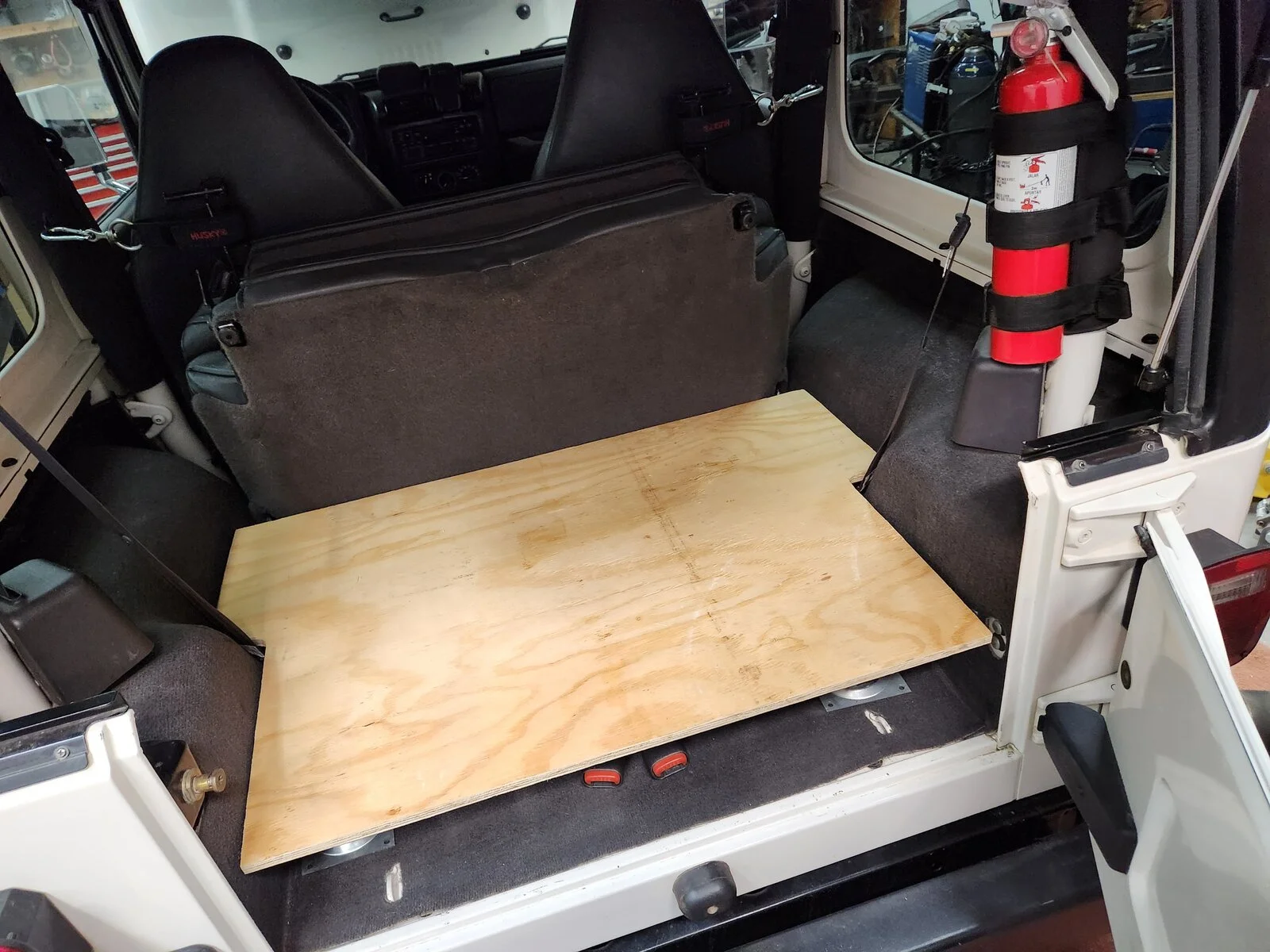

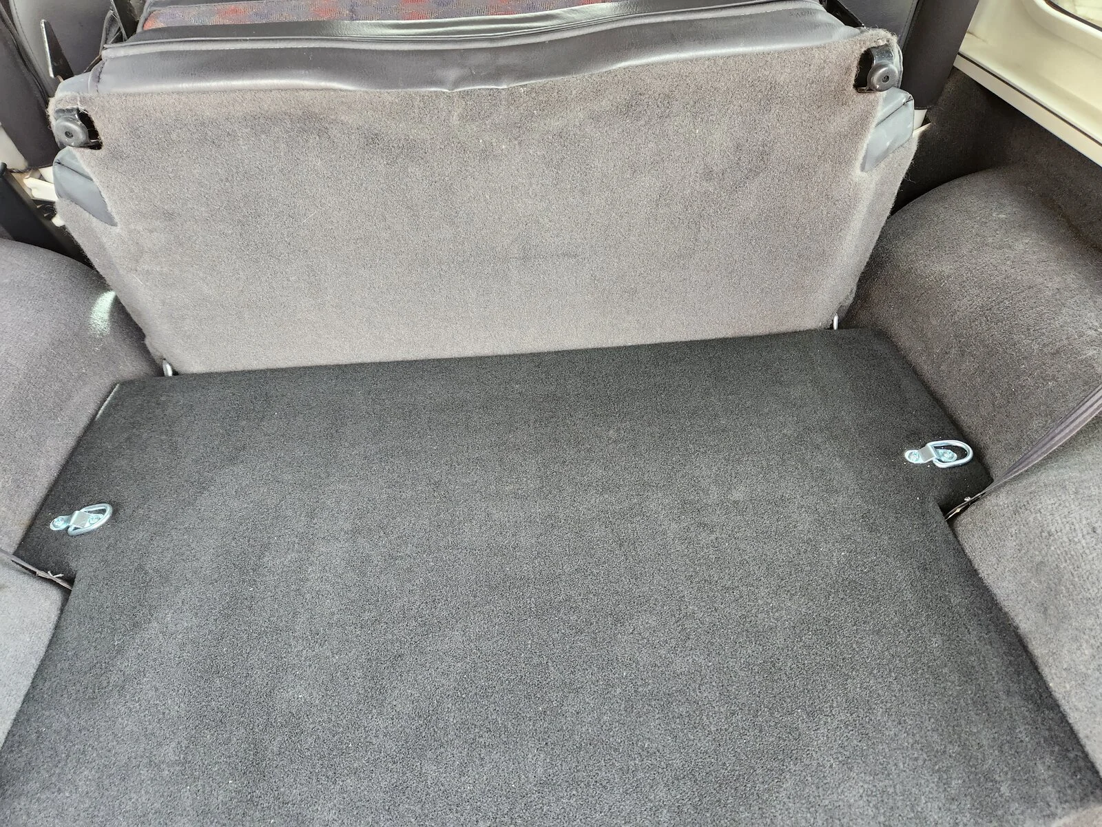

I built a platform for the back of my Jeep. I installed some tie downs in the floor. The built uprights that contoured to fit in the seat tracks. The top has 1”x2” pieces to sandwich the uprights. Then that turnbuckles down to the tie downs then the front piece is bolted on. I made deck tall enough for a bottle of oil to stand upright underneath. The front piece is about 3” taller than the deck to keep items from sliding forward and the tie downs on the deck attach to he turnbuckles underneath down to the floor. I had he seatbelt retractors in it but have taken them out. I would also remove the center buckle just to be able to slide my gear underneath. It comes in and out with 6 bolts and about 10 minutes.

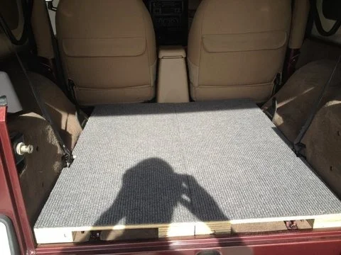

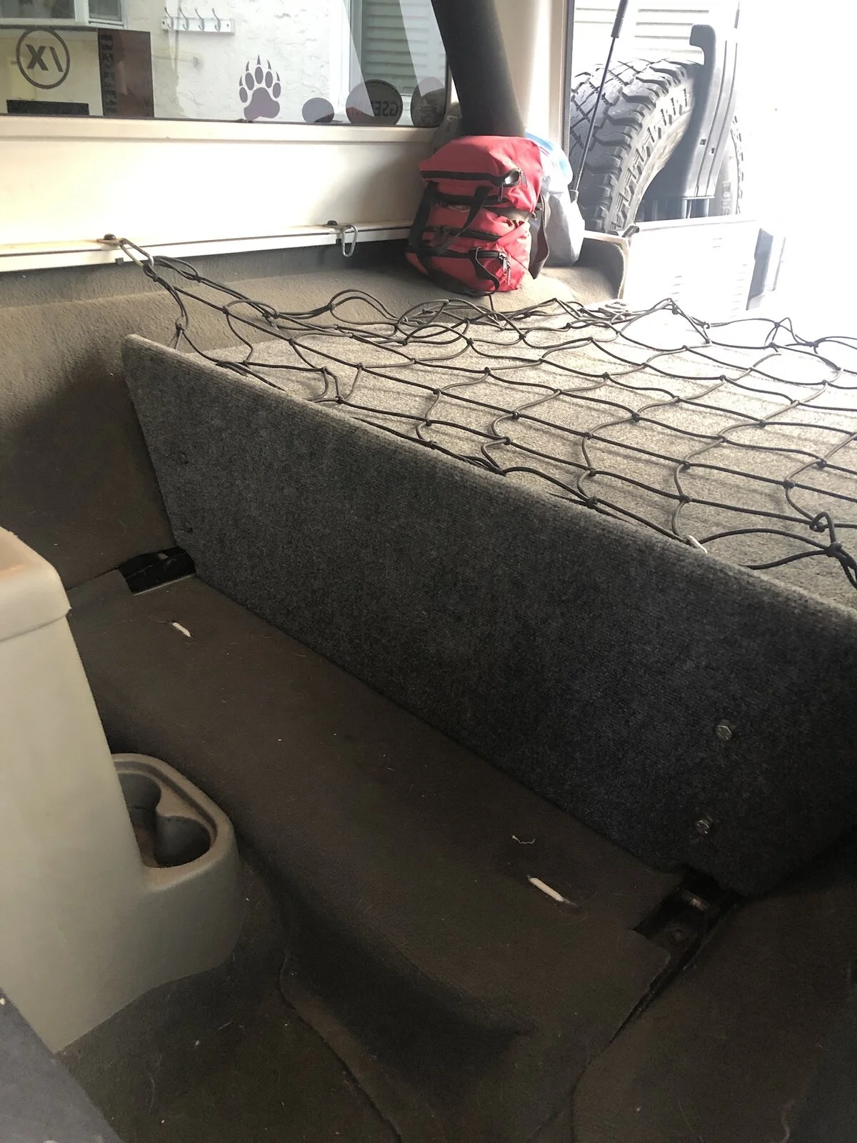

I made this so my dogs have a flat surface stand or lay on. It's two pieces, so I can install and remove it easily. I've since removed all of the back seat brackets.

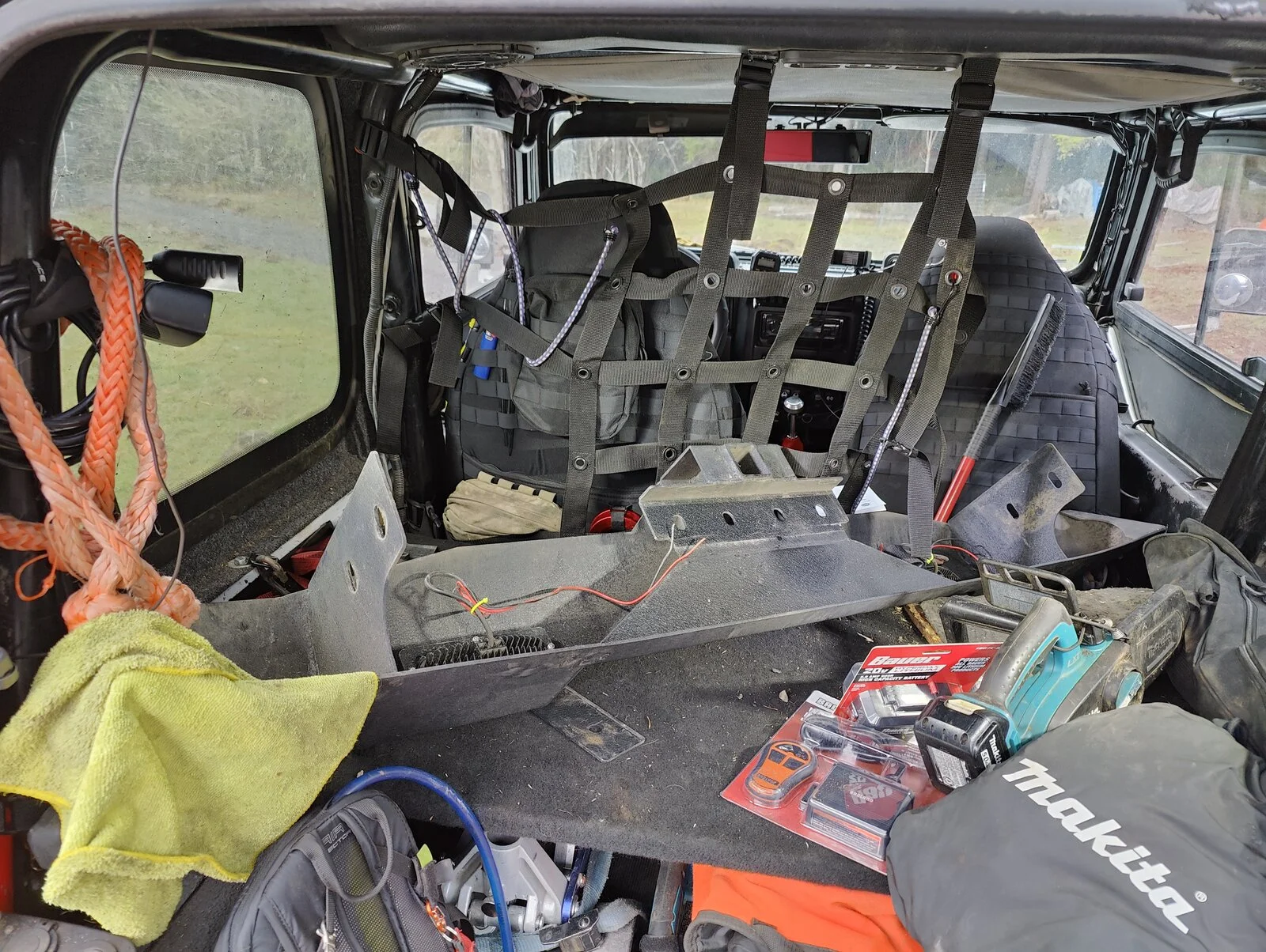

I had a scrap piece of 3/4" plywood left over from a subfloor job... bought $20 worth of marine carpet from Amazon and a spray can of adhesive. Two bolts through existing holes. Holds up a JK junkyard bumper find. And a couple of chainsaws.

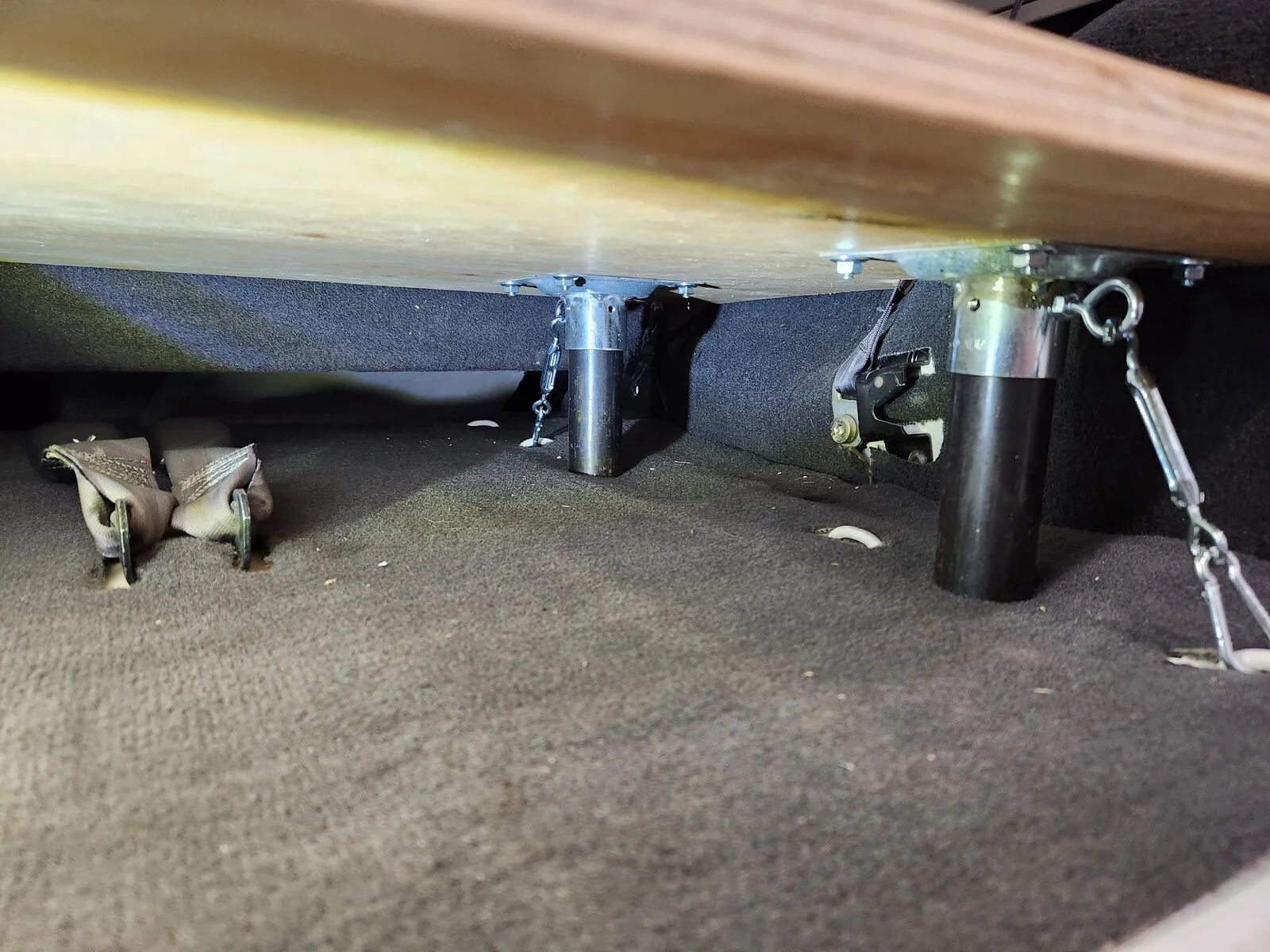

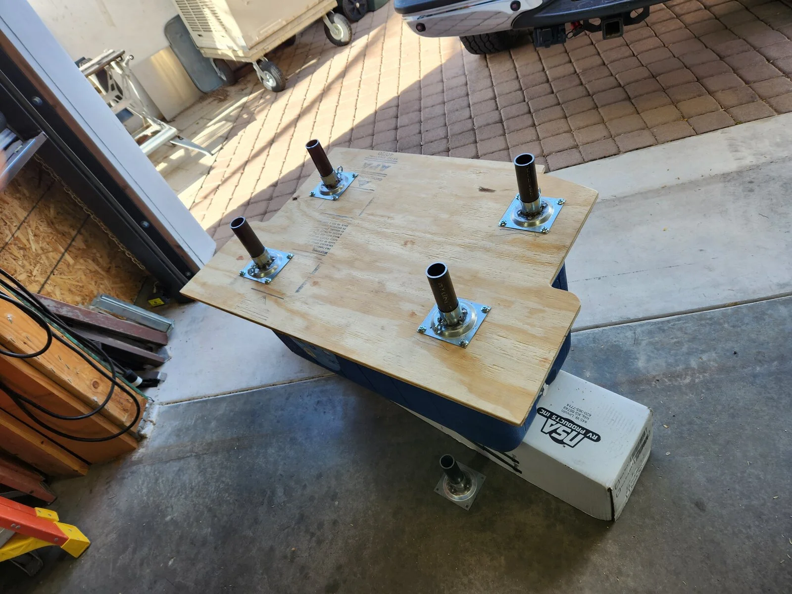

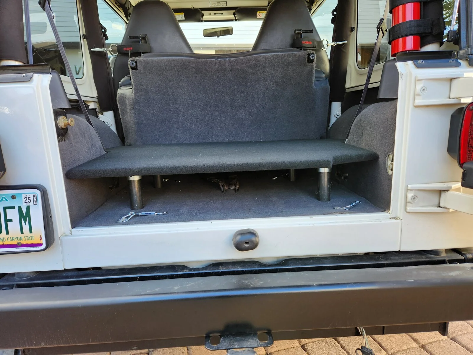

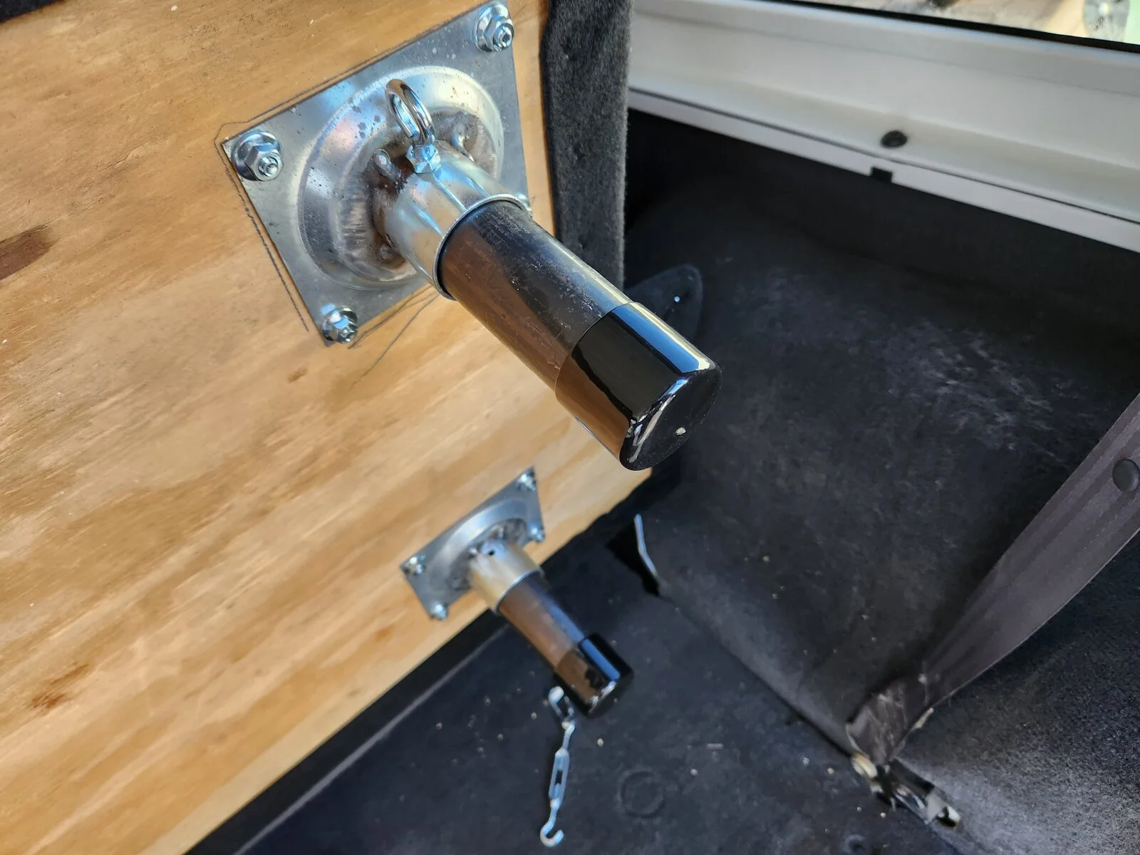

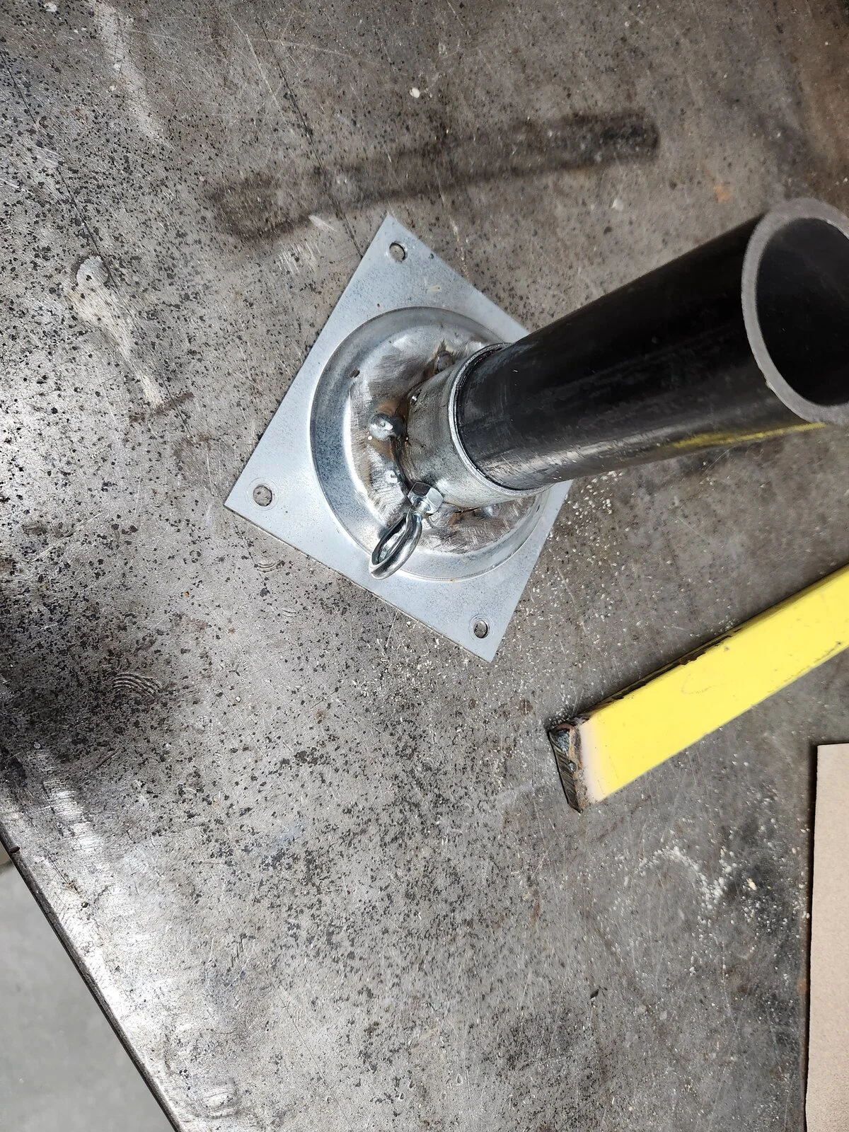

Finished my special purpose platform today, it's purpose is a way to transport the cooler and my gear down to Mexico. I need the back seat once we get there so I designed something to accommodate that. Once I arrive in MX everything goes in the house and I can then fold the back seat back down for beach cruising. I can store tools and gear underneath and the cooler on top. I made the legs from 1-1/4" black pipe cut and threaded to fit couplings which I welded to some hub blank off plates from service panels. I drilled out the center of the plates so the coupling fits thru it and welded it on both sides, then I drilled and tapped the tops of the couplings for hold down hardware. The legs unscrew for easy storage.
