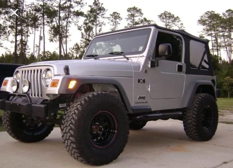

This is 33s on a 2” BB. I’ll have more lift than this. It looks good to me proper bump and I’ll be fine on potholes and speed bumps and yes, I avoid every pothole I can. I take speed bumps slow too.
