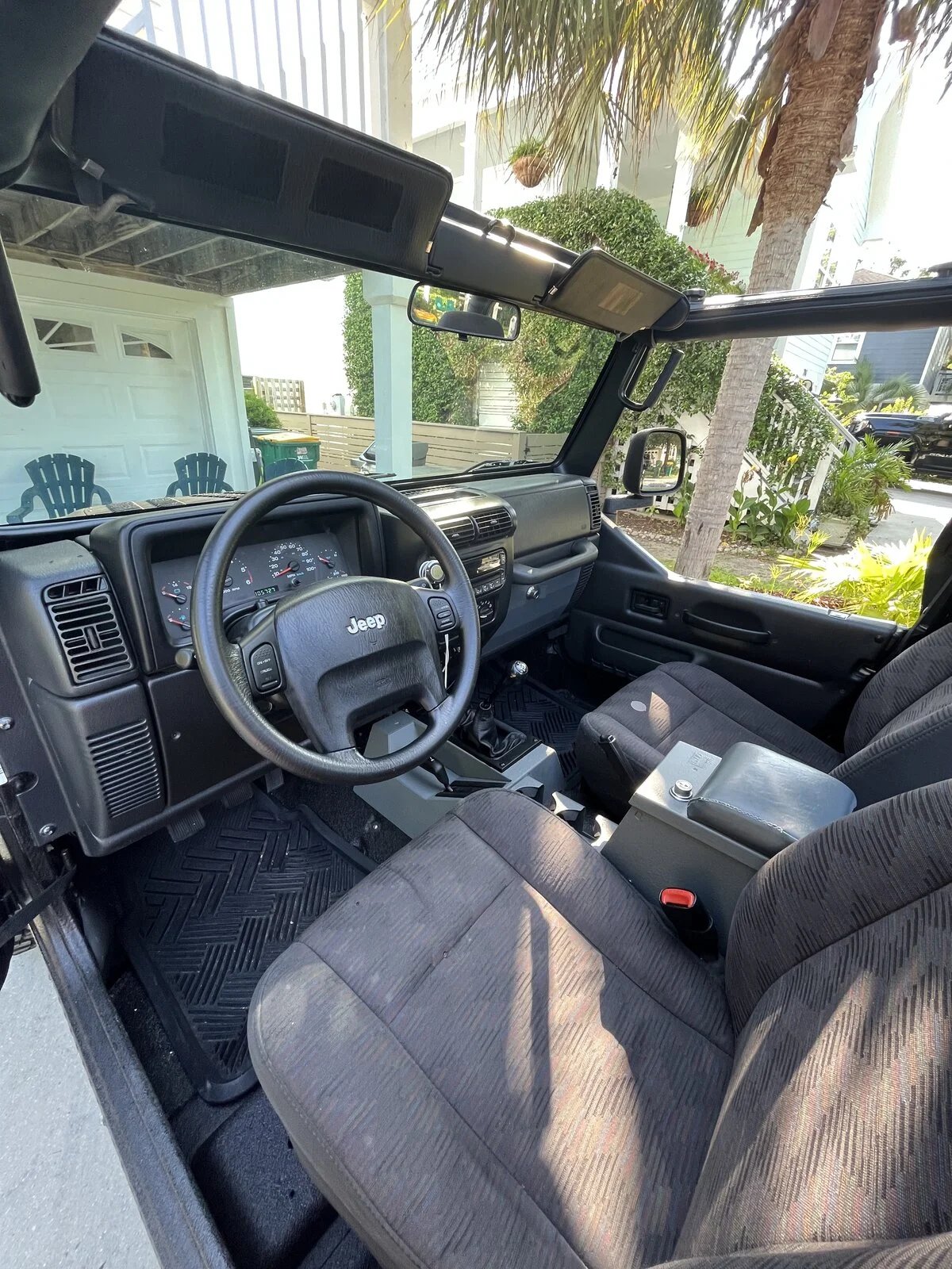

Hi all, I will be documenting my build here. Probably won't be doing a whole lot of mods but may look for advice here in the near future... This is my first Jeep so forgive my ignorance I am here to learn.

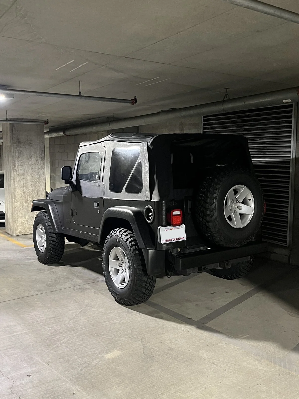

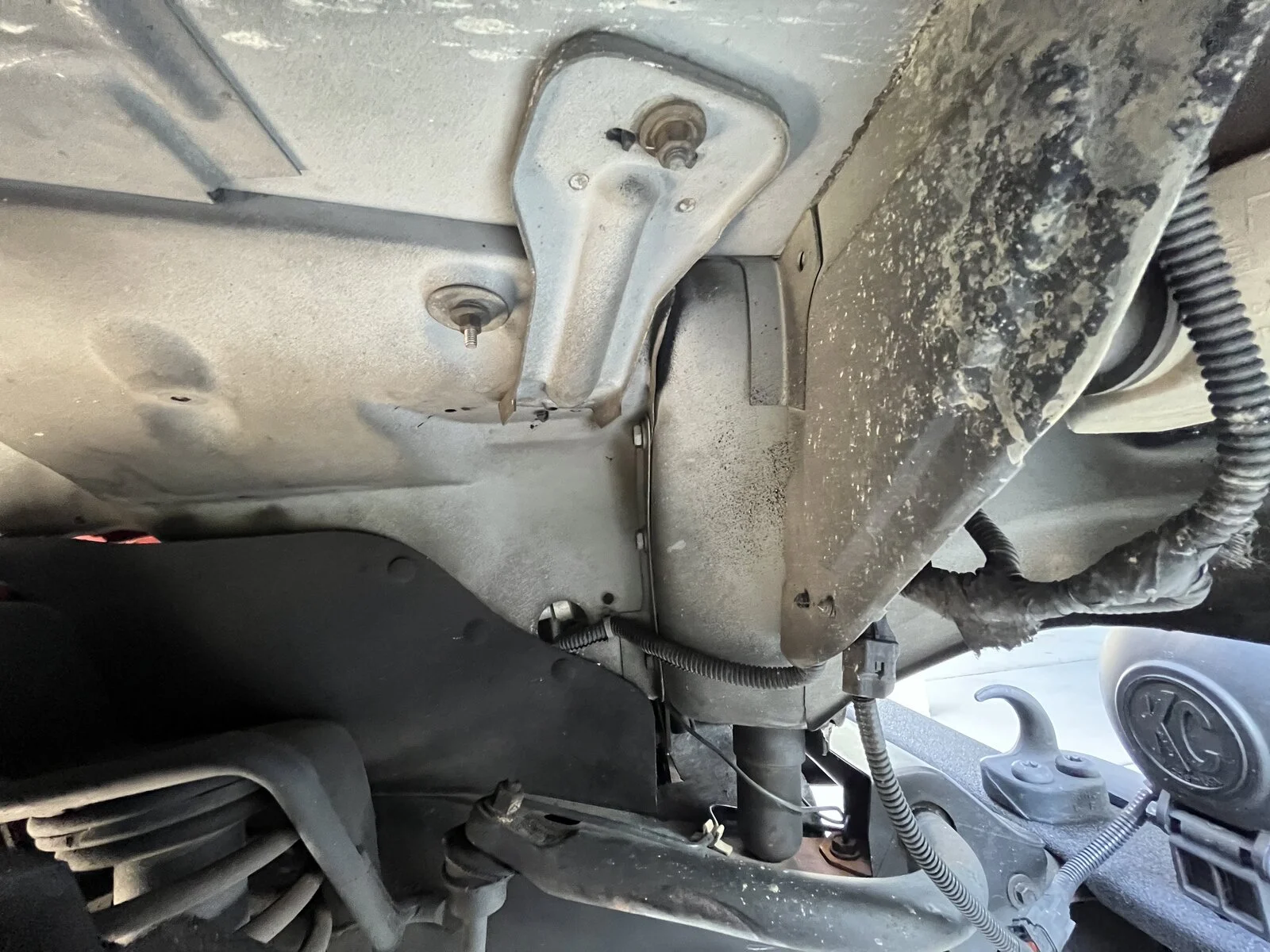

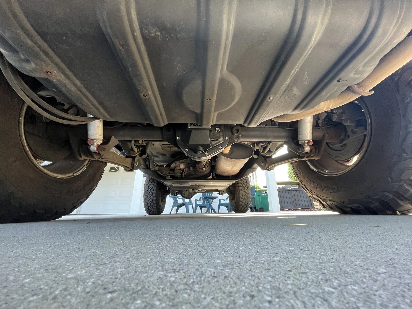

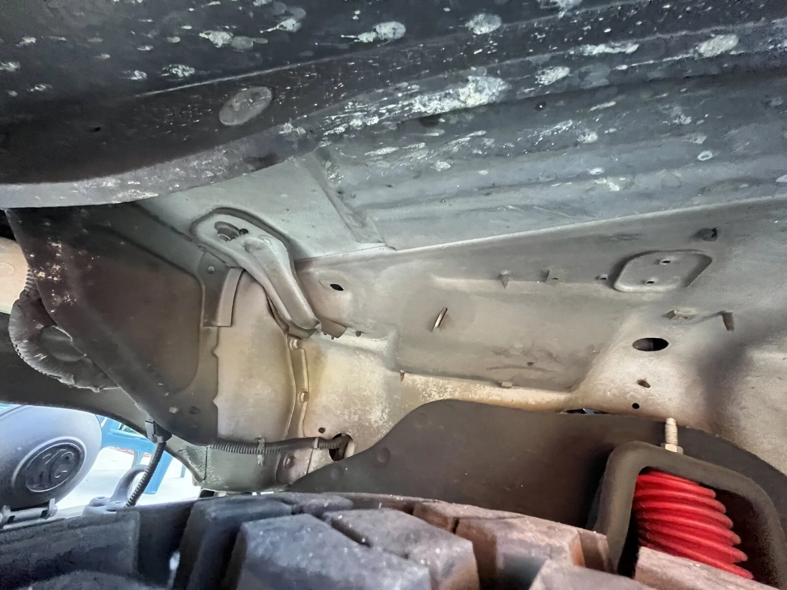

2005 TJ Rubicon 6 speed manual with 100,000 miles, Florida car it's whole life I am the third owner. The entire undercarriage has little to no rust at all, one of the cleanest I have seen. It drives great and I suspect I may not need to do much to baseline it.
Do plan on taking it off-road here in NC and would love to meetup with other people in the area. I plan on going camping near the beach with it mainly this summer.

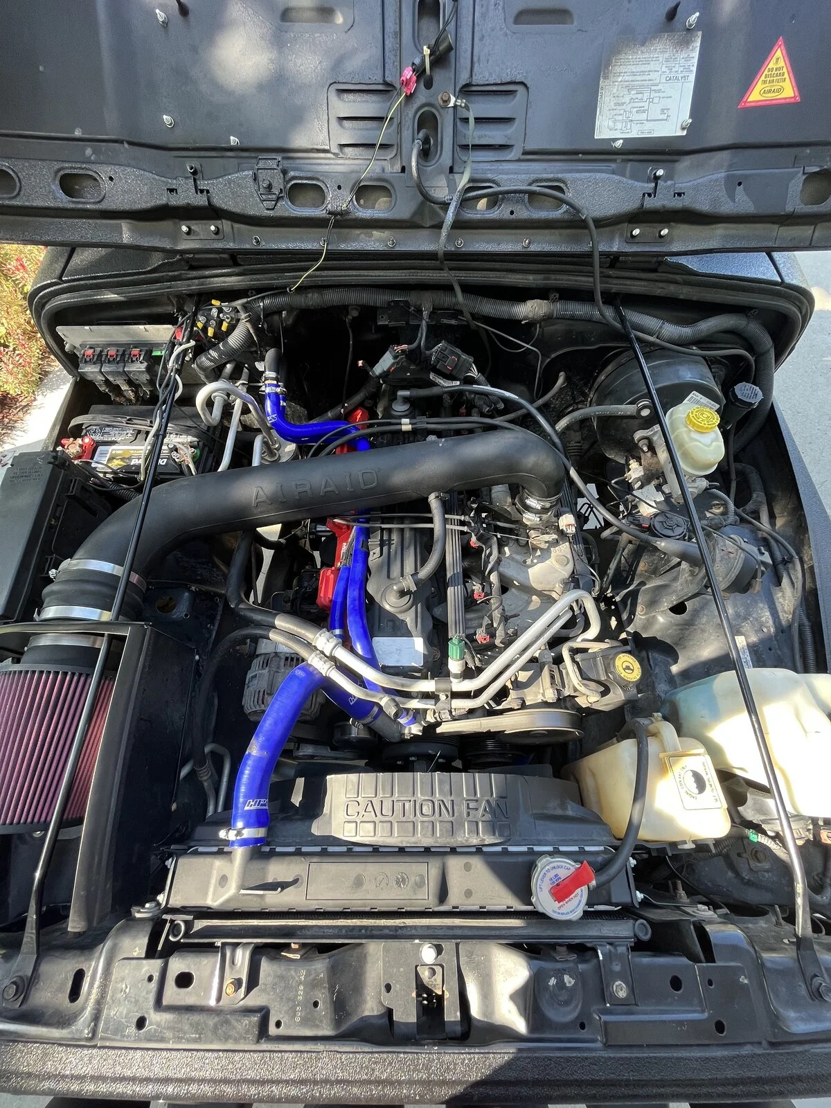

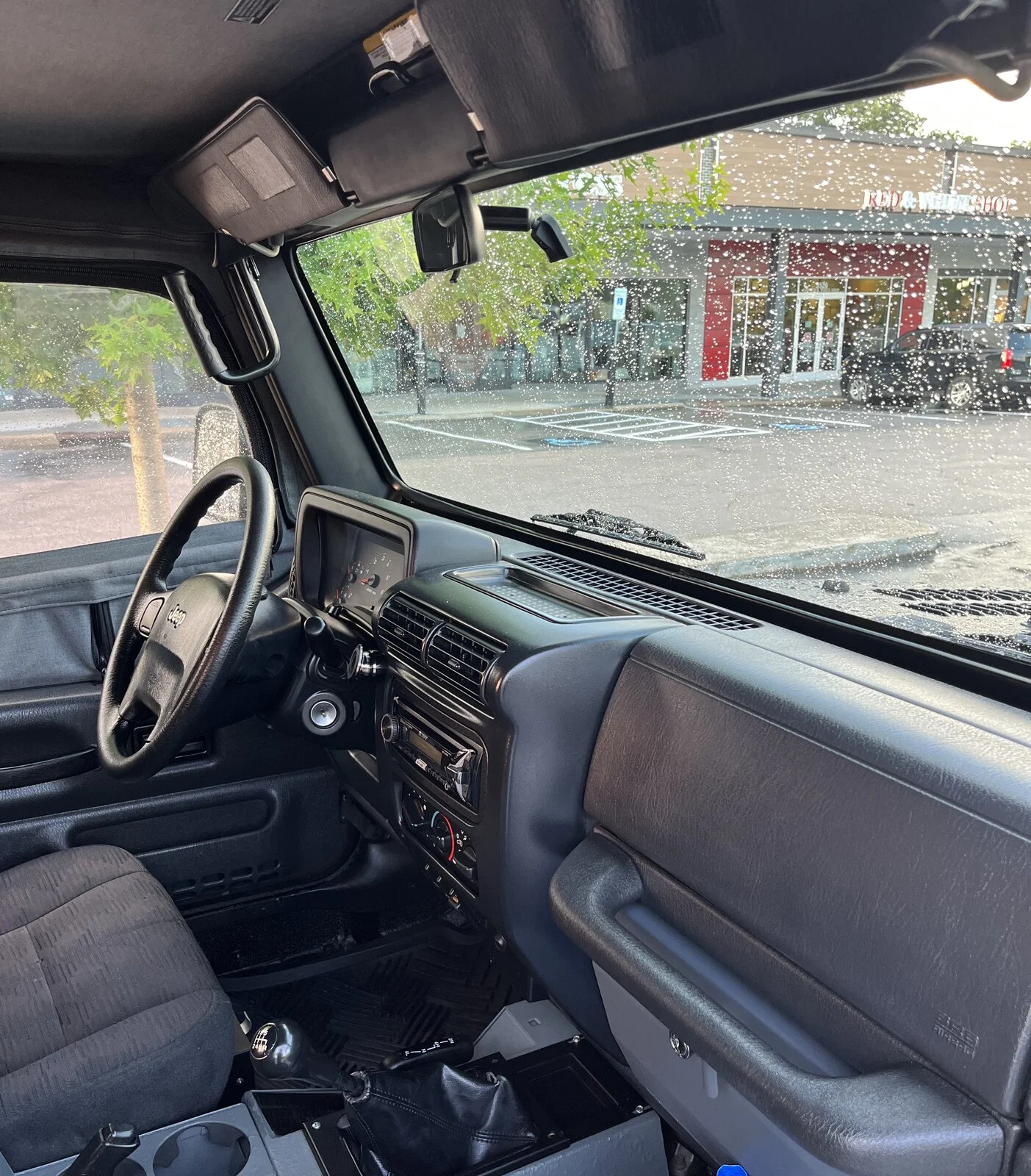

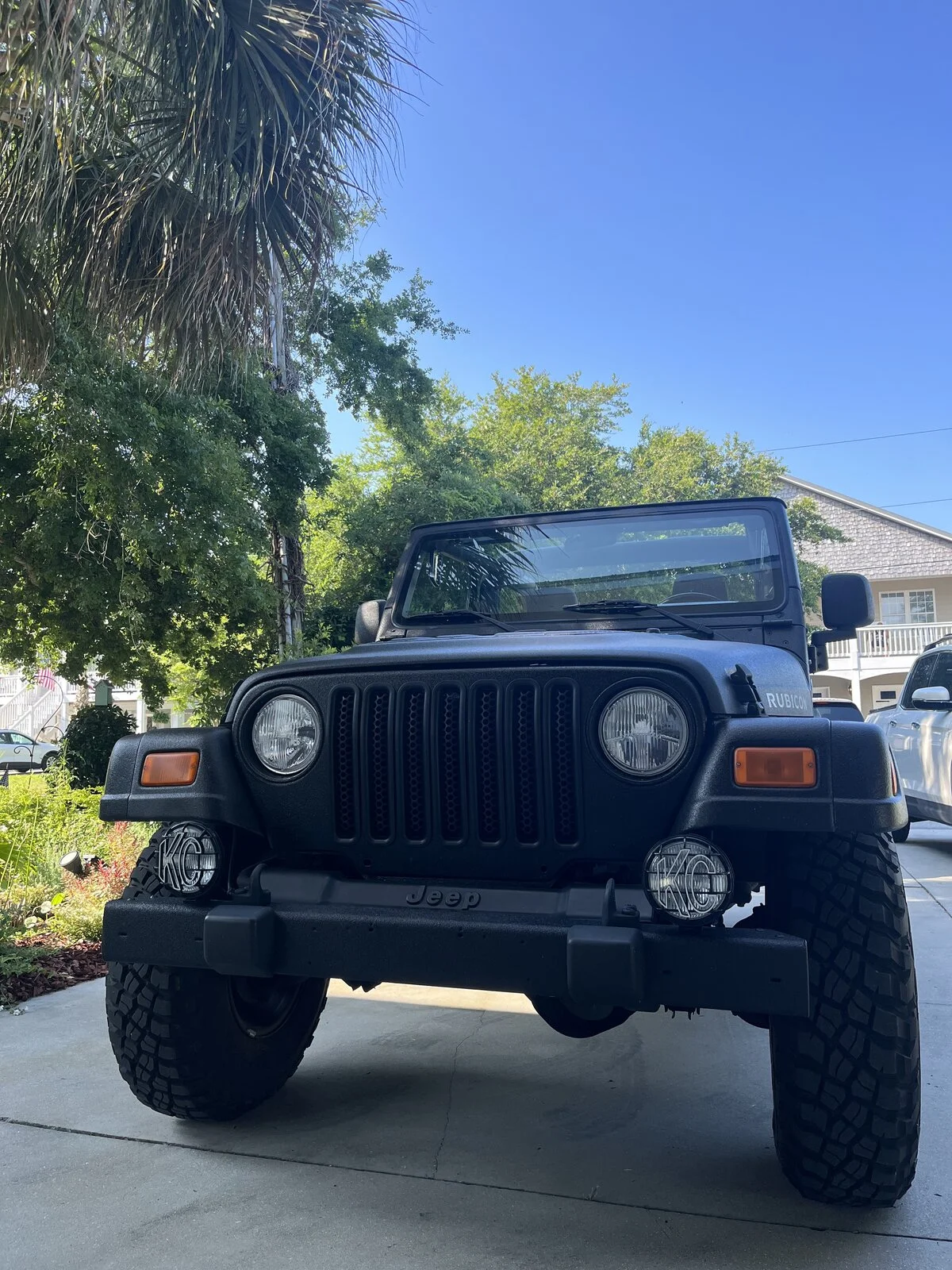

Previous owner bedlined the entire thing including the interior and deleted all carpets, bedliner was seemingly done professionally and looks decent... Original color is black. Has Tuffy locking center console, glove box and under seat compartment. Appears to have a 2 inch body lift and potentially no suspension lift to be confirmed(?), but has rancho RS9000XL shocks and rough country NR3 steering stabilizer as well as Yukon diff covers. Had aftermarket side steps which I have removed and hood mounted forward facing lights which I have removed as well. Brand new transmission was installed in 2022. Has MSD ignition coil and Airaid air intake (any opinion on these?).
Just installed 255/85R16 KM3's.

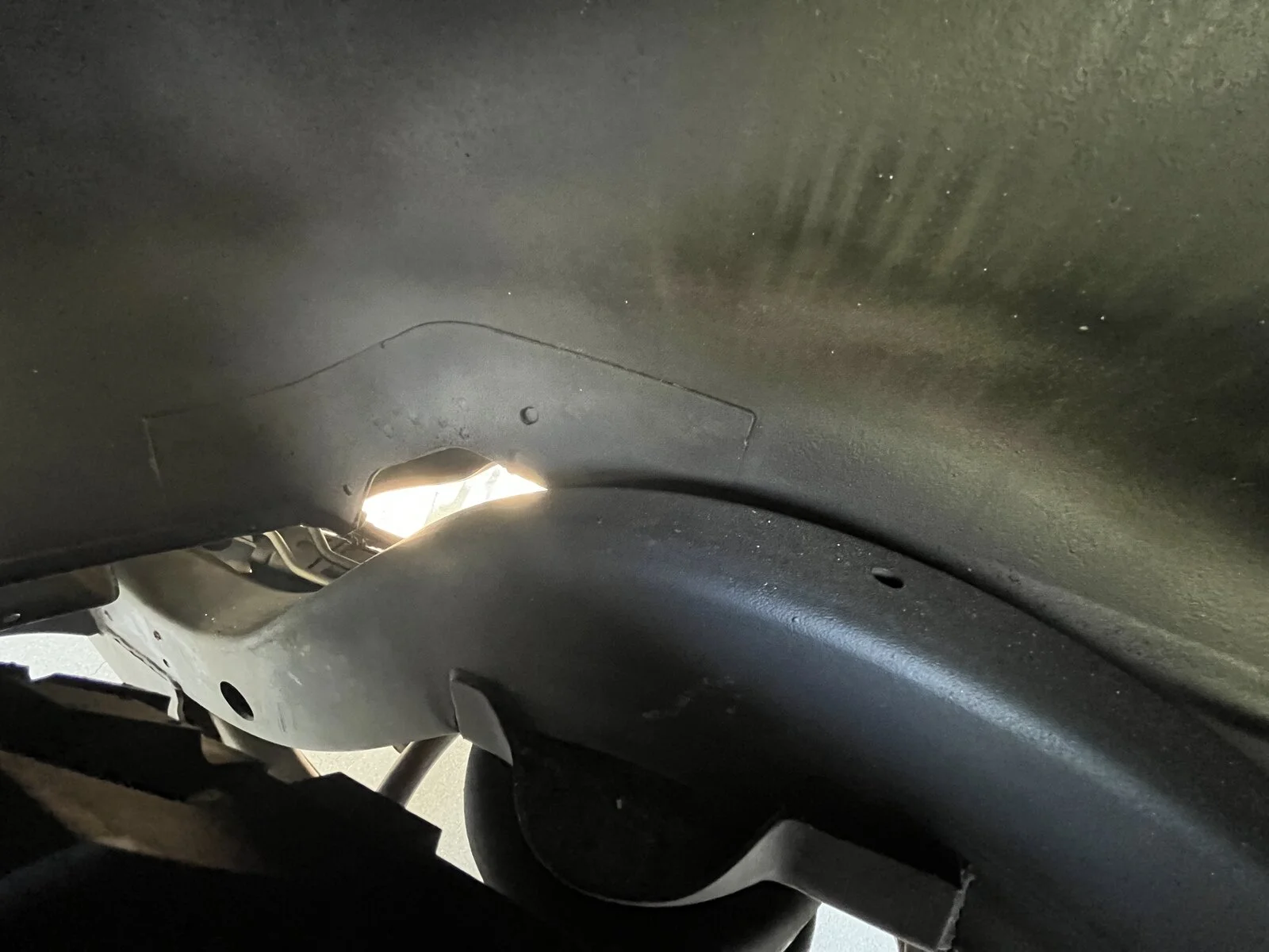

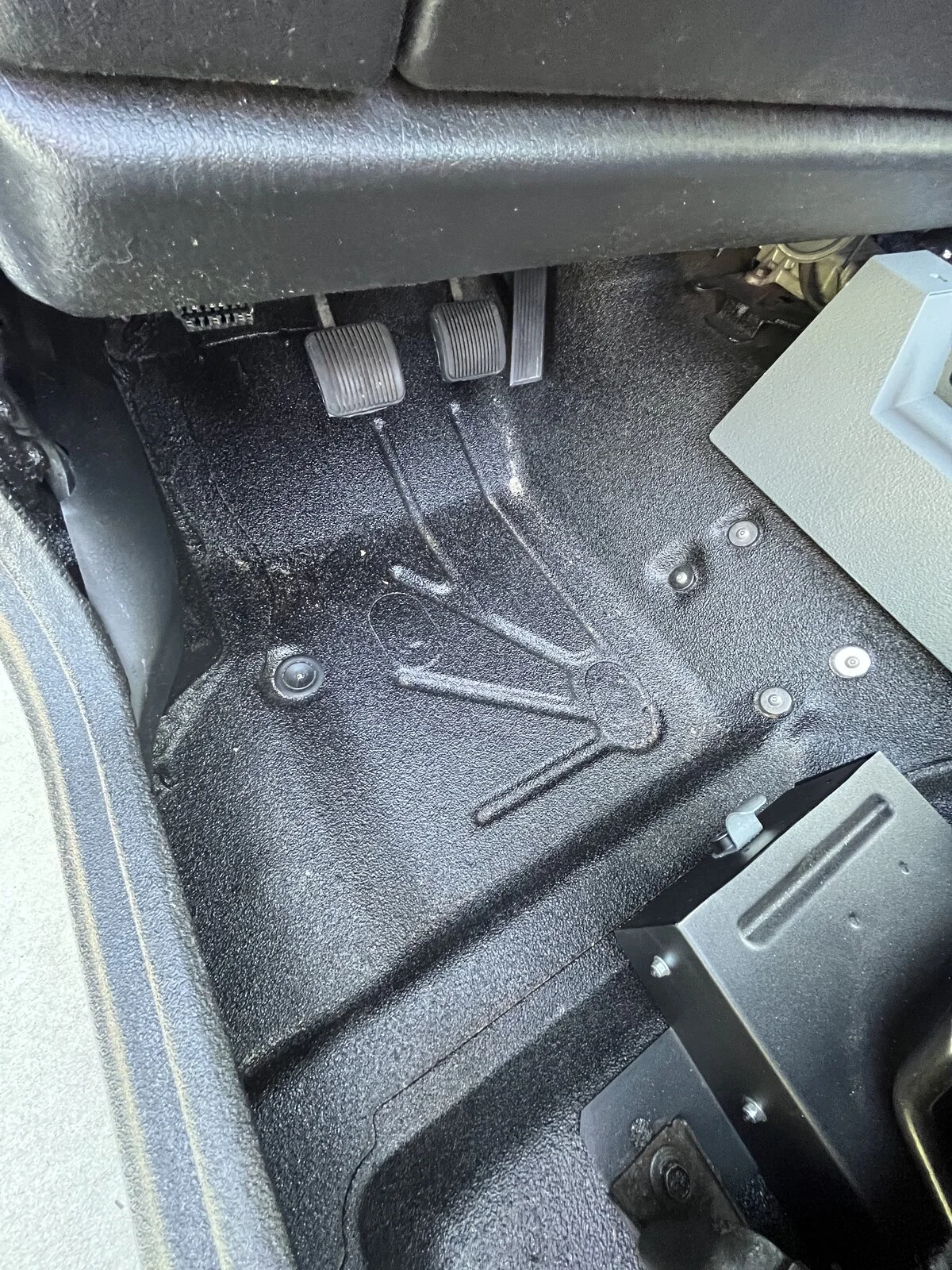

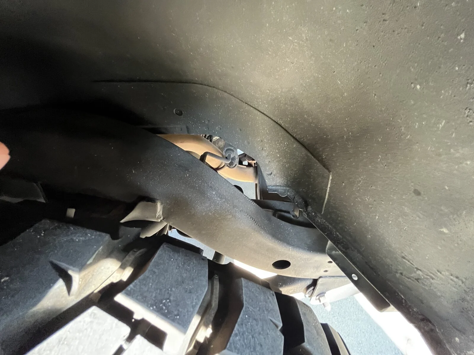

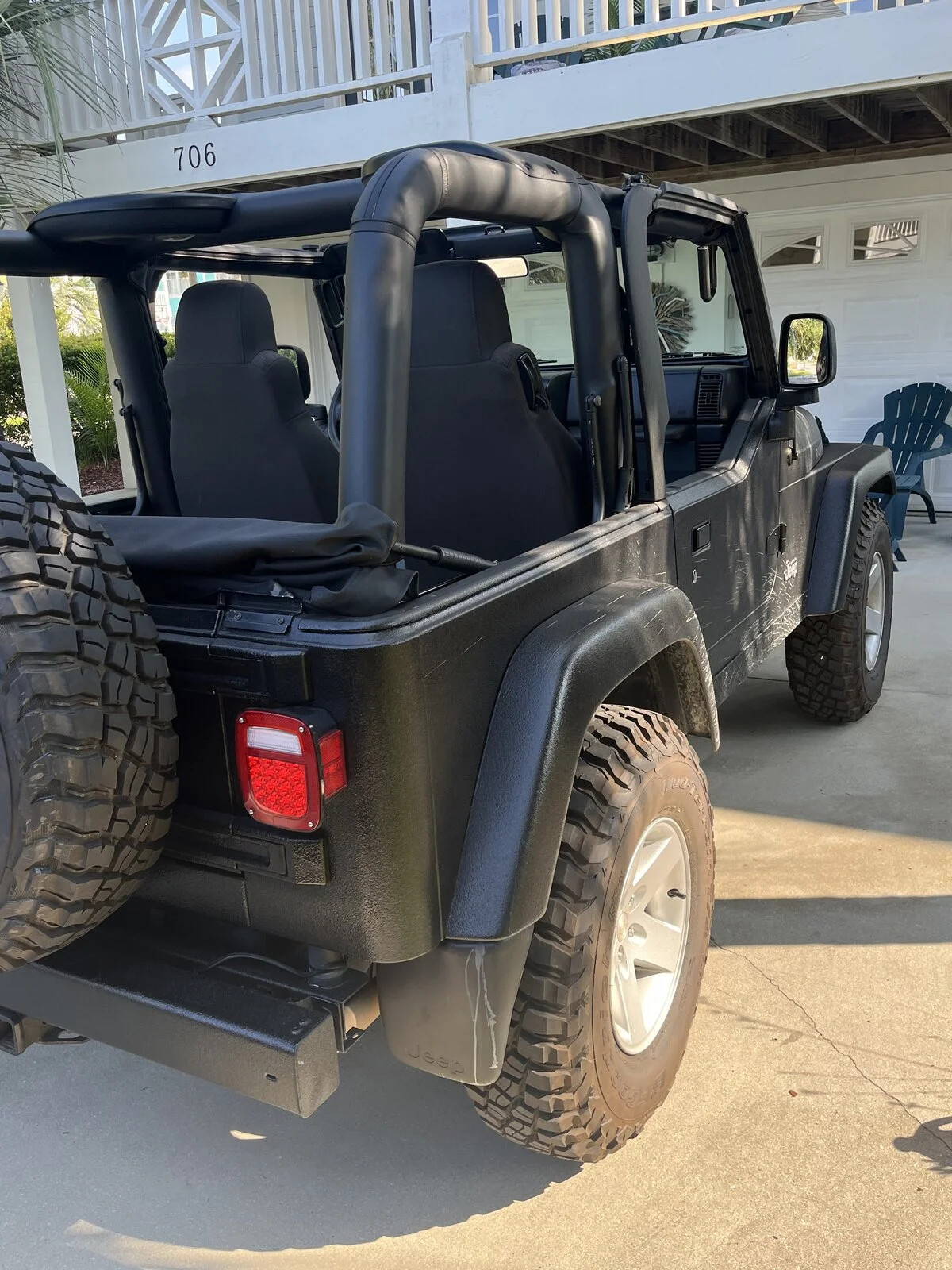

The bedliner is — interesting. Can we get more pictures of it, outdoors, and close ups? I'm just curious.

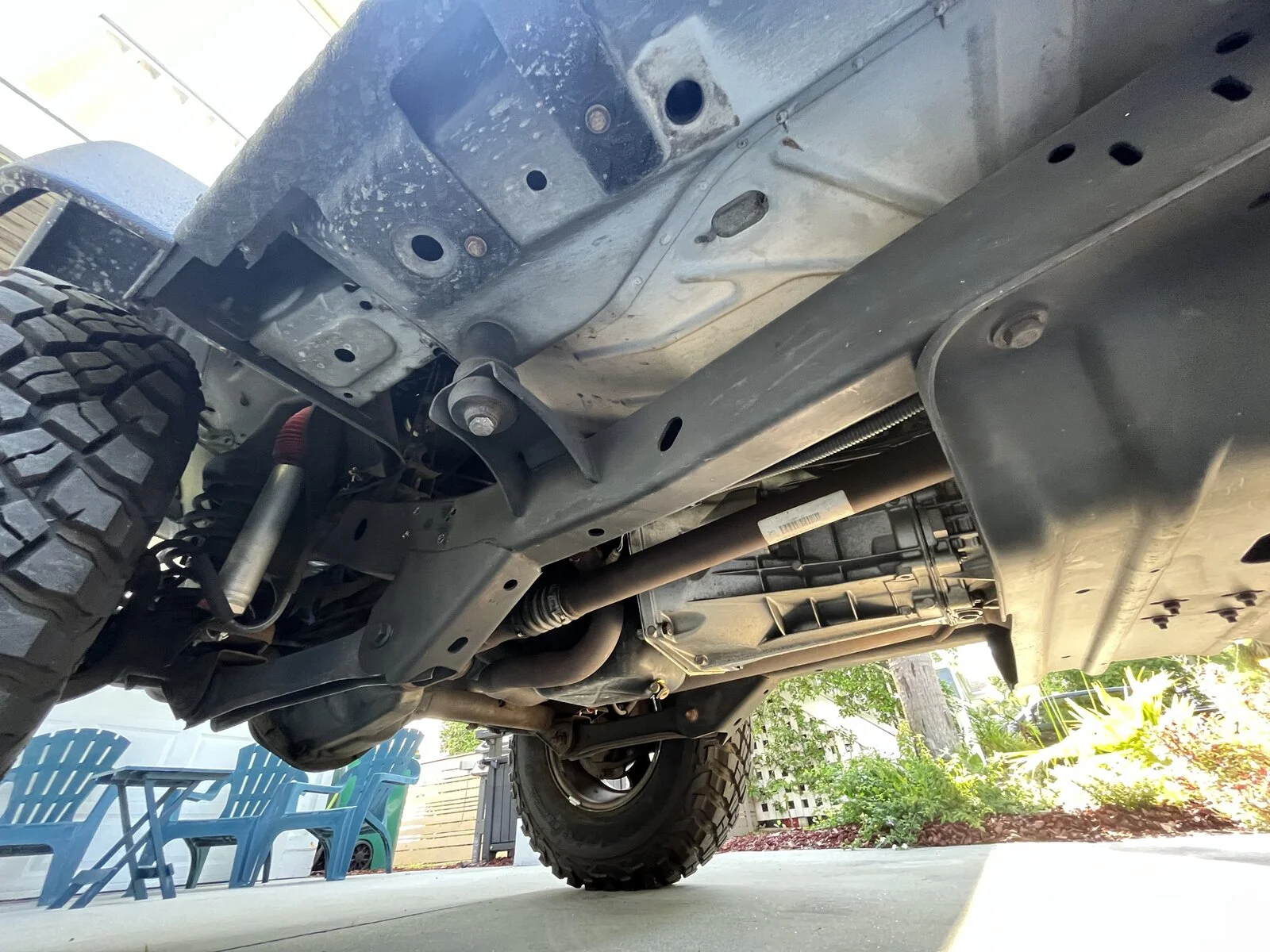

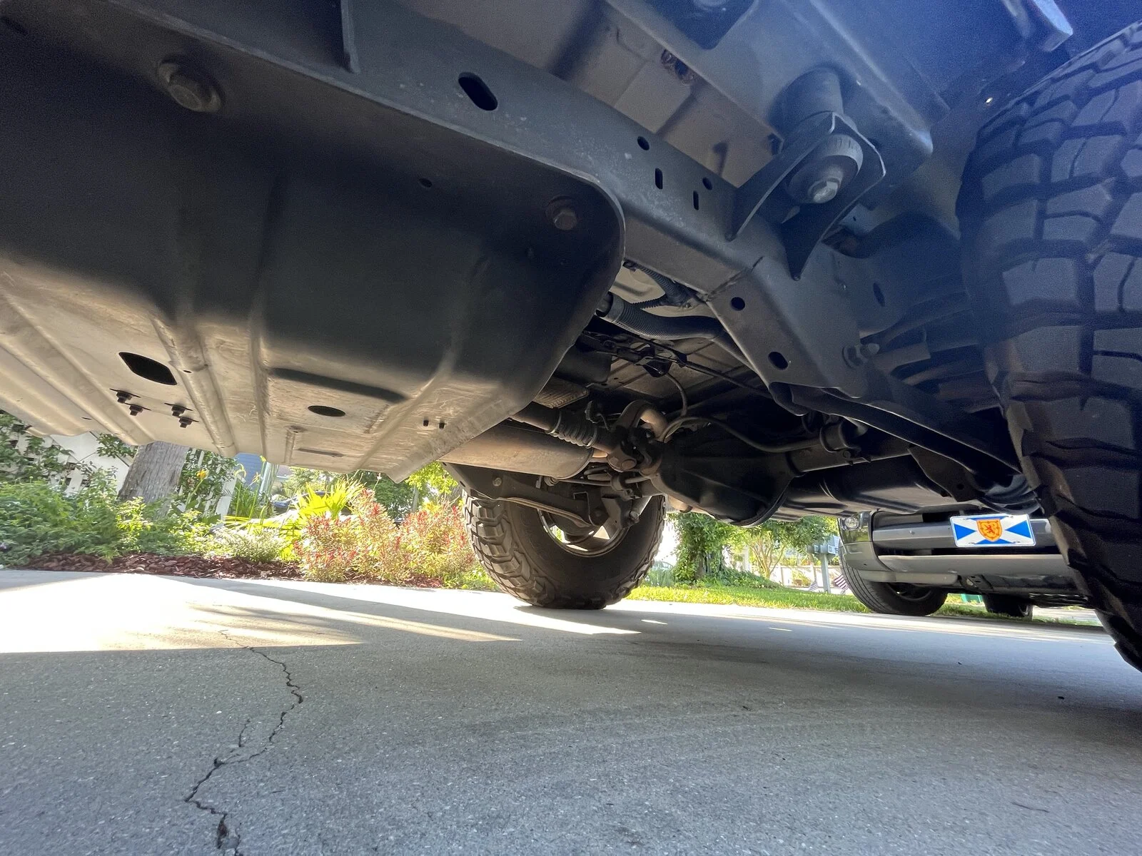

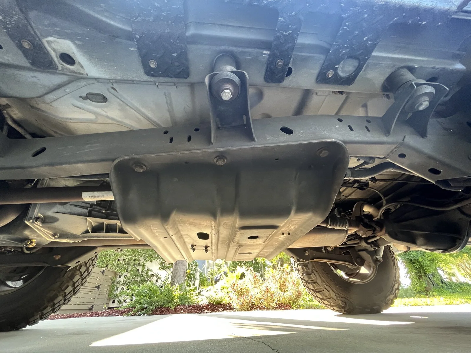

That is an extremely clean looking frame, a good foundation to build on.
I would recommend ditching that too-tall body lift and replacing it with a 1.25" body lift (if you want a body lift) in aluminum, or Mr. Blaine's new acetal set.
If you piece together your own lift parts, you'll get exactly what you want, instead of what some manufacturer thinks you need. There are dozens of threads on here with people doing their own mix. I like my OME springs, JKS track bars, mix of Moog OEM-style control arms with Savvy uppers, JKS sway links (filthy greasy things), StreetRays spacers, Savvy body lift, Black Max shocks, etc.

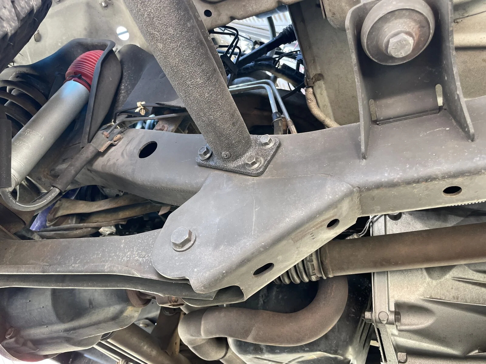

Since you'll have it on the beach, look for ways to protect your frame. There are a lot of threads on here about interior frame coatings, drain holes (you have front ones where an auto trans mount would go), cleaning, and inspection.

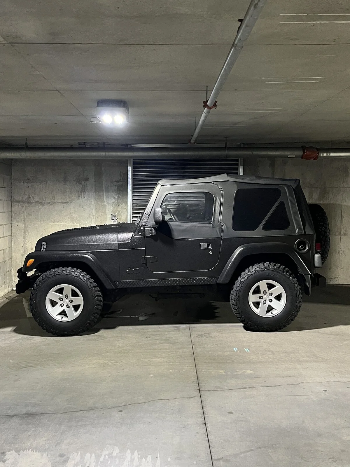

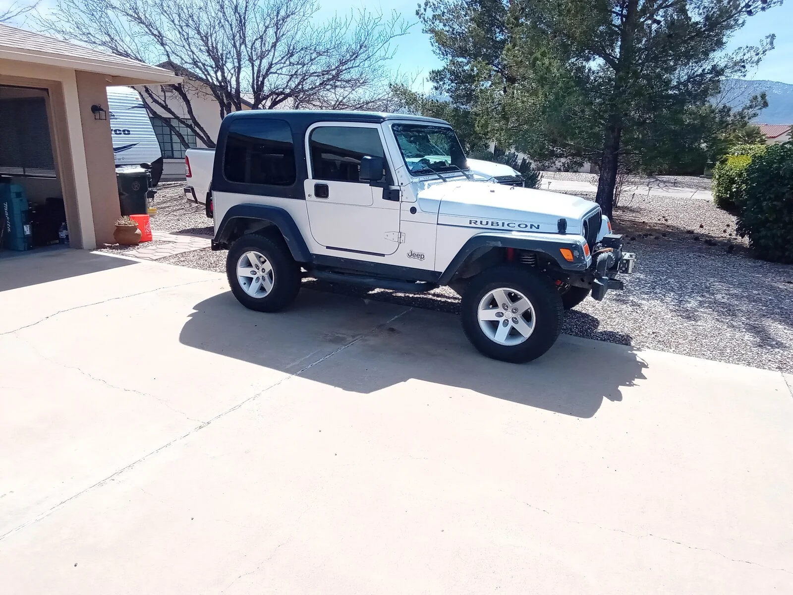

Here is my two inch OME coils paired with rancho shocks, 1 inch BL, properly cycled bumps, and an antirock. This setup served me well for years

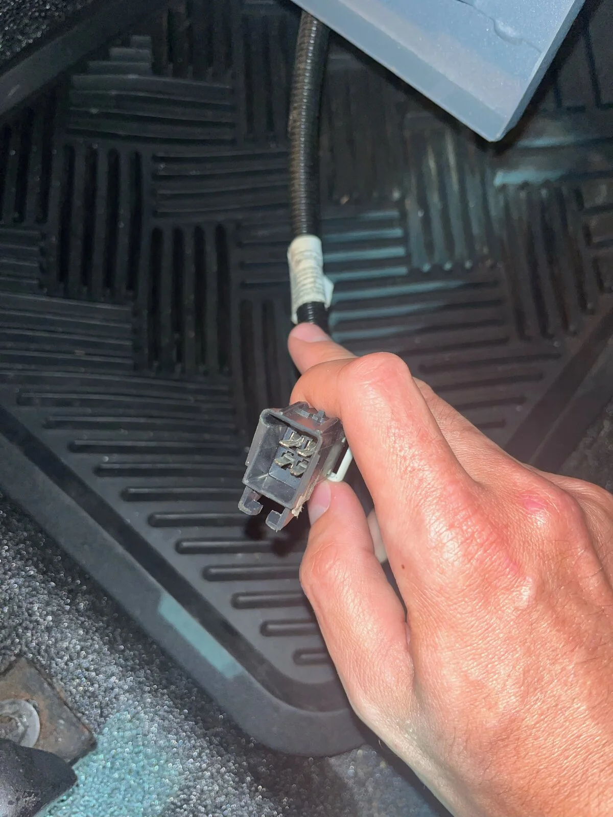

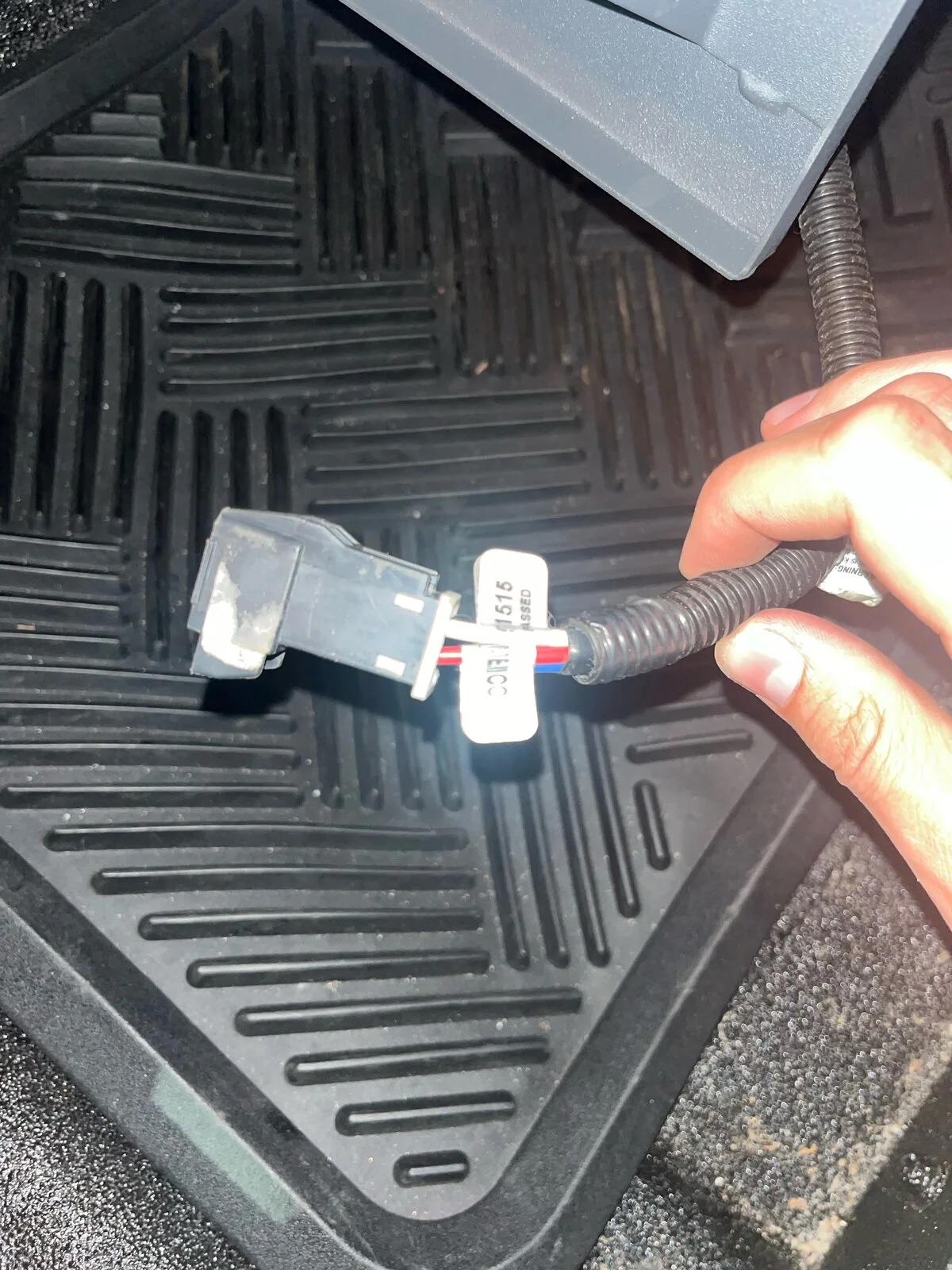

Does anybody know what this connector is? Appears to be aftermarket and is hardwired directly to the battery through the firewall as well as a bunch of other wires that branch off behind the glovebox. It was sitting in the driver side front footwell by the center console.
