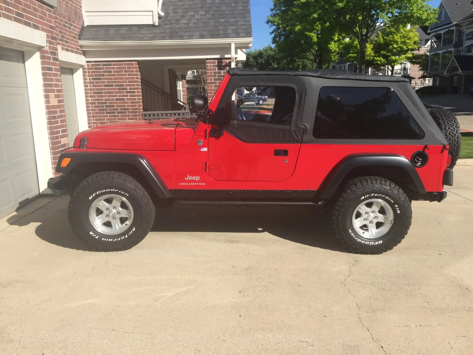

I do have KO2 33x 10.5 on the Unlimited and runs good on road, no much noise. Never try 12.5 on the Ravines so I can't spoke there.

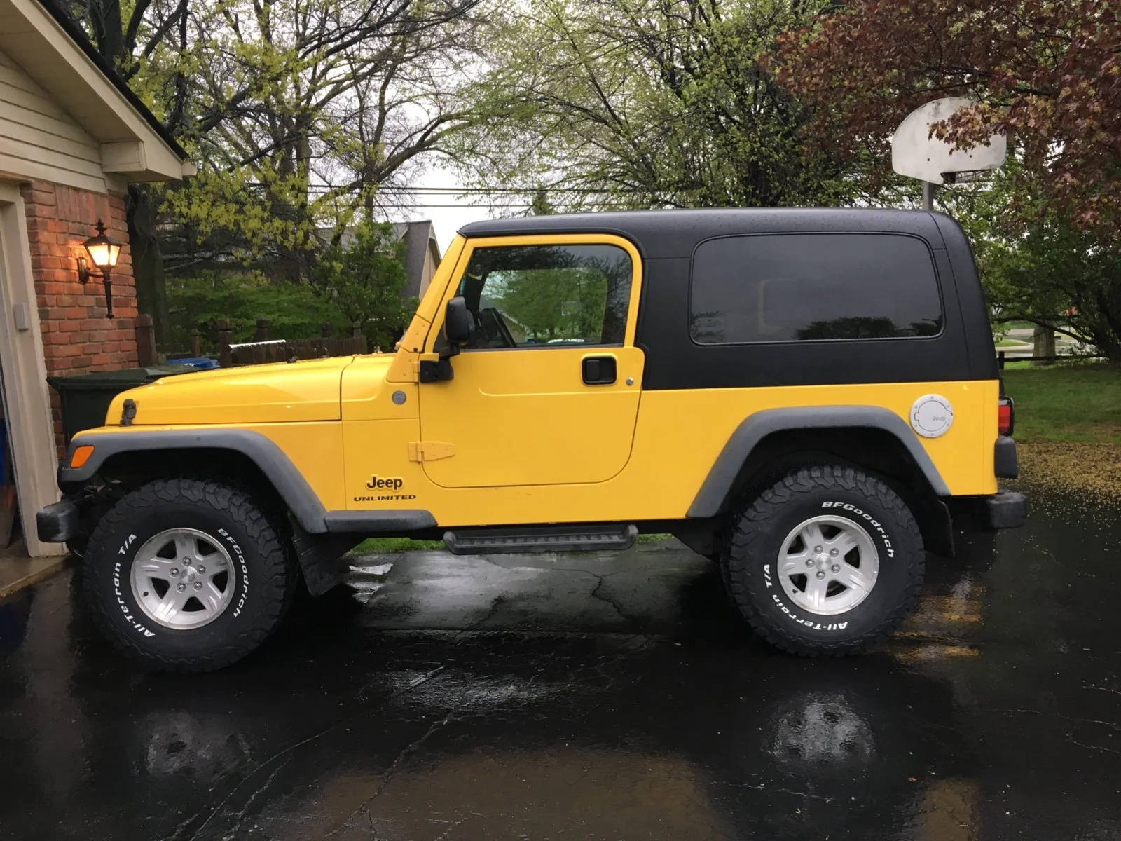

We have a 2 inch suspension and 1 inch body. We are running 33x10.50x15 BFG Ko2's on our factory ravines in our LJ. If you go 12.50 I believe you will need wheel spacers.
That's a nice looking rig! I think I will be going with Ko2's 33x10.5. Not to interested in spacers. Thanks for the replies guys!

Your jeep looks identical to mine except mines all black. I have 33x12.5 on my jeep but your wheel needs to be 0offset I'm pretty sure for them to not rub
