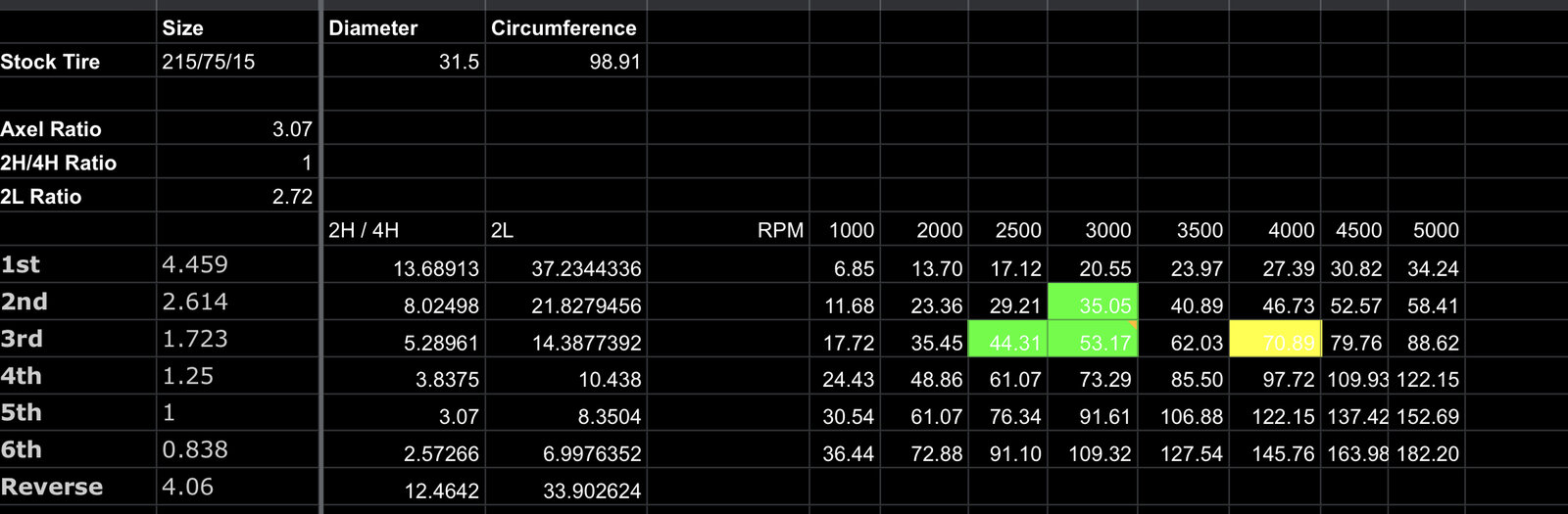

I’ve been reading the forums and have a specific question I cannot find perspective on. I have a 2006 6MT with the 3.07 axel and 31.5” wheels. I’ve verified these numbers by driving and spot checking.
My setup is not as quick as I’d like.
I am thinking of going to 4.56 gears and 33”s. So question, it seems that I’m in an overall 13.68 ratio in first gear with my current setup. If I upgrade to 4.55 it would calculate to 20.33.
Would I be able to shift into 4Lo (2.72) and use 2nd gear - which ends up being a 21.8 ratio - to test what the “after” feels like? Wouldn’t that give me very similar feel of how I’d accelerate in 1st gear after regearing? Yea I’d be going from 31.5” to 33” but I think that would coincidentally be the difference between the 20.33 and 21.8, give or take.

This is my go to gearing calculator:
https://www.marlincrawler.com/java/getspd_calc.html
You can plug in the info for your scenarios there easily. And the short answer is yes, 2nd (with 4.56’s) will feel close to your current 1st (with 3.07’s) but will still be a little faster. Also—yes you can use 2nd gear in 4-low. And yes, 4.56 gears with the 6 speed is a good choice as long as you are committed to never sizing up to 35s. And if you do really technical off-roading you will want to go lower. But for good highway performance I would say 4.56’s and 33s are a good combo.

Thanks for the input. I am not sure I was clear - I want to get an idea of how it might feel NOW before I regear.
If using my current 3.07 gear, 2nd gear, and 4-low (21.8 ratio), would that get me the “seat of pants” feel for what first gear in 2-high would feel like after regearing (4.56 * 4.45 = 20.3 ratio).
I’ve hear people say “I want to know how it might be like to accelerate from a stop after regearing” but haven’t seen anyone suggesting this hack for those with transmissions and transfer cases that happen to Line up ratios like this.

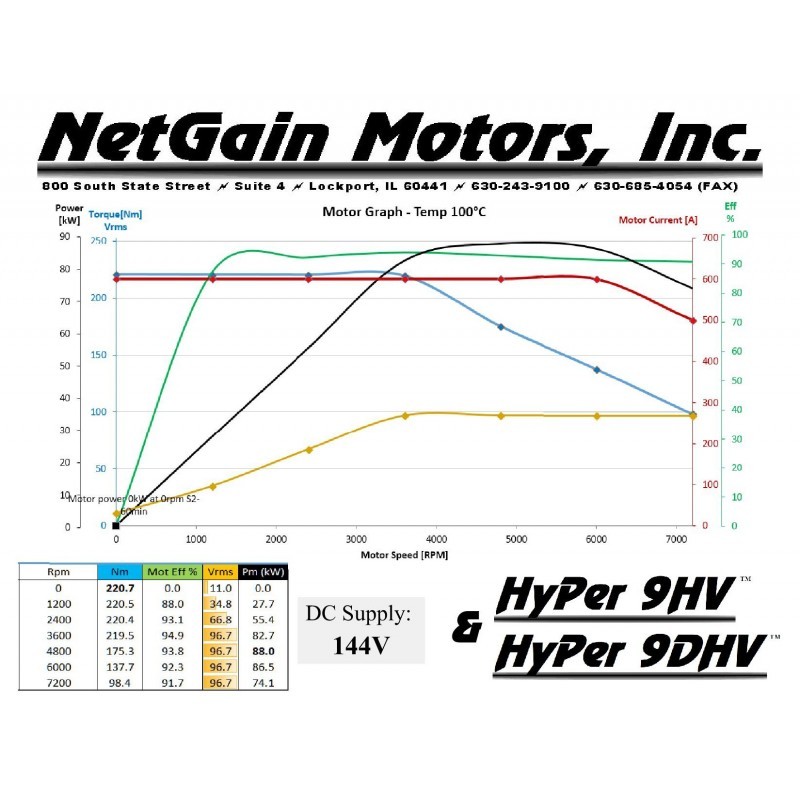

Here’s the performance graph for the motor. It’s 176 ft-lbs of torque from 0-3750rpm then declining from there. I know it’s not apples to apples but it’s probably close to the 4 cyl except the torque is fully available at 0rpms so maybe not 🤷‍♂️

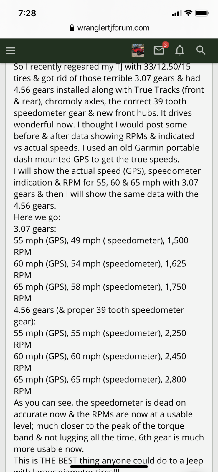

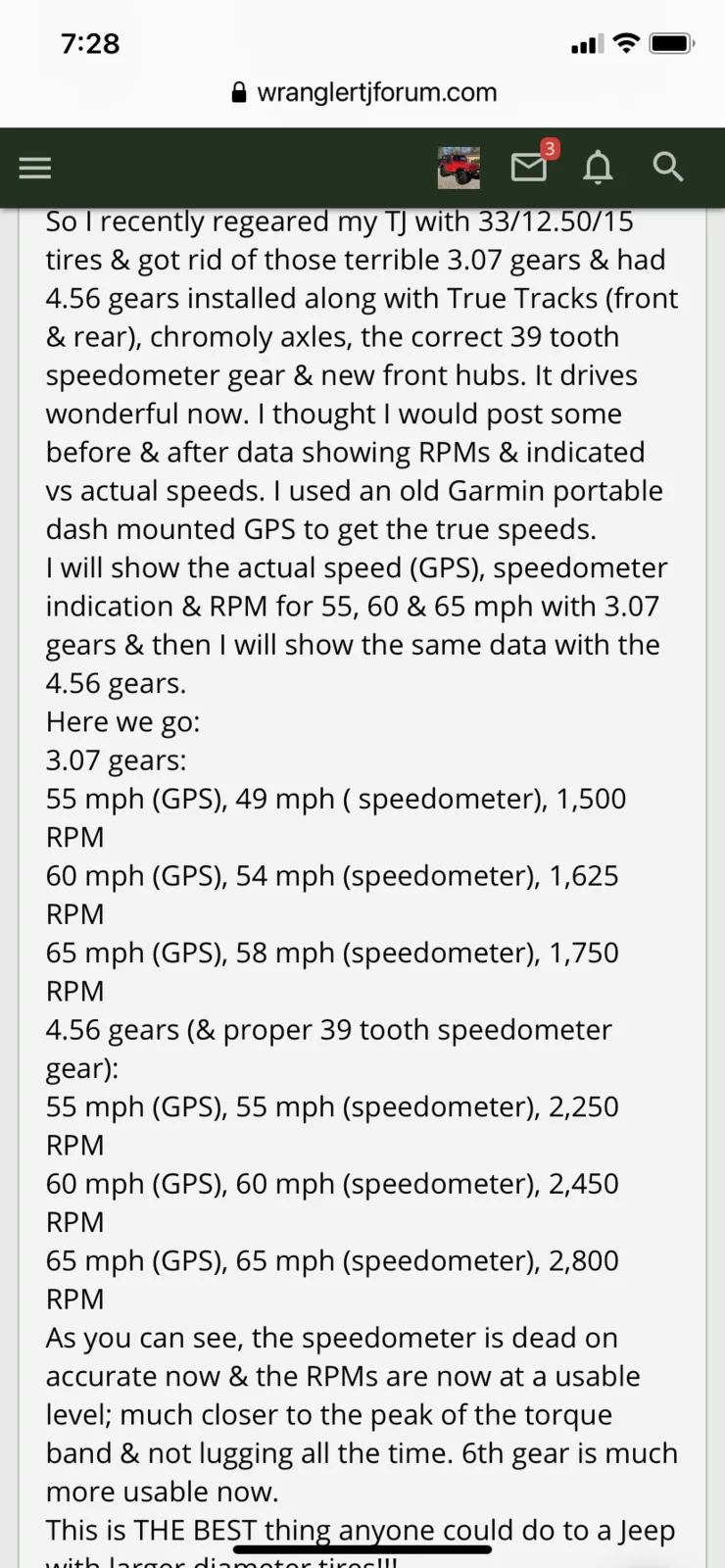

I don’t think I have an answer to your question, but I’ve attached some “before & after” data from when I changed from 3.07 gears to 4.56 gears. 4.0 liter & 6 speed manual.
By the way, you will need the 39 tooth speedometer drive gear if you go with 33” tires & 4.56 gears.

Thanks for this perspective - very helpful. Especially the speedometer fix. I’m at some point going to need to just roll the dice and regear regardless of the different performance characteristics of the electric motor.
4.56 but I might keep my 31.5” tires until they are done, then go to 33”.
